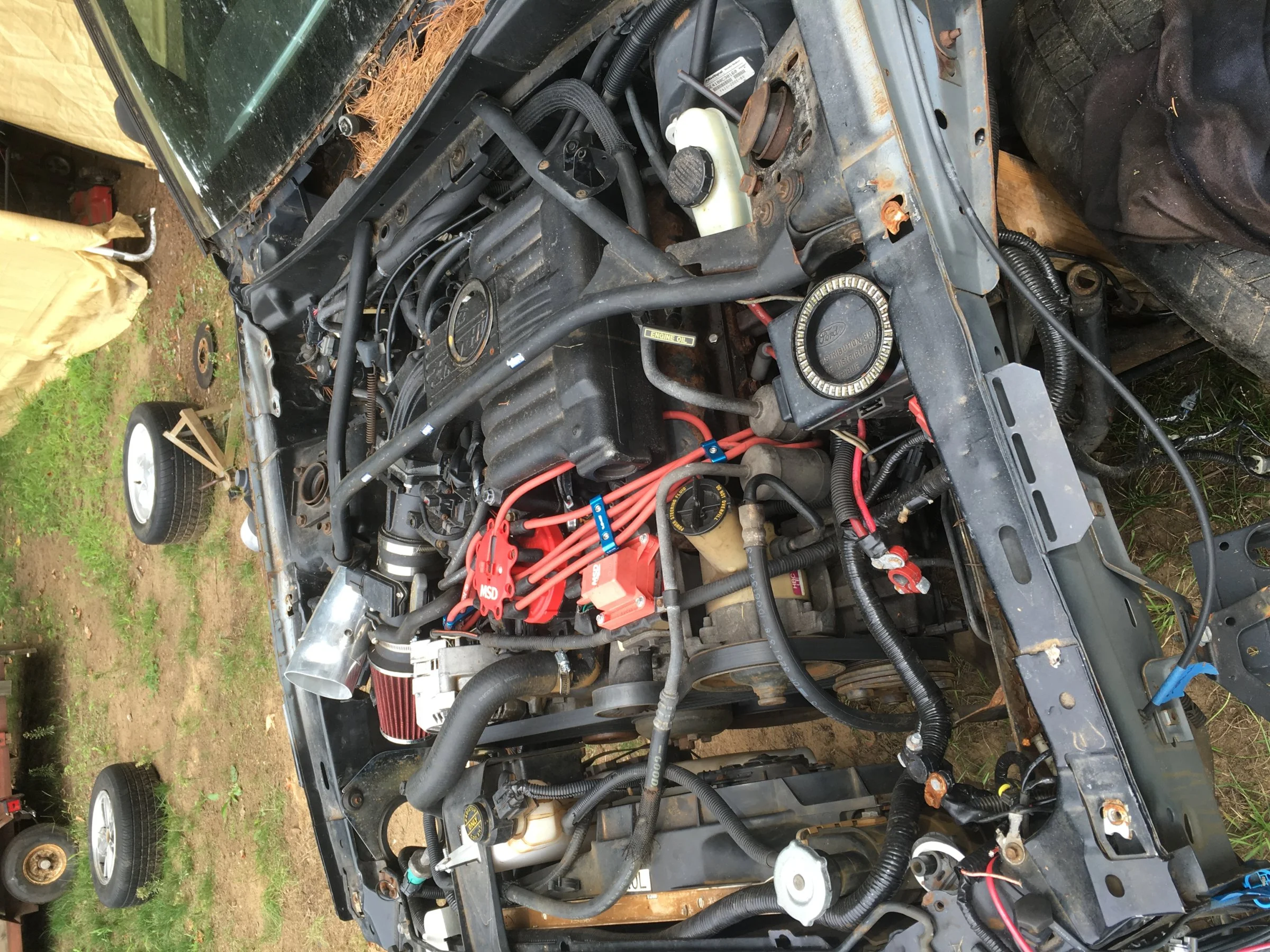

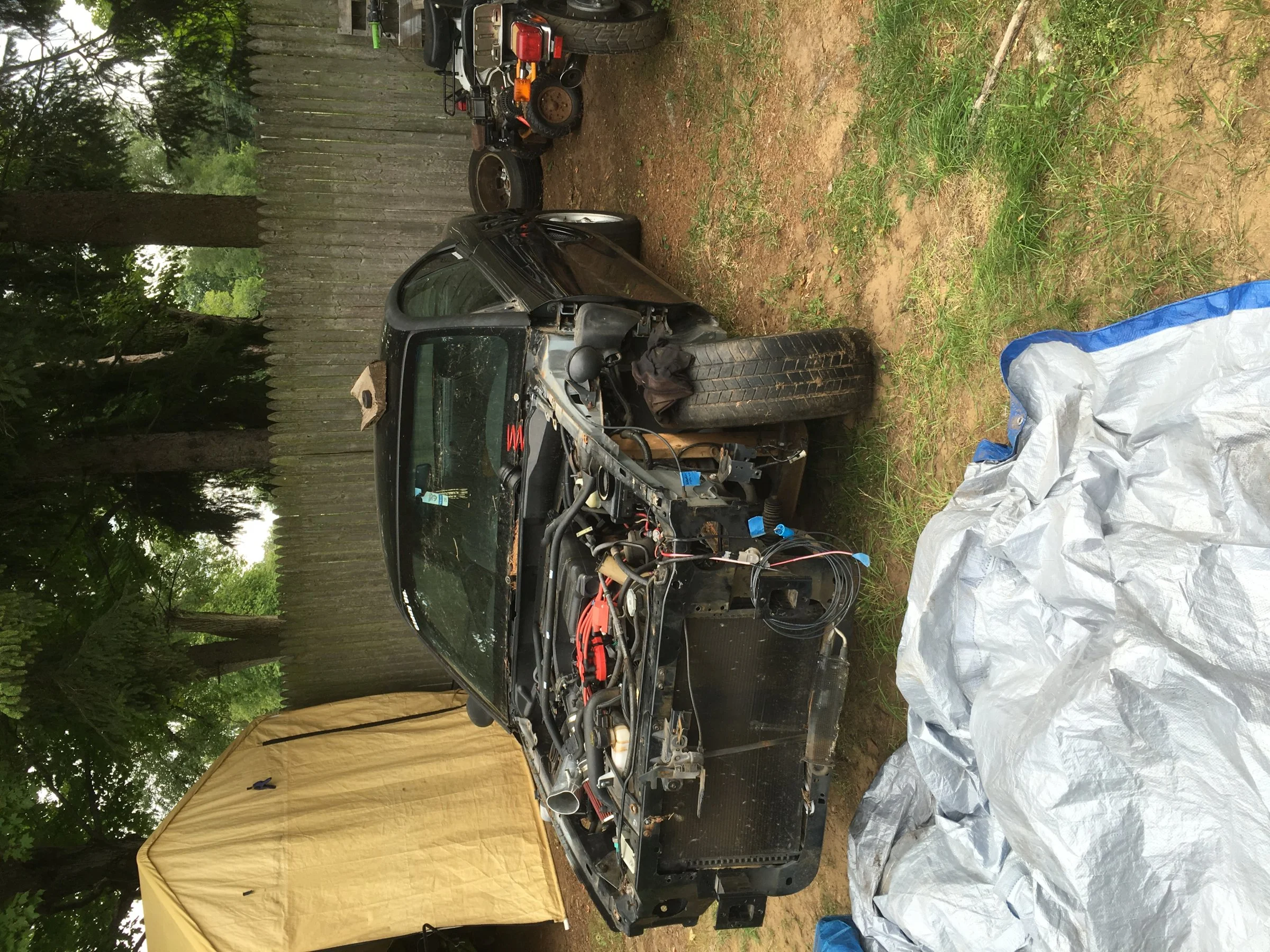

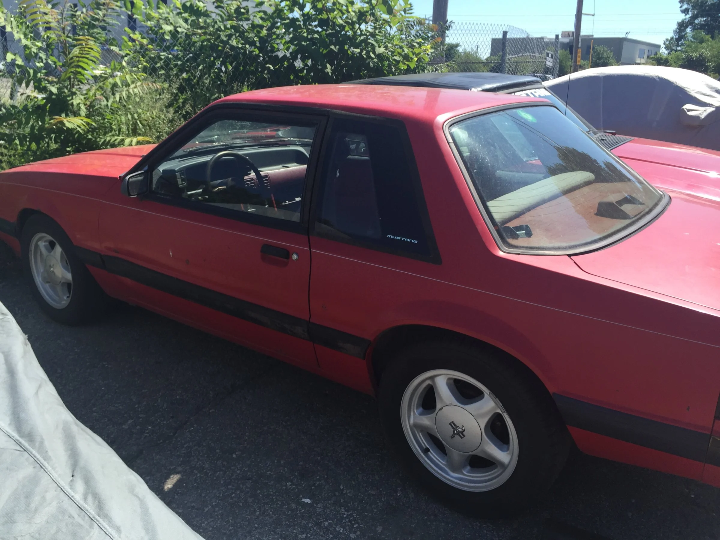

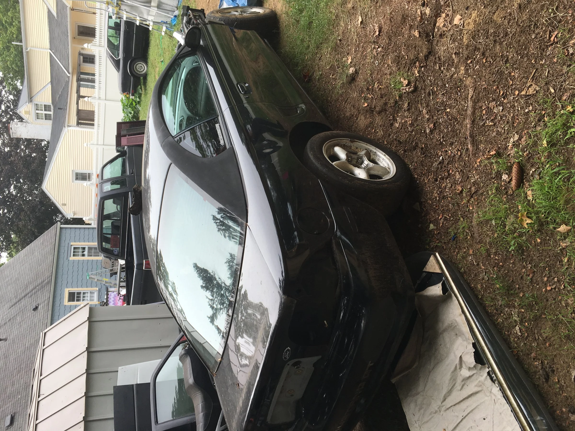

injust got a 95 sn95 mustang parts car complete pars car and I have a 89 notch that I want to swap everything into. I was told that the car has a 94 motor in it. Also when I bought my notch the car came with a 5.0 computer and harness for the engine bay. I am new to building mustangs but it has been somthing that I've wanted to do for a long time.

Hey man thanks for the response. My notch didn't come with a 5.0 v8 it had a 4 cylinder in it but the previous owner gave me an engine bay harness for a v8 so all I really have is what that 95 comes with. And I've never built a mustang before unfortunately, in my teen years I was into volkswagens so this is my first mustang. So most of what you said I don't quite understand lol it seems you know a lot about this though... would you mind texting me or emailing me?
