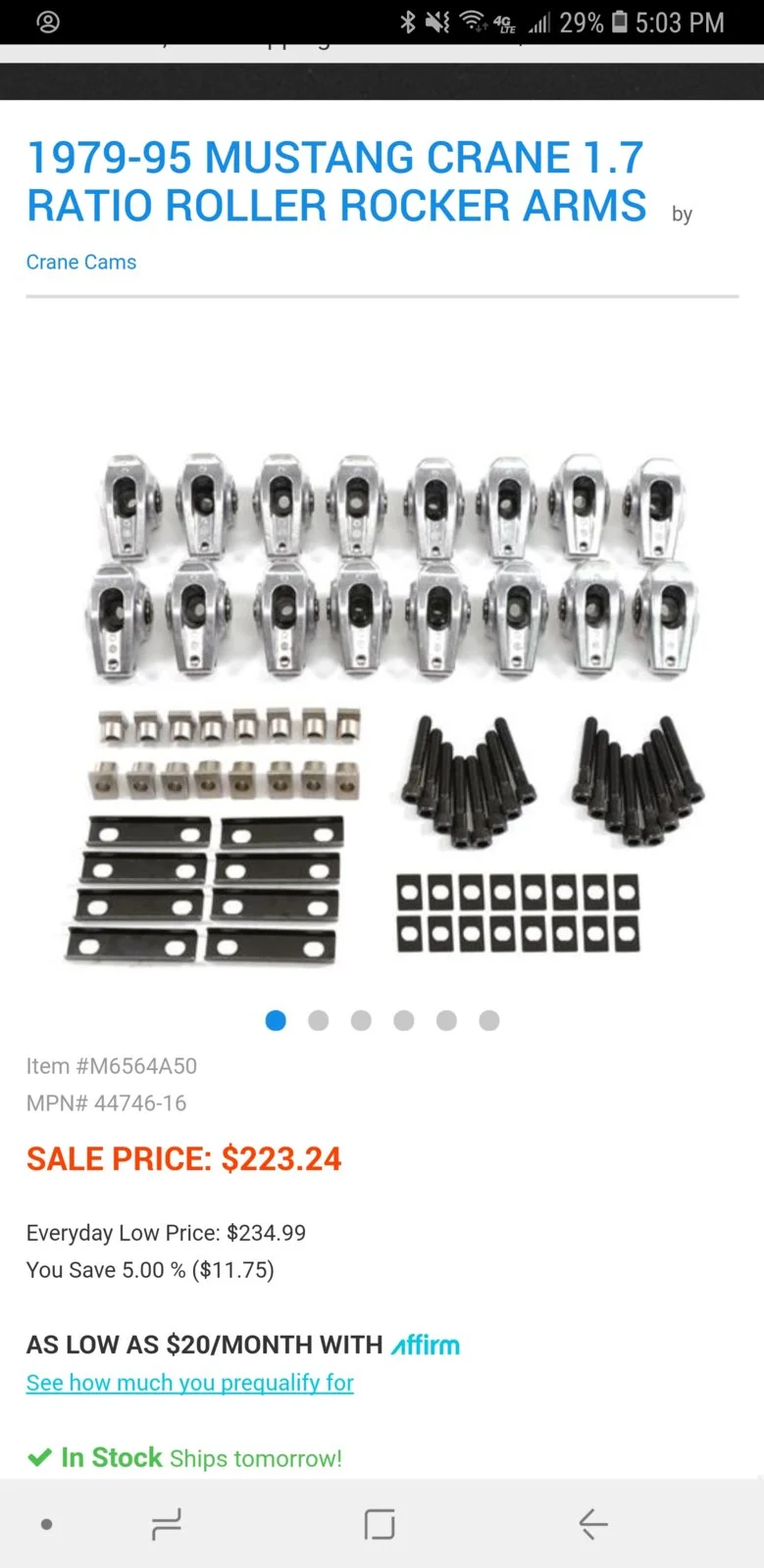

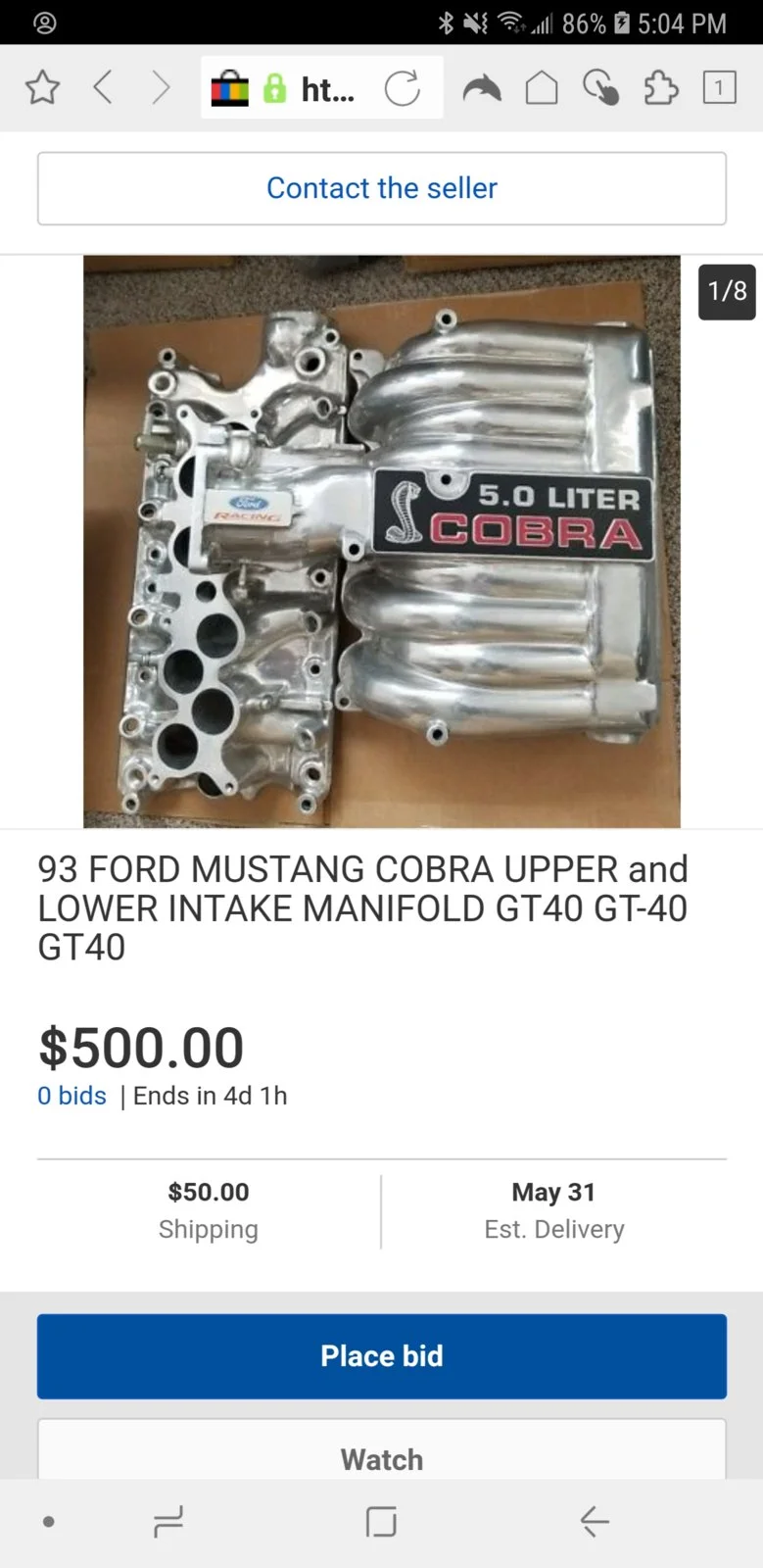

so...maybe do the intake , TB, Maf and the rollers?...no tune or anything afterwards?...I just want a fast street carThat's a simple way to pick up some power with a stock or aftermarket cam. Don't do it without replacing the springs on stock or GT40 type heads.
The original 93 Cobra used GT40 heads, a ford letter cam , those rocker arms a larger MAF , larger throttle body and 24 lb. injectors. It made a nice hot street combo with minimum tuning problems.
Match the MAF to the injector size and you should be good to go without a tune. The stock Injectors with a 70 MM MAF from a 94-95 Mustang is a good match.so...maybe do the intake , TB, Maf and the rollers?...no tune or anything afterwards?...I just want a fast street car
