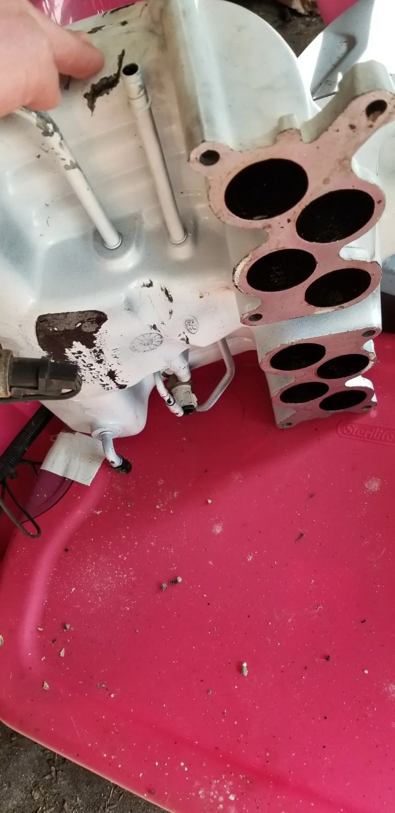

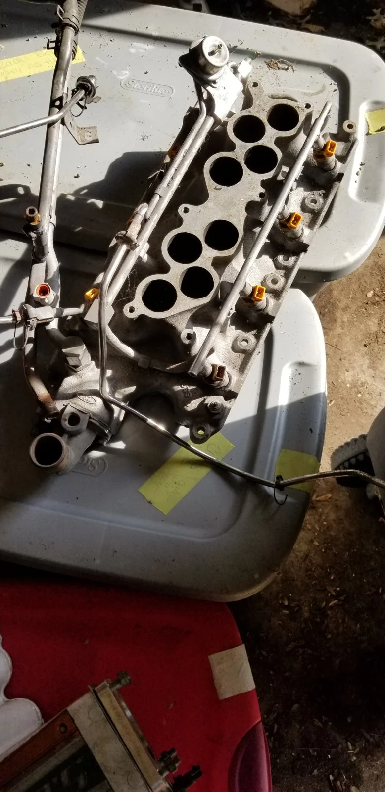

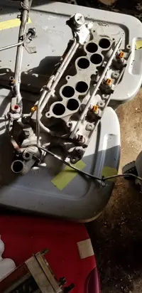

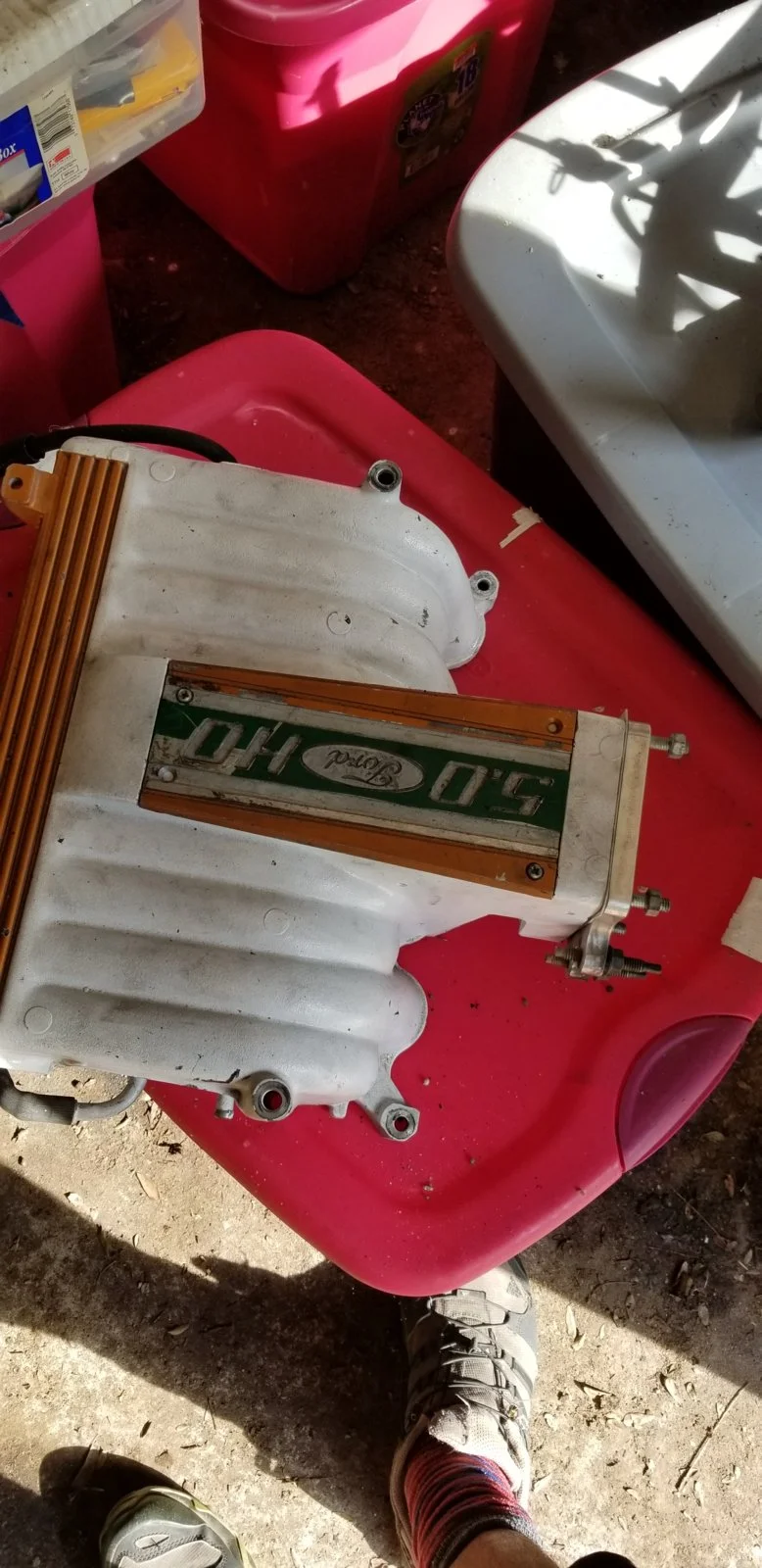

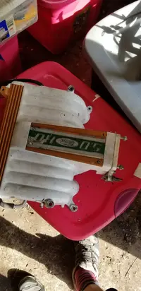

is this what I should have?...bought it a while ago....just didnt know when I should put it on...since I put new headers and a midpipe on... would now be the time to do it?

Definitely install it. I run the Cobra version on stock heads with shorty headers and it definitely made a difference from 4k RPMs up. It will cost you just a little below 3k RPMs so if you still have the stock gears I would go to 3.55s or 3.73s as well.
what do u mean, it'll cost me rpms?...and there are 2 types of those....is that the right one I should have?
thanks
He means it will take a few lbs of torque away from you but gain you a good bump in hp... The intake manifold is the biggest restriction on the motor in stock form so ditch it and put your explorer intake on.
