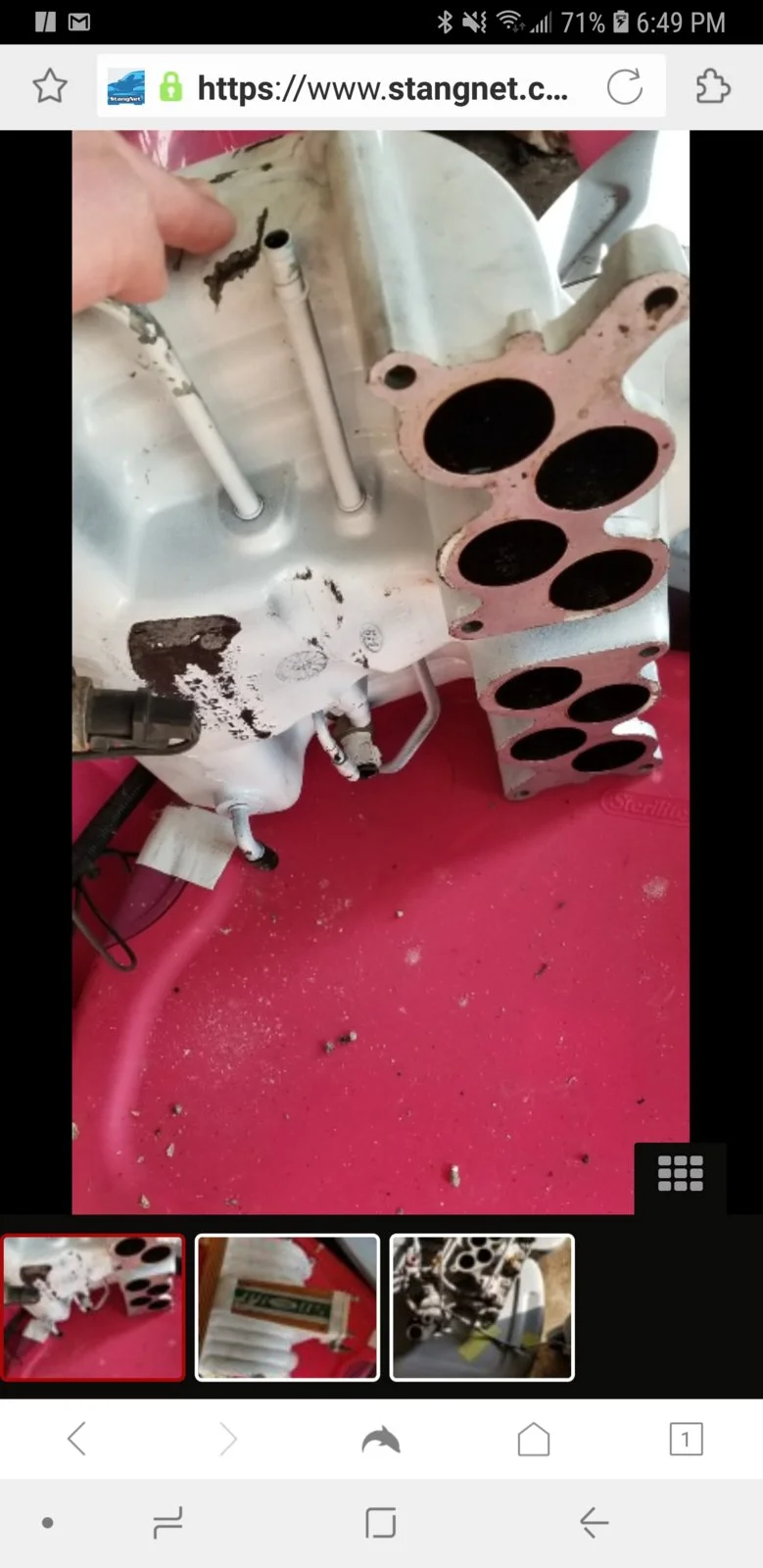

Oh and you have the wrong intake. Yours is the later Explorer version that does not have internal EGR provisions. It will work but you will have to eliminate your EGR.

is this what I should have?...bought it a while ago....just didnt know when I should put it on...since I put new headers and a midpipe on... would now be the time to do it?
....so that one will work?...do I need a new TB and MAF?....just all sorts of confused....sorry guys....just get confused when the EGR stuff is talked about....

As for the EGR stuff... Does this help?
Or maybe THIS for help guiding your decision on intake manifold.
