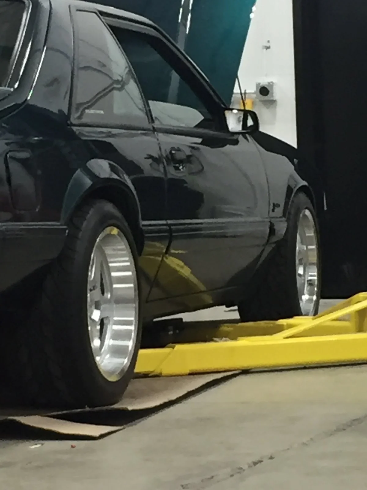

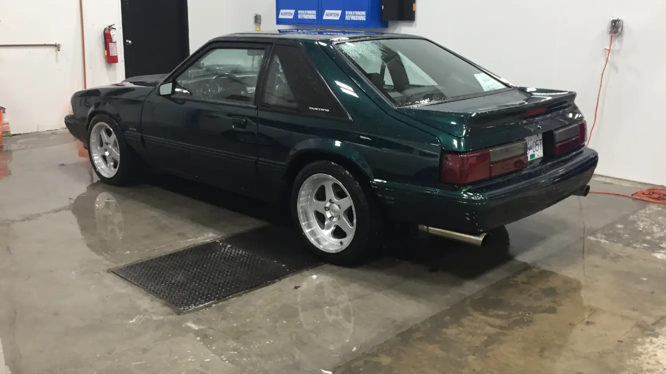

This is the usual question,been asked many times,i just did 5 lug and 4 wheel disk brakes,decided to go with 10" saleen sc rims in the rear with fox length axles, i ended up mounting my 275/40-17 bfg kdw on them,but i would like to see a little less stretch.I know the nittos run smaller,and some ppl mount 315s with minor work,i have my lip rolled already and im thinking of giving it a try but not sure yet.
My question is?,since nittos run smaller,what size should i get for the front?....i have bfg 255s now?....what size from nitto would be close to that?

ya i looked at all the specs,but each company has a different way of measuring them,so its still a toss up...but i ordered the continental 285s for the rear and 255s for the front,we see how they fit.,hope my lip is rolled enough already for the rears.
255's rub really bad on my car at full lock. I didn't try rack limiters though, may eventually look into them but really don't care enough yet.

ya,255s rub at full lock...need a couple rack limiters, a little less u turn ability,but super easy to install...
275 on 10.5 rims?...must have a bit of a stretch look?
