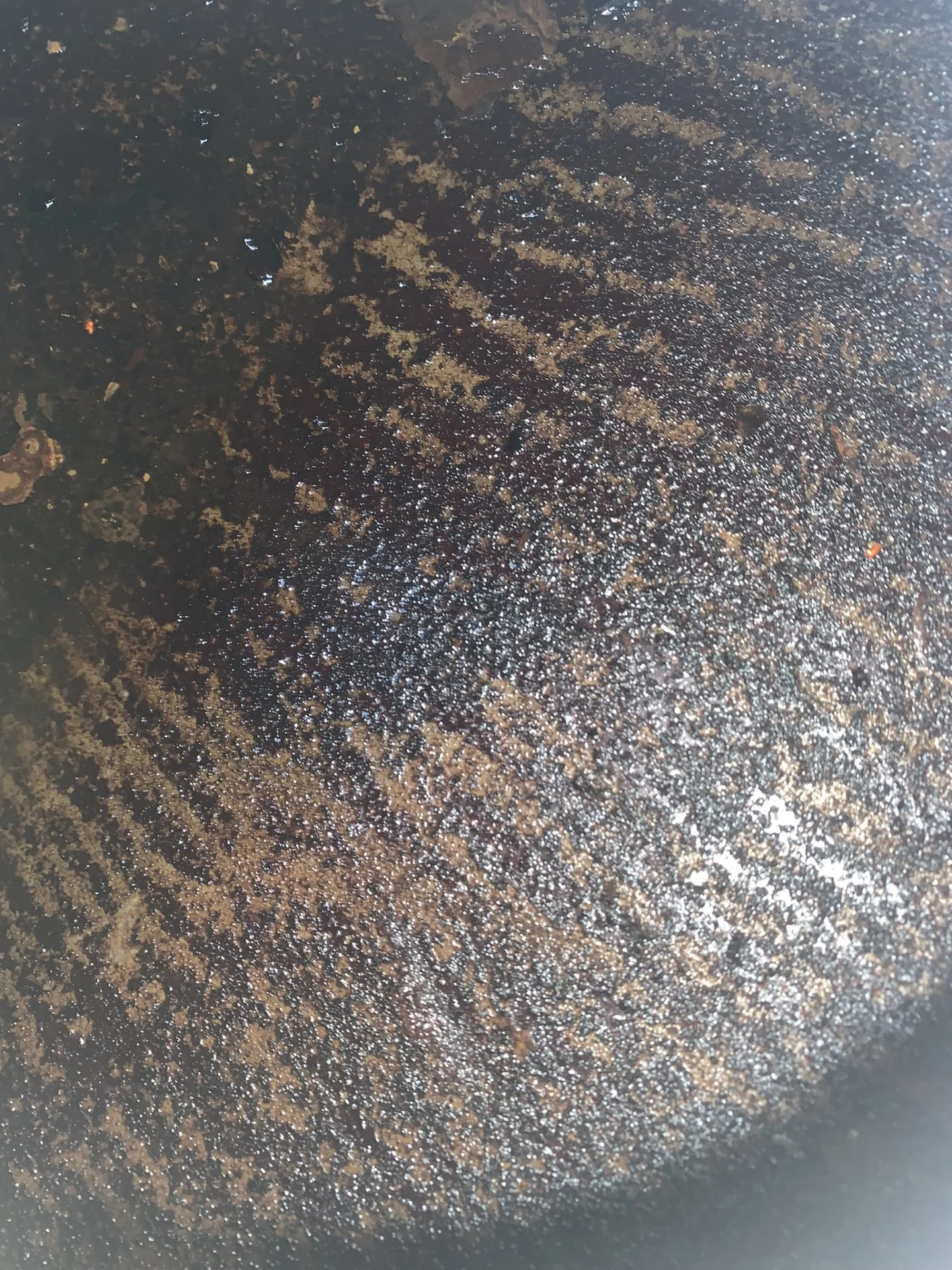

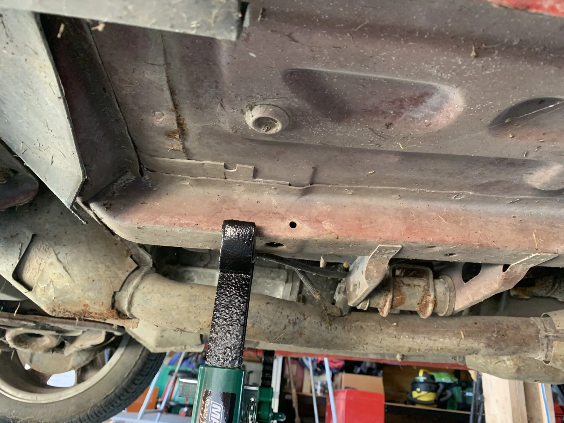

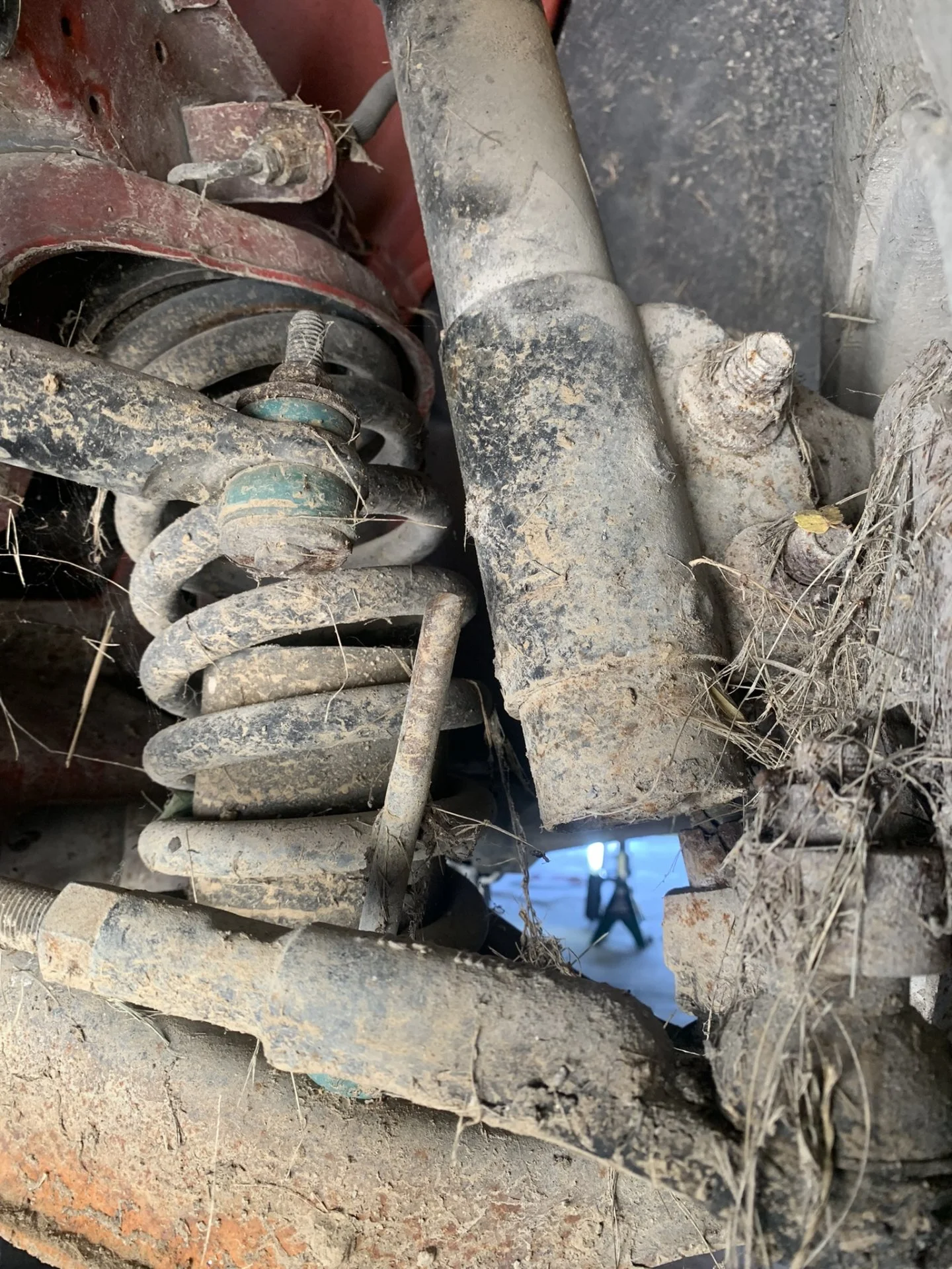

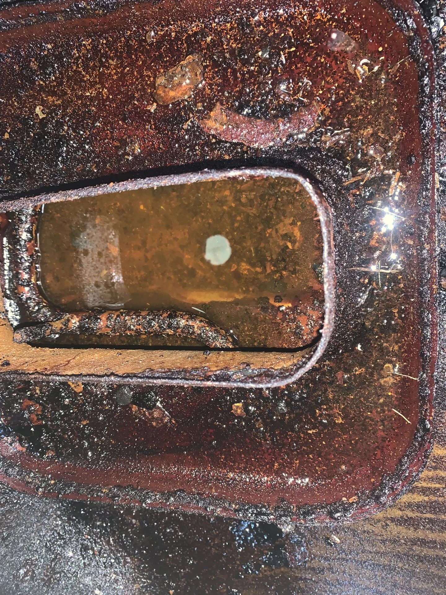

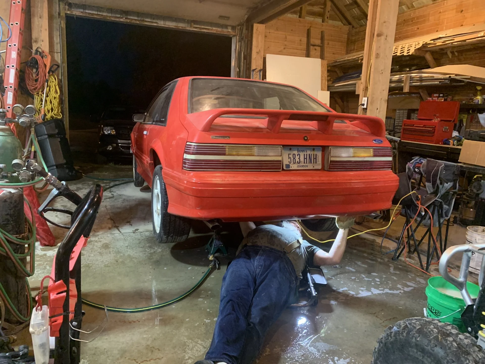

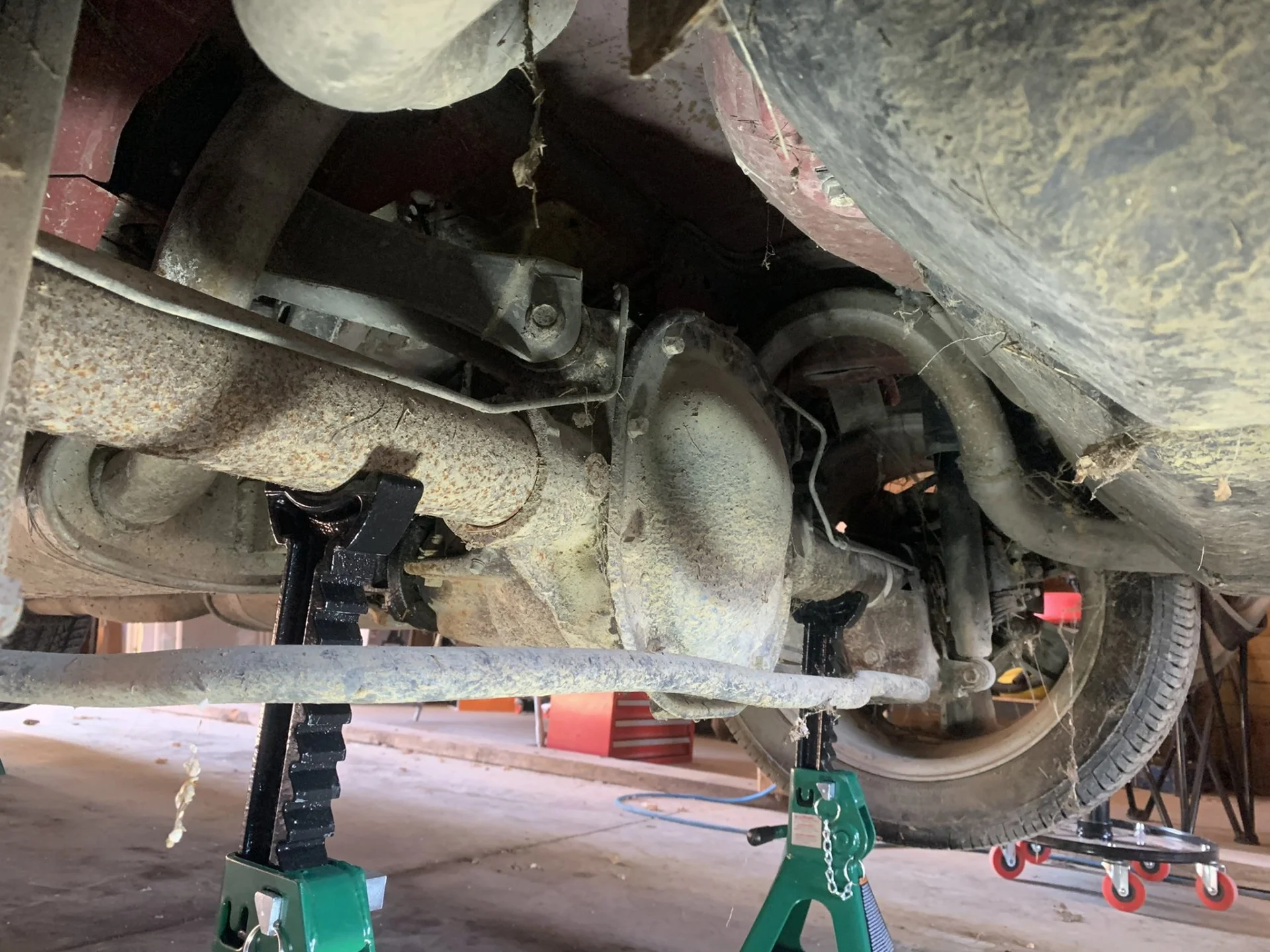

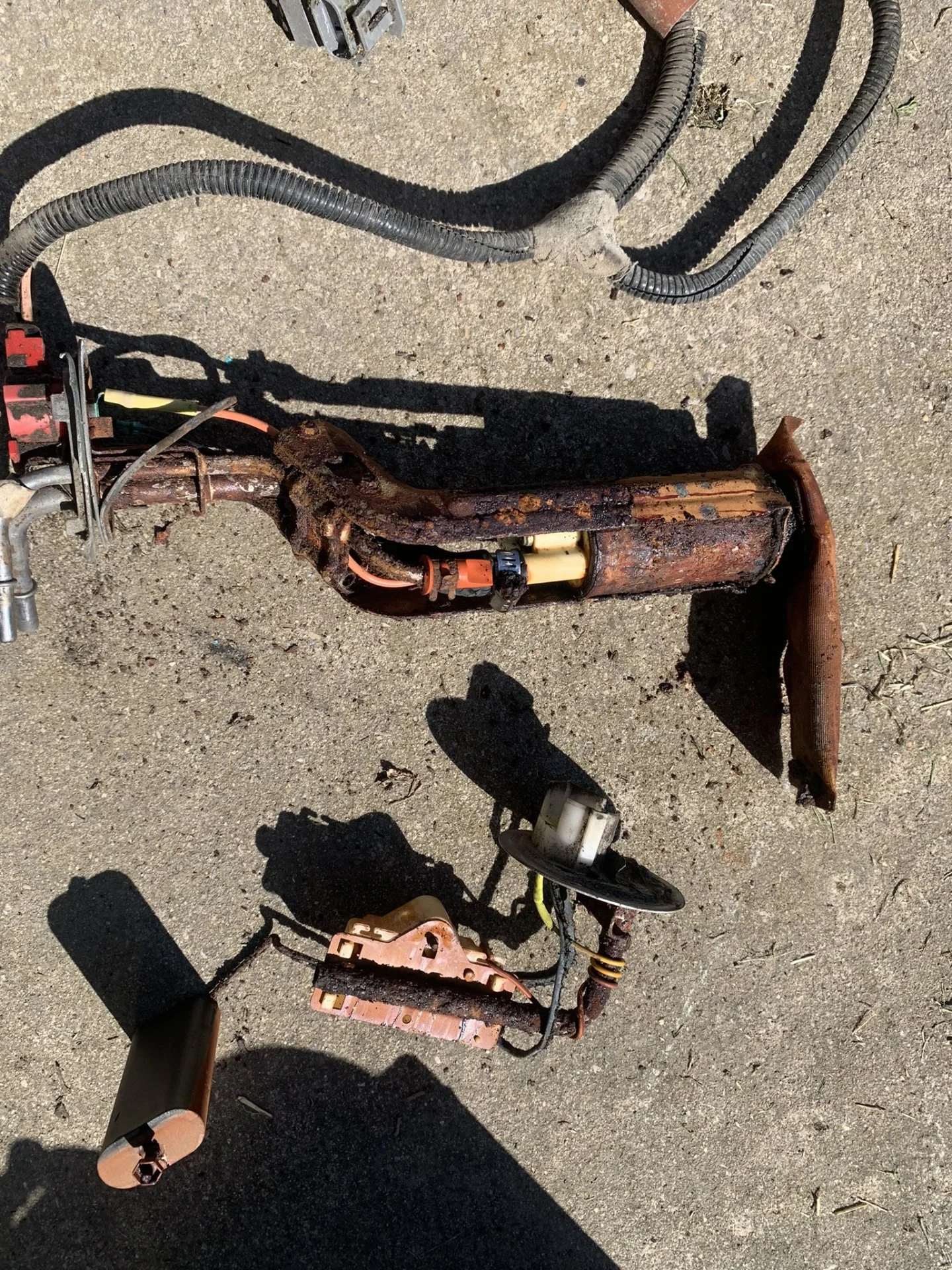

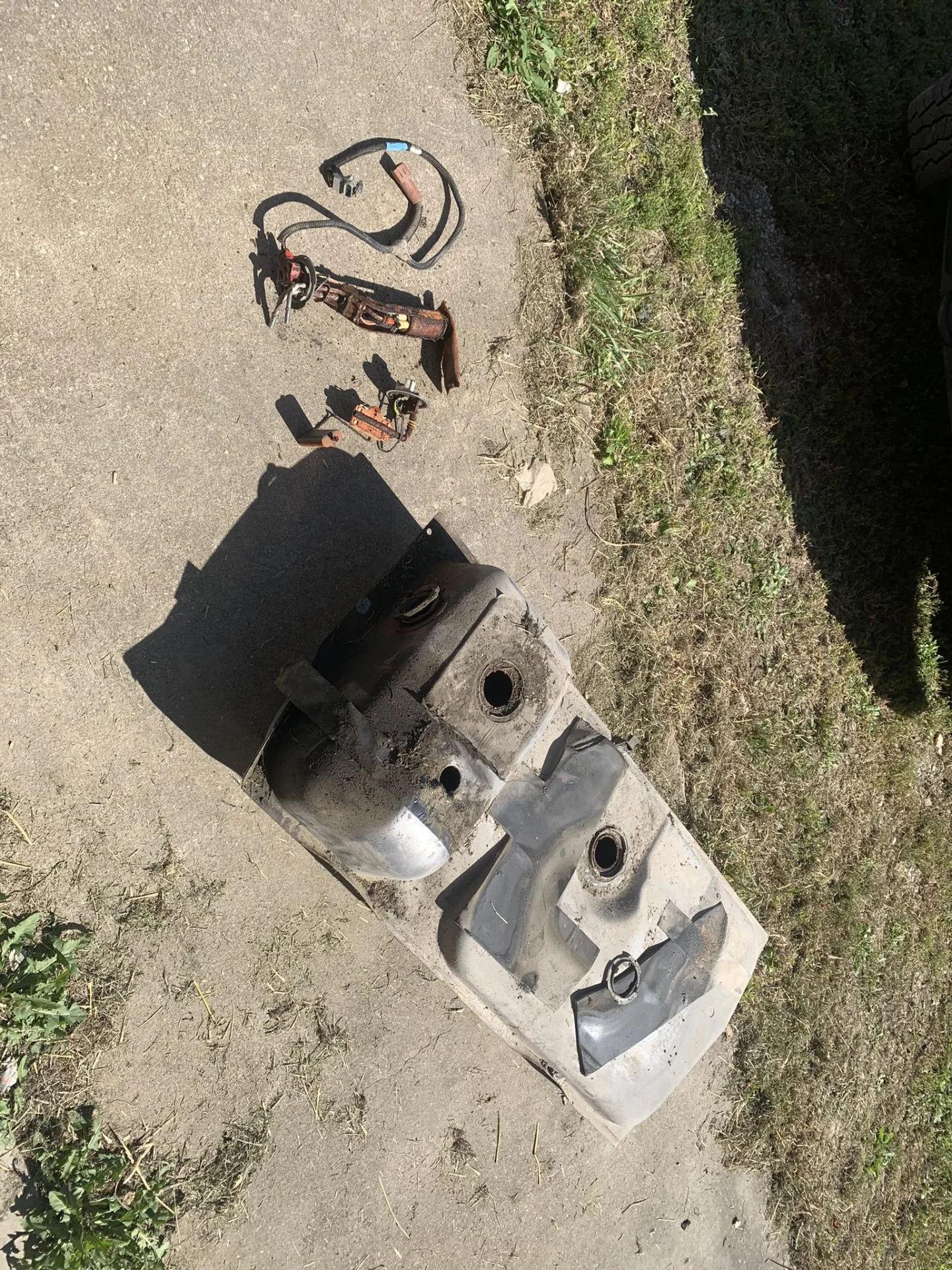

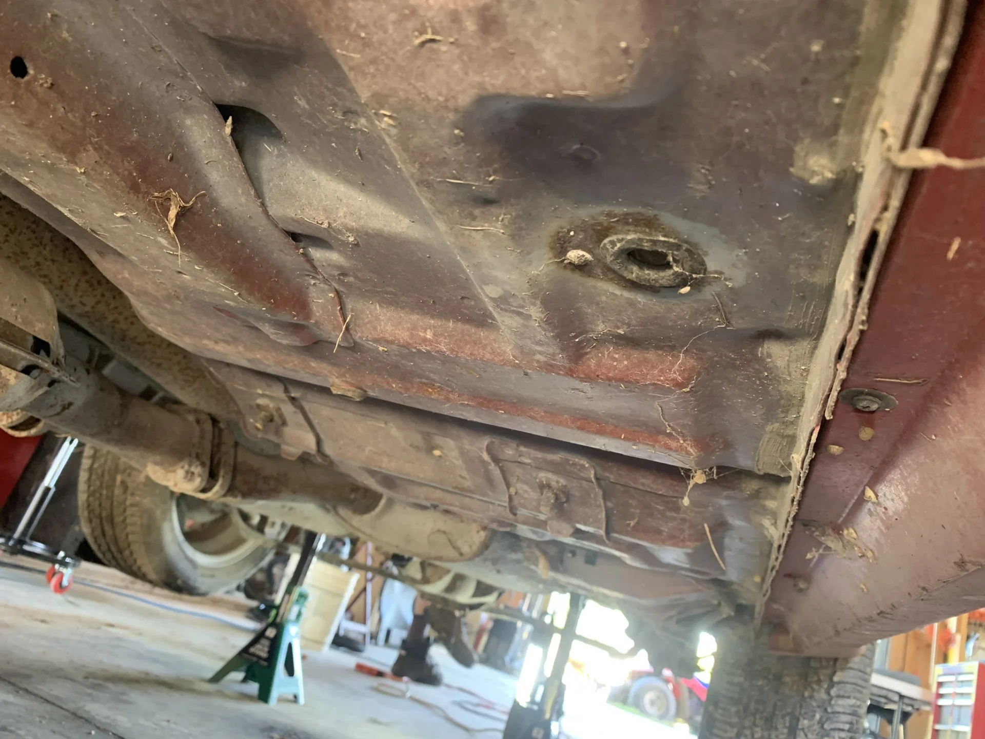

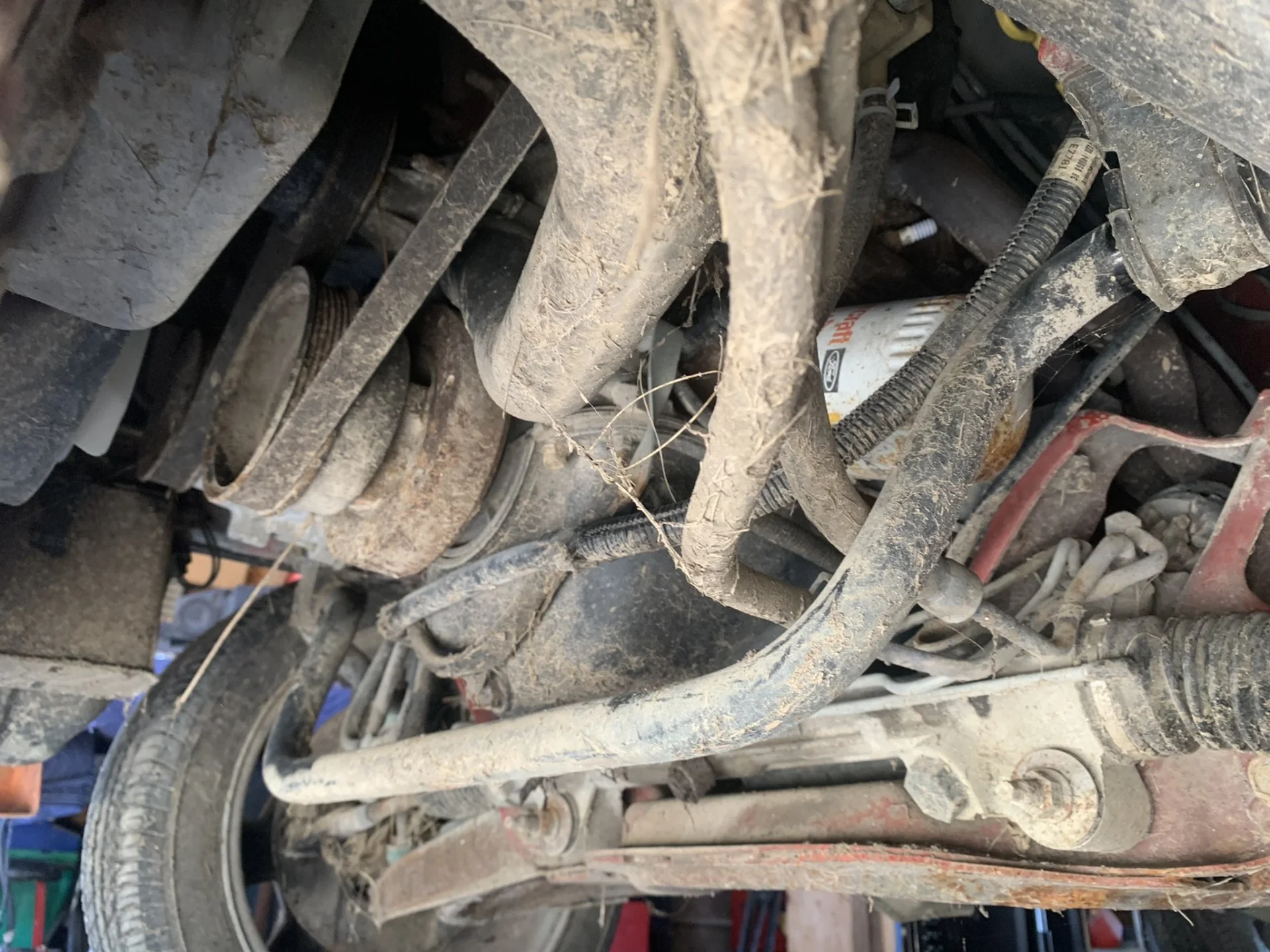

This morning we got the car on jack stands and dropped the gas tank. We also found a broken sway bar link so that has been added to the list. It came out pretty easily, spilled a little gas but some kitty litter took care of that. The gas left in the tank was NASTY and bright orange, lol. As expected the tank and everything is rusted and I’ll be ordering a new tank kit that I’ll post about later.
The under side of the car looks pretty good but I’m going to spray off the under side of it.
Here’s the broken sway bar link
A look underneath the car
Here’s a look at and in the gas tank.

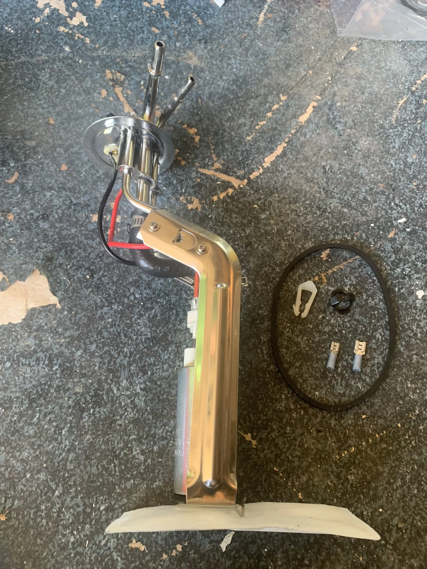

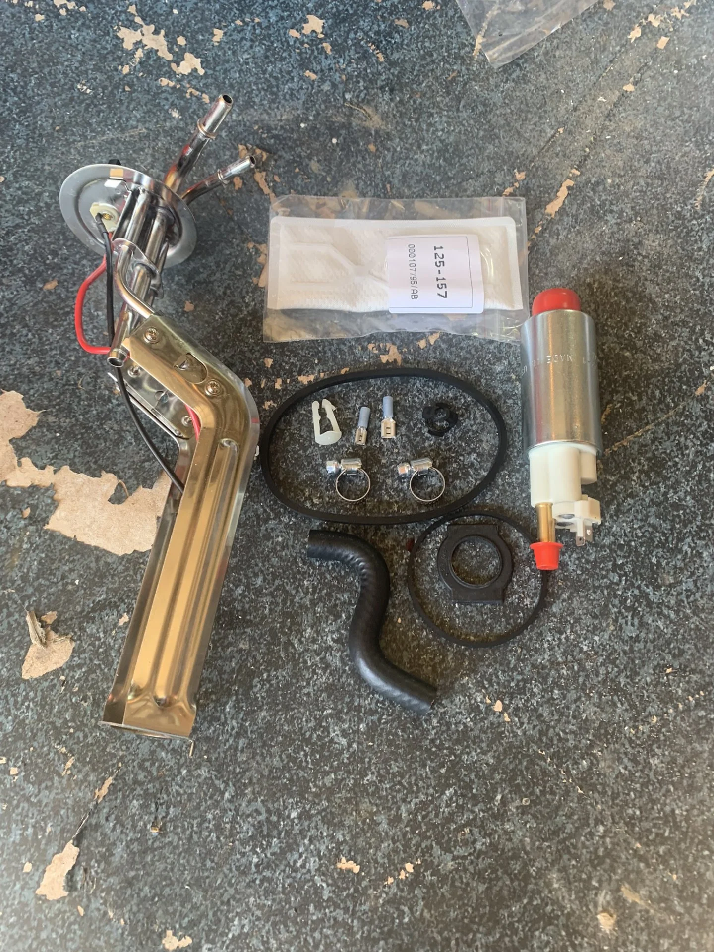

Spectra Premium tank
Walbro pump
Ford Fuel filler grommet
Spectra hanger
A 255 pump is kinda large for a stock-style fuel system. Do you need that much flow? A 155lph is plenty adequate for most N/A builds.
There are draw backs to running too big of a pump. The return leg/regulator need to be able to pass enough fuel to not impose a restriction that could lead to inconsistencies in the fuel delivery. For example. when running at idle, your return line may be too small for a 255 causing a slight pressure buildup. You adjust the pressure using the Adjustable FPR to allow for more flow through it, but what you are really doing is adjusting flow based on the downstream restriction combined with the FPR setting. At WOT, your engine is now consuming more fuel that previous, so that restriction is gone and your FP will decrease slightly from your set point.
Because of this I tend to recommend sizing the fuel pump based on your needs to give better consistency in pressure. Every combo will be different however.
Stock or bolt on 93 Cobra? 110LPH or 155 is more than enough.

Thanks for the advice, I got a 155 lph pump and all the rest ordered. Hopefully everything gets here by the weekend.

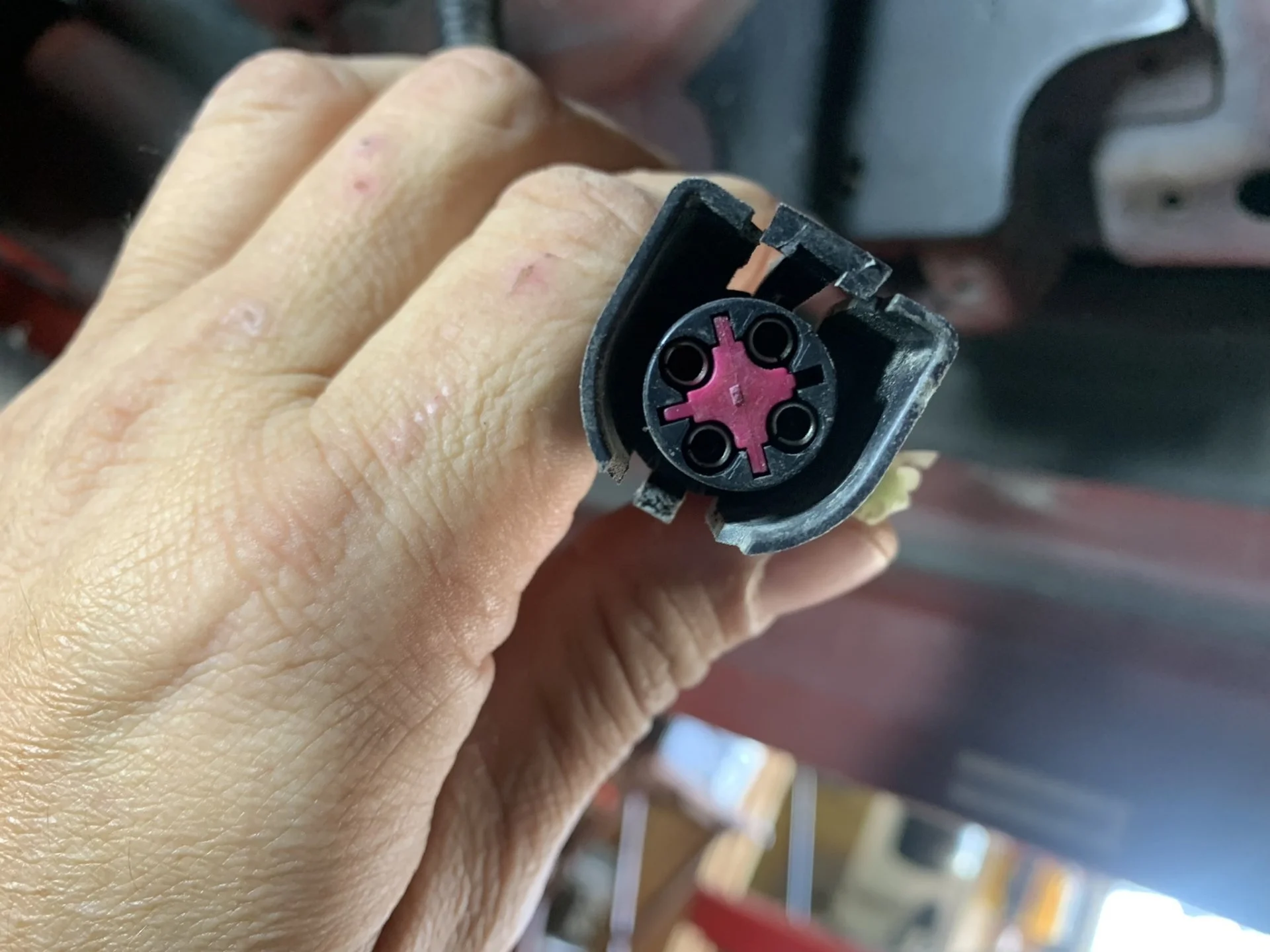

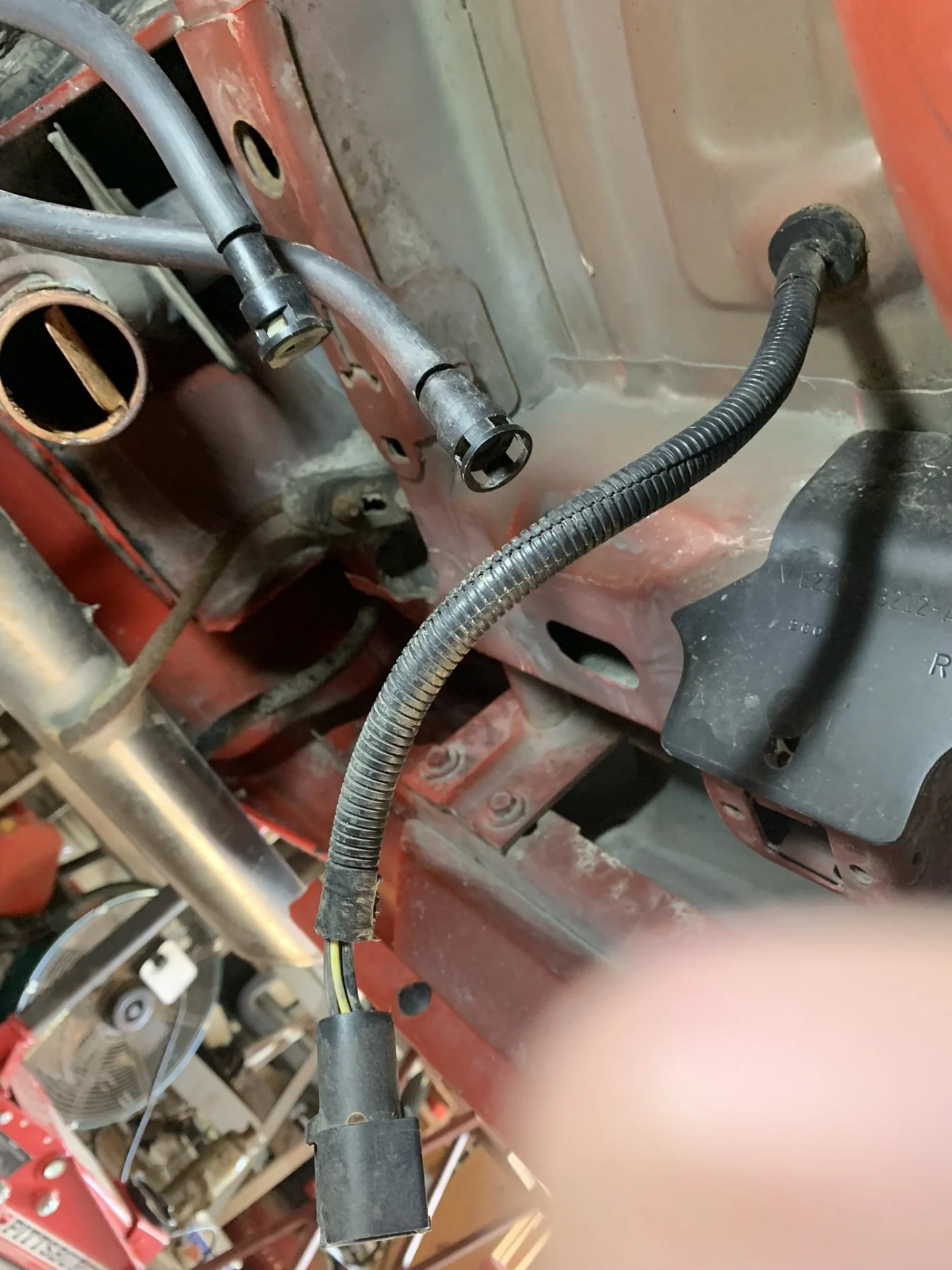

Looking things over tonight I realized we must have broke one of the clips on the plug that comes from inside the car. Looks like it comes from the crash switch/reset inside the car goes through the floor and connects to the fuel tank harness. I don’t real want to use the old zip tie solution and was wondering I can get a pigtail for that and replace the plug.

LMR sells the pad kit, maybe that connector too?
https://lmr.com/item/LRS-9002B-K/mustang-fuel-tank-seal-kit-82-97
Reactions: 93FoMoCo

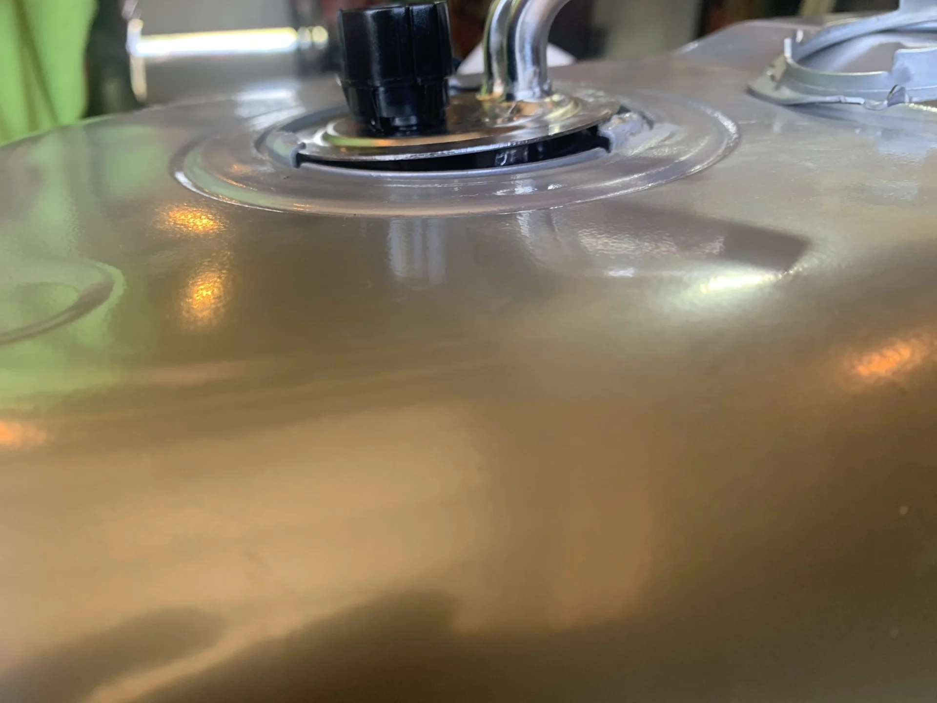

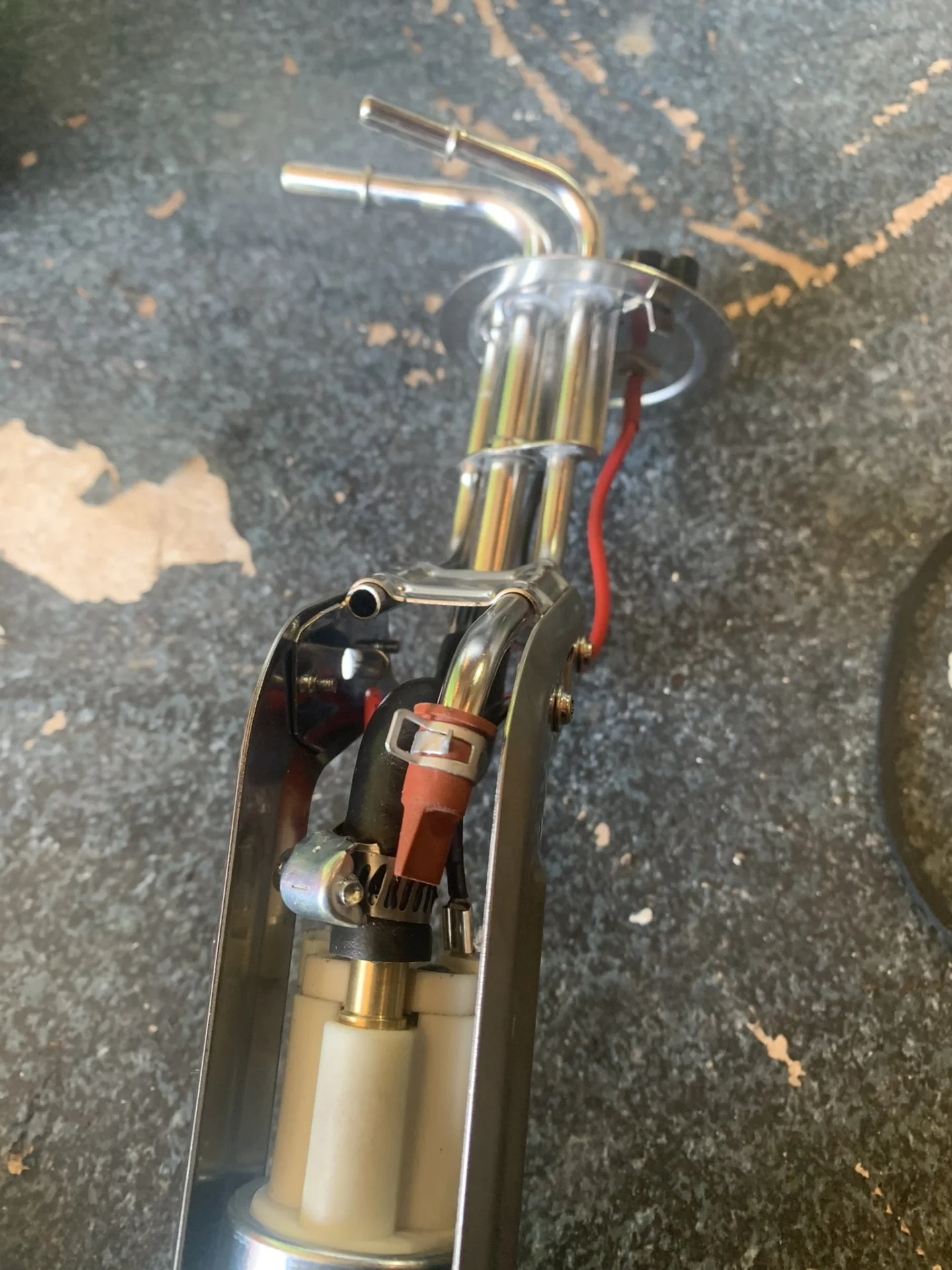

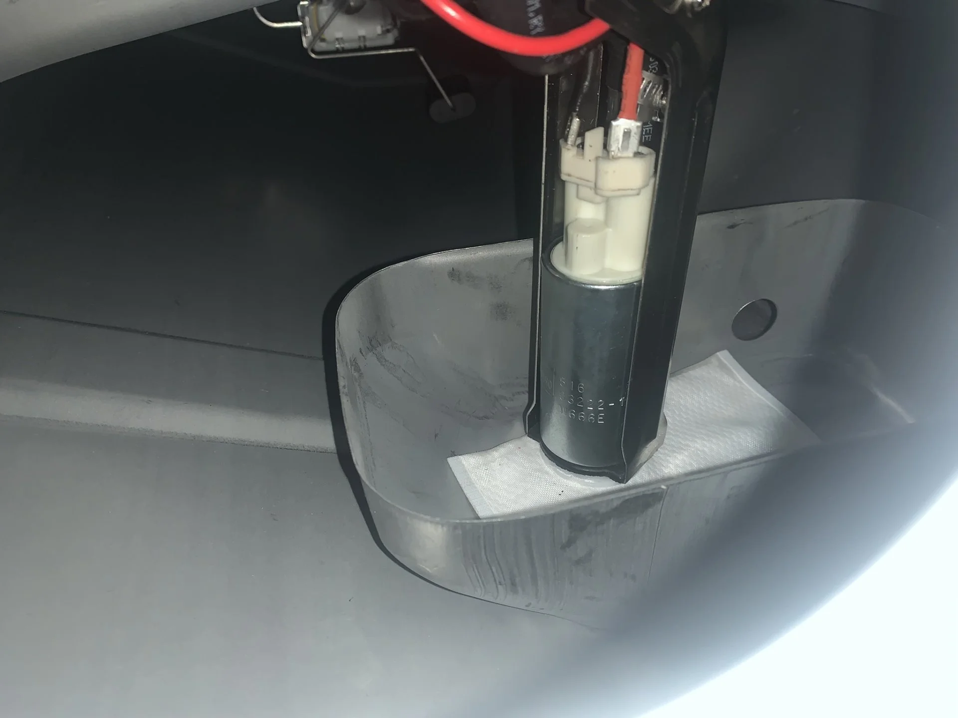

So I ran into a problem. If I test fit the fuel pump hanger without the fuel pump in it, it seats on the fuel tank. When I have the pump installed with the sock on and oriented the correct way it won’t seat. It seems like the whole assembly is to long. Any idea on what I’m doing wrong?
General karthief
Mod Dude
Aug 25, 2016
28,048
10,671
213
polk county florida
Oct 10, 2022
#78
  • Oct 10, 2022
  • #78
Is the bottom of the tank pushed up a little?
Mustang5L5
Mod Dude
Feb 18, 2001
43,324
18,049
224
Massachusetts
Oct 11, 2022
#79
  • Oct 11, 2022
  • #79
Where is the hanger hanging up? Is the botton of the tank dented up a bit? You can use a sturdy peice of wood to knock that part of the tank down a tad. I've also seen the baffle spot welded slightly off which causes some interference

Hanger may just be off a little. If massaging the bottom of the tank downward doesn't fix the issue then I would remove the four screws holding the lower section of the pump bracket to the upper section of the pump bracket, remove the tabs that are bent inwards, drill four new holes on the lower section that are high enough to get the hanger to seat in the tank, reassemble, and call it a day.
