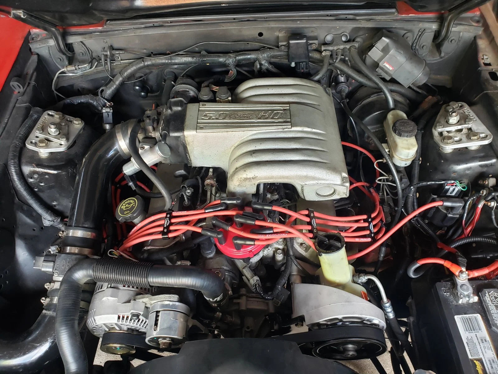

Power steering pump completed. Man that pressure hose into the steering rack was a pain but I got it done. I also did my spark plugs, wires, and the cap and rotor too. I just tried to start it and it wouldnt turn over. I saw a trouble shooting thread which I'm going to try and follow tonight.

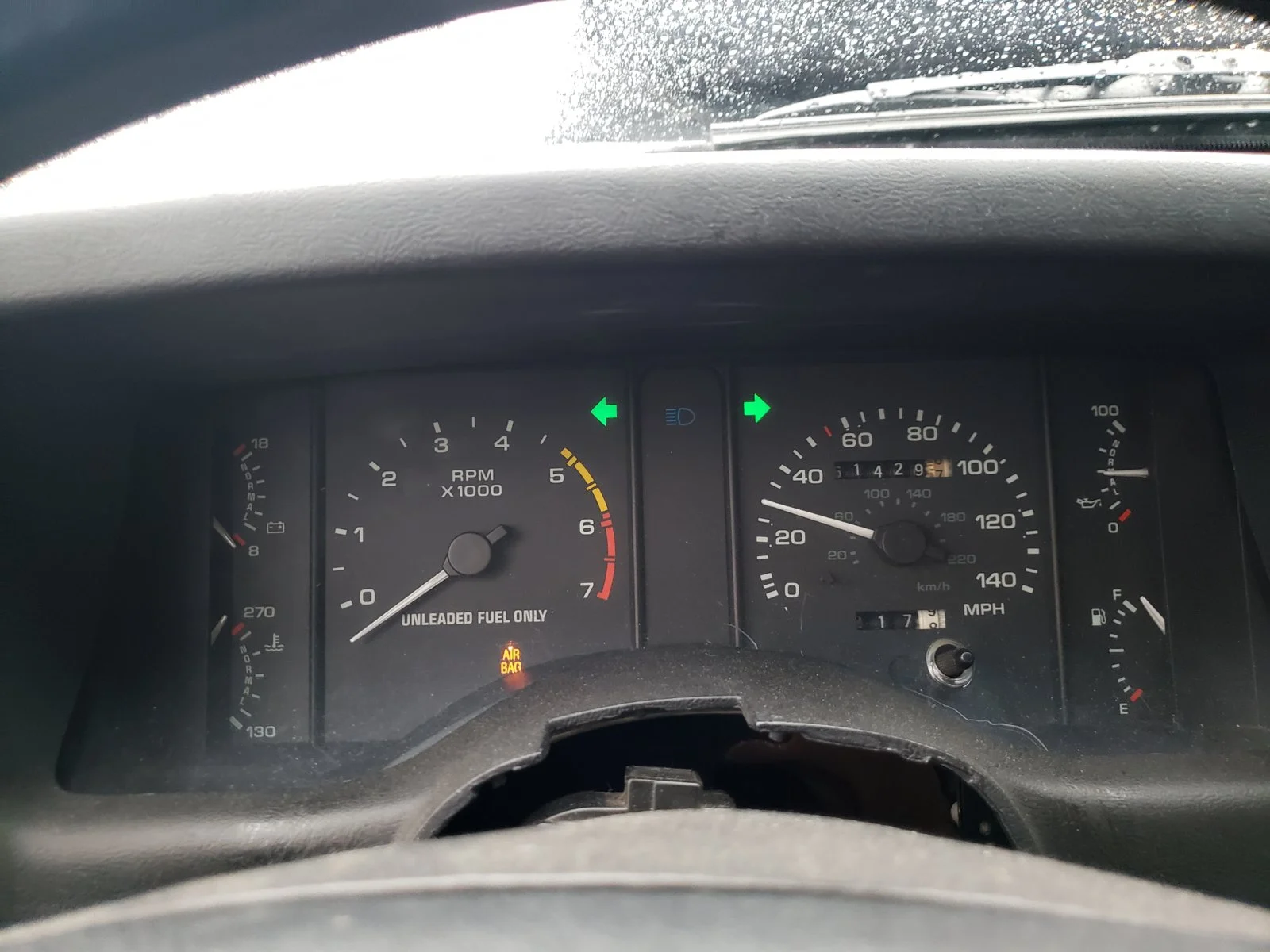

Spoke too soon. Was driving home and everytime I hit a bump the gauges would act up and bounce around, then they stayed flat like this. Anyone know what would cause this? (Pic taken while driving)
Update. Ran the car today with no issues. I checked the engine block ground and it was still secure. I checked the ignition switch and it was solid, some of the wires I might need to redo though. I even ran the car and wiggled the ignition switch and wires but nothing happened. Hit a few bumps in the road and the gauges were fine. So I'm still not sure what caused it. But I'm thinking maybe since it was raining pretty hard the water was effecting something?
Edit: started happening again with no rain so I checked the grounds again and lo and behold one of the grounds above the headlights was so loose it popped off when I touched it. So basically every time I hit a bump it would pop off.
Both lights being ON to me means either the hazard wiring to the switch in the instrument cluster bezel or the Hazard flasher
What's weird to me is it all happened together, the gauges acting up and the hazard lights. I have a ton of wiring to redo though. Previous owner used a ton of electrical tape and didnt do a good job of covering exposed wire.

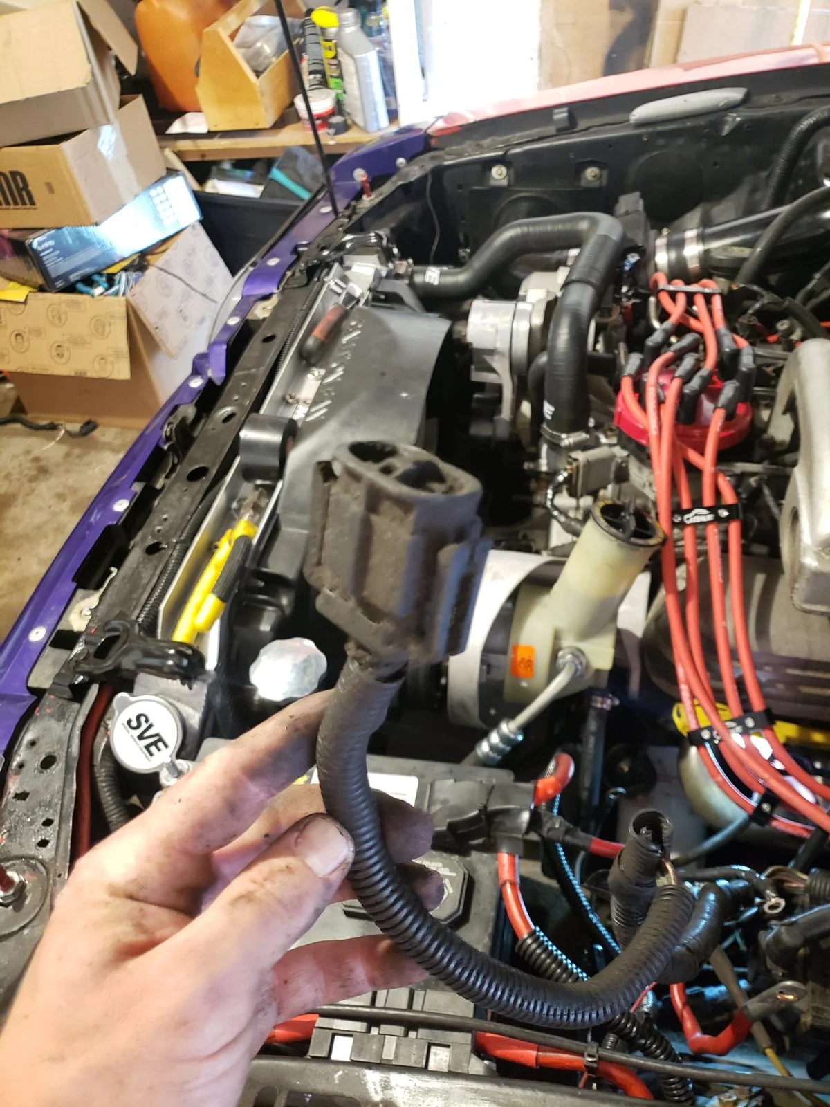

Saw some more wiring that needed some attention so I decided just to address the issues and do a wire tuck. I think I asked what this connector was before and someone told me daytime running lights for Canada cars, if I remember correctly. Can i just cut this connector off and tape it up so it's easier to do the wire tuck?
If you are going to tuck everything, why not just tuck it in tact, rather than cutting it? Can’t be much harder to tuck one more connector!
Yeah I guess I can just tuck it too. That plastic connector at the end it pretty big which is why I was thinking of getting rid of it and since I'm never going to have a use for it.

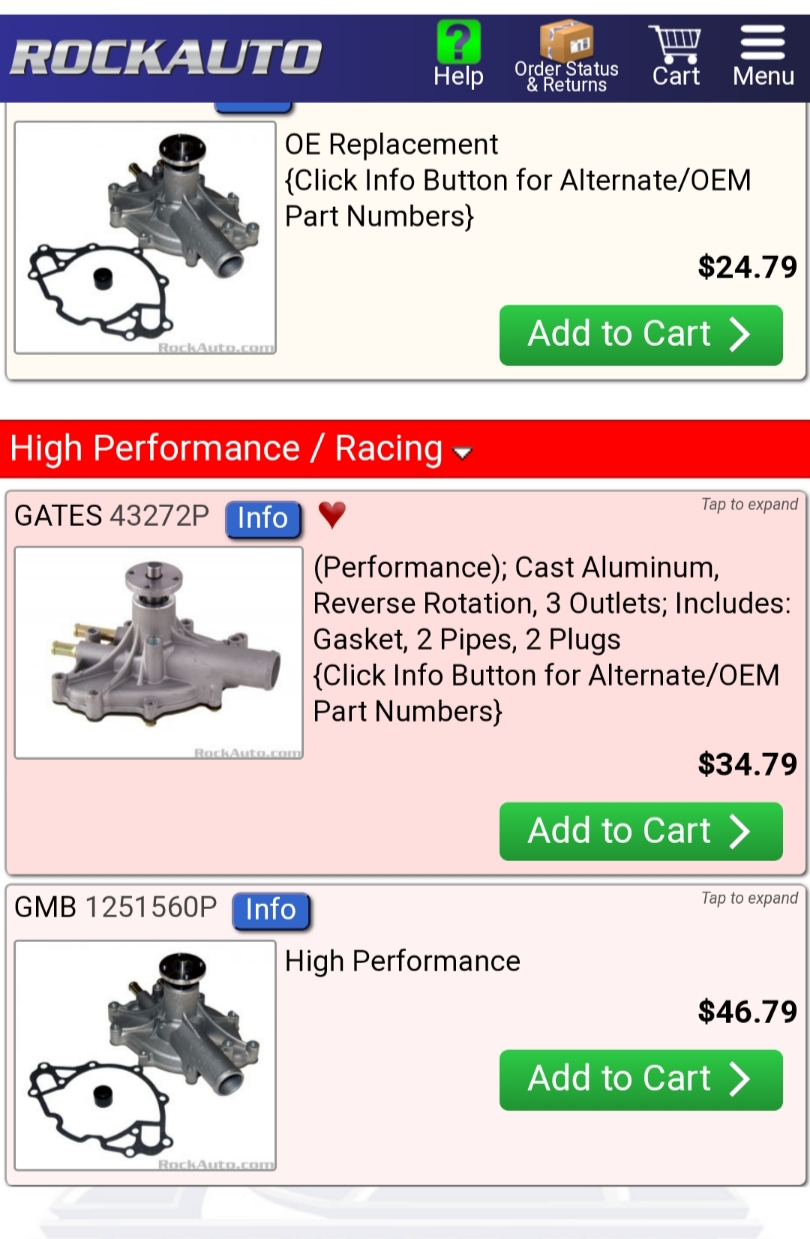

I'm having some issues while idling for a few minutes like sitting in line at a drive thru, the temp starts creeping up. I did a little research and some people suggested it might be my water pump that needs to be replaced. While looking up which new one I should get I saw ones that said "heavy duty" and I see this Gates one that says "high performance/racing". Is there a difference?
