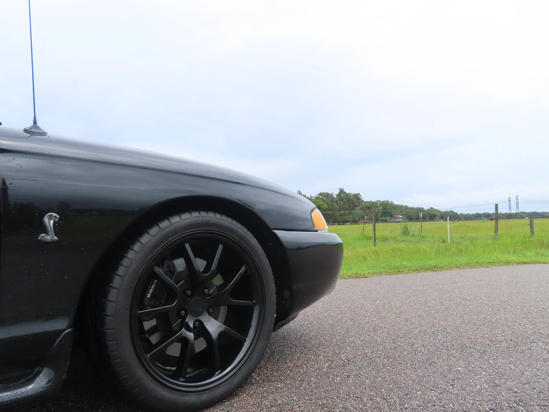

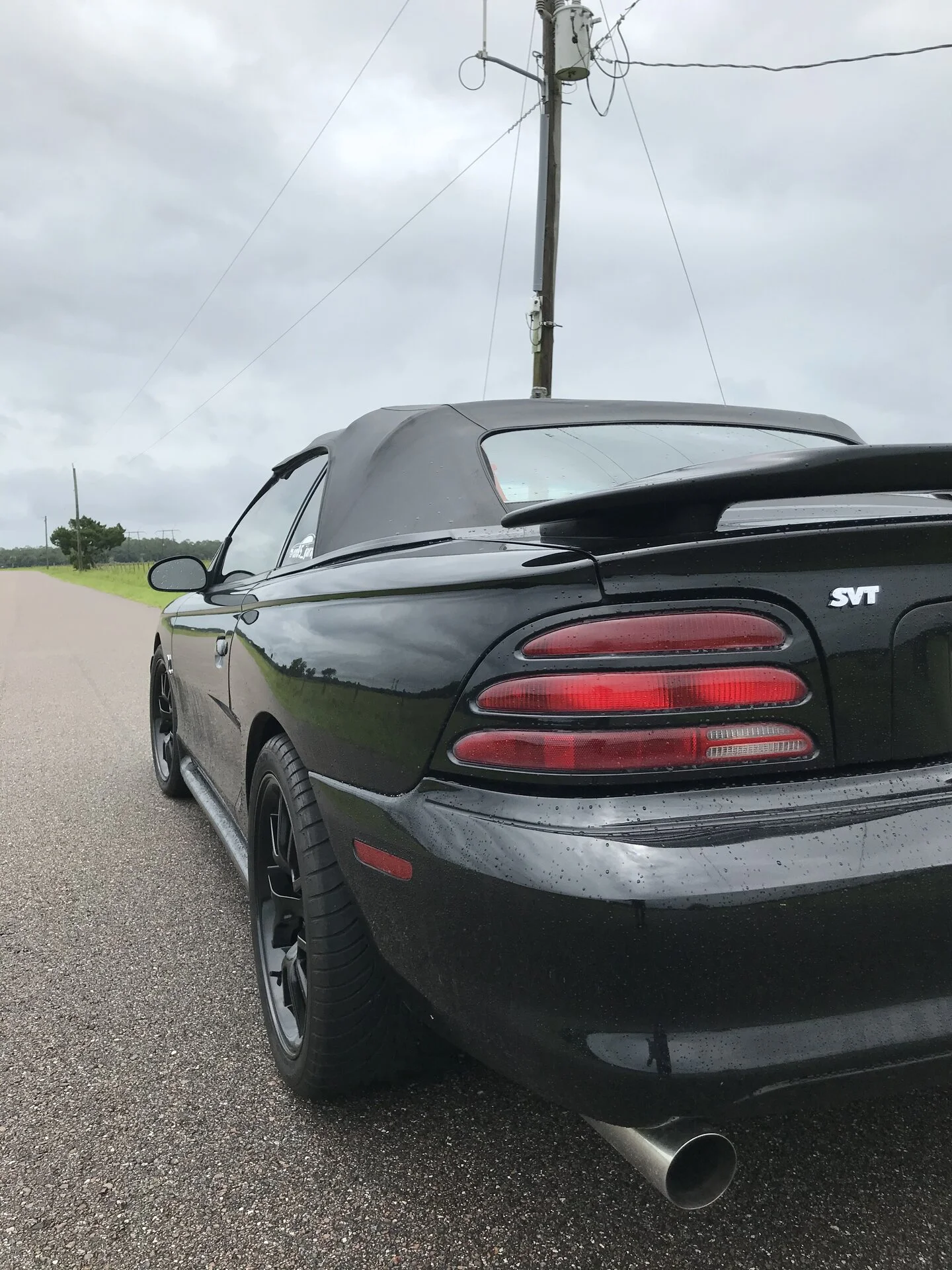

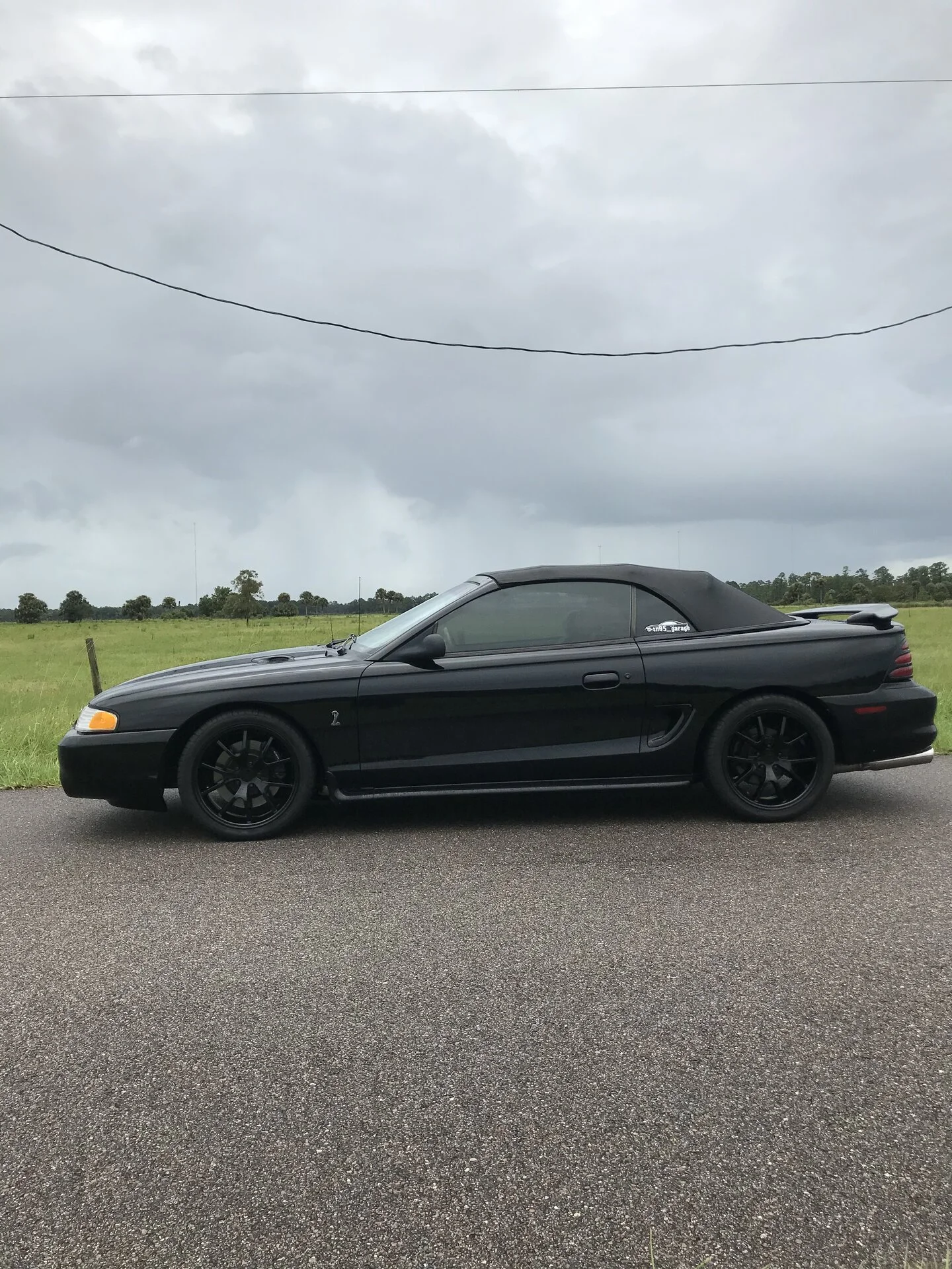

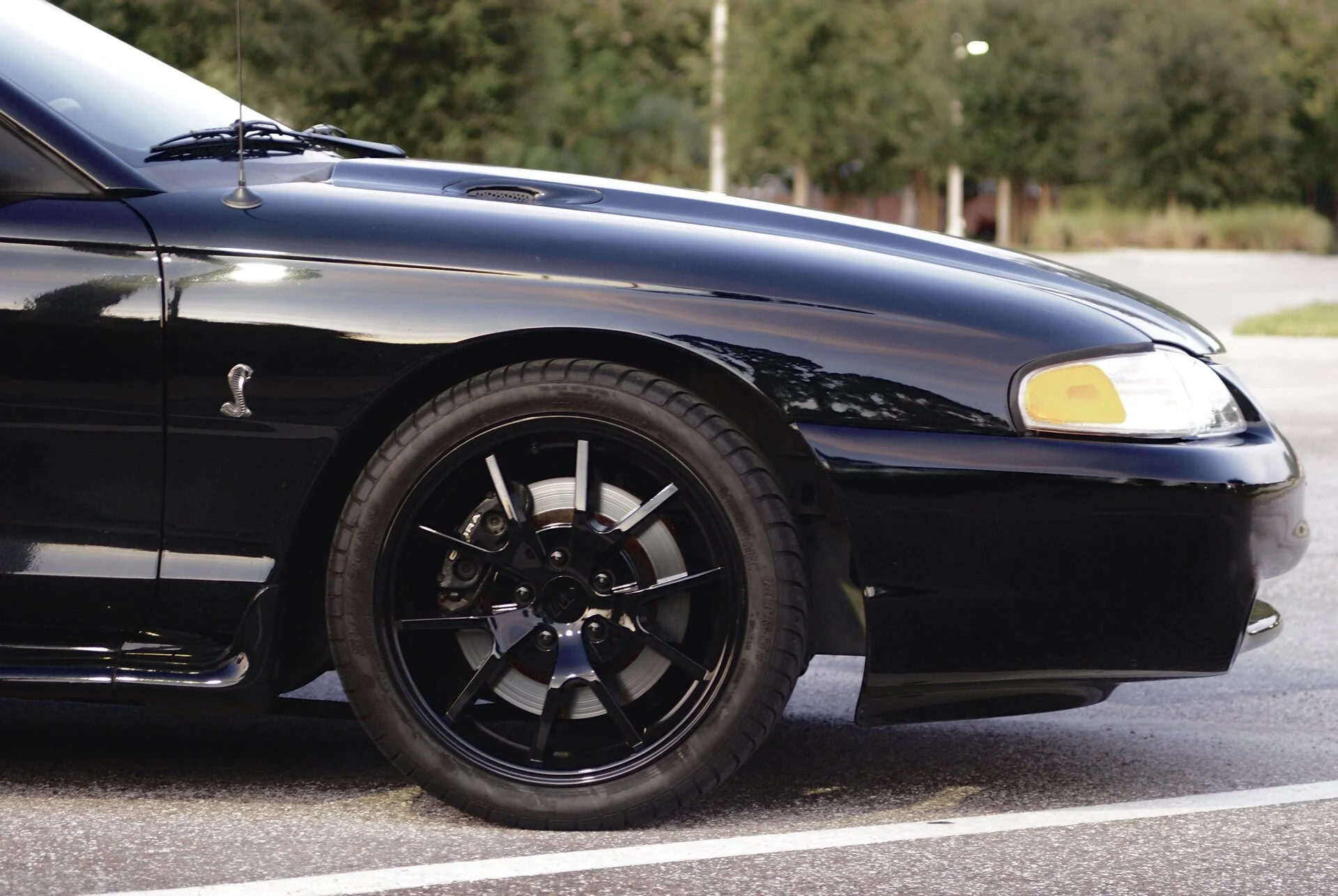

Here’s some pics mounted. I have to say the ceramic coating on these wheels really boosted the gloss and no dirt or water has stuck to them through this “hurricane”. The tires are the best improvement being a 275 summer square setup. The car has so much more grip through turns and hooks right up.
I don’t mean to take away from your excitement, but in my opinion the car looks better and more “special” with the factory wheels. With those wheels, it looks like any other SN on the road.
That being said, if you’re able to enjoy the car more with the new wheels and tires, rock on! :rock:
I know where you’re coming from and I agree with you to an extent. My cobra wheels needed new tires and these popped up and for the price I couldn’t pass. I plan to switch between the two often as you rarely see a cobra on stock wheels. I just wanted a little change for now. Stock wheels are stored next to the hardtop and will still be utilized often.
Reactions: 95BlueStallion

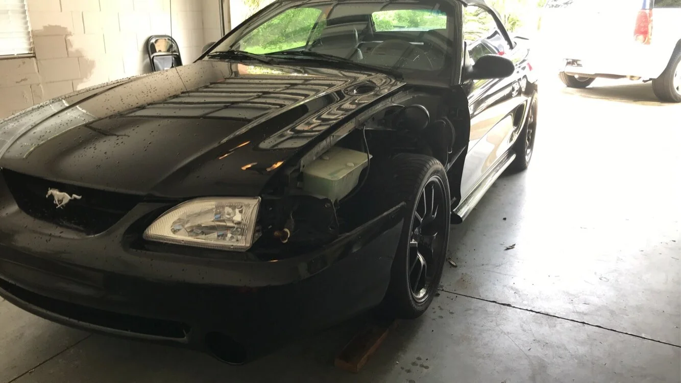

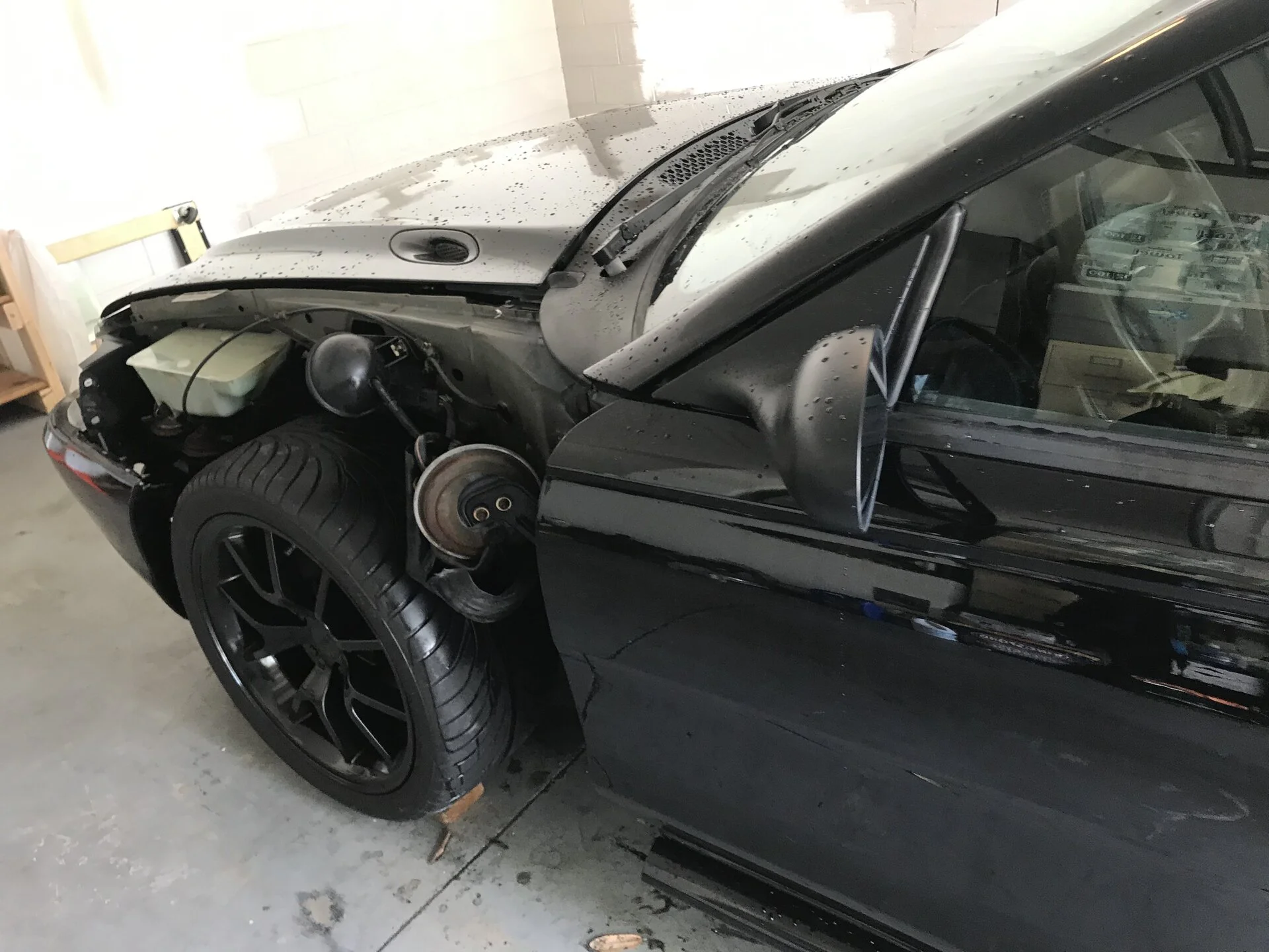

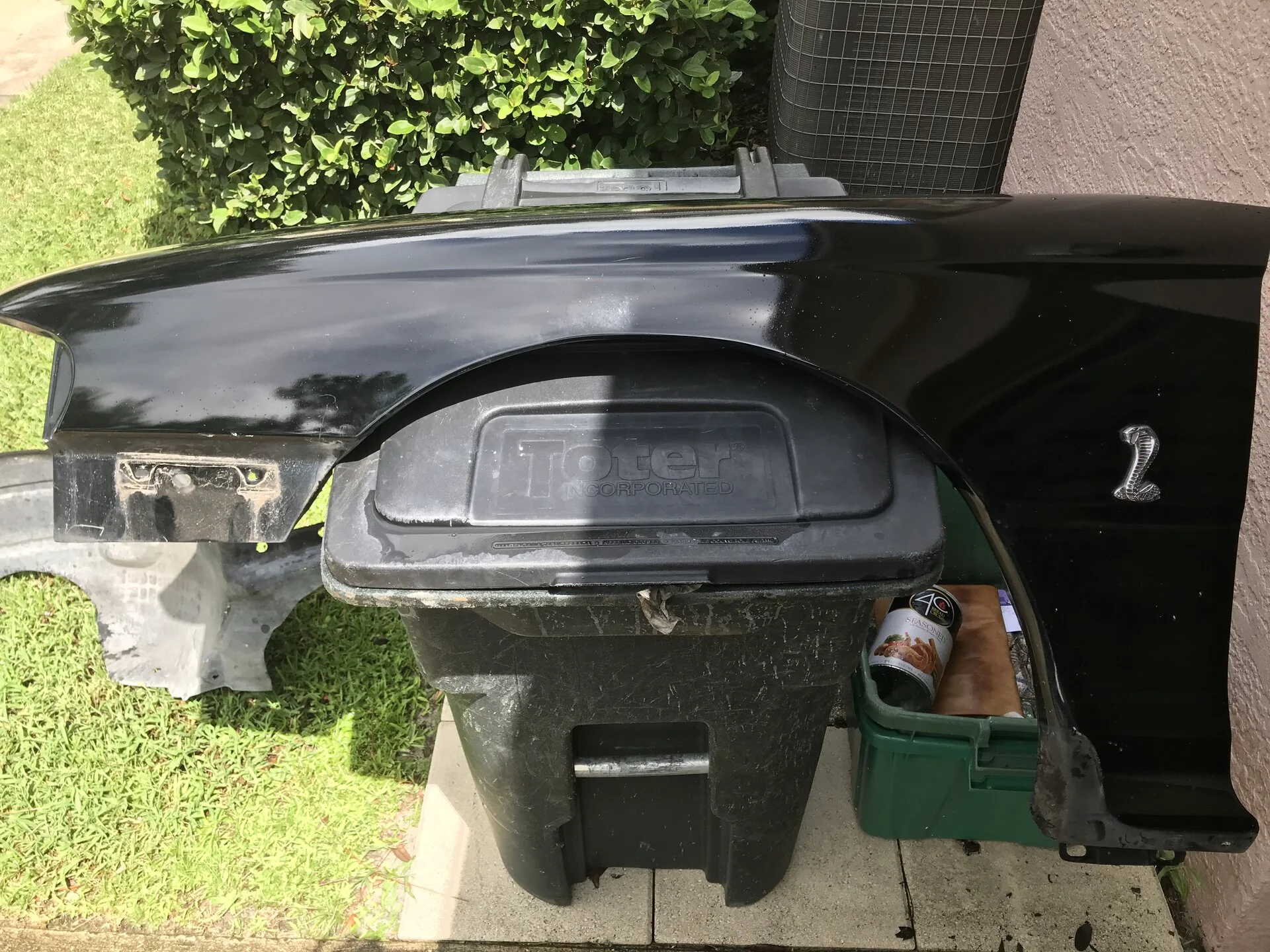

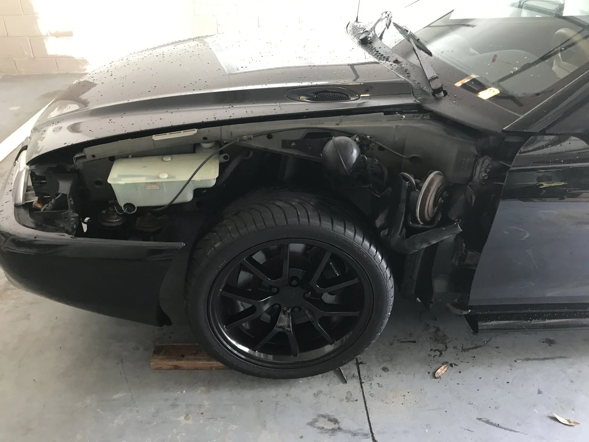

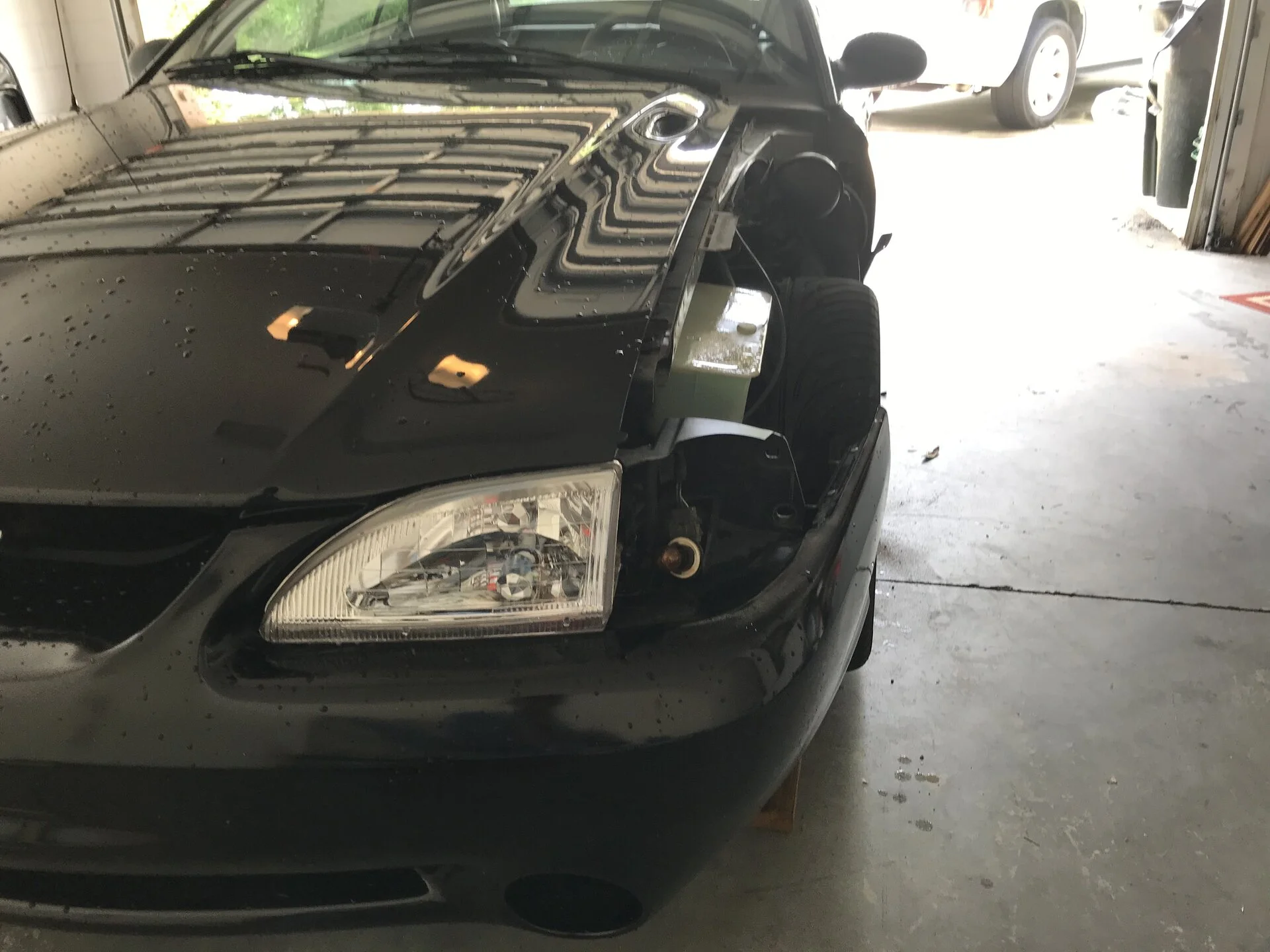

No dice on the noise yet but I did yank the fender
