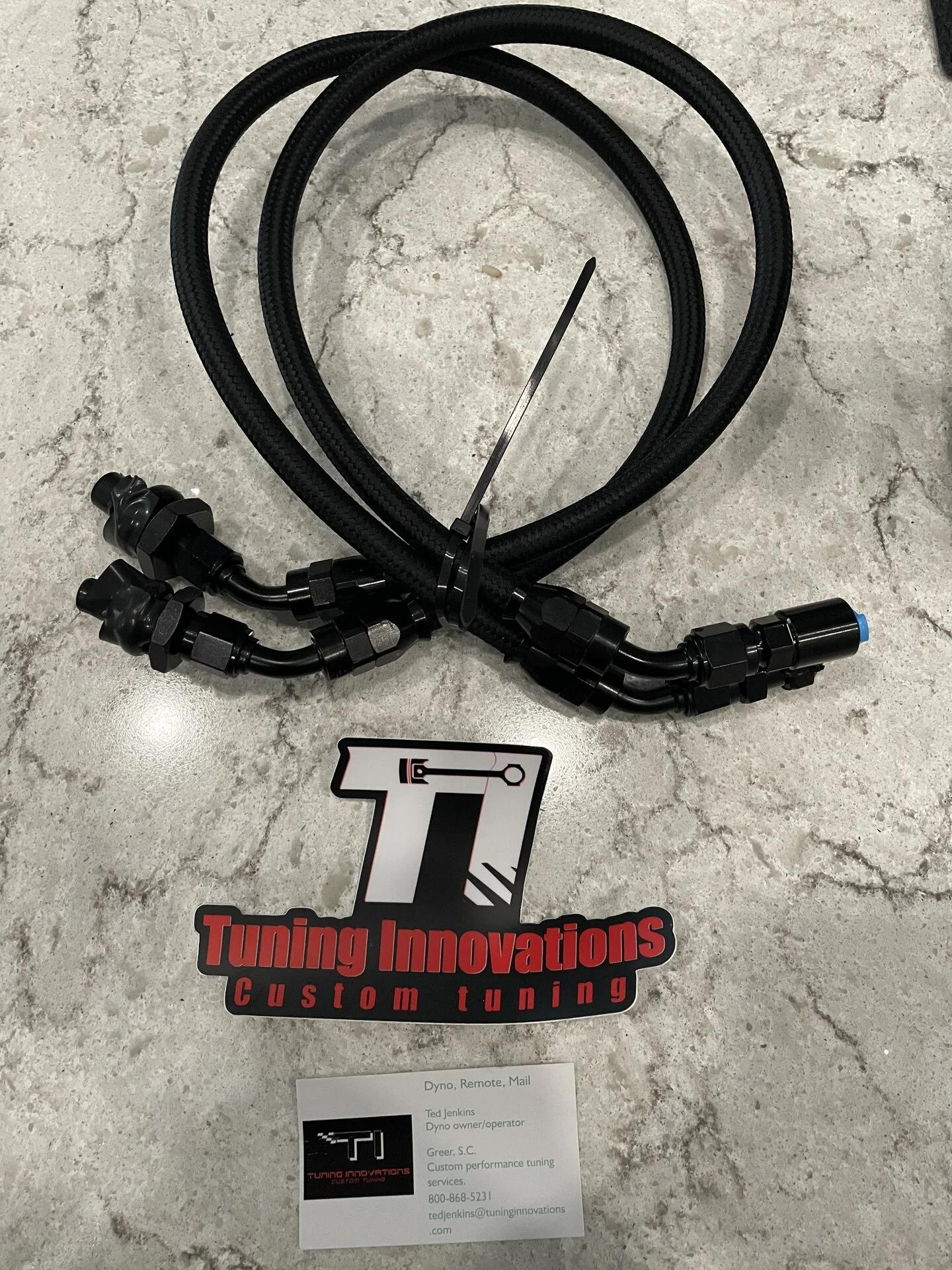

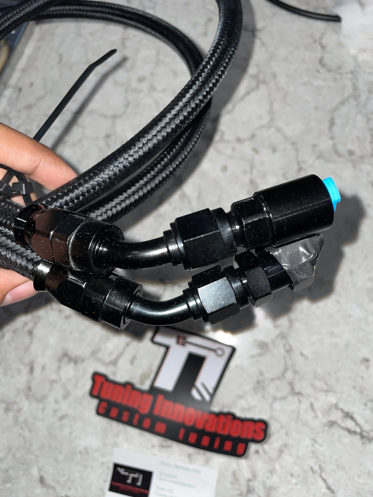

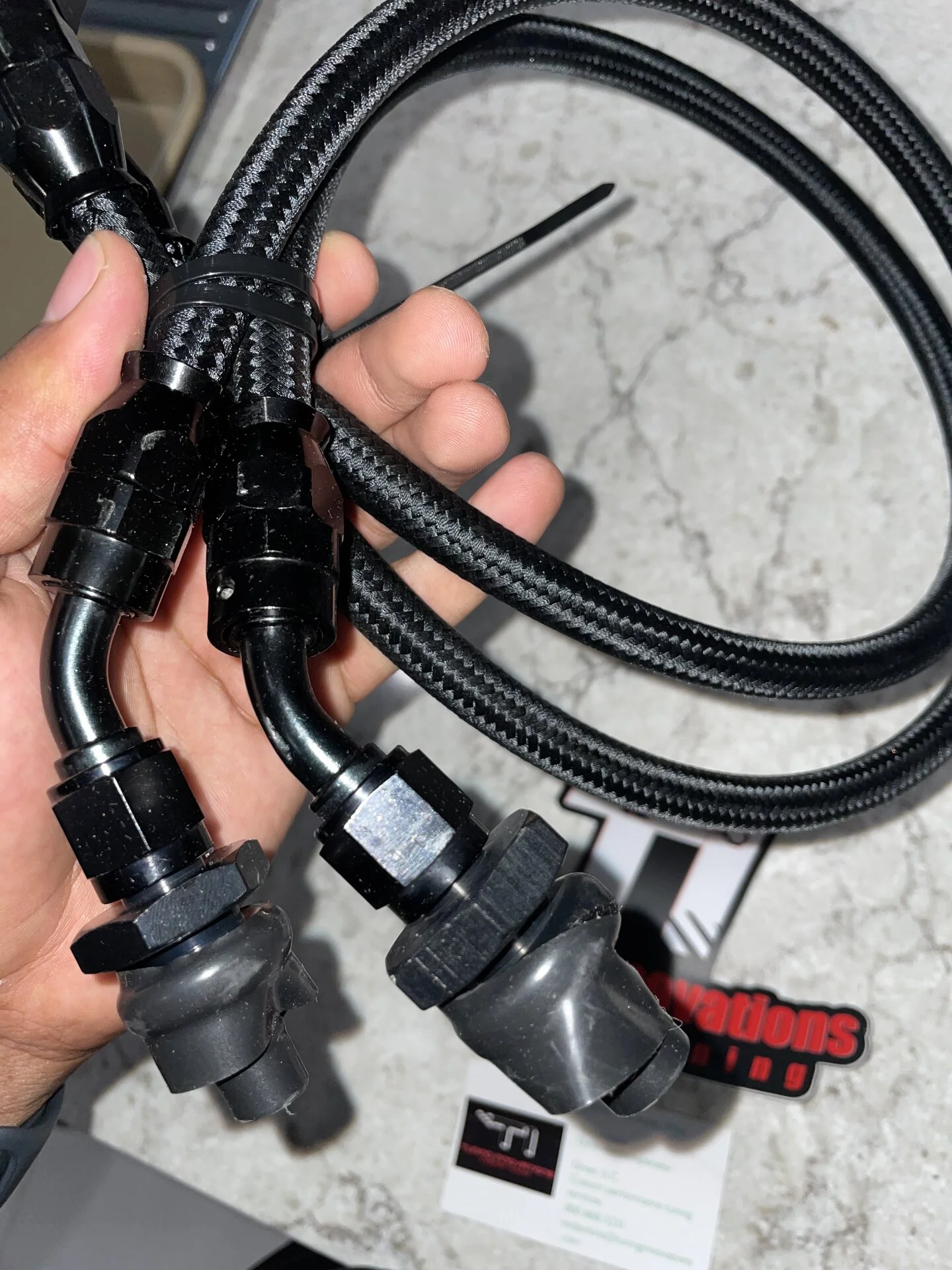

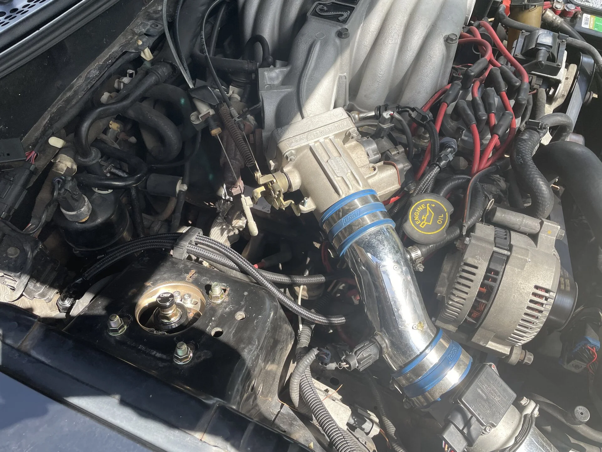

Got my fuel lines in today, very nicely built pieces. Will install this coming weekend and report back
Reactions: WhiteCobra95, General karthief and Rdub6

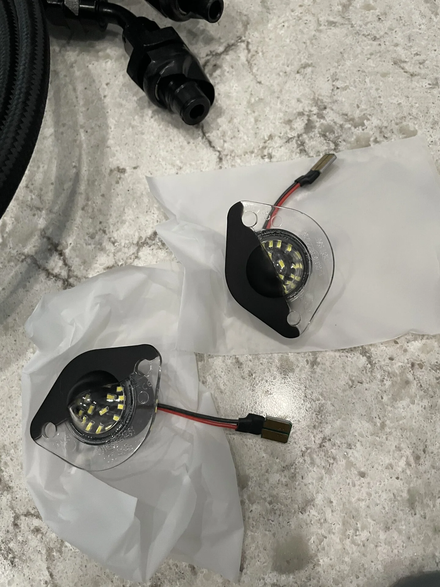

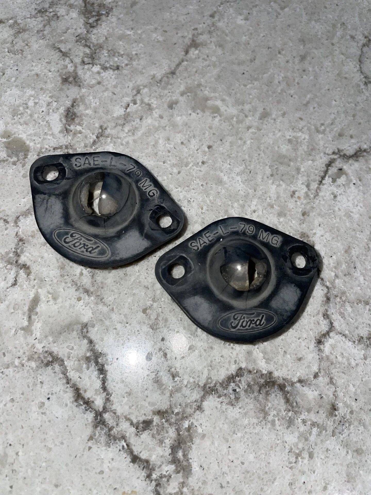

Also decided to finally replace my OEM cracked license plate lights that I added LED bulbs into with one integrated LED unit.

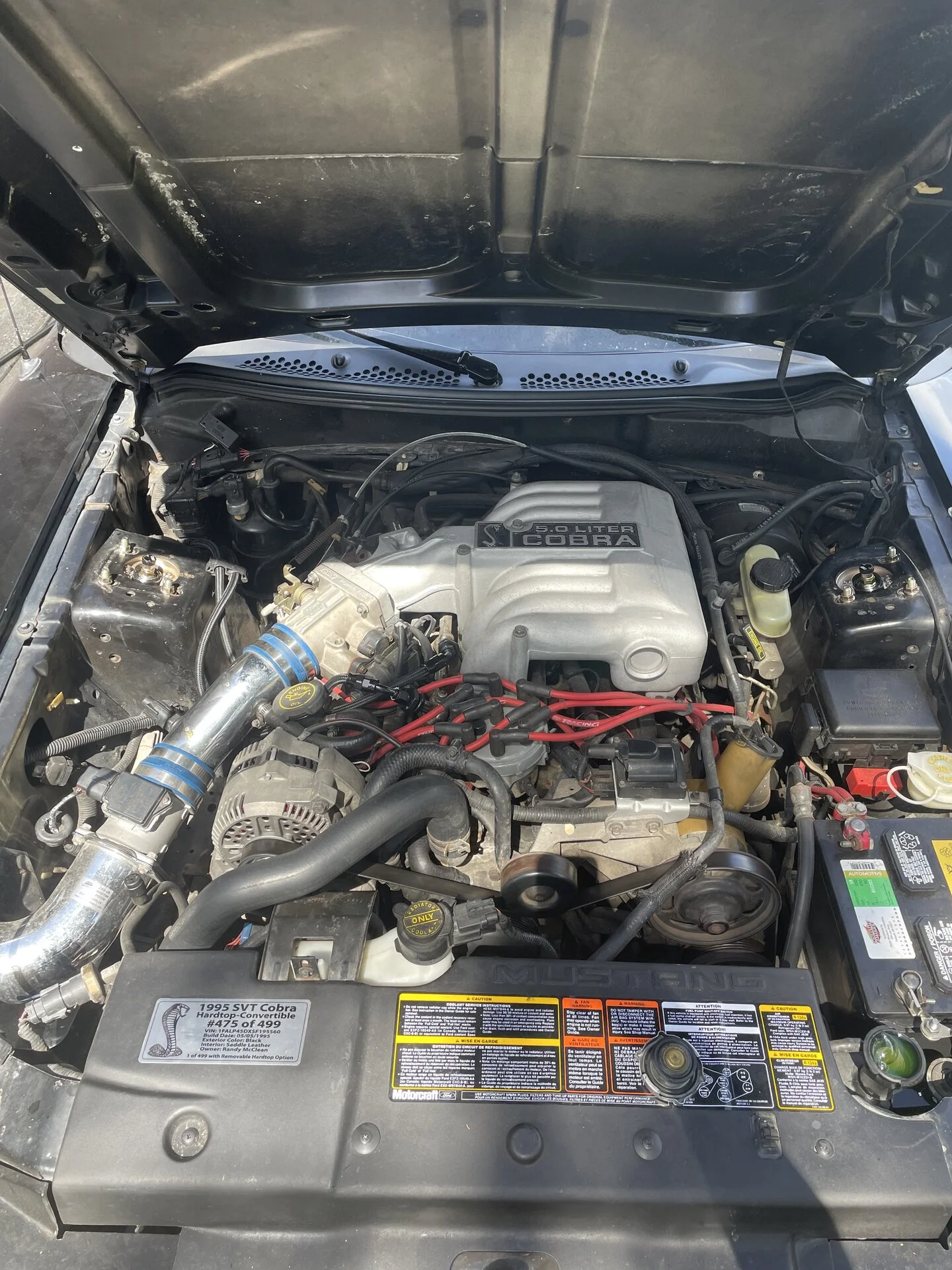

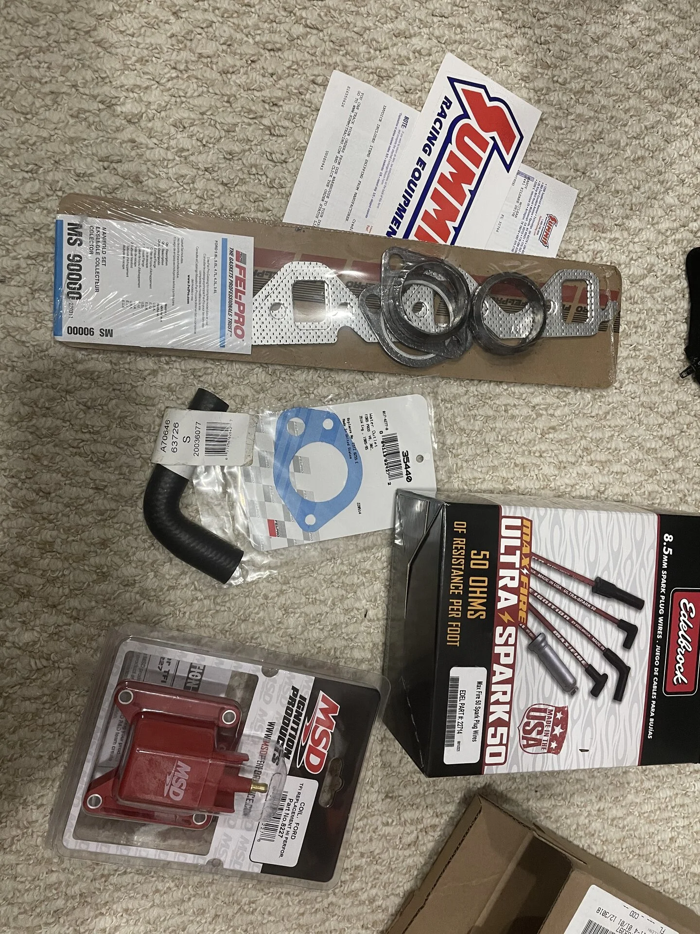

More parts arrived going to redo the thermostat gasket I did when I was 15, it has a very small leak and I’m guessing it’s either the bypass hose being brittle and cracked from what I see on top or the thermostat slipped out of the groove during install. Rest is ignition stuff to beef it up for forced induction. Trying to avoid using the MSD ignition box if possible.

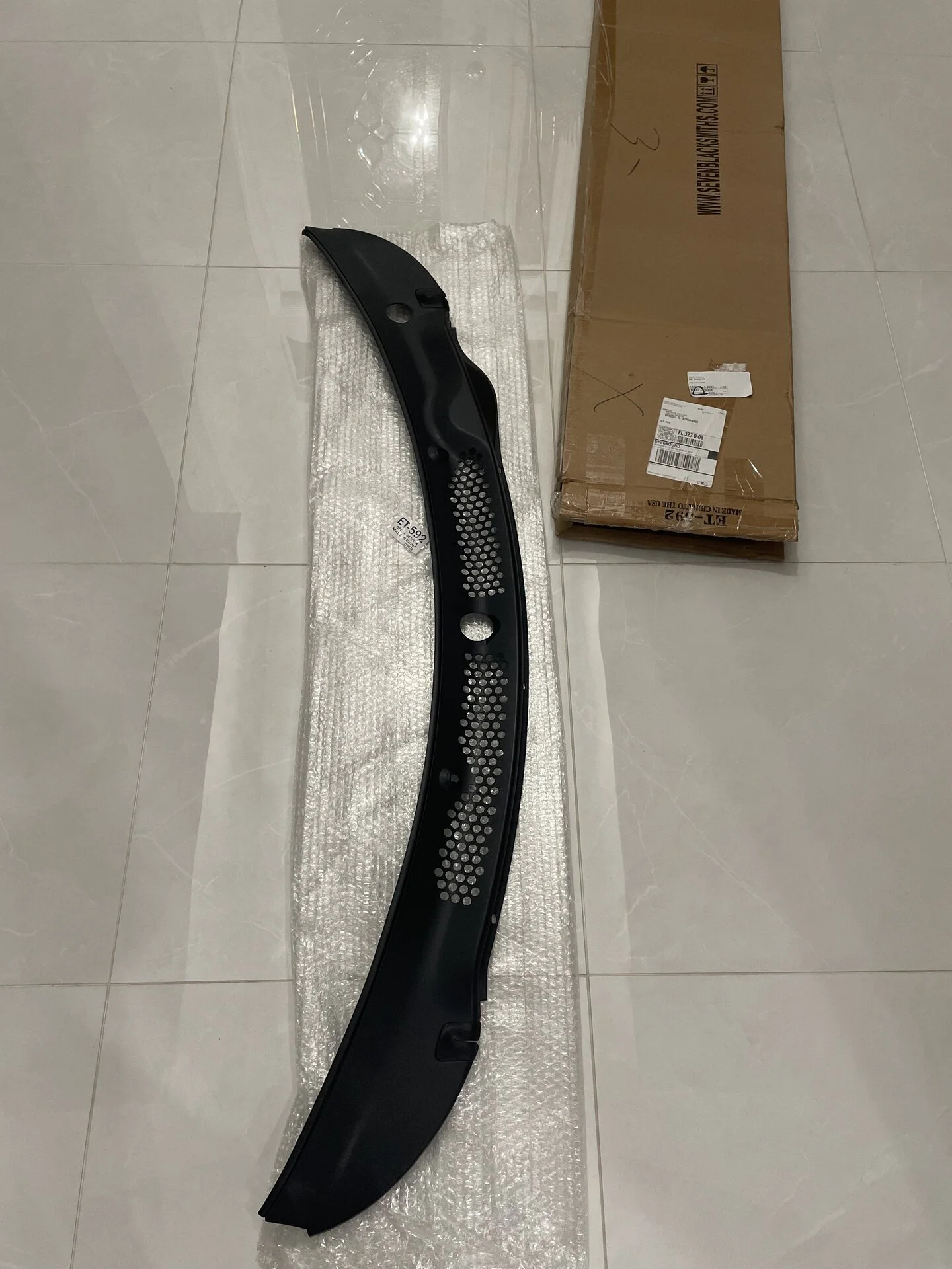

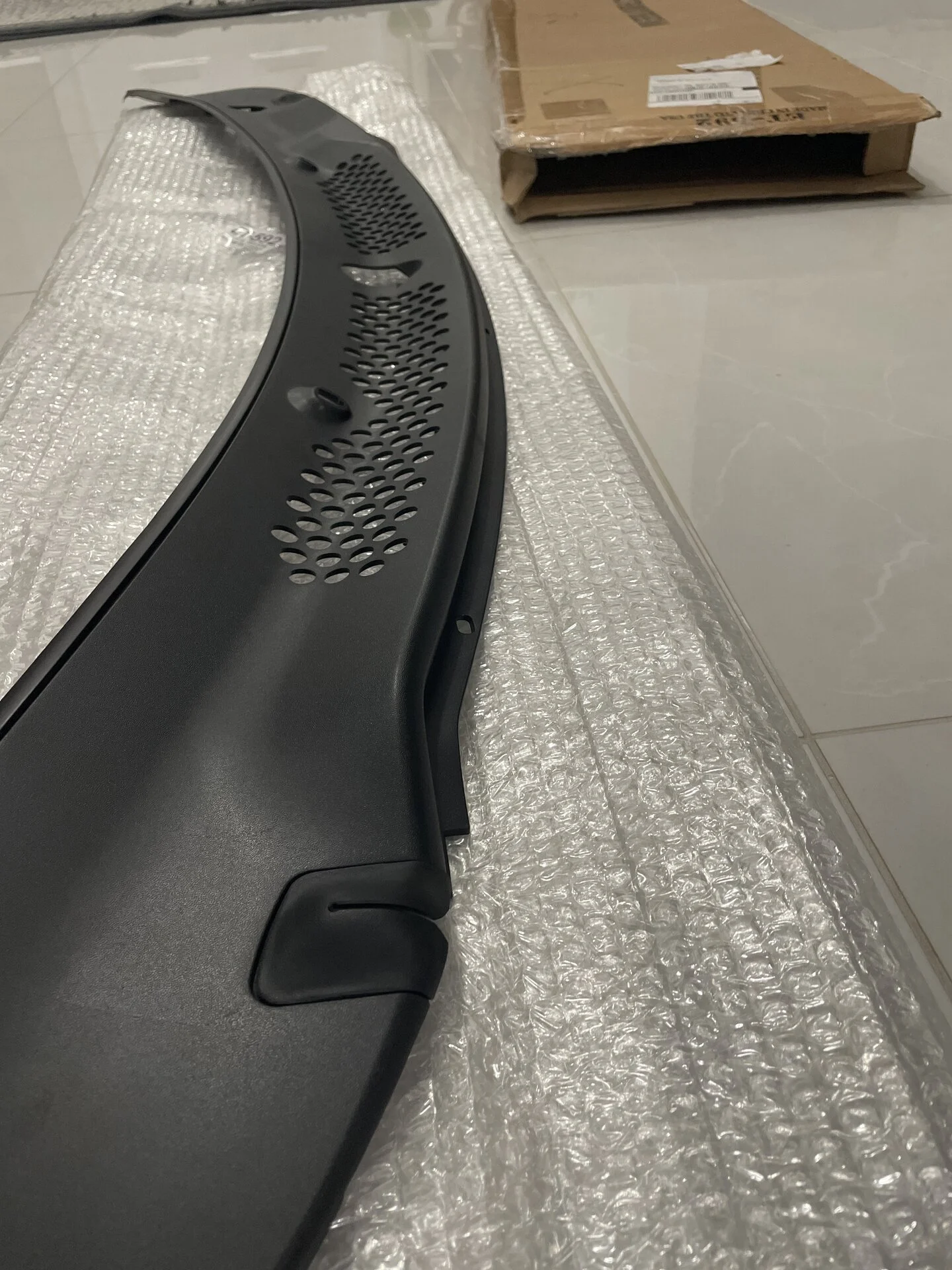

New windshield cowl panel as well to replace stock faded and cracked piece.

I'd keep the stock coil handy.
Just say'n.
Will do, this coil is just a rock auto special from a few years ago. I hear some bad things about MSD but seem to have a decent consensus on this TFI coil with boosted applications. I plan on installing that and the fuel pump shortly as these don’t need boost right away to make it worthwhile, will just reduce the steps I would have for the “big tear down”

Cowl panel installed, fitment was great on the knockoff piece, had to reuse the stock clips however as the provided ones didn’t snap into place.

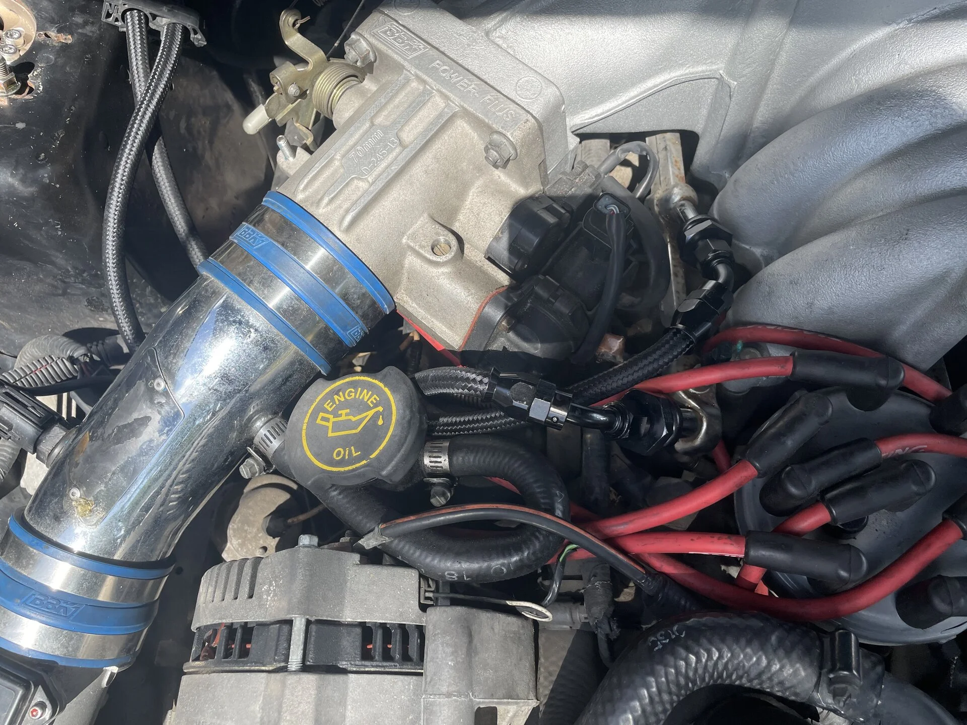

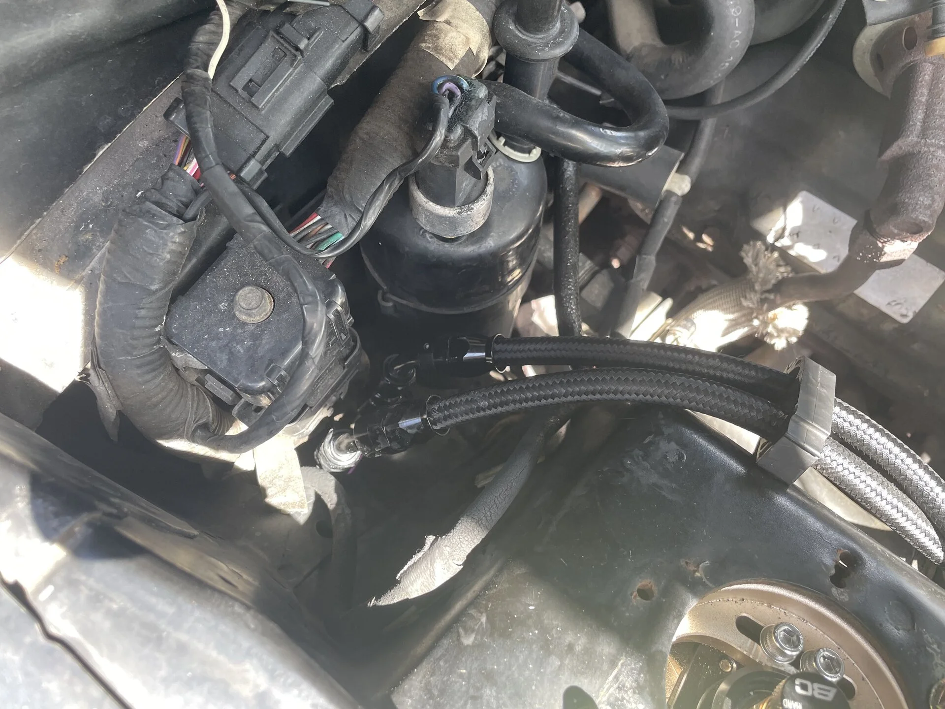

Finished up the install on the braided fuel lines and the new bypass hose and thermostat gasket. I used a little RTV to first affix the thermostat to the housing and then a thin layer on the housing and the engine side to sandwich the gasket. Probably overkill but didn’t want anymore small leaks. Bled the system and checked for fuel line leaks and coolant leaks, none present. I highly recommend these lines for the SN guys, fit and look great and took just about an hour start to finish.
Reactions: General karthief

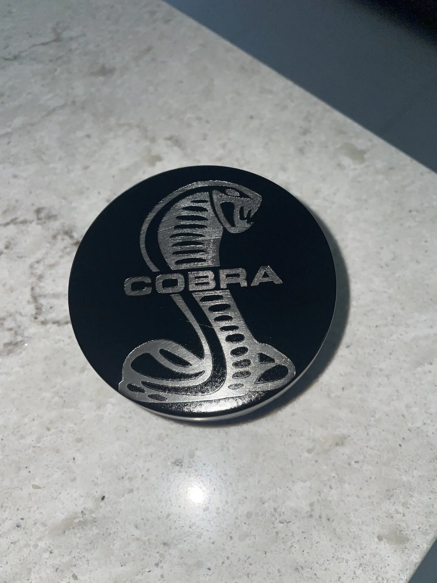

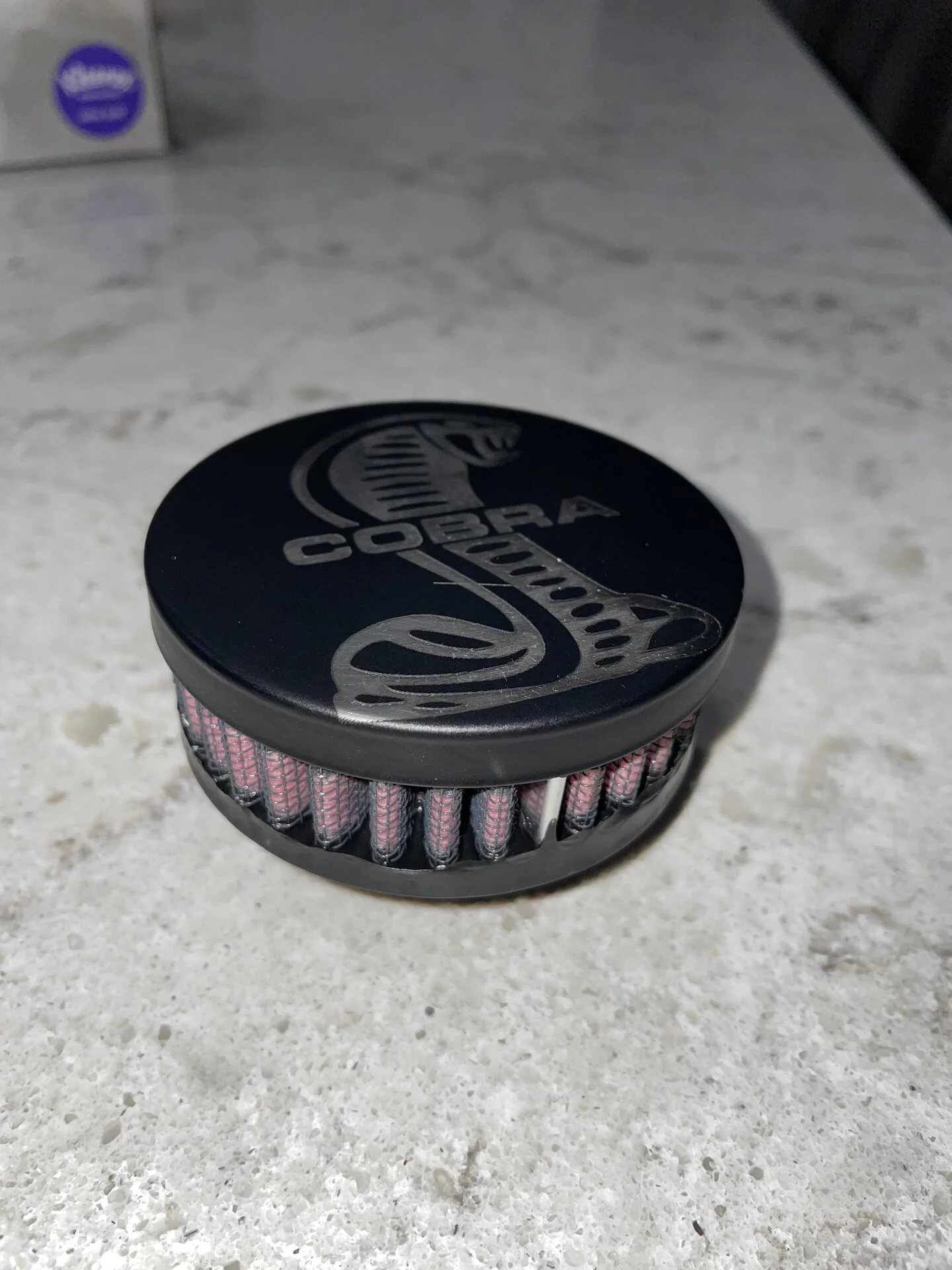

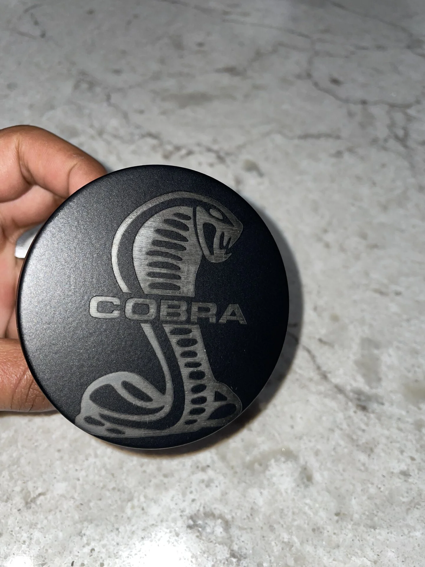

Bought this for my PCV solution when boost enters the equation. Has a one way check valve to allow crankcase pressure out without allowing unmetered air into the engine. I threw it on my laser engraver to add a personal touch.
CFM Performance Billet Valve Cover Breather Kit for 2002-2017 Mustang GT
“NOT FOR SALE/LEGAL IN CALIFORNIA/CARB STATES. ORDERS WILL BE CANCELLED AND REFUNDED“ Click here for SVT Performance's review of our valve cover breather. NOTE: 2011+ Twin Turbo Mustangs will also need oil fill neck below. Click here for Oil Fill Neck. FREE SHIPPING available via USPS First...
www.c-f-m.com

Clearcoated to seal the engraving.

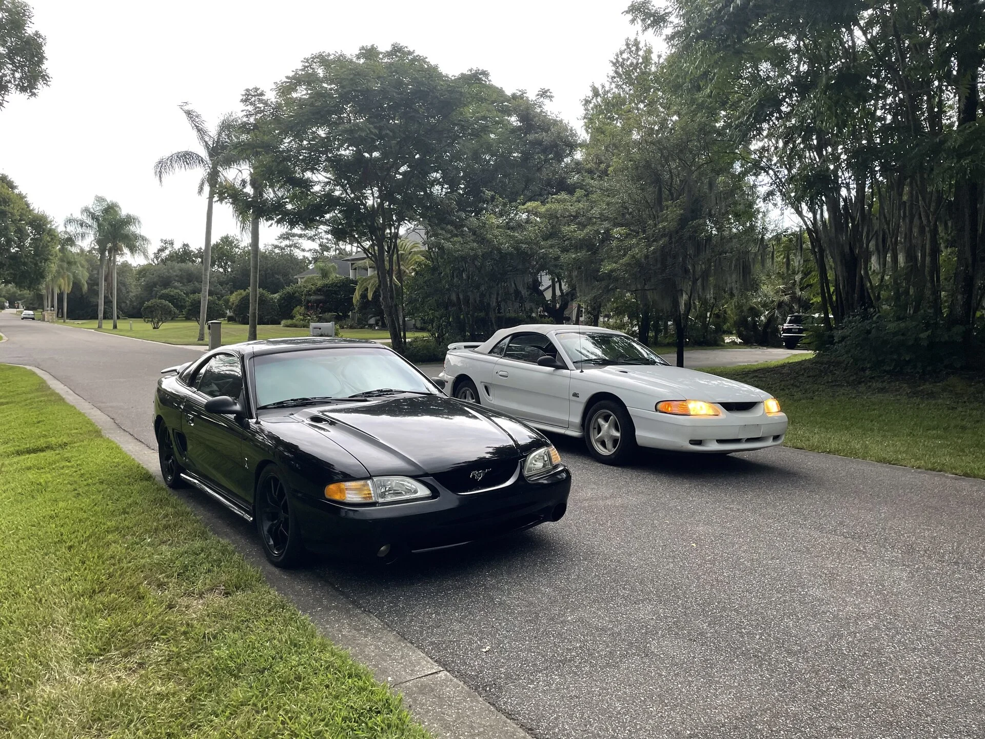

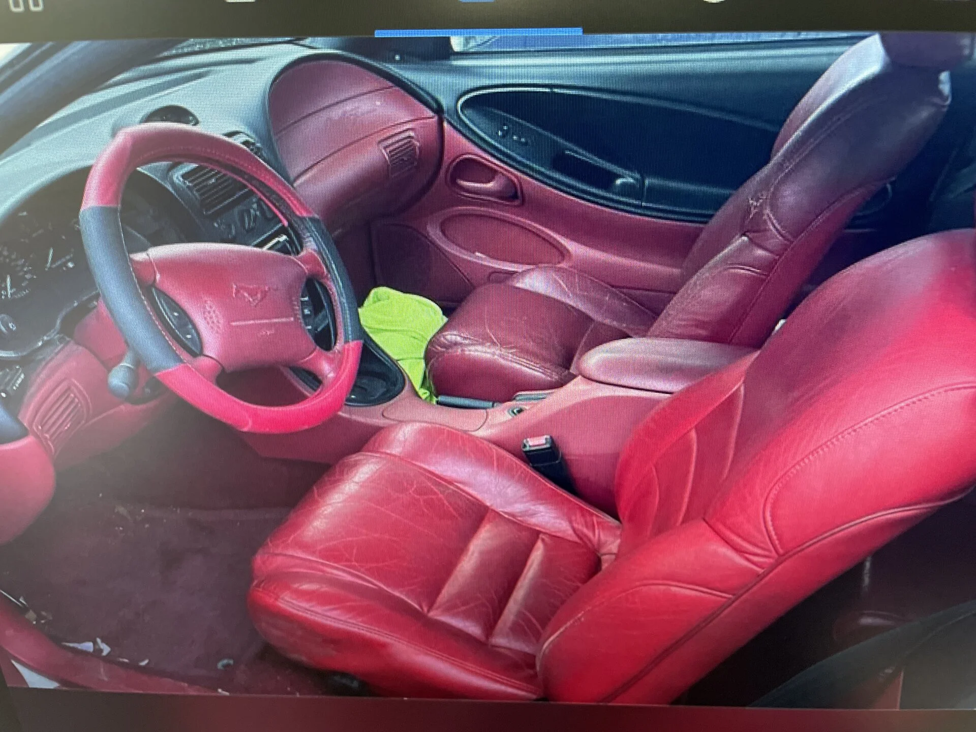

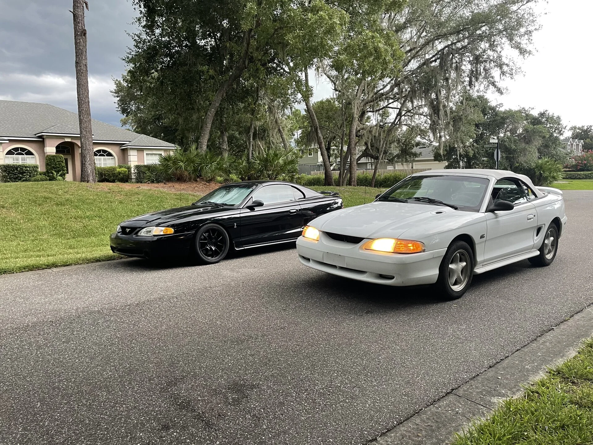

Off topic but we picked up this 94 GT to replace my cousins broken car. White on white top with the porno red interior. I would love to have this interior in my Cobra! Supposedly 1 of 36 in this spec

Sorry, that interior hurts my eyes, I mean, I like it but WOW
Sometime I think I should've kept my cobra but money talks.

That interior looks rare. Especially the back
