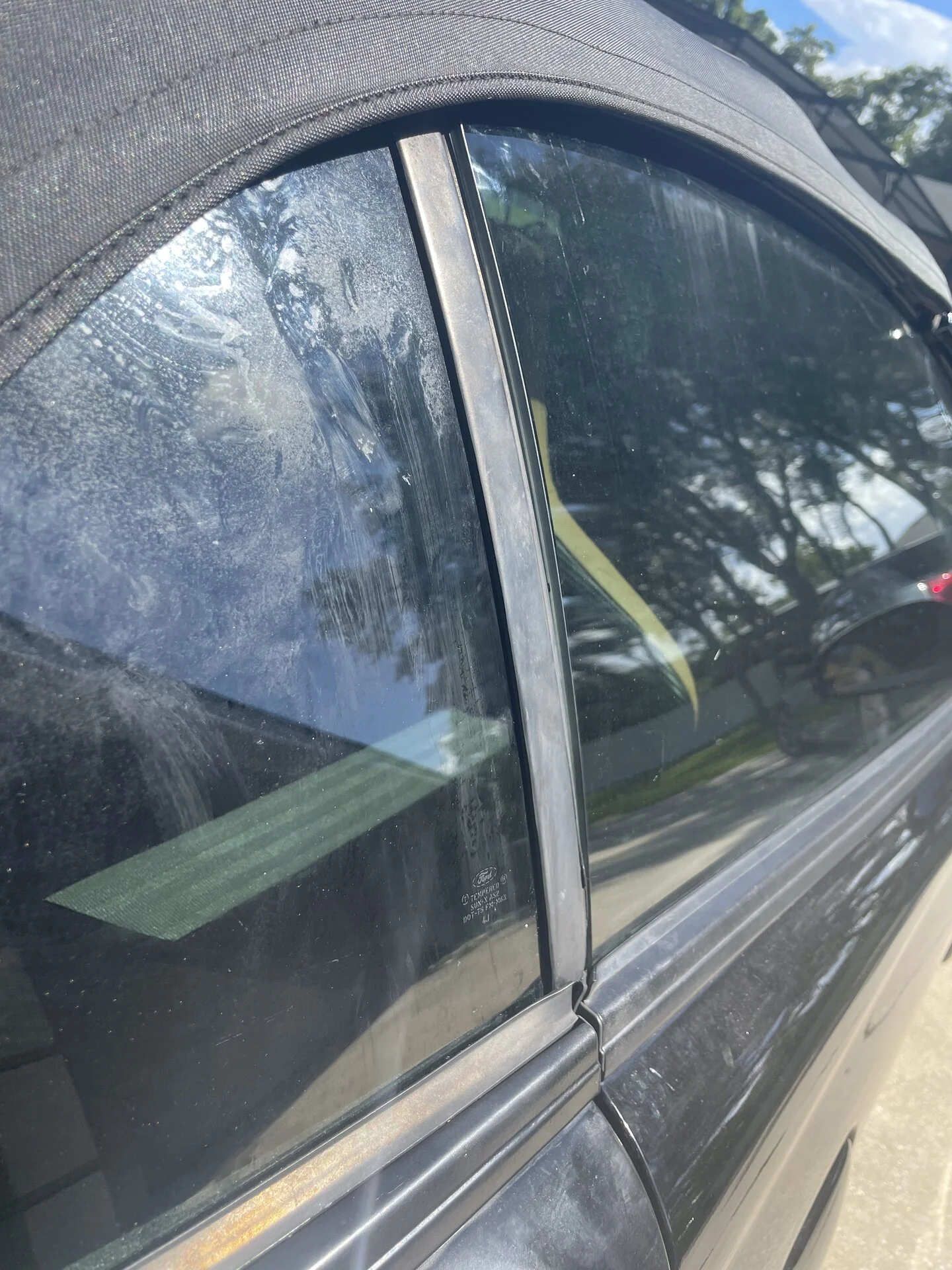

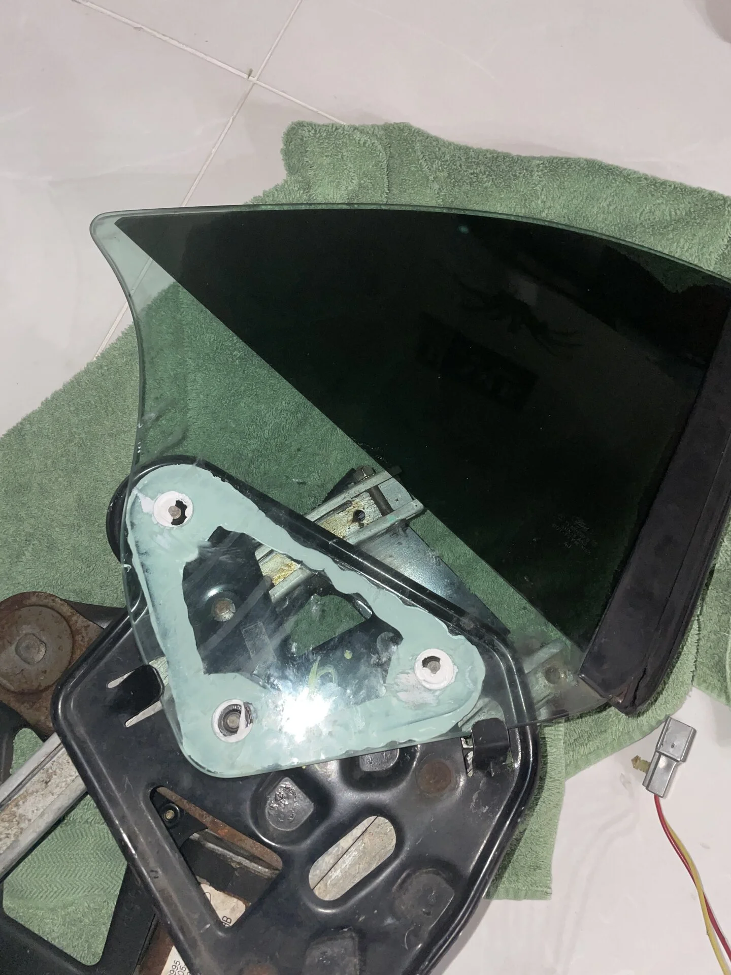

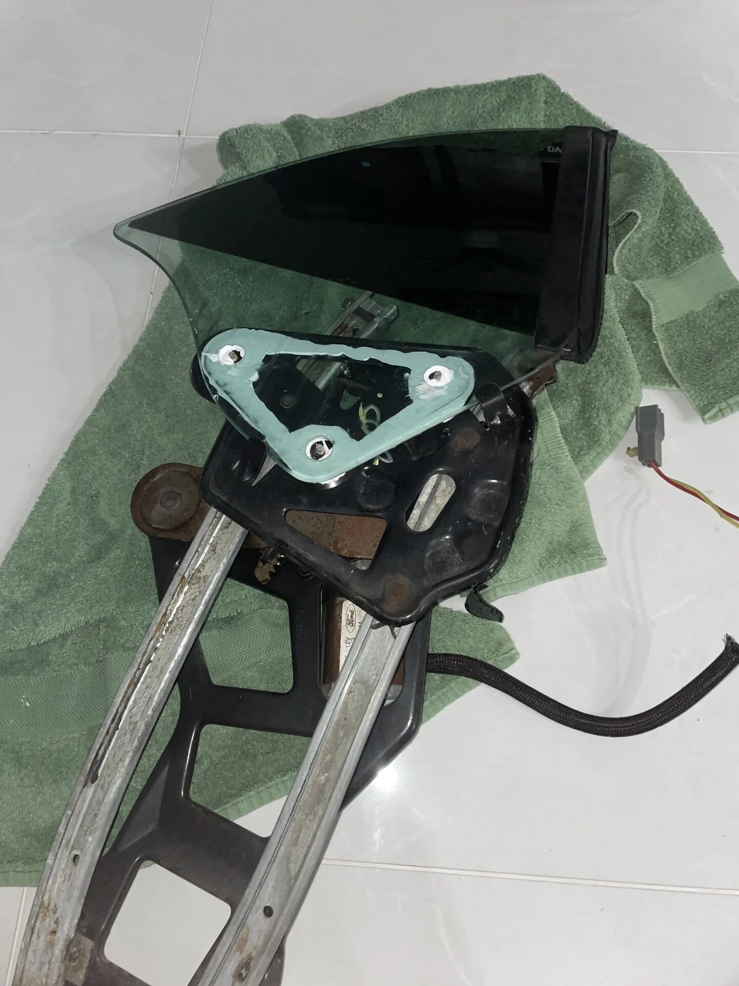

Tore down the back seat and quarter window assembly so that I can glue the window back to the track. Had to remove speaker enclosure and seatbelt bracket and then 4 bolts held in the entire assembly. Used a razor blade to scrape off old adhesive and cleaned with a degreaser. Applied the new stuff and now waiting for it to fully cure for reinstallation.
I would have expected a black sealant adhesive more like 3M windshield gunk.
Does Gorilla adhesive list glass on the label?
I looked into the 3m windshield adhesive but it was $32 vs $7 on Amazon. This was also marketed to have instant hold which I wanted so I wouldn’t need it clamped too long. If it works well, I will sing it’s praises. 2 hours of cure and it seems rock solid. Will install tomorrow when daylight returns
Reactions: 90sickfox

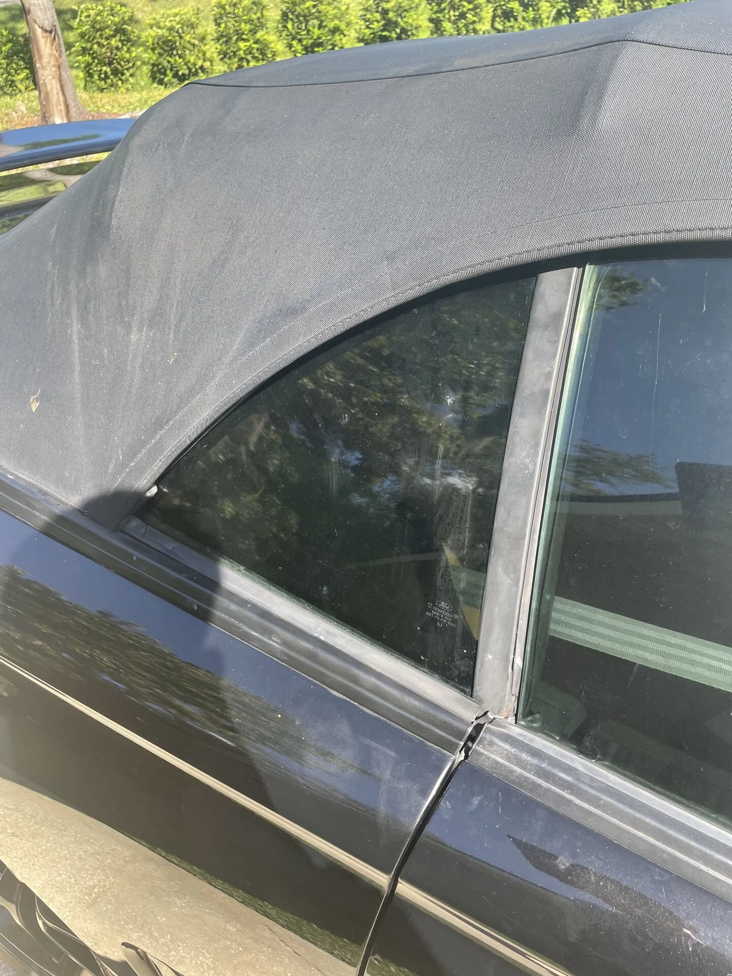

Waited the 24 for it to cure, had to redo it because the window and regulator assembly would not fit in the allotted space. Had to install the regulator first and then slide the window through the top end line it up. Took the car for a drive and all was well. Window lines up very nicely, I am satisfied with the repair. Longevity will be the next question.

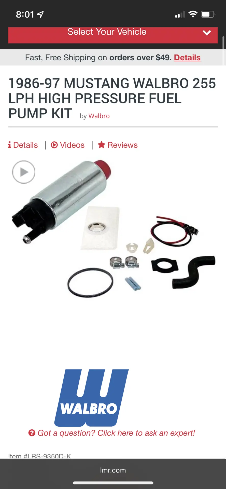

Tackled the Walbro fuel pump install today. Ended up dropping the entire tank because the old pump came out with no fuel sock and I figured it had come off during removal. Looked inside and couldn’t find it so just put it back together. Used this kit with new hose, O ring and fuel sock. No pictures unfortunately but everyone knows how the job goes.
Test drive went well with no leaks
