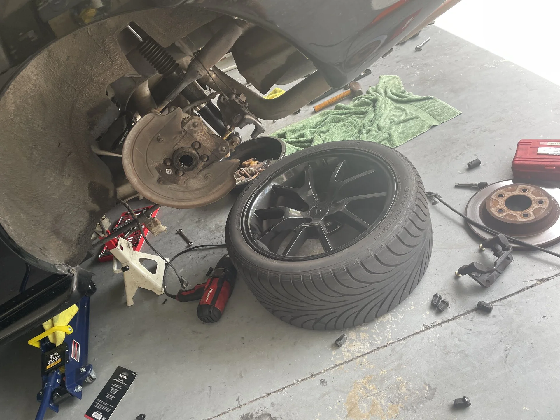

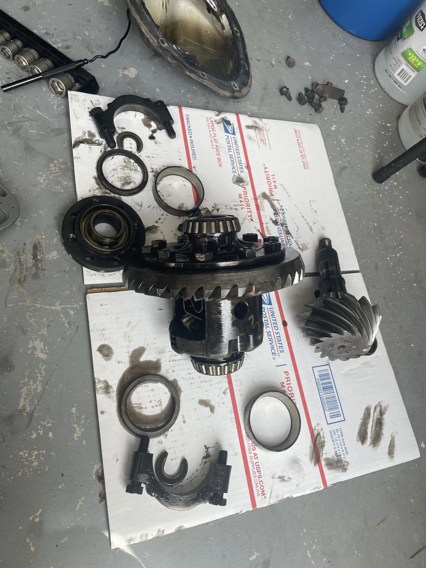

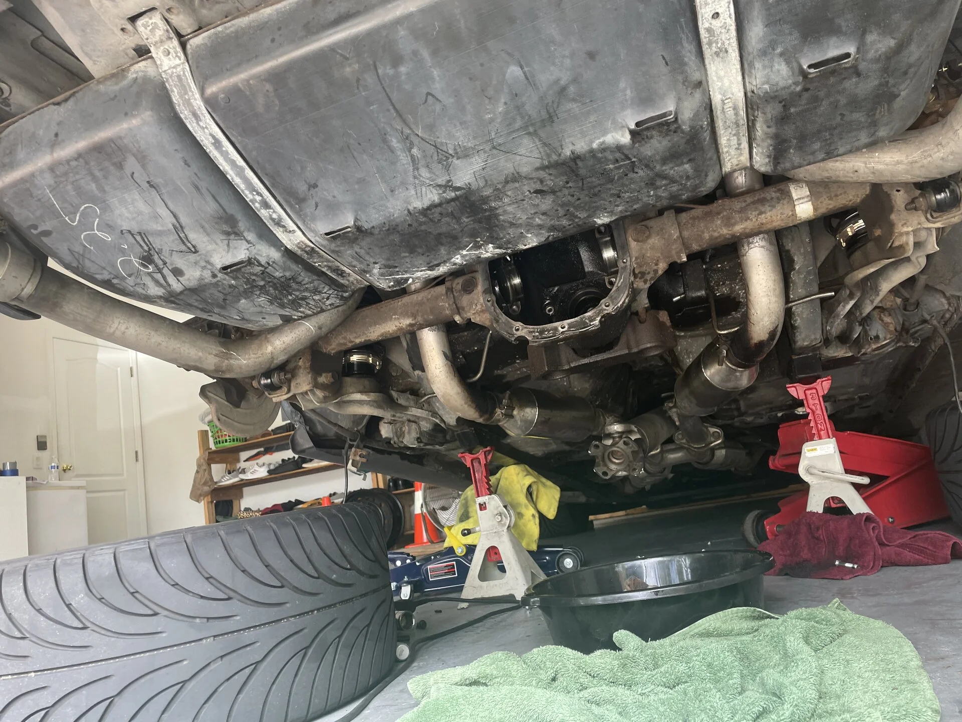

Everything is out, need to bring the pinion to a shop tomorrow to get the old bearing off to grab that shim and press on the new one. Took about 5 hours in dissassembly and installing axle seals and bearings. I did break both rear speed sensors in the process, they seemed to have fused to the caliper bracket so if I am not able to hammer it out, I will need to replace the bracket and the sensors. Not ideal, but to be expected with 27 year old plastic.

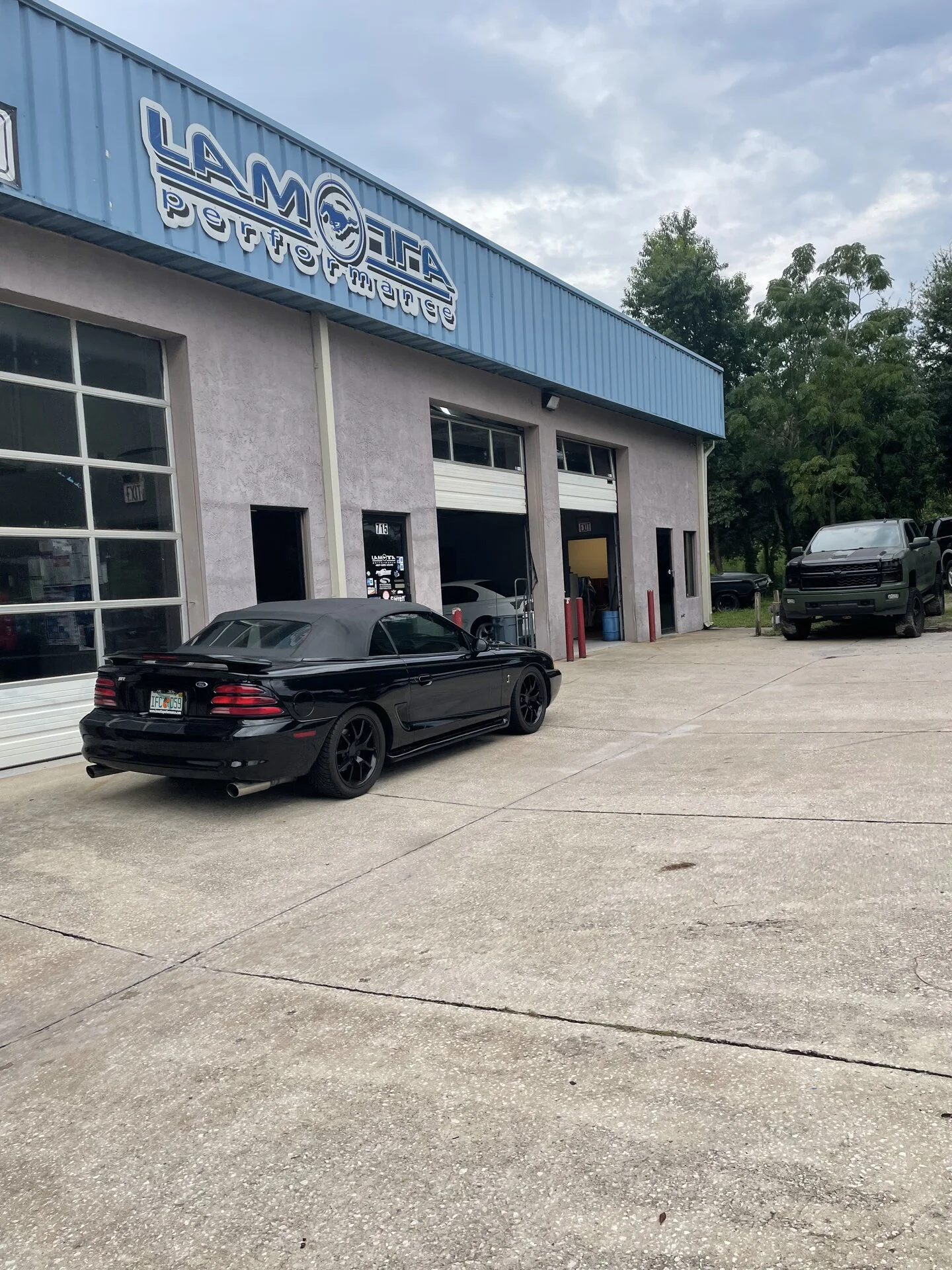

Took a little while to update because I was a little disappointed in my work. Got the car on the ground for its first test drive. Picked up drive nice and smooth with no noises and was very proud. Get into third gear and let off to coast to a stop and I get a good amount of gear whine/whirring. Felt a little defeated so she sat for a week while I debated starting over or taking it to a shop. Decided on the latter. Drove it about 20 miles to my local mustang shop to get the install done. On the bright side, she drives flawless and the 3.73s felt perfect. They gave the car a good amount of pep and around town under 55mph she stays under 2k rpm. It even seemed like the decel noise got a little less apparent or I started to get used to it. Most would probably leave it, but I really want to have this car perfect. This will be her first time at a shop under my possession but she’s in good company at Lamotta Performance

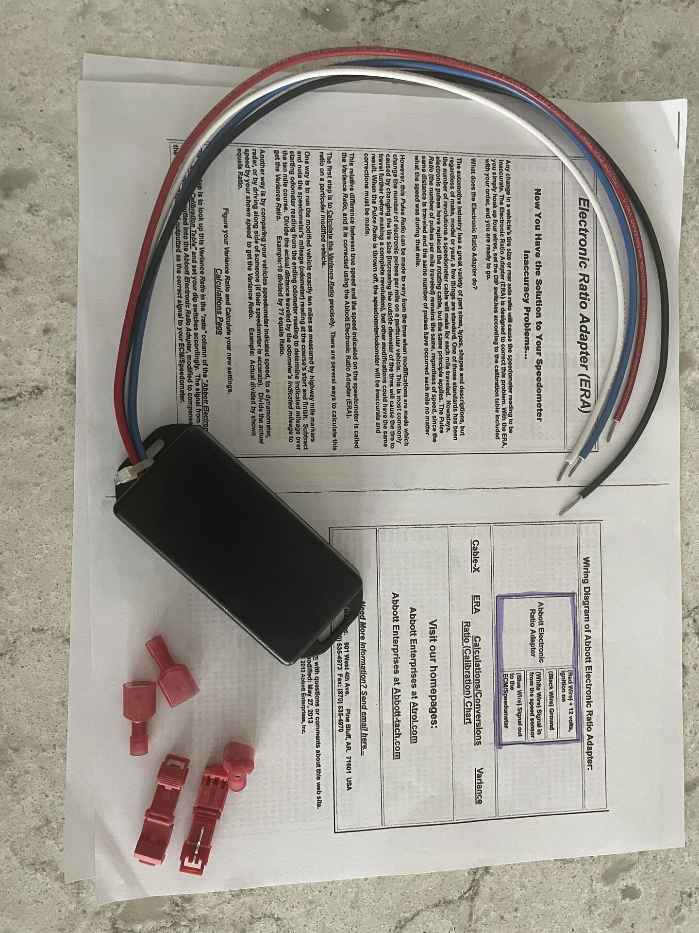

This morning I also replaced the side view mirrors that would rattle a little while driving. Dorman units went in and look good. Will need to exchange driver side as the up/down wire was slightly damaged upon arrival.
Also installed my Speedo recalibration module. Pulled switched power from the orange/black wire by ecu that is for auto trans temp. Ran a ground to a clean bolt down there as well. Soldered in the module signal wires in line to the gray/black VSS wire. Won’t know if it works until I get the car back as I am having them throw in my new abs speed sensors while the car is all apart.

Oh yeah, Lamotta rocks

Picked up my car from Lamotta this evening. Nice and smooth drive and no noises. They said they needed a thinner pinion shim than the OEM piece which usually isn’t the case with Ford Racing gears. Started the break in process today and very happy with the 3.73s around town
