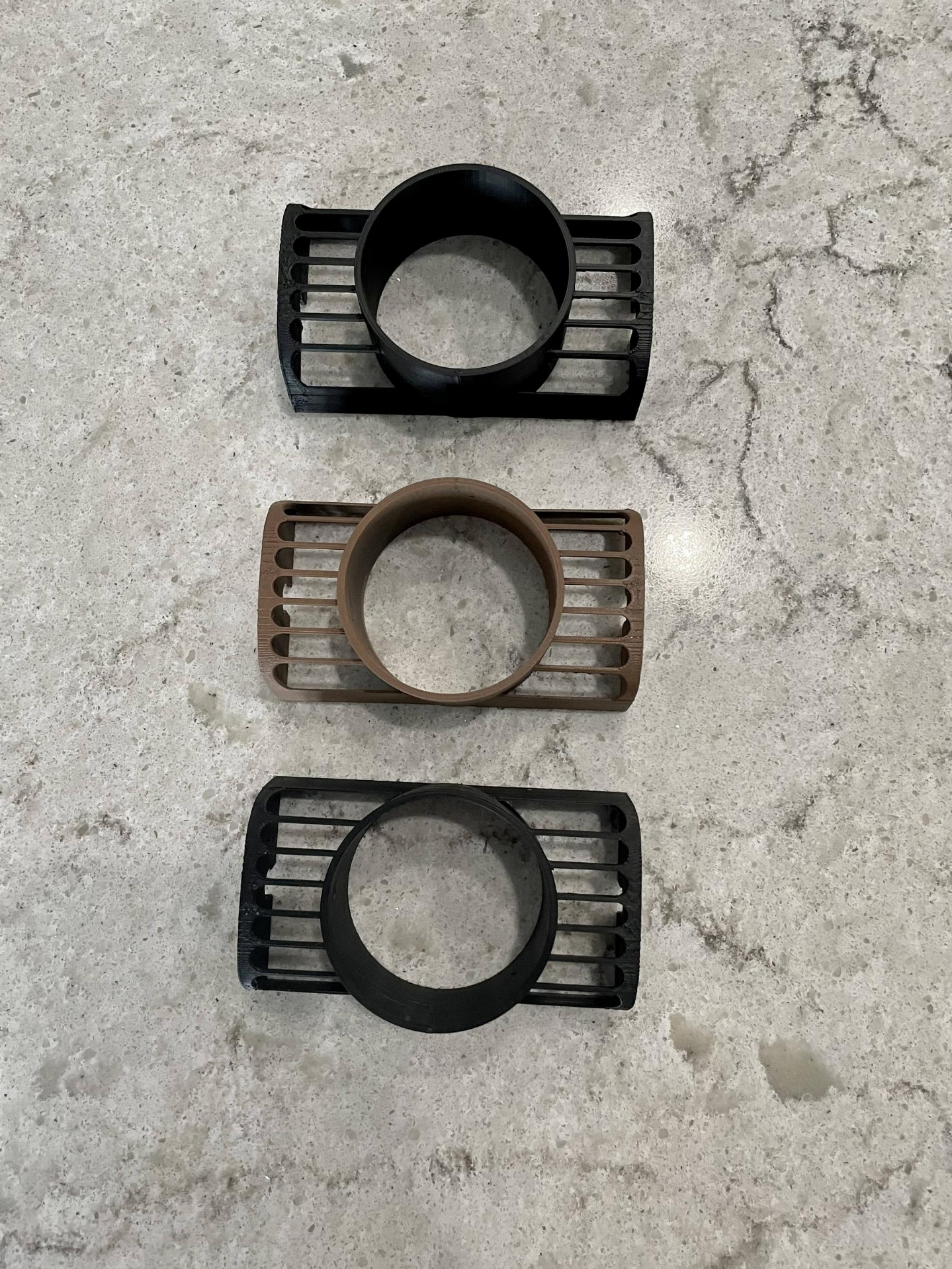

From top to bottom I have the ABS version, SEM “saddle tan” PLA version and unpainted PLA. I will be sticking with my newest model with the integrated clip and print in ABS. The surface finish is more high quality and it will be more resistant to heat. I ordered some proper saddle tan paint from LMR to get a better color match for my other interior pieces as well.
*Pictures won’t upload for some reason, will edit and add them in
(http://imgur.com/Z98HFXL) View: https://i.imgur.com/Z98HFXL.jpg

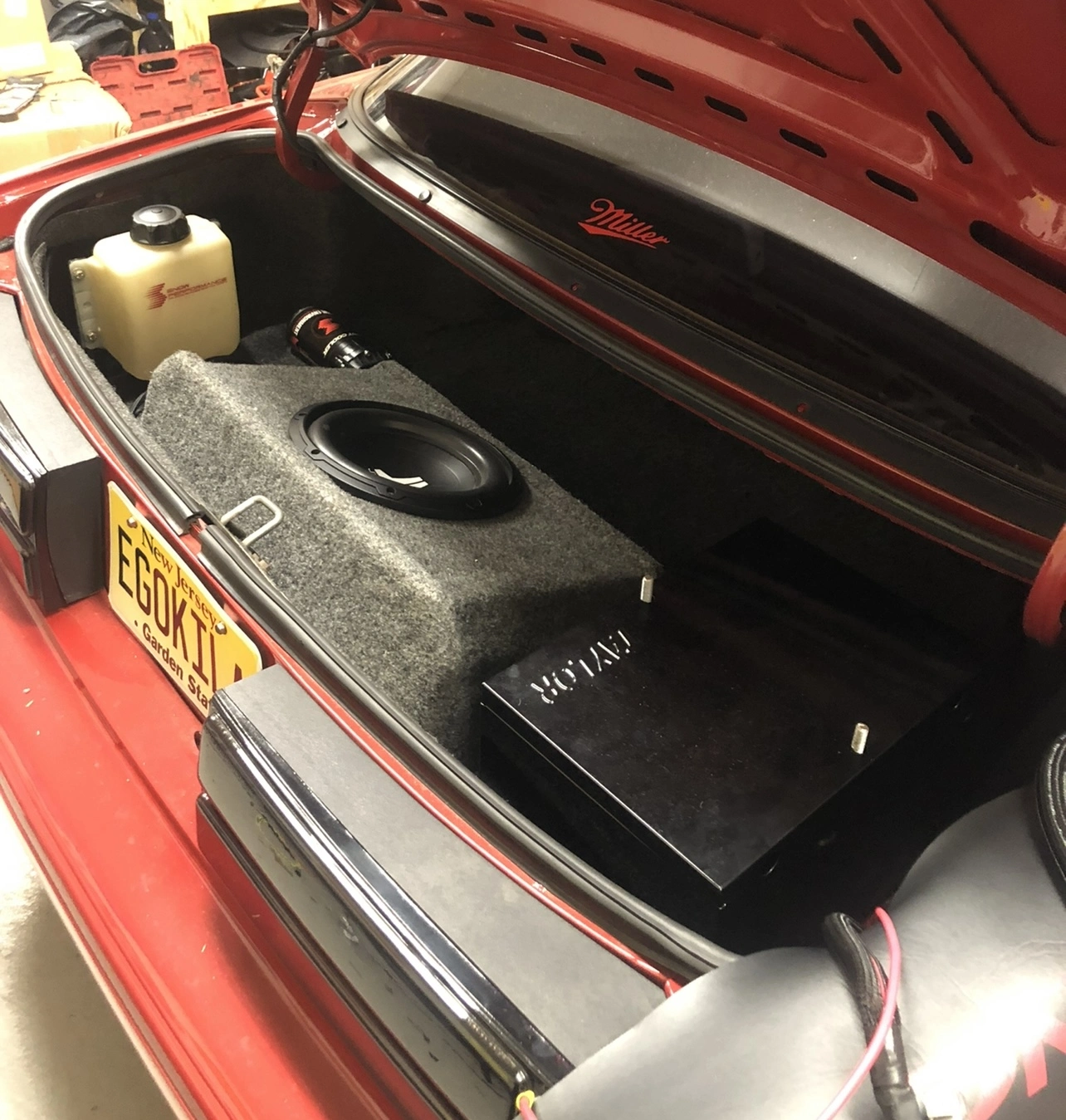

Essn95 said:
Are you running pre and post blower nozzles? I also planned on using my stock windshield reservoir due to space restrictions in the engine bay. I am not opposed to running a different mixture, especially seeing the success and power you have made on the 80/20 safely. I'm assuming you are mixing your own mixture of VP meth and distilled?
Both are post blower .
Yes just vp m1 and distilled water

Sep 21, 2022
#515
  • Sep 21, 2022
  • #515
@TOOLOW91 I know you drive your car on the street a lot; how much meth do you go through?
TOOLOW91
20+ Year Stangneter
8,483
8,687
S.I.NY
Sep 21, 2022
#516
  • Sep 21, 2022
  • #516
Hard to say , if I take it out and beat it a bunch maybe 1/8-1/4 of a tank every 60 ish miles . I’ve only filled it from almost empty once since winter . I topped it off from 3/4 of a tank once so far this summer after that
Are you using a separate reservoir or your windshield reservoir?
TOOLOW91
20+ Year Stangneter
8,483
8,687
S.I.NY
Sep 21, 2022
#519
  • Sep 21, 2022
  • #519
The snow reservoir , mounted in my trunk.
