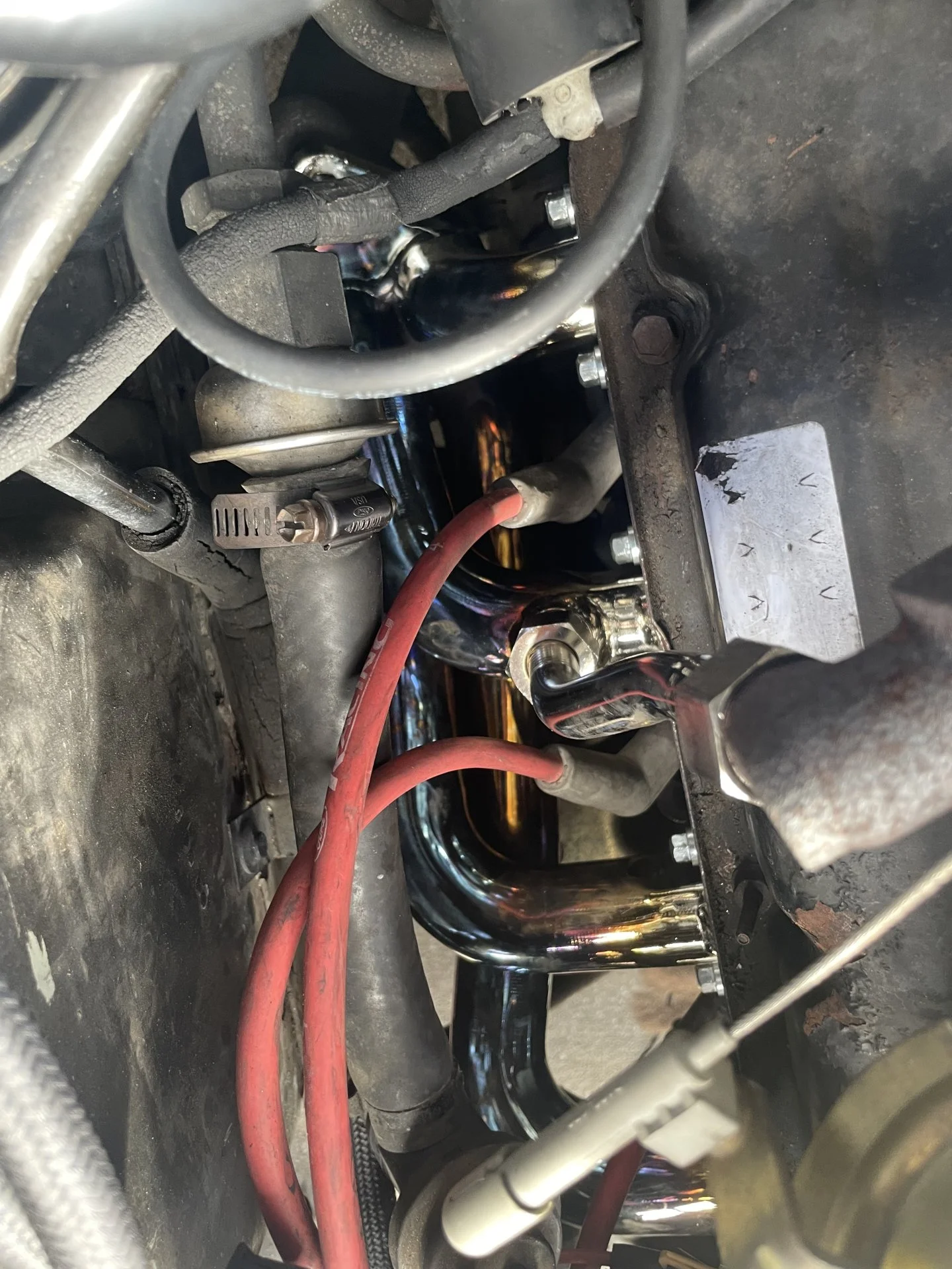

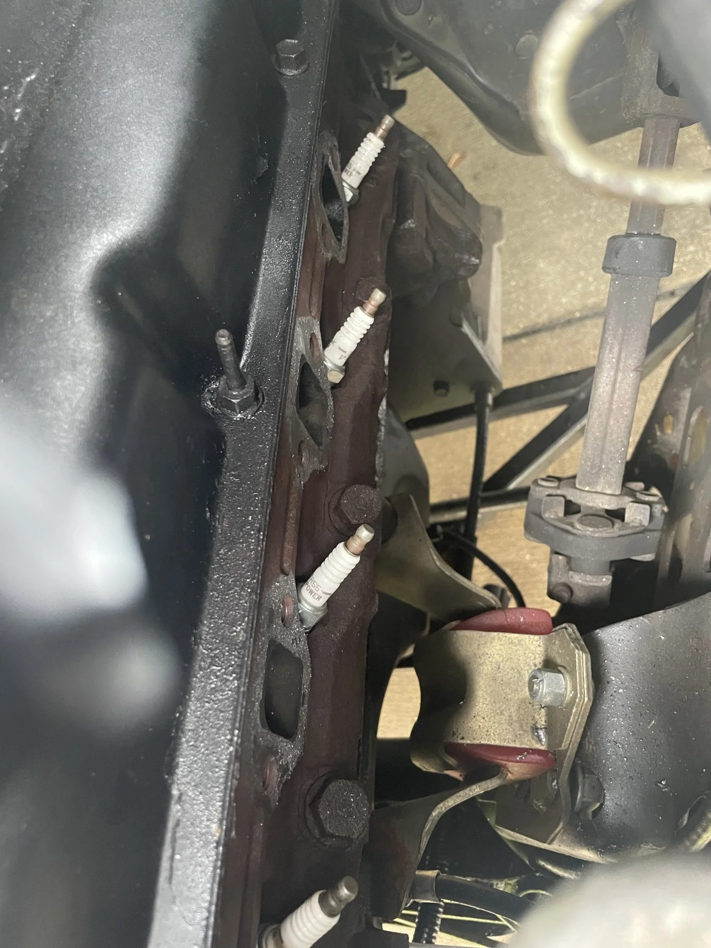

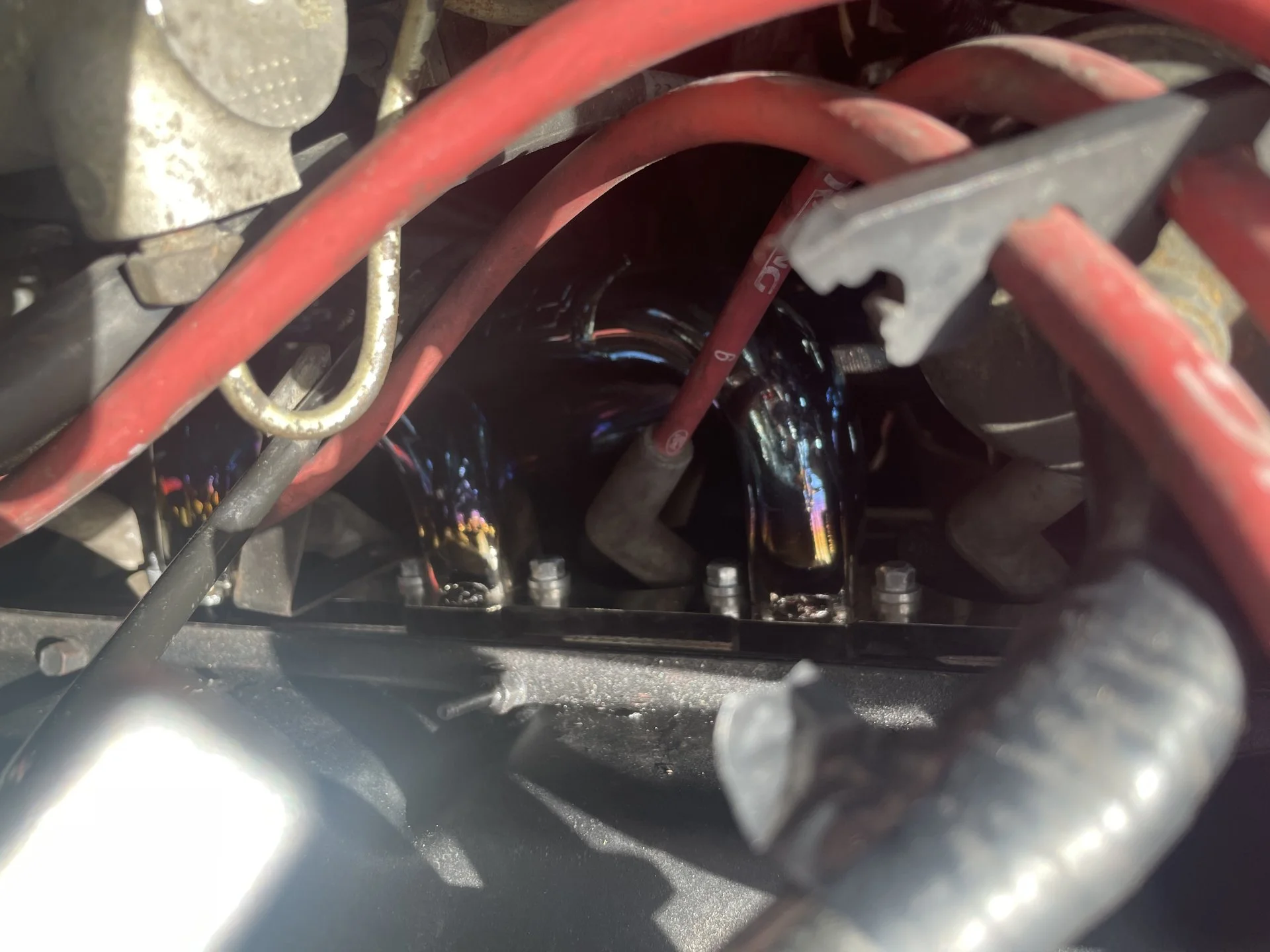

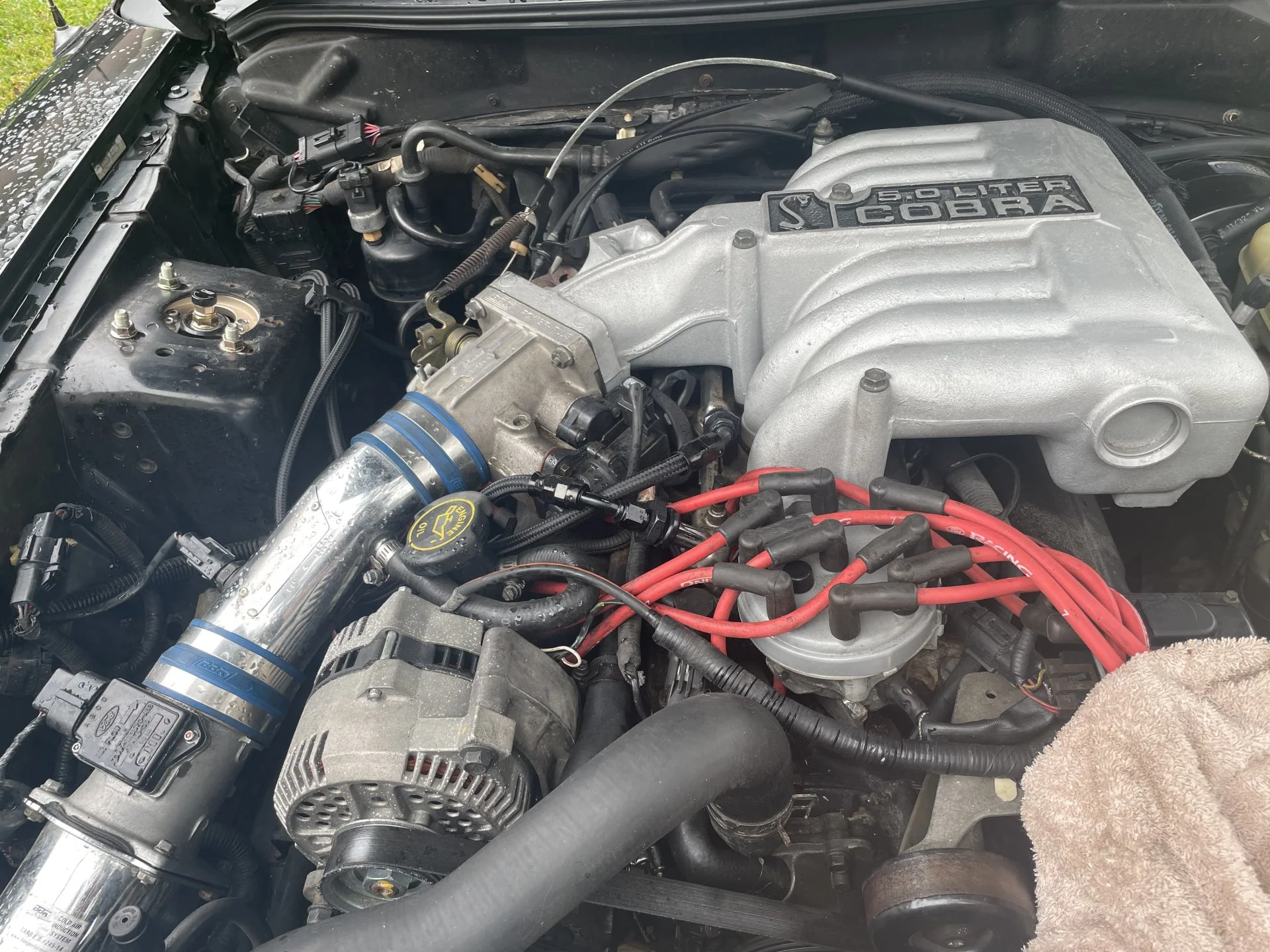

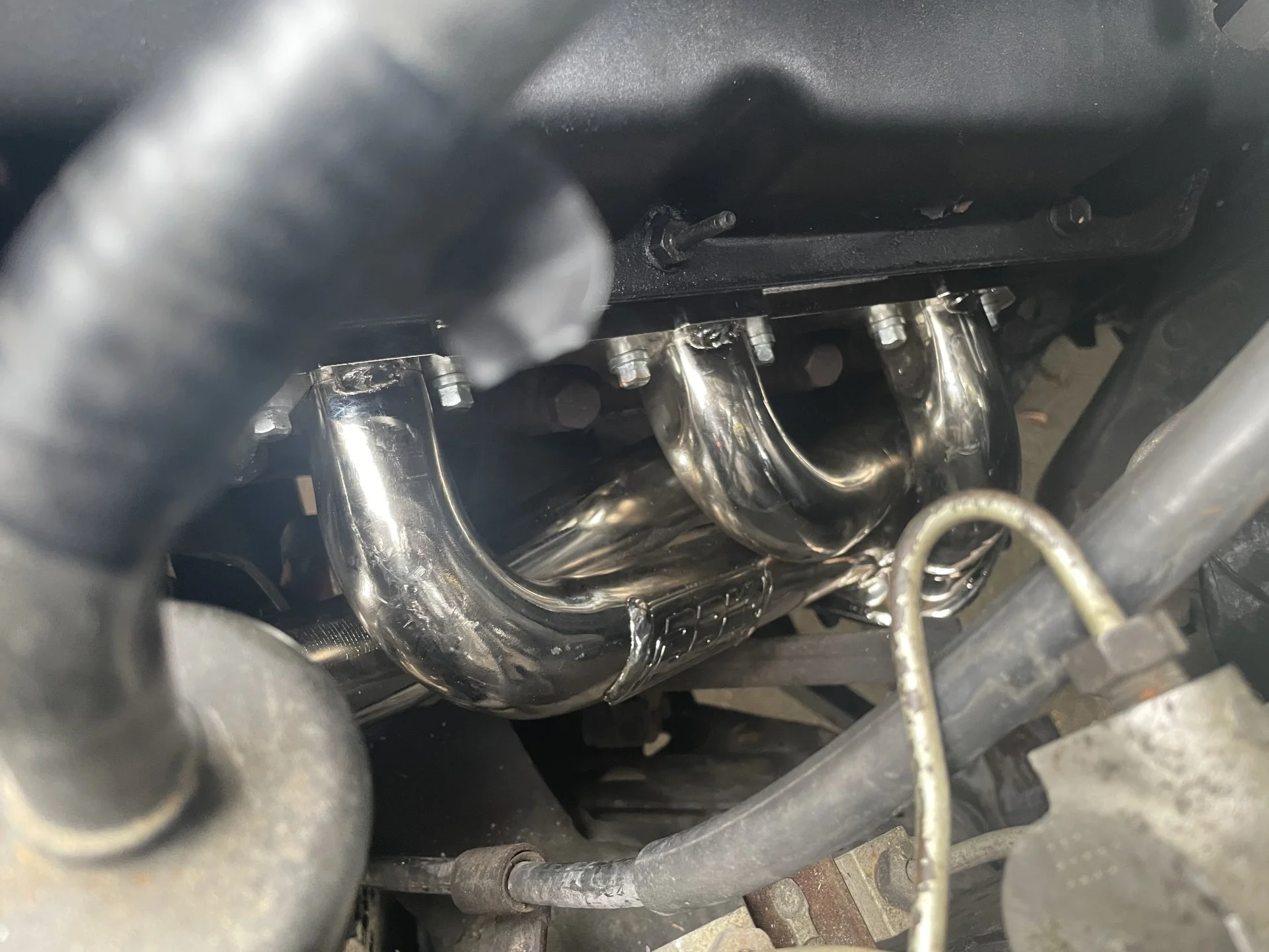

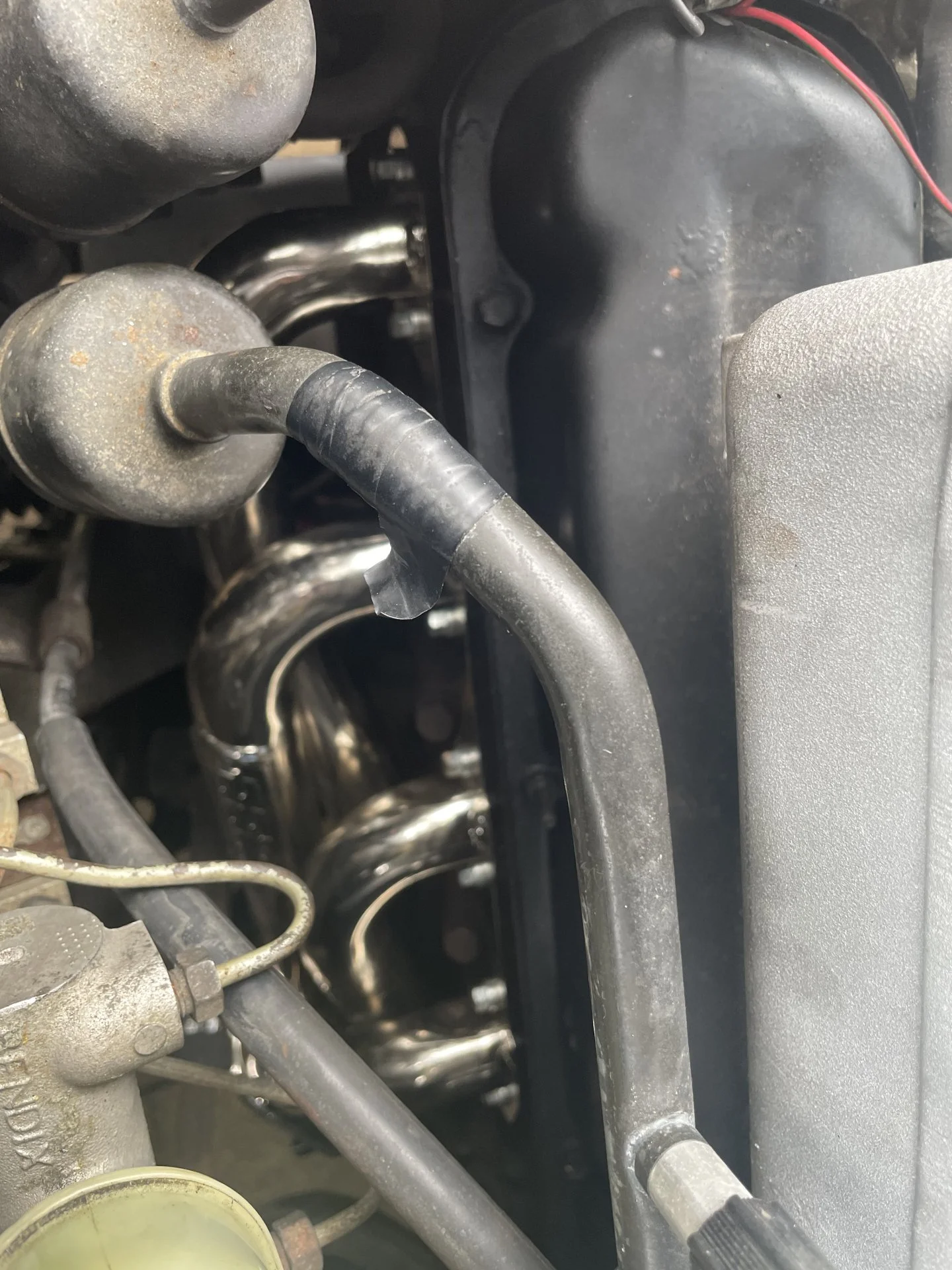

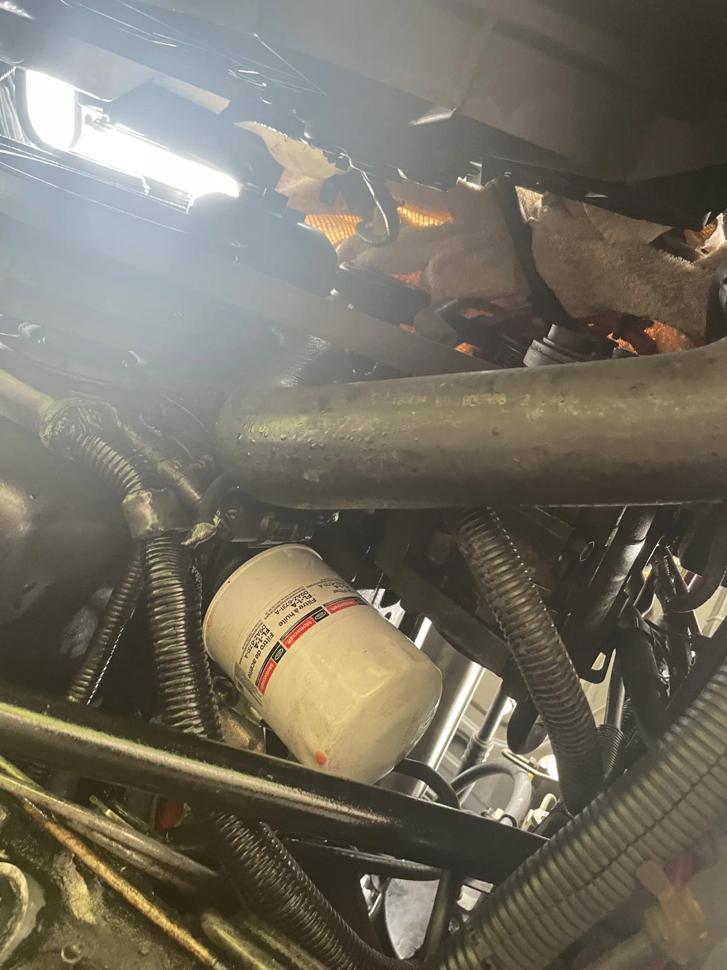

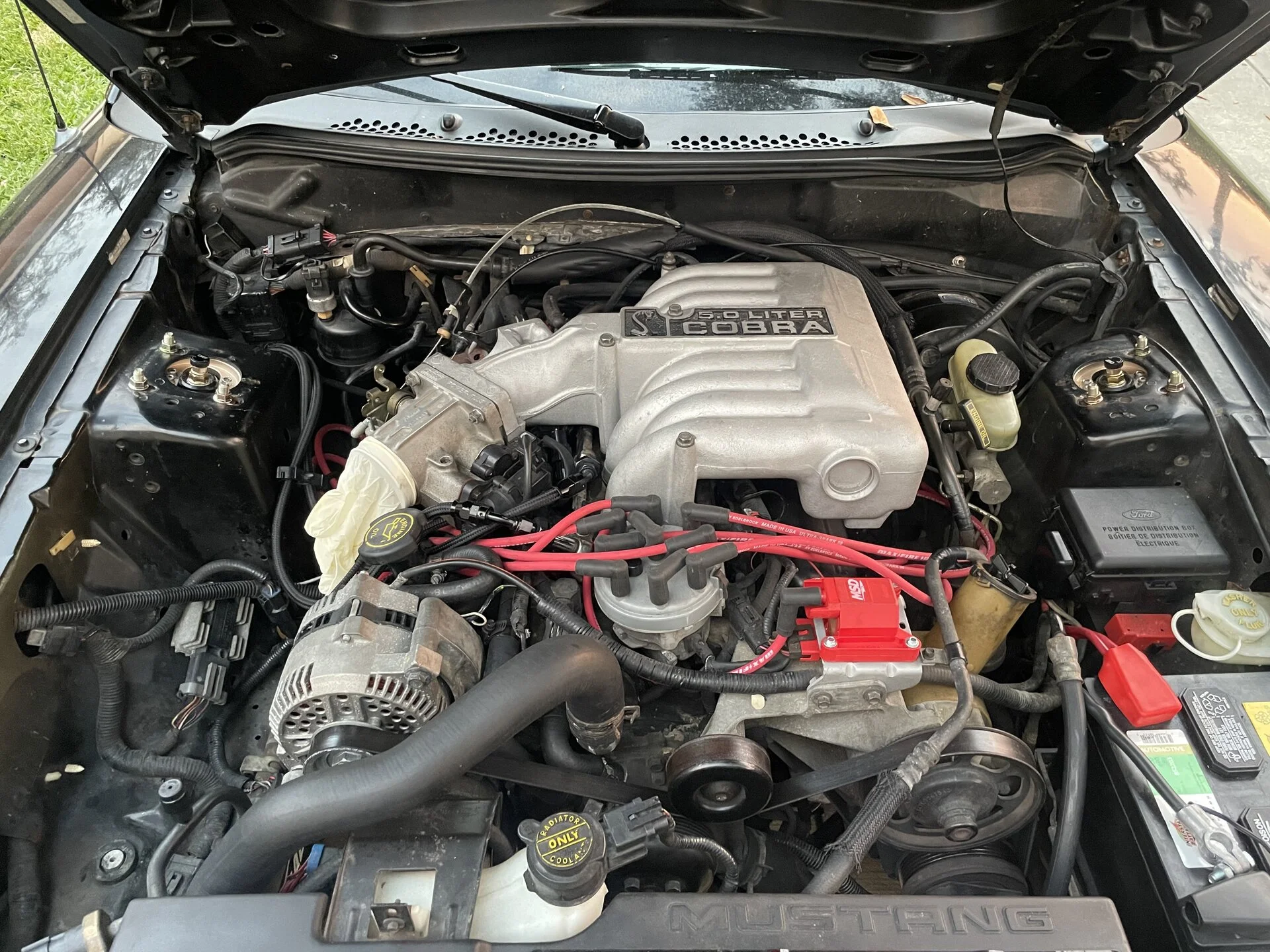

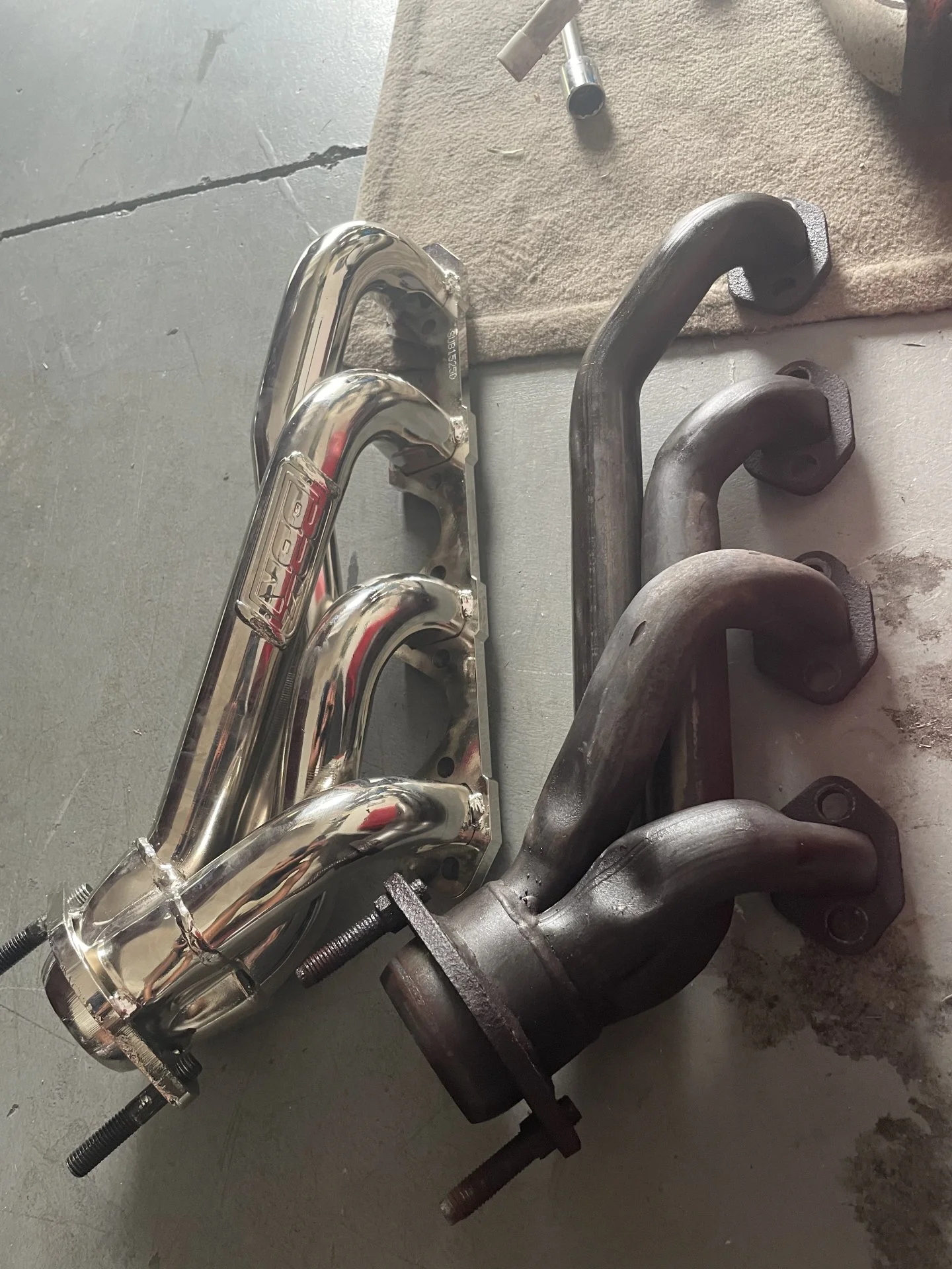

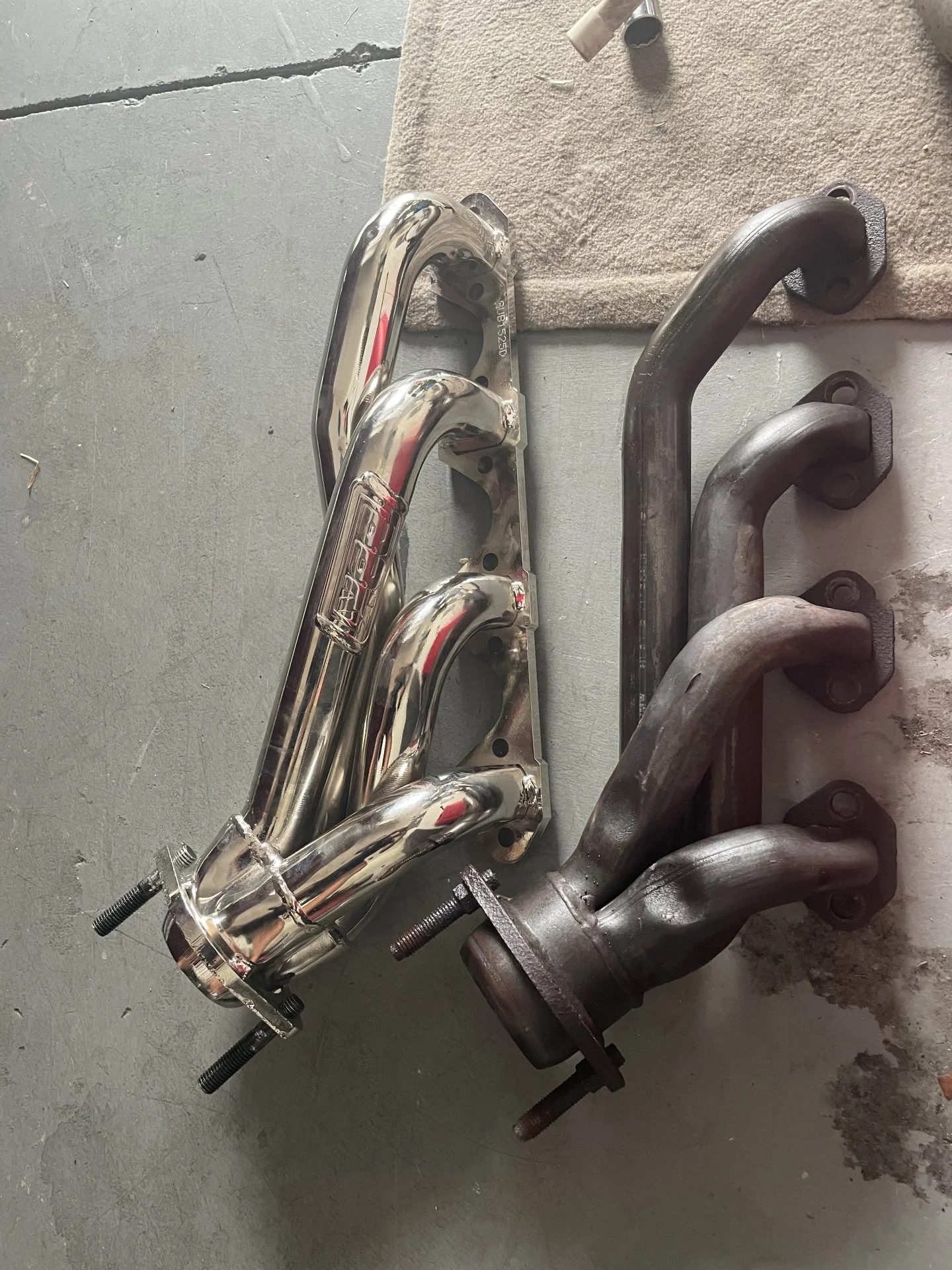

I deleted the oil cooler and tossed in an FL-1A. This is to clear up space for the Vortech Install. I also started on the shorty header install, driver side is out and the new one is going in, so far so good. I wanted the ceramic BBKs but my order from Jegs hasn’t shipped because they’re on back order so the chrome will have to do.

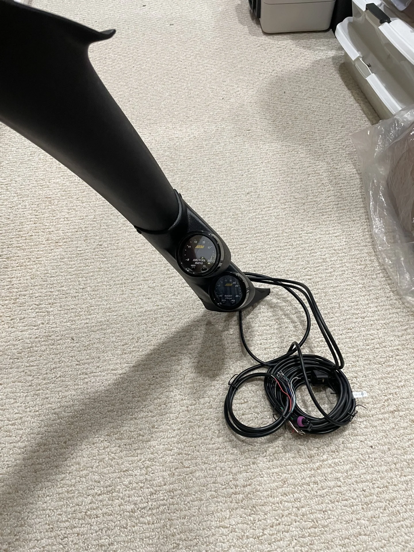

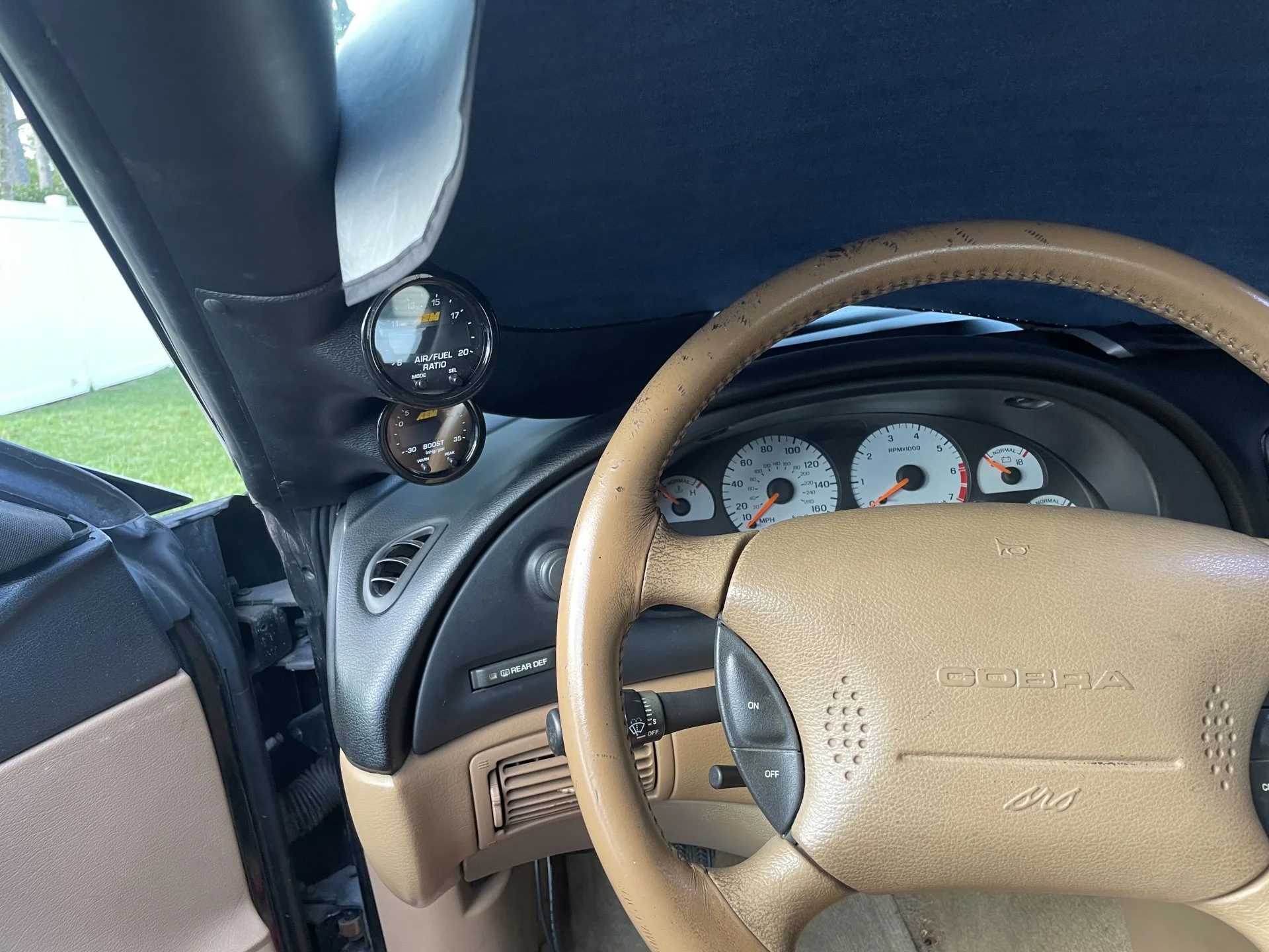

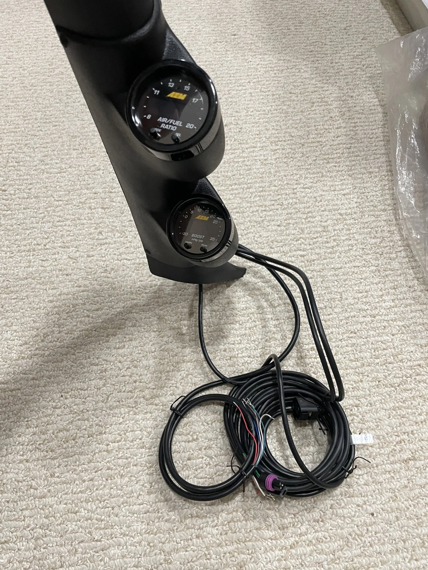

Depending on the rainy florida weather this week, I might also hook up the wideband and boost gauge and find somewhere to tuck up the boost gauge wiring. Going to have a bung welded into my test pipe for the wideband to reside and then run all the wiring for the pillar pod

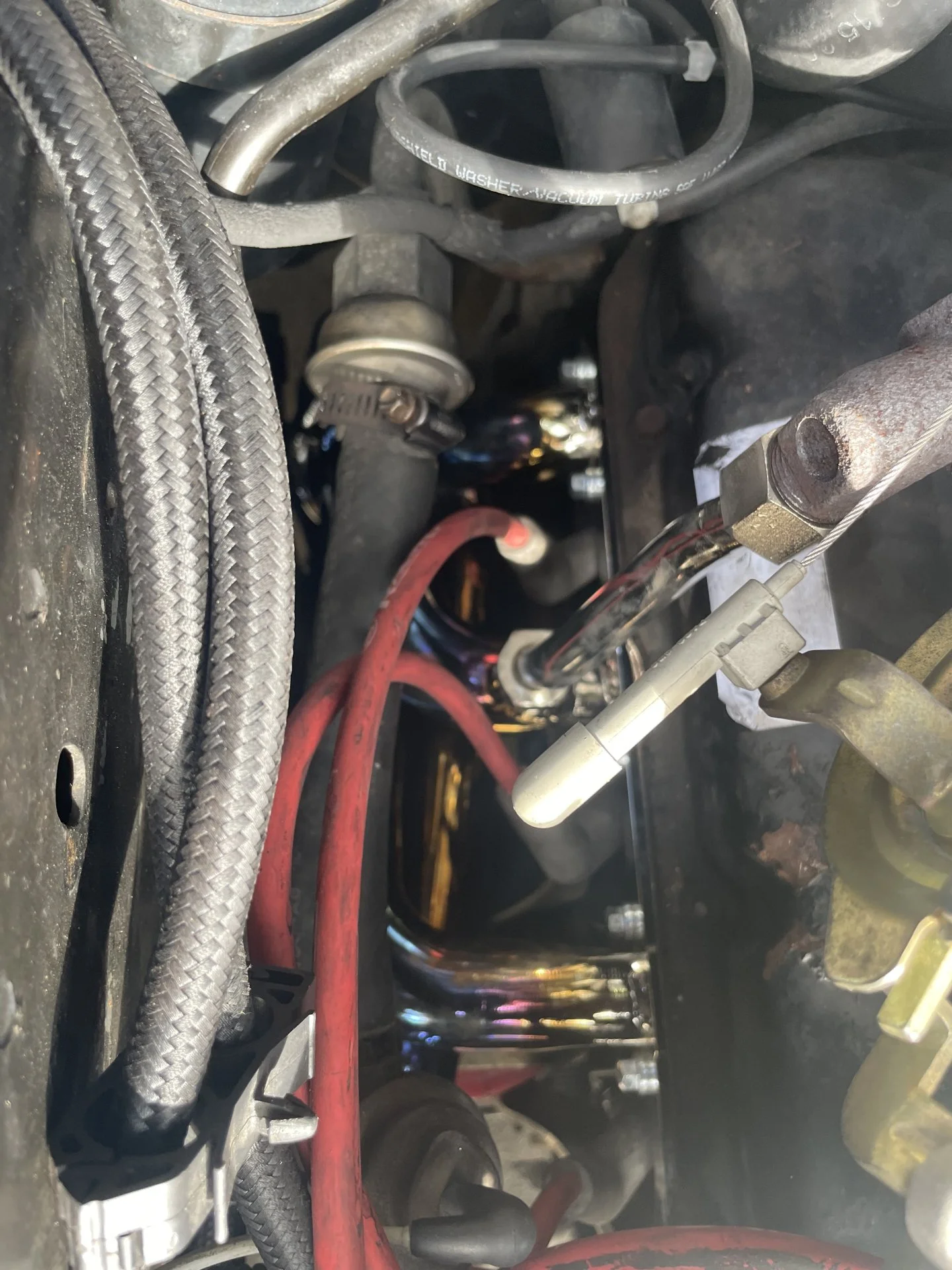

Passenger side was a breeze except for the EGR tube. The nut snapped down the middle after a few turns with a 3 foot pipe. My BBK EGR flare fitting came cracked so I have to wait for them to overnight the part so the car is just awaiting install. In the meantime I hooked up the power and ground to the gauges using an add a fuse. Will run the wires to the wideband and boost reference tomorrow, hopefully there will be a nice firewall grommet.

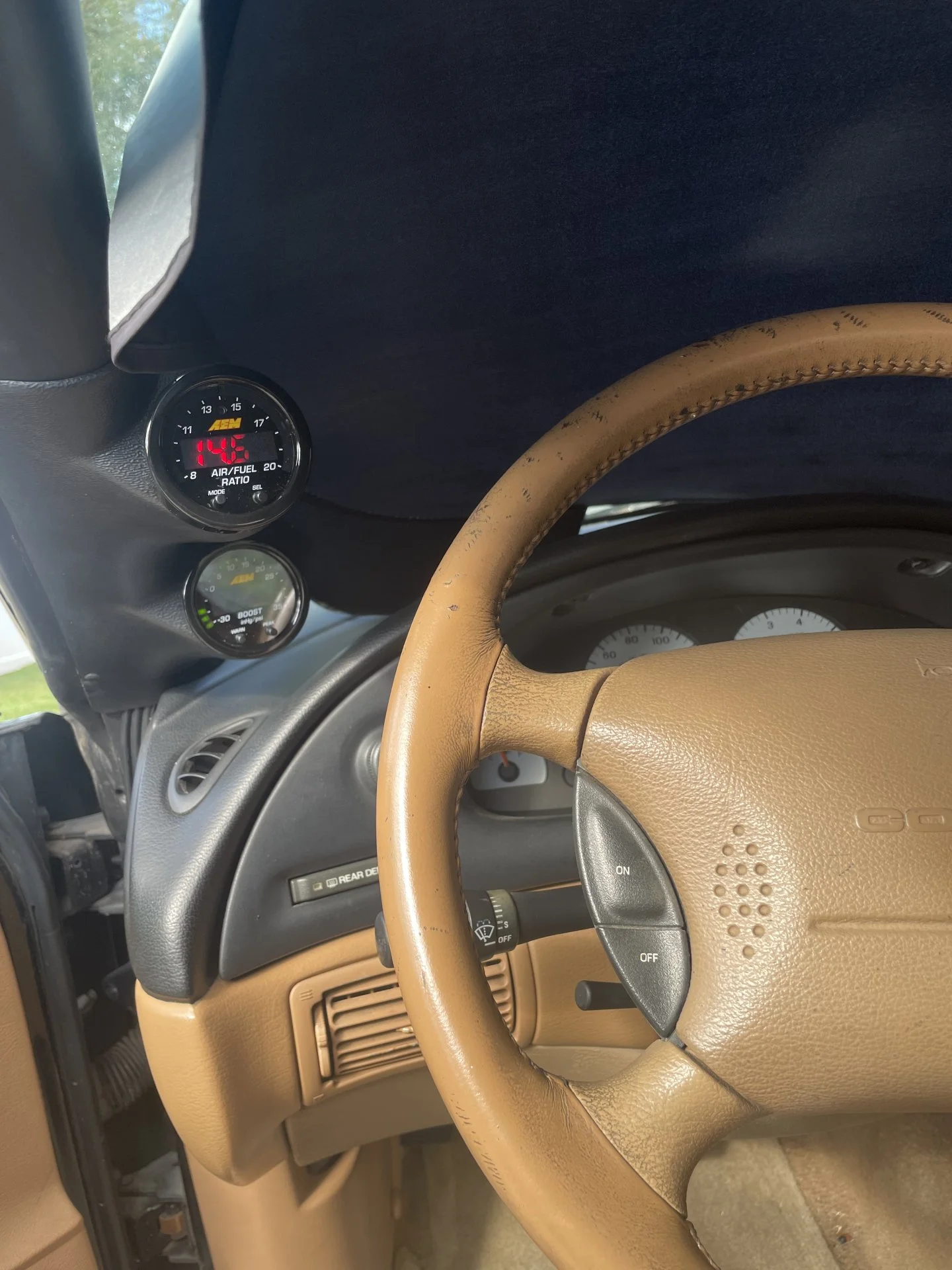

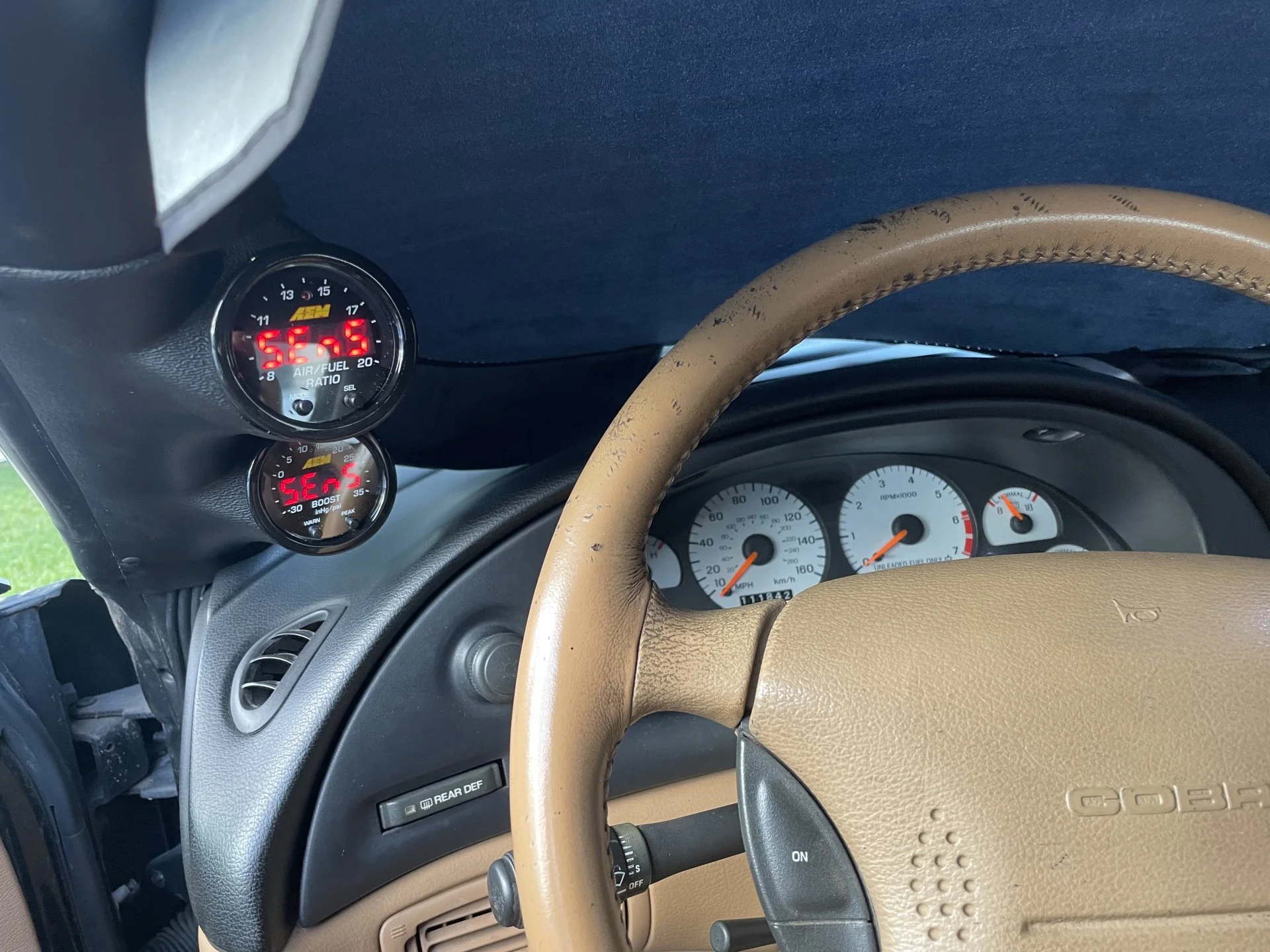

Finally got the wideband bung welded on the connection pipe so I could button everything together. Ran the boost line and wideband sensor and got all that hooked up. Took it for a test drive after a long two weeks on the ramp. Seemed a little lean at 13.0 for WOT, noticed a slight tick in 2-3 gear at low speeds on the way back in, will recheck bolt torque first. Pics:

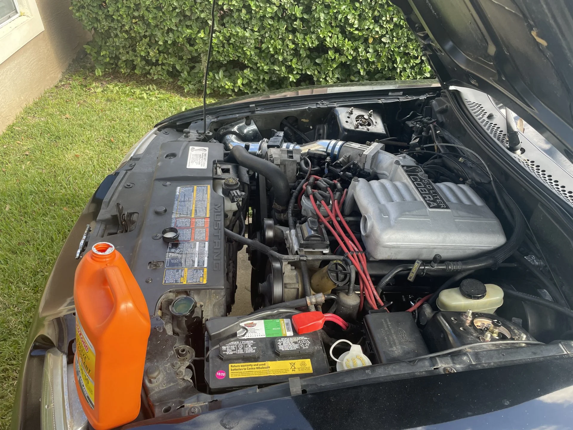

I went ahead and placed an order for an FL-1A filter, GT bypass hose, and some -20 windshield washer fluid (roughly 30 percent methanol). I am going to delete the factory oil cooler to reduce some engine bay clutter and simplify the vortech install.
Otherwise the car has been great, on full daily duty while the CTS-V is down. My MPG average dropped to about 17.5 with the 3.73 gears but I still absolutely love them. The car is much punchier now and an absolute blast to drive

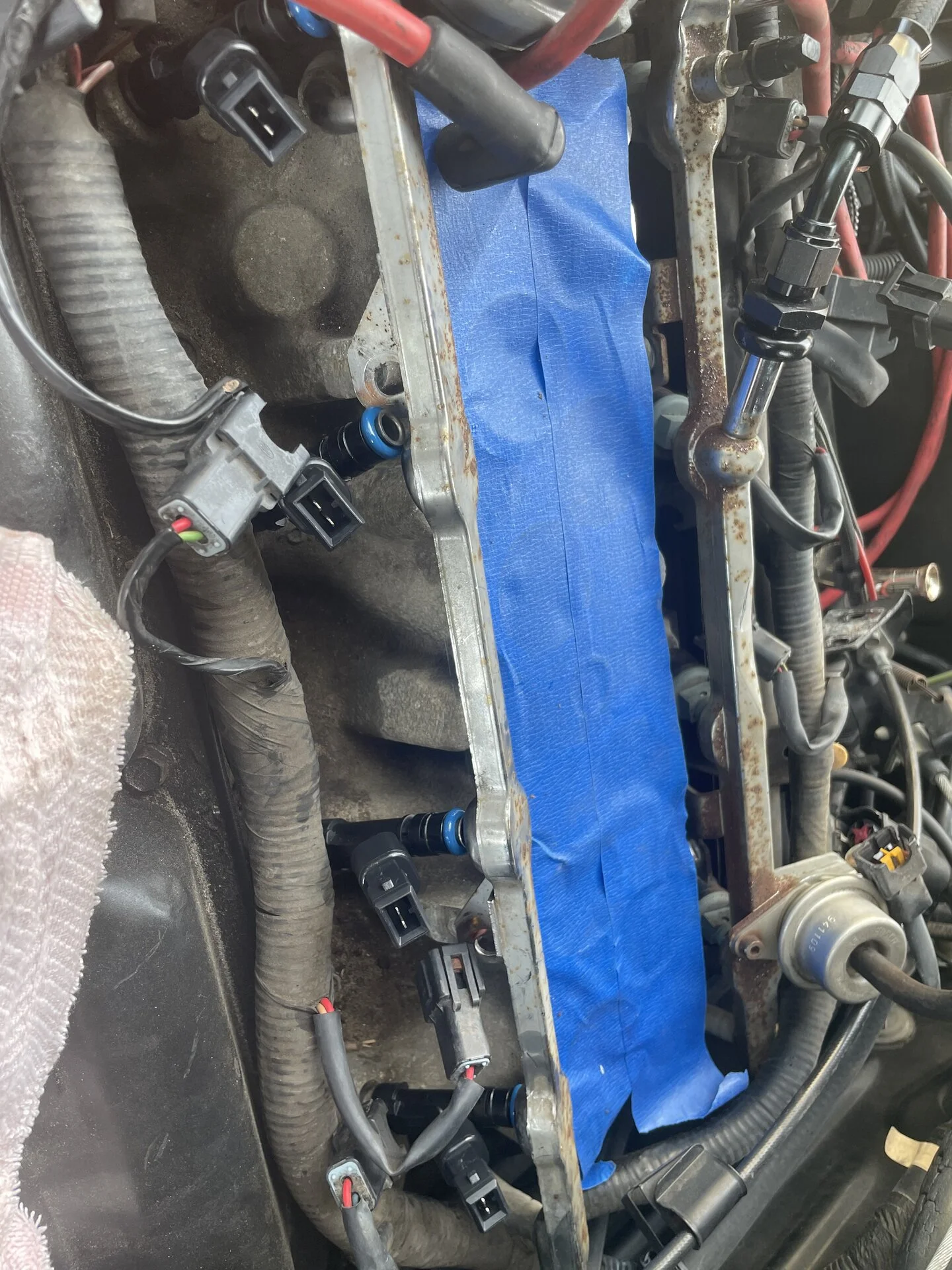

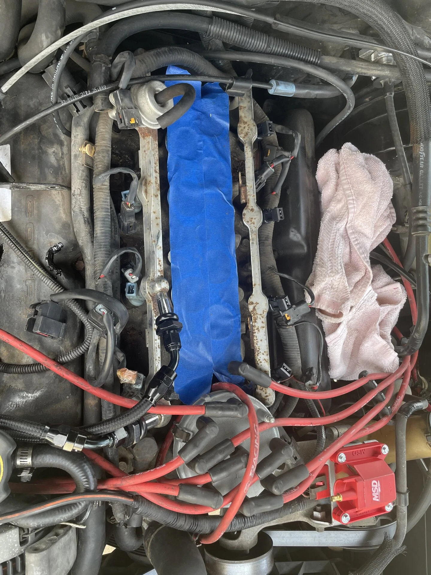

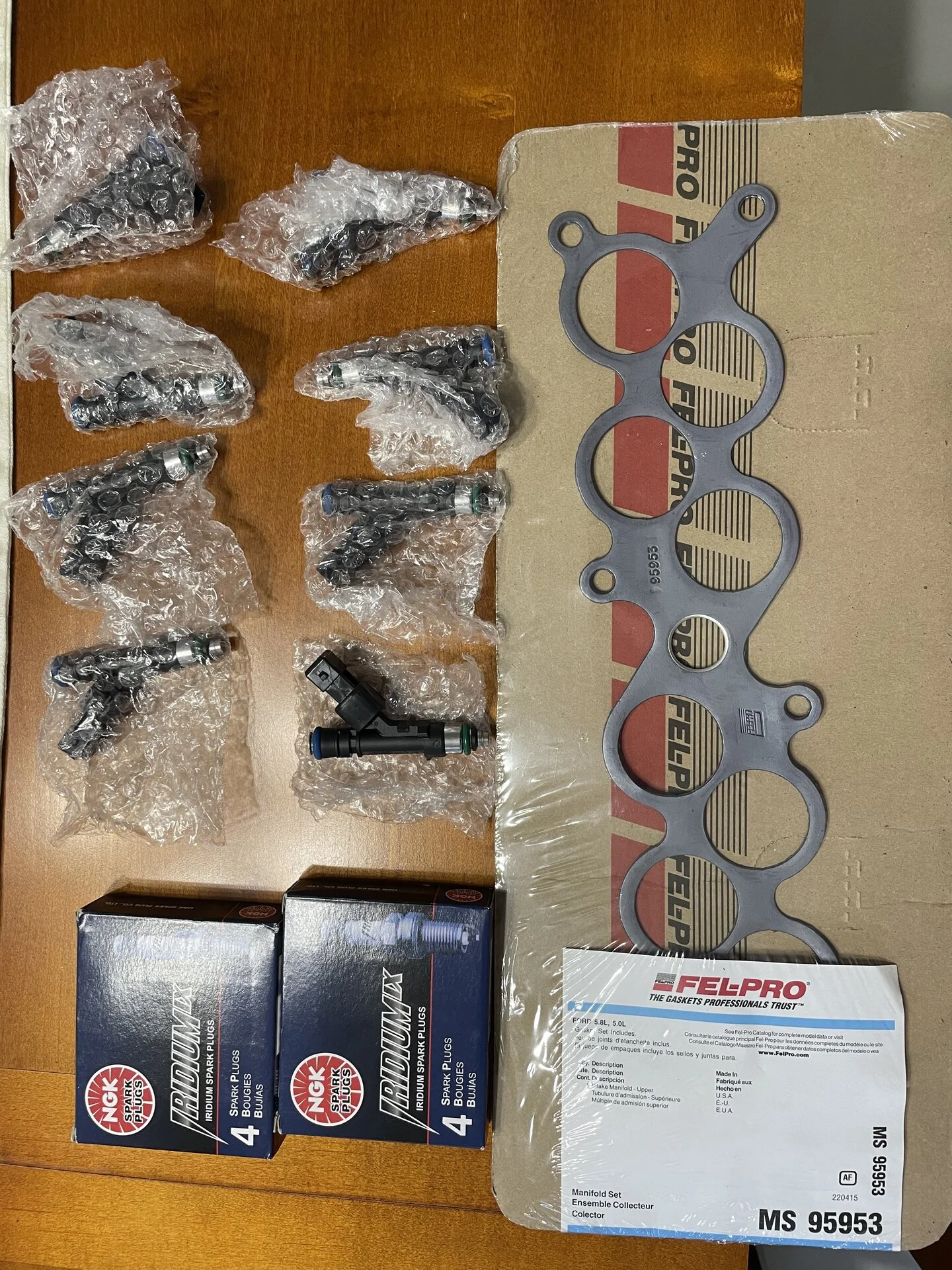

The time has finally come! Tomorrow will be the first day of blower install. My goal is to pull the upper intake, install the Ford 47lb injectors, install TR6 plugs, new plug wires and seal back up the intake with a fresh gasket. Modest day of work to begin with. After that, I will begin on the methanol kit. I have some camber bolts I’m also going to throw in to straighten up the front end. Currently has 3 deg neg camber
Todays tasks finished:
-TR6 Iridum Plugs installed
-Edelbrock Ultra 50 plug wires
- New upper intake gasket
-47lb Ford Racing Injectors
- MSD Blaster Coil
-Drilled and tapped blower discharge for meth nozzle
Tomorrow I will begin with the vortech instructions and get to the main portion of the install now that the supporting mods are done.
Primed everything to make sure there were no leaks and all is well!

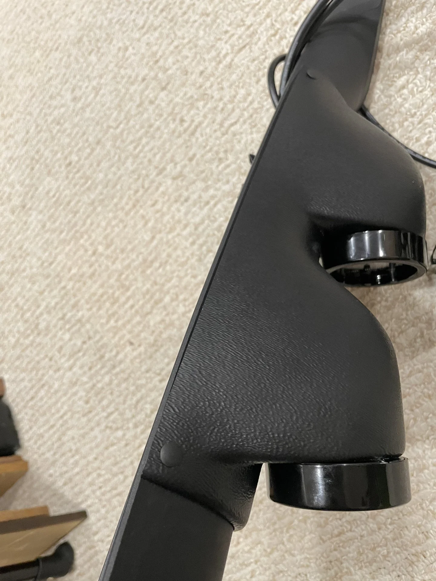

- Installed my custom gauge pod for methanol controller and connected power and ground, still need to mount pump and reservoir to finish wiring

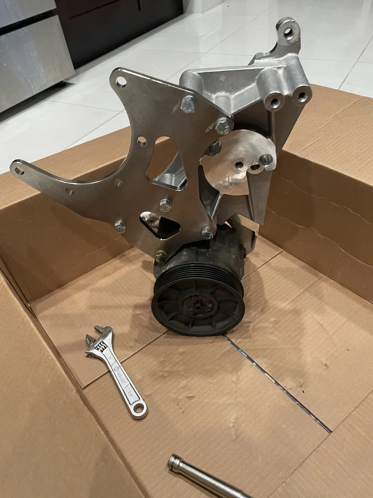

- Removed coolant hoses, water pump pulley, crank pulley, alternator and smog pump + associated brackets

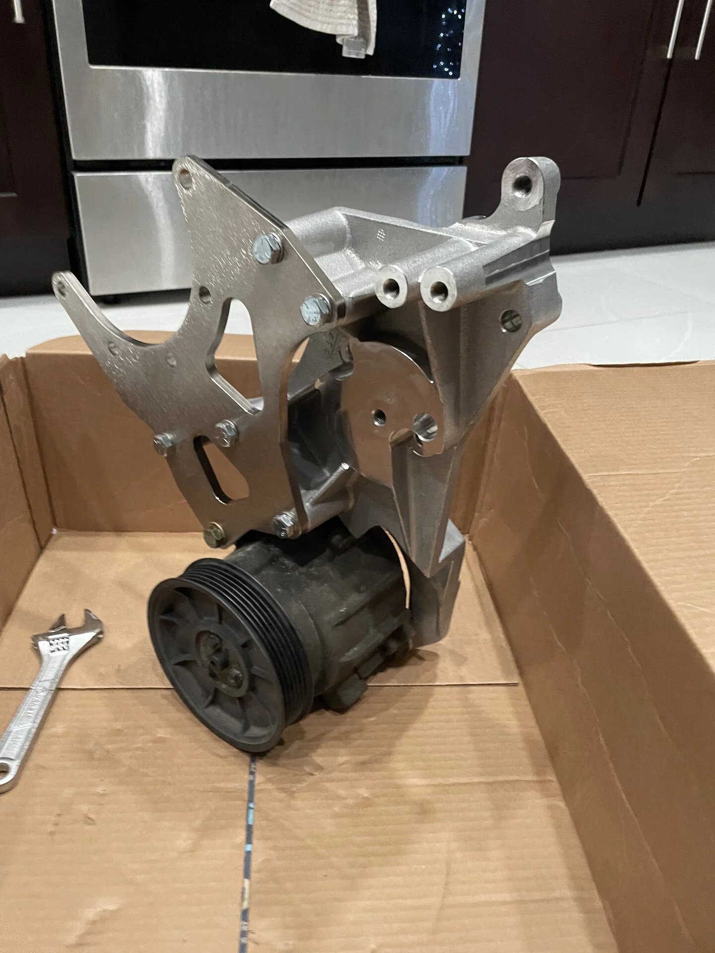

-Assembled Vortech bracket and it is ready to install into the car tomorrow
My goal for tomorrow is to mount the meth pump and install new windshield washer reservoir and run all the feed lines, cut the hole for the power pipe, trim coolant hard tube and install the vortech bracket. The goal right now is to have the car on the road by Sunday
