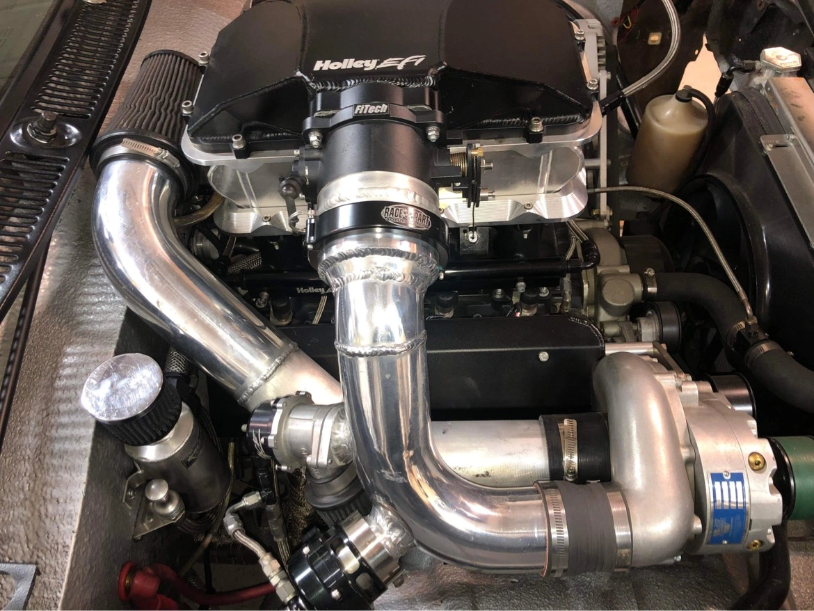

The blower has arrived…

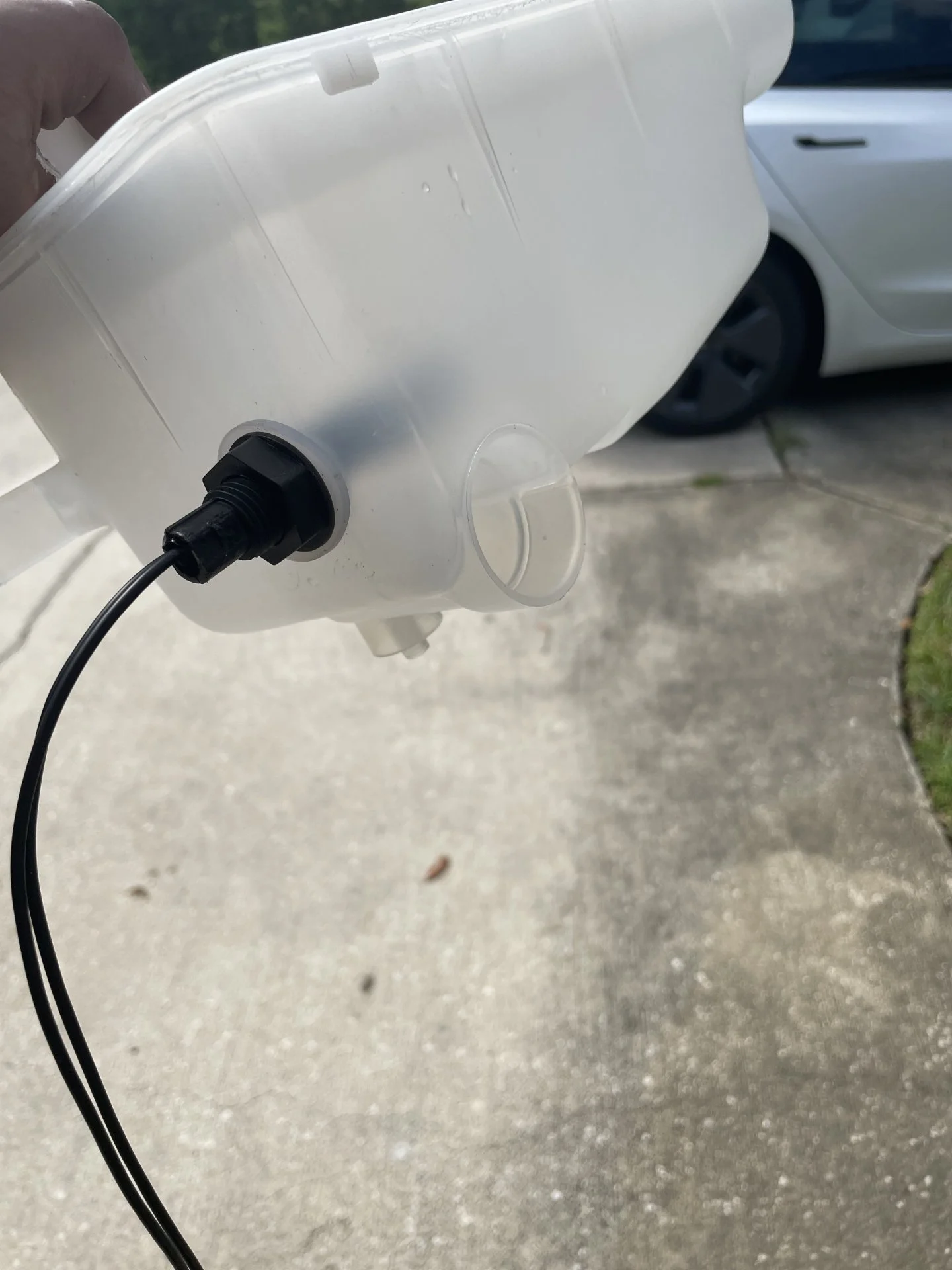

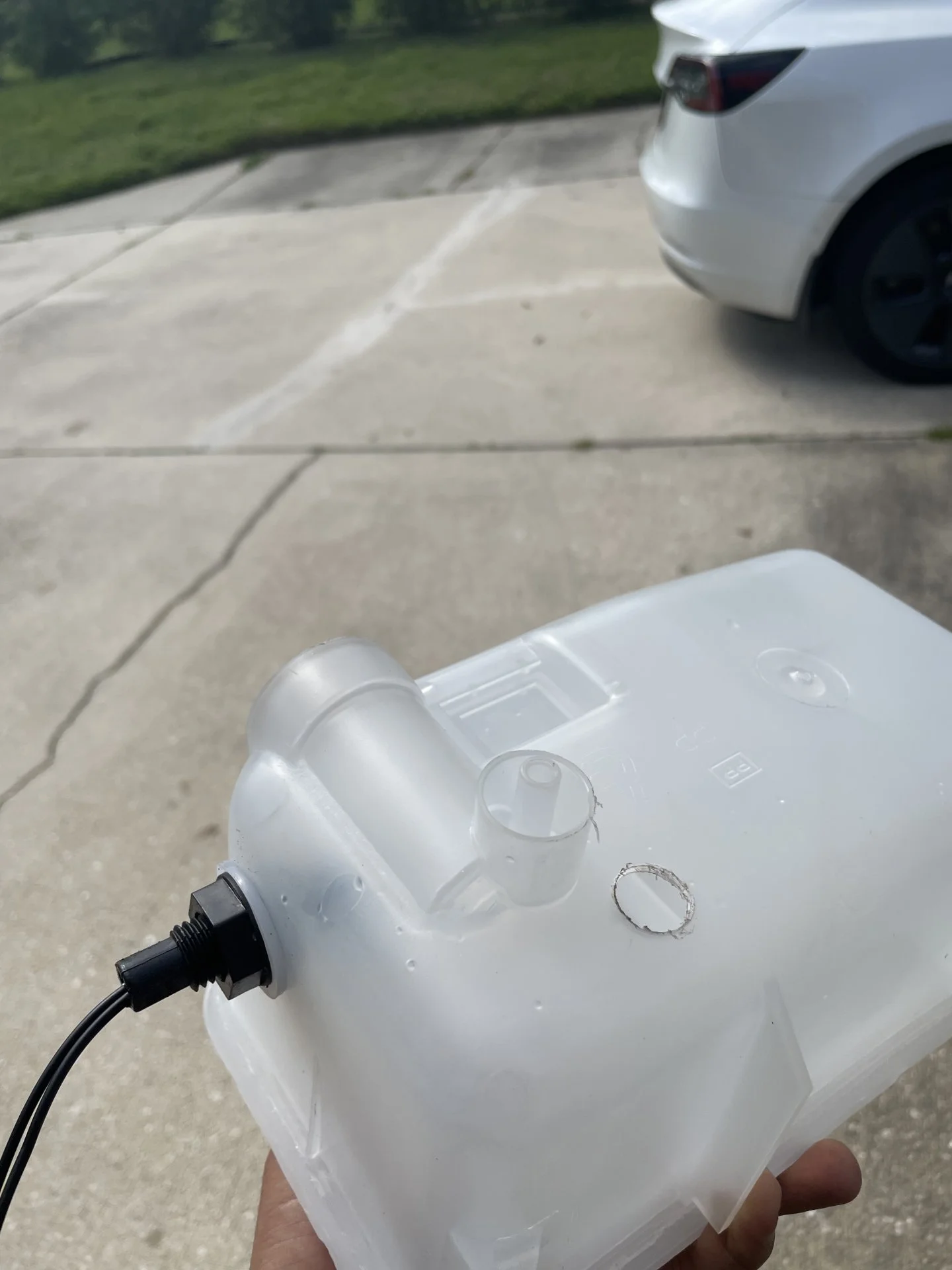

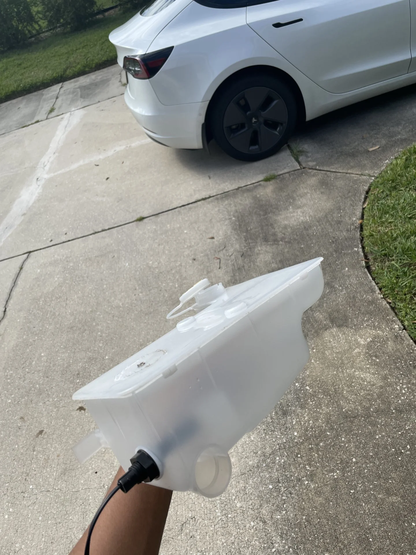

Got a new windshield reservoir to hack up. Drilled and tapped for the AN feed and low level sensor
