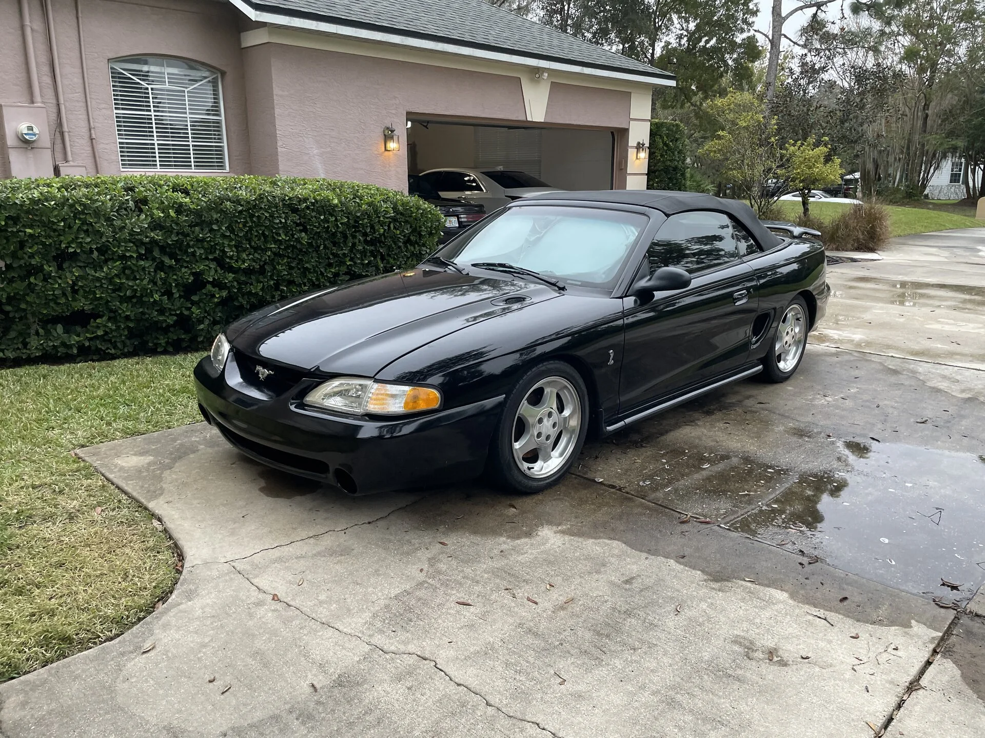

Decided I would list my wheels for sale at a higher price and see what happens as I already had my eyes on a new setup for V2 of the car. Listed them at $800 and one day later they are gone! Back to the stock wheels for now. Loving the look of the OEM

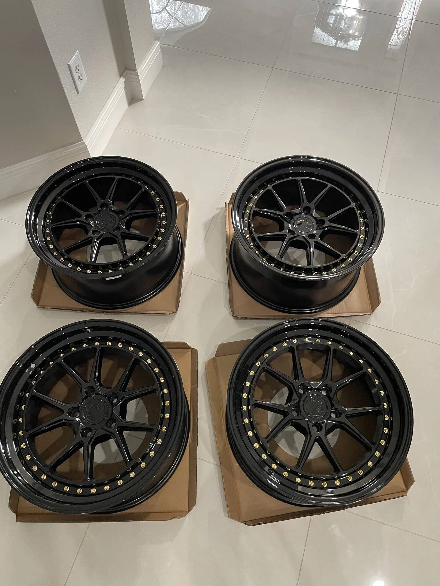

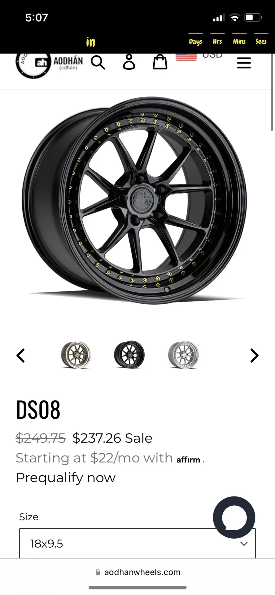

The setup will be Aodhan DS08 18x8.5/9.5
Front tires: 245/40/18 some cheaper all season
Rear tires: Michelin Pilot Sport 4S 285/35/18
Reactions: 90sickfox and General karthief

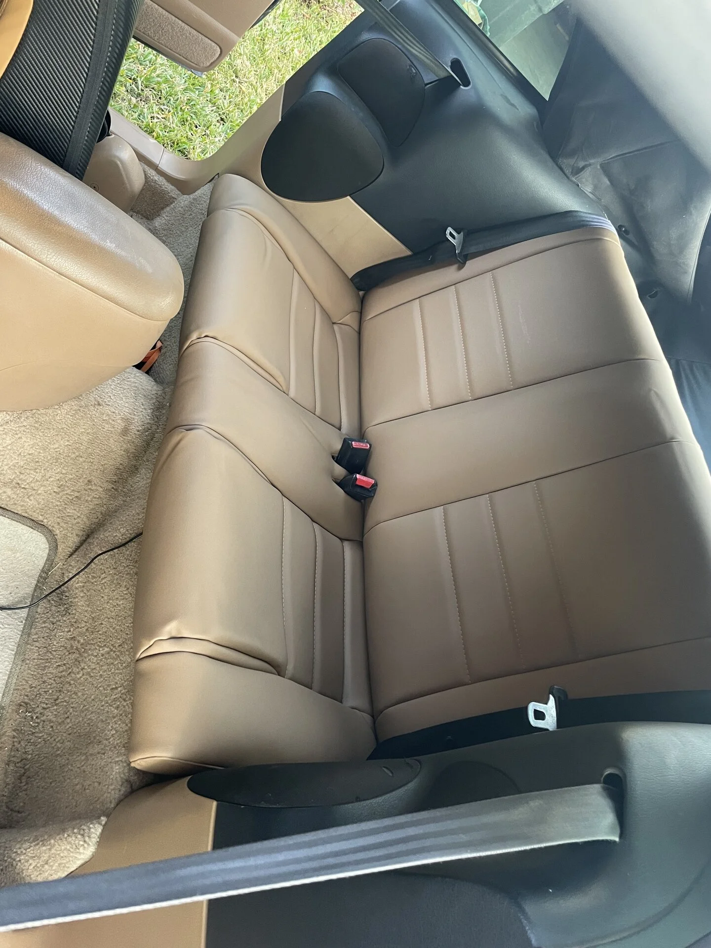

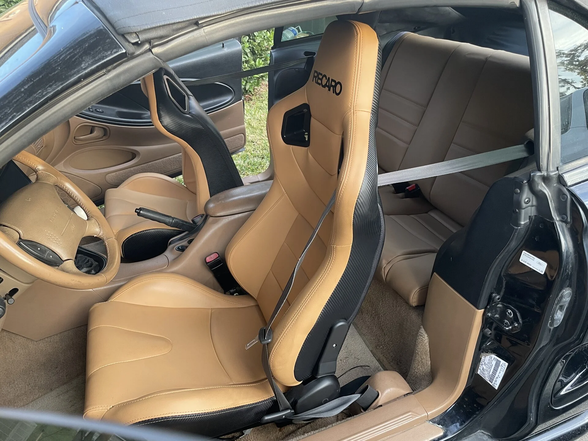

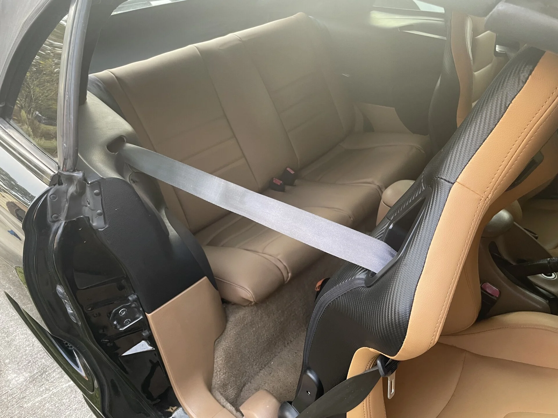

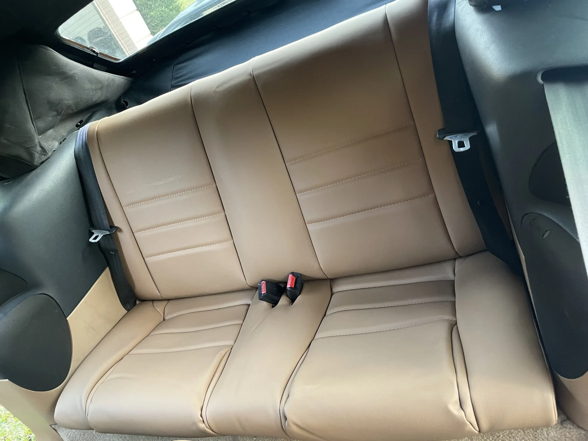

Rear seat upholstery installed and seats put back into place. Still want to steam out some creases but overall it looks much better having fresh vinyl in the car

Looks sooo much better, nice work!

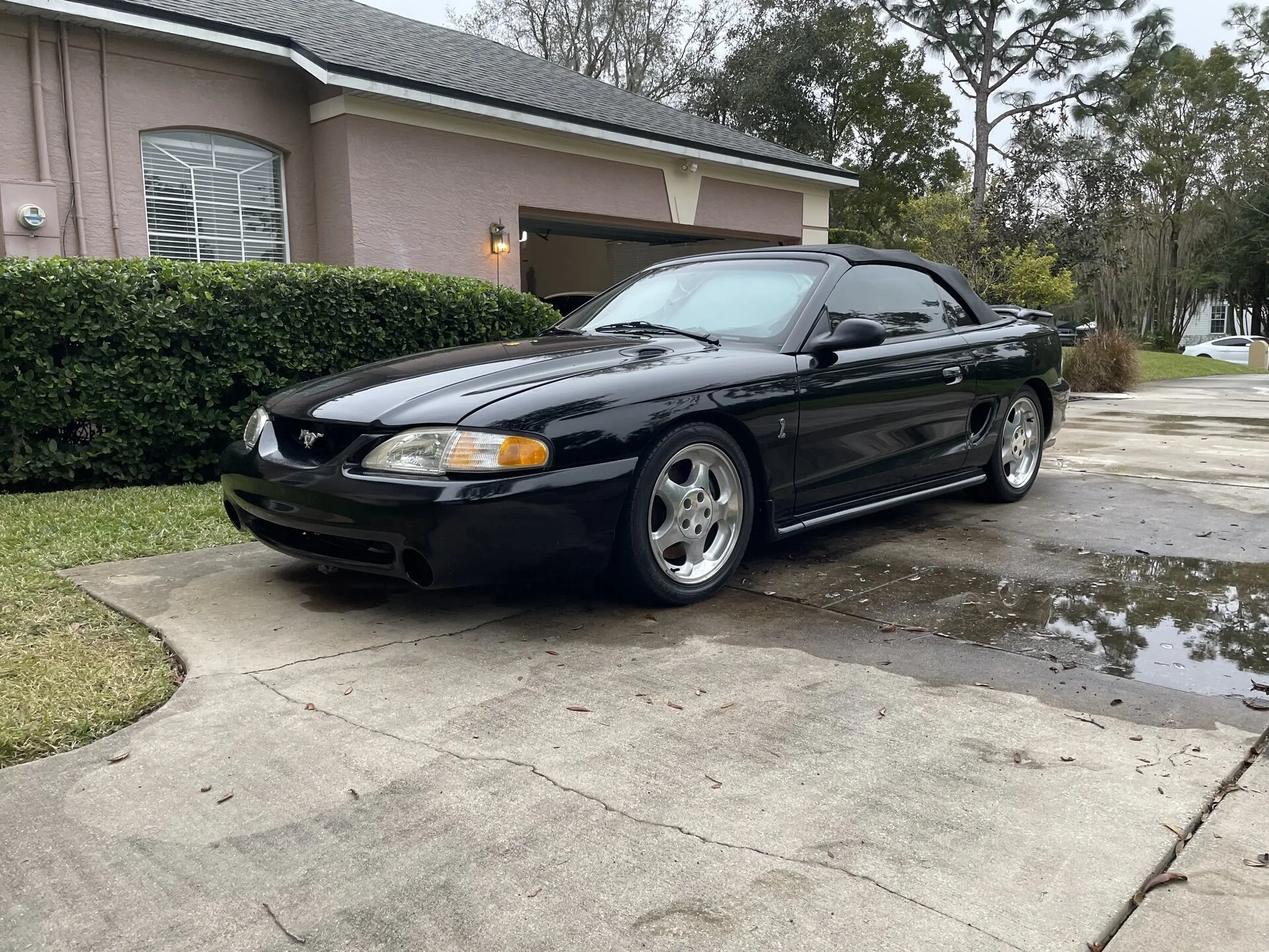

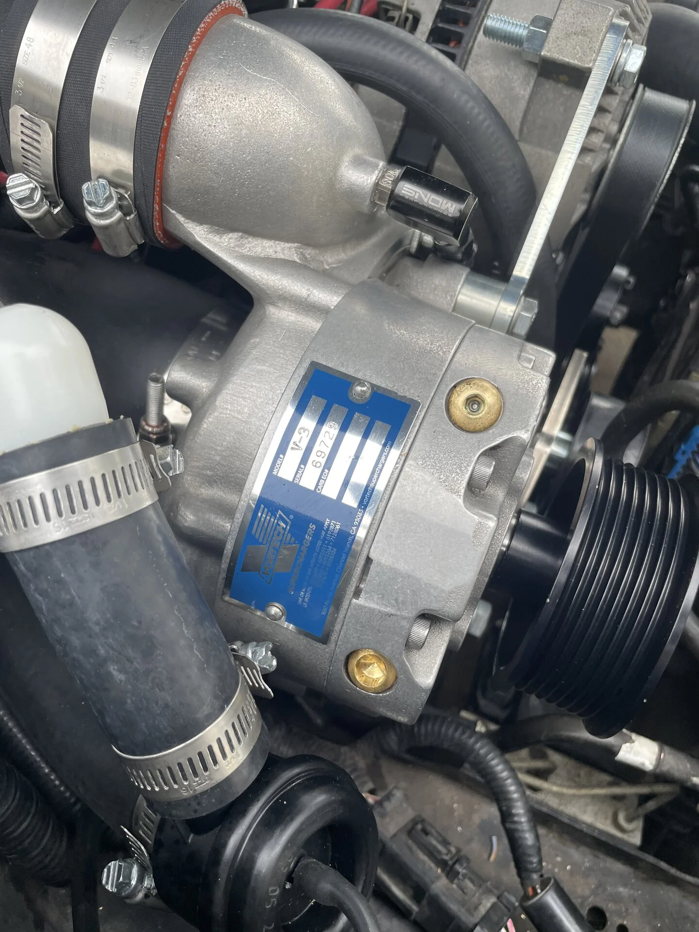

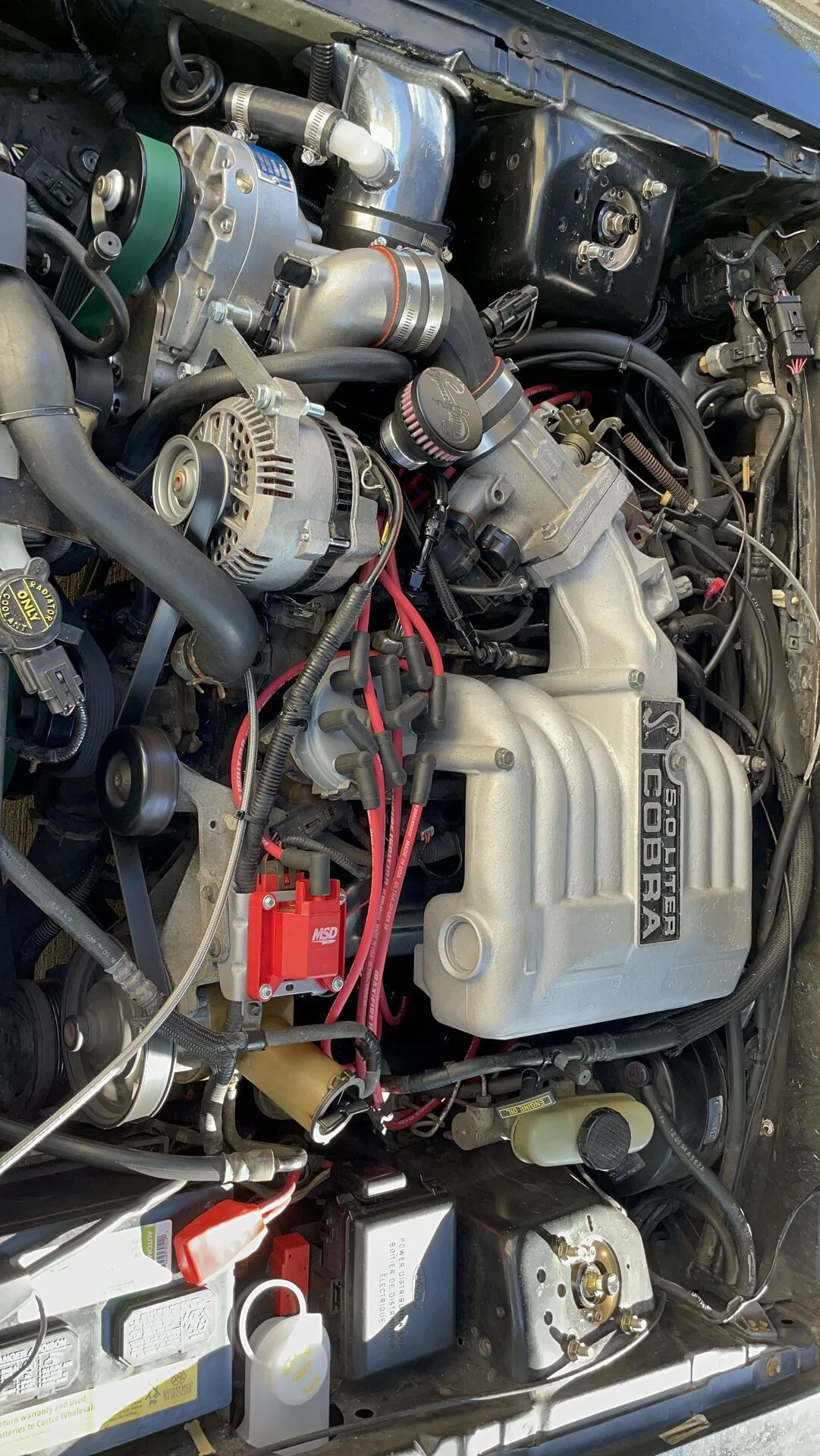

Amazon messed up 2 out of the three belts I ordered so 59 in was the only one I had but it worked perfectly. Tensioned it up and have her a start, idled beautifully and bled the coolant system. Took her for a quick 10 min drive to get the requested data from Willie. Awaiting the next revision for the next drive. Words cannot describe the happiness and satisfaction I felt finally driving the car after weeks of work and waiting

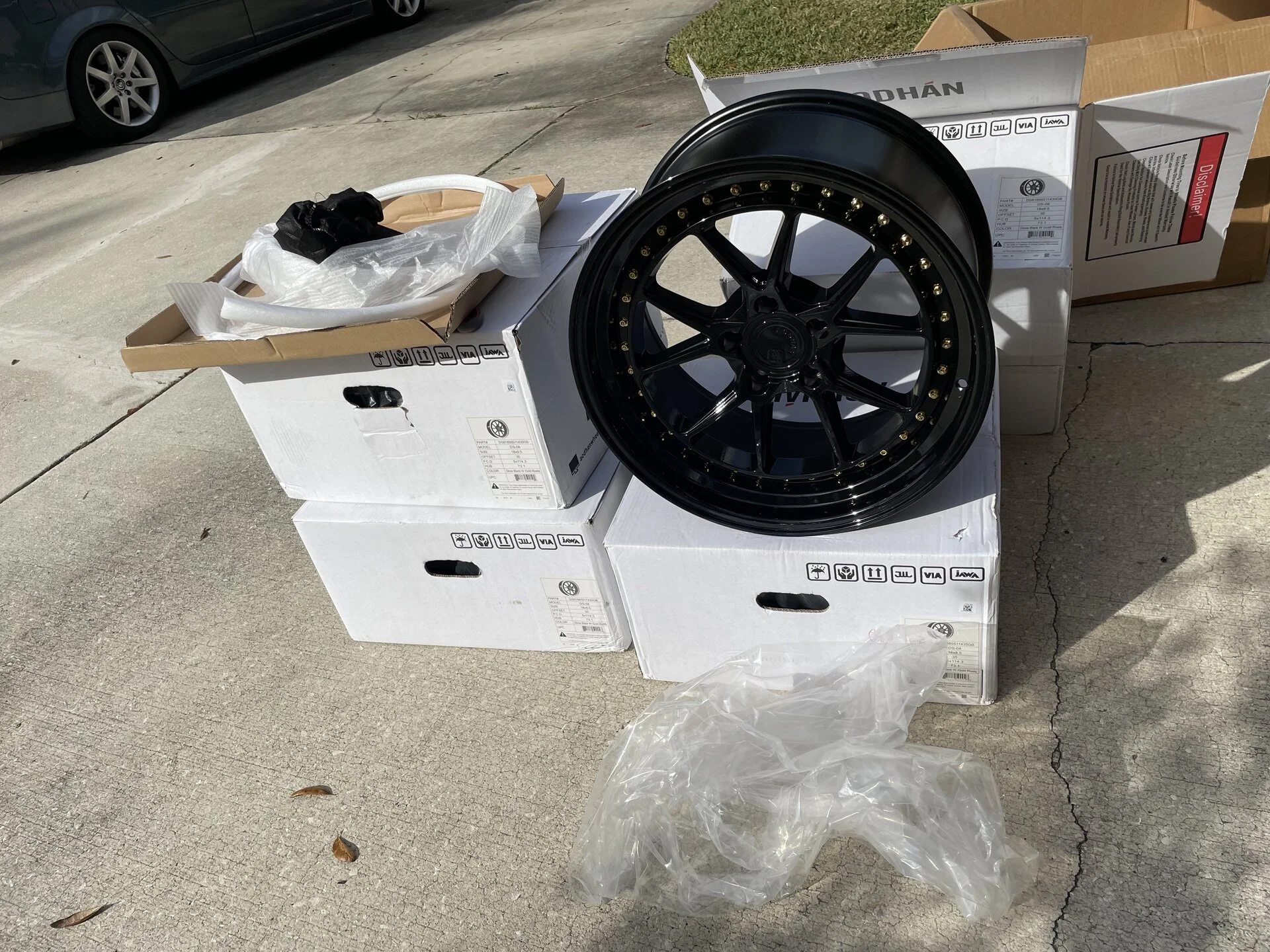

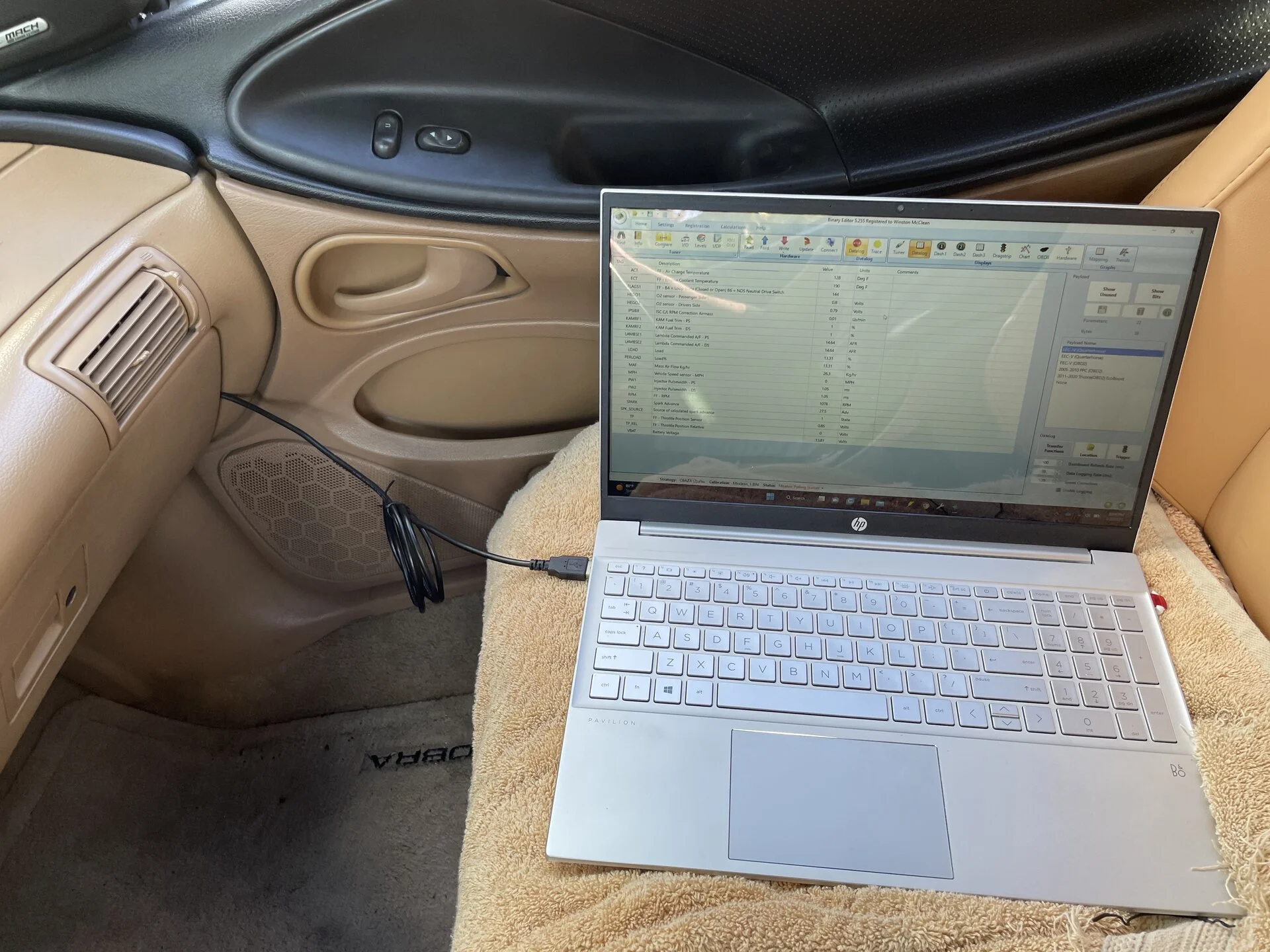

Willie is now logged in to Binary Editor remotely to make some changes. Hopefully today we can make some good progress on the tune. My wheels and tires were just delivered today so will try and pick those up later today

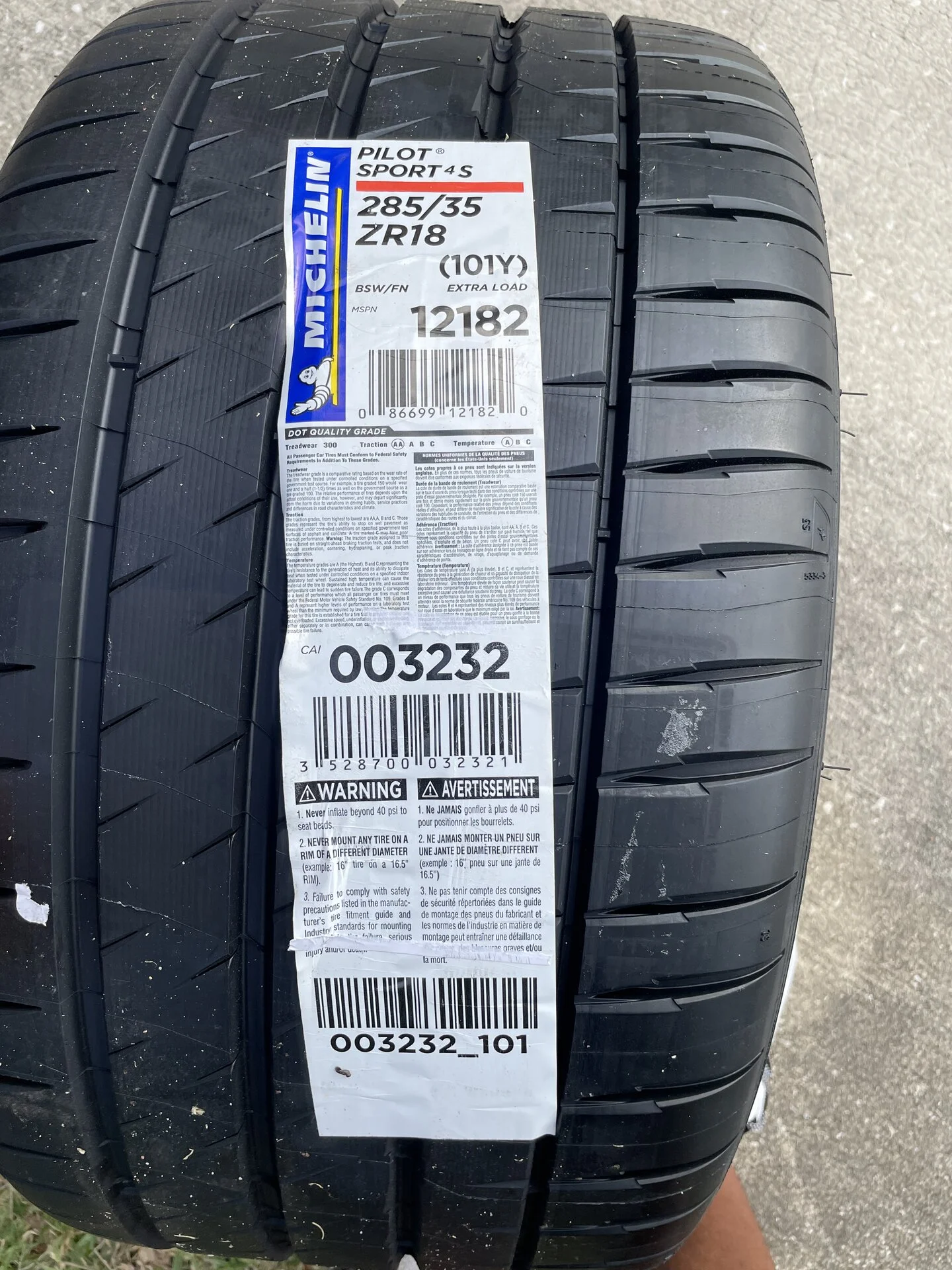

Wheels and rear tires are here! Getting them ceramic coated right now and booked an appointment to have them mounted/balanced on Thursday
