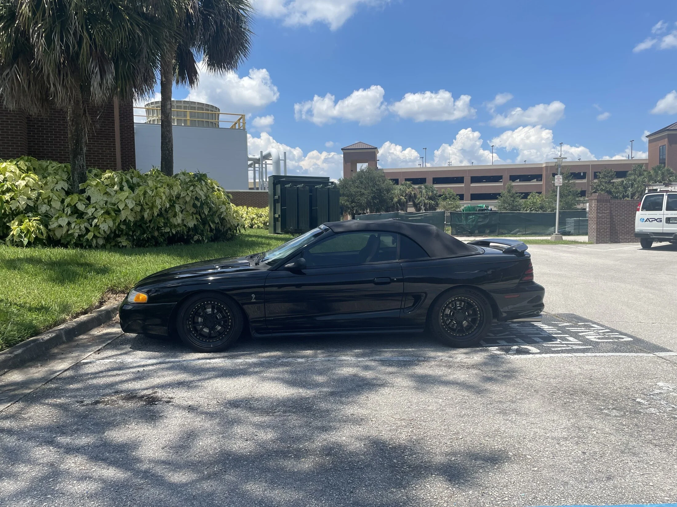

Swapped in autozone distributor and she started right up! Checked timing and set to 10deg. Runs great and pulls hard to redline

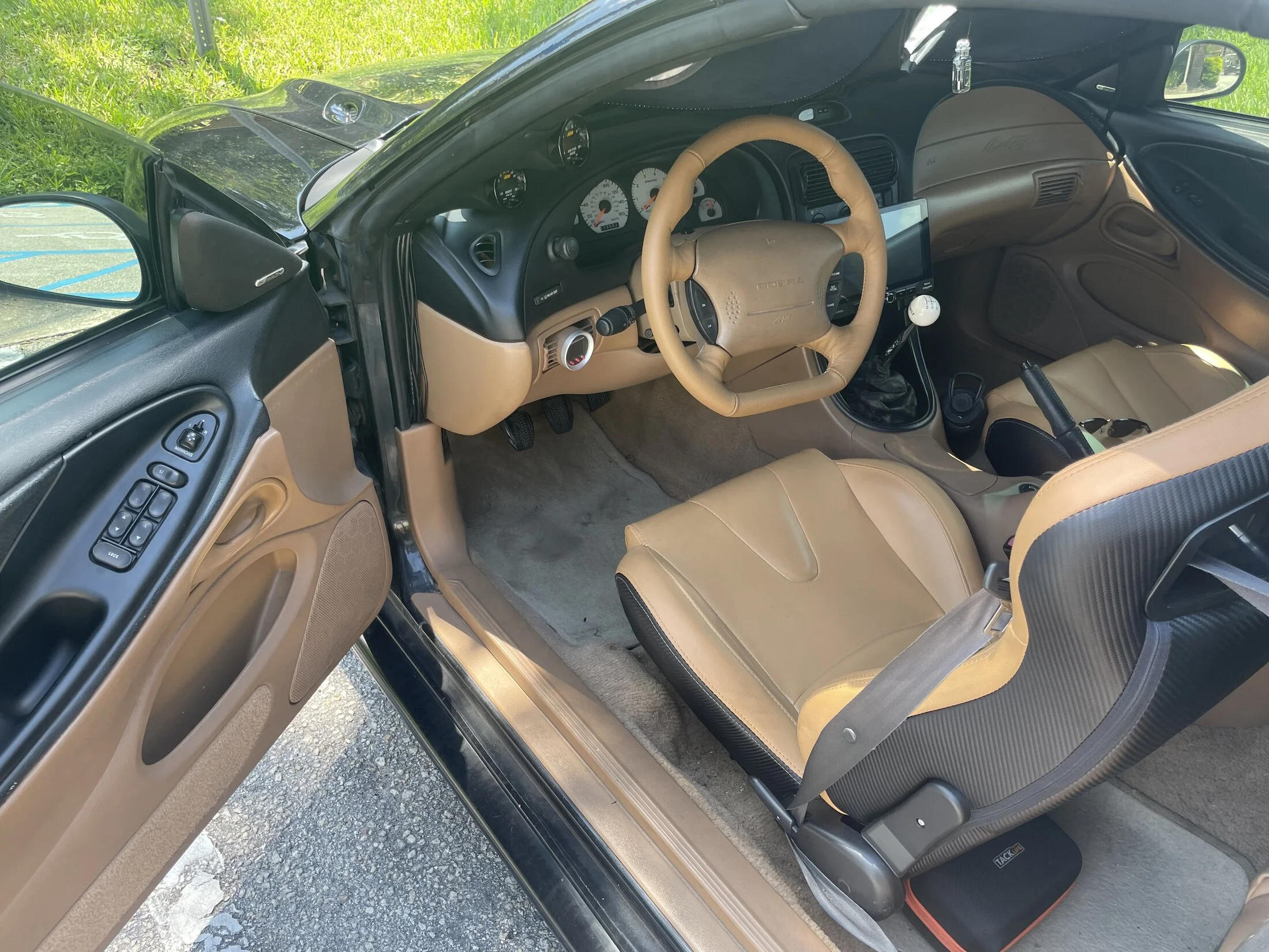

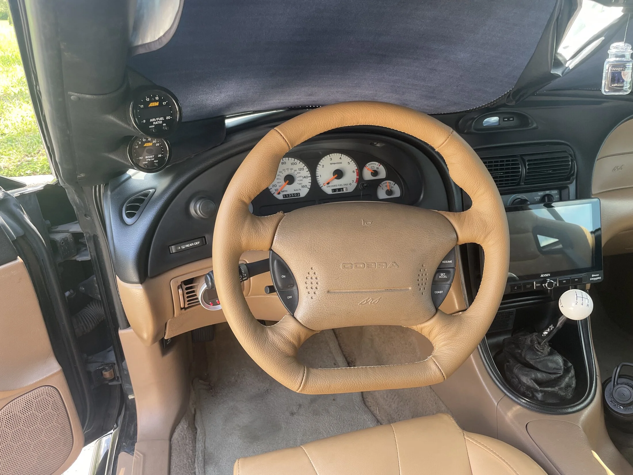

Back on daily duty to campus! Also a little update on the interior look

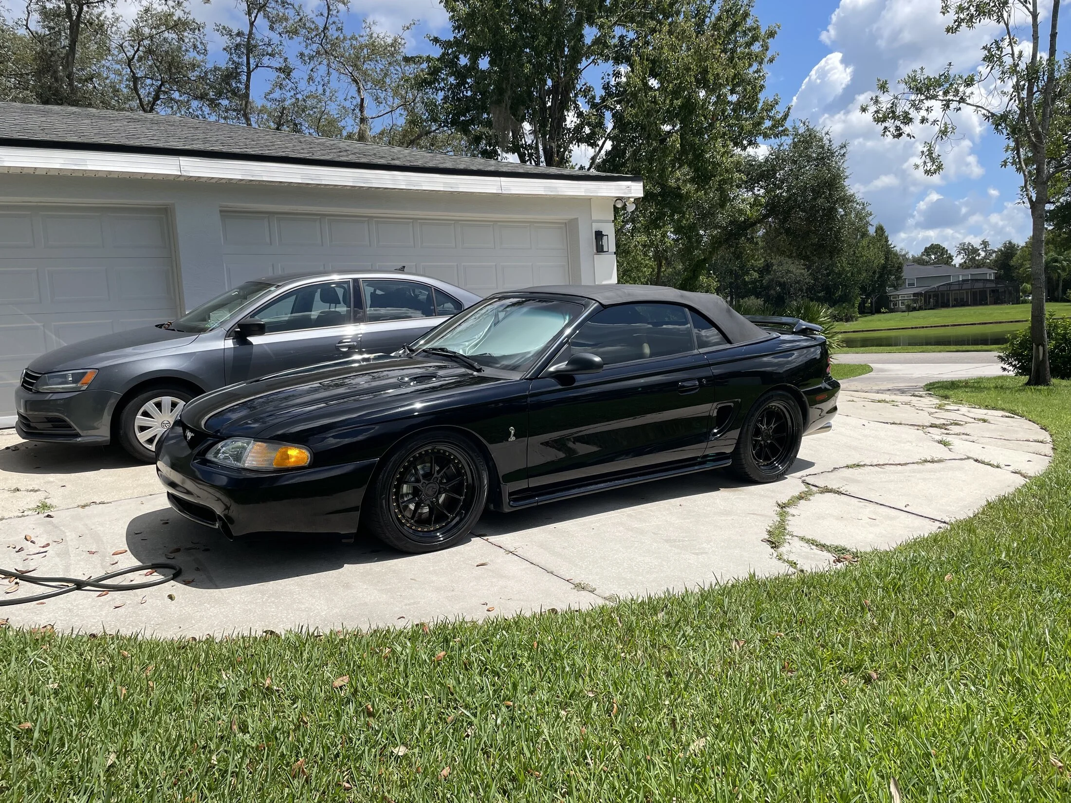

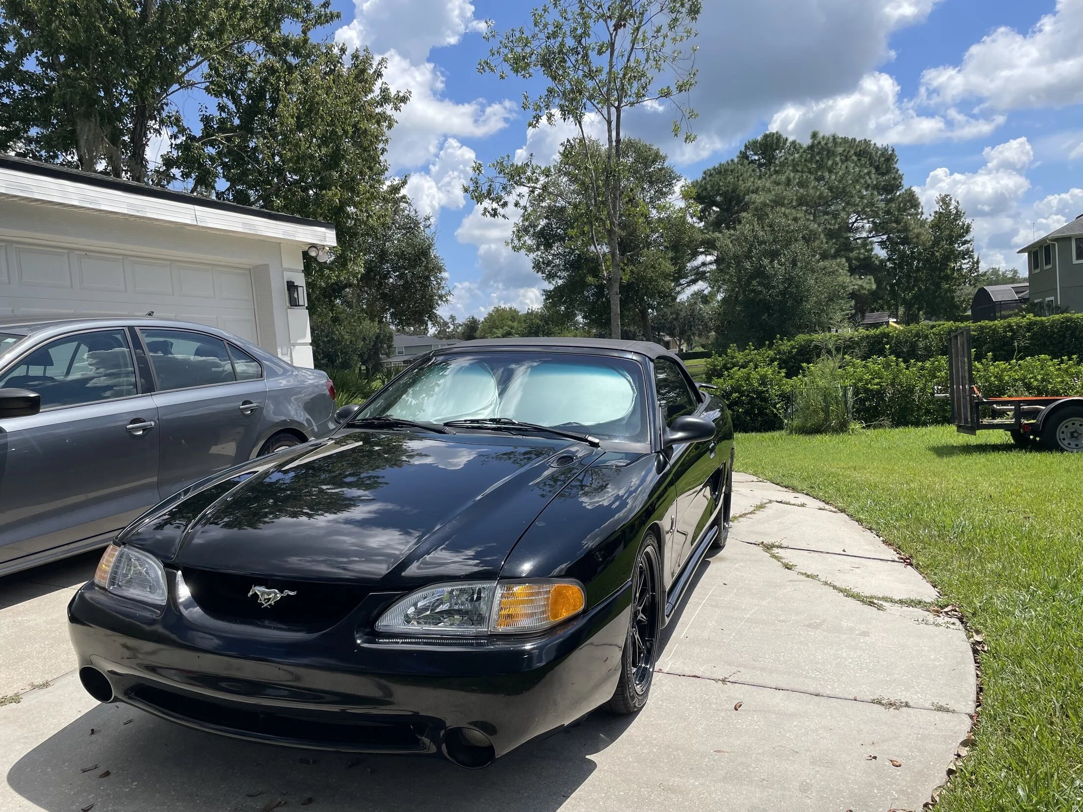

Have been neglecting this car a little bit as with the unreliable run lately haven’t had the will to wash her really. After about 2-3 months, finally got around to cleaning and shining her up

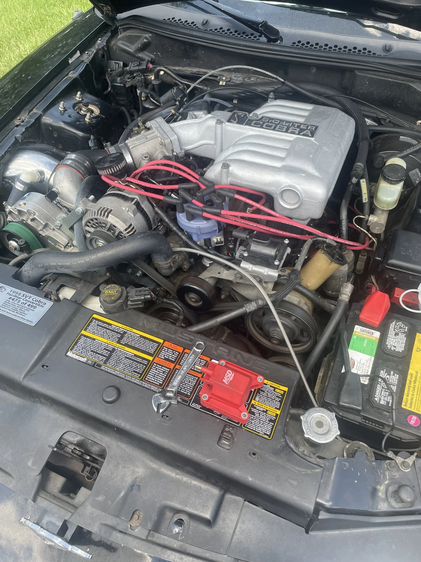

Small update: car is now running a screaming demon coil and an MSD Digital 6AL and absolutely zero spark blowout. With OEM coil and screaming demon to a lesser extent was still having issues in high rpm. The box took care of it

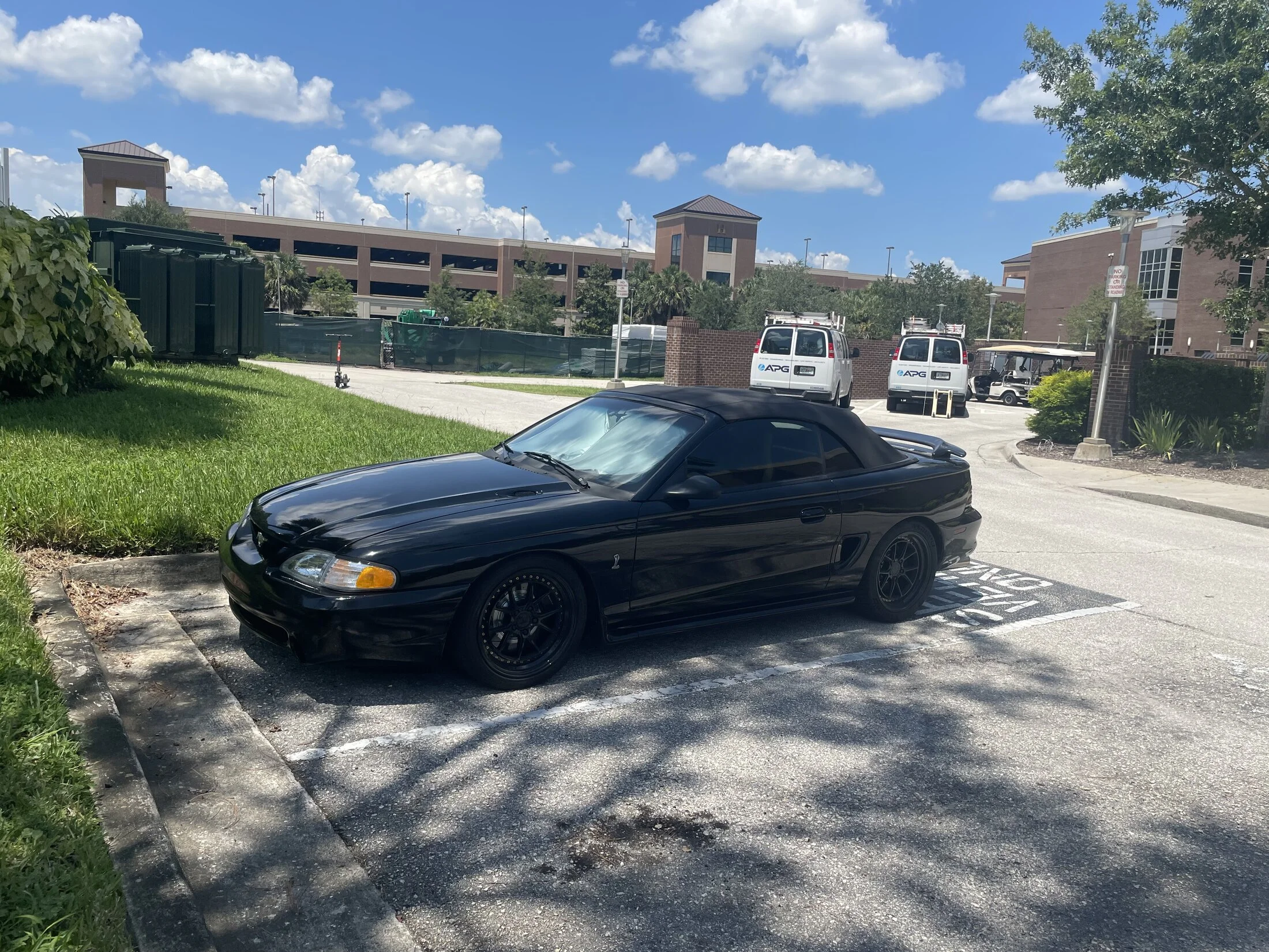

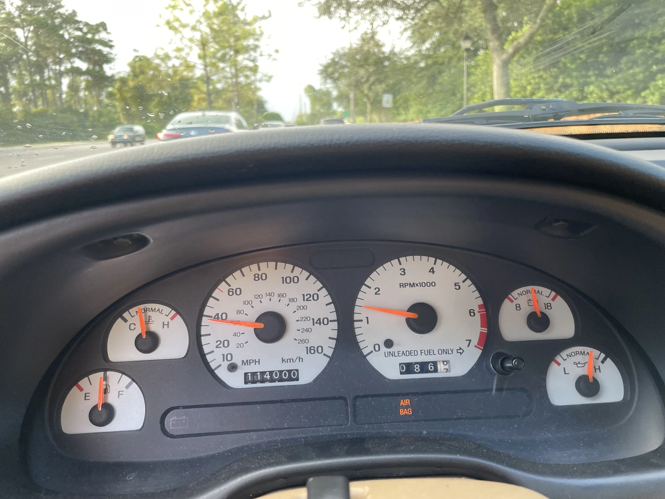

Just clocked 114k miles on the Cobra which puts me at 16,244 miles under my ownership. The car has come a long way in these past few years for sure. Sucks I’m fighting an airbag code 34 that only comes on for first start of the day for the pic but I’ll get to it!

Oh she’s a good looking ‘vert.
And 16kis enough for proper emotional bonding.

Where did you end up mounting the MSD? The Digital 6AL is a pretty good sized box.

Right under/infront of the power pipe on that flat area. Basically on the mirror side of the battery. Thanks for the kind words

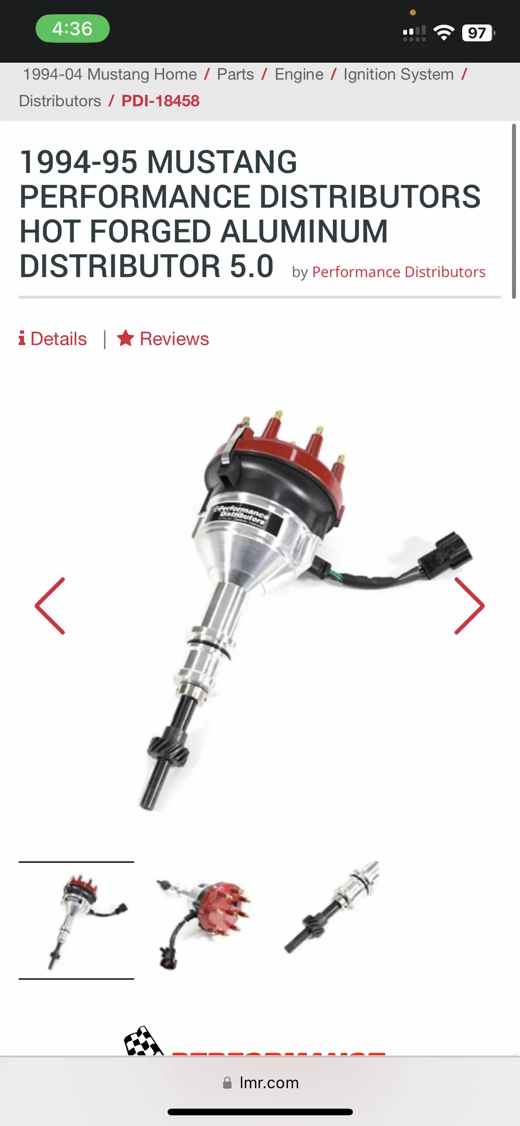

Got tired of plowing through the Duralast Distributors with their fault PIPs. In about 4 months I’ve gone through 6 of the parts store ones. I finally broke down and took advantage of the small sale from LMR and got the Performance Distributor Hot Forged Distributor. $232 out the door and hopefully will be the last distributor I buy!

WhiteCobra95 said:
Have you checked out these guys?
Performance Distributors
They've been around for a long time. I haven't run one personally since I could always find Motorcraft, but my friends running GM engines have used their HEI distributors without any issues. This was the only other non-OEM replacement that I have considered.
I should've done this from the jump! I've got their coil which has been excellent and now I am upgrading to their distributor
