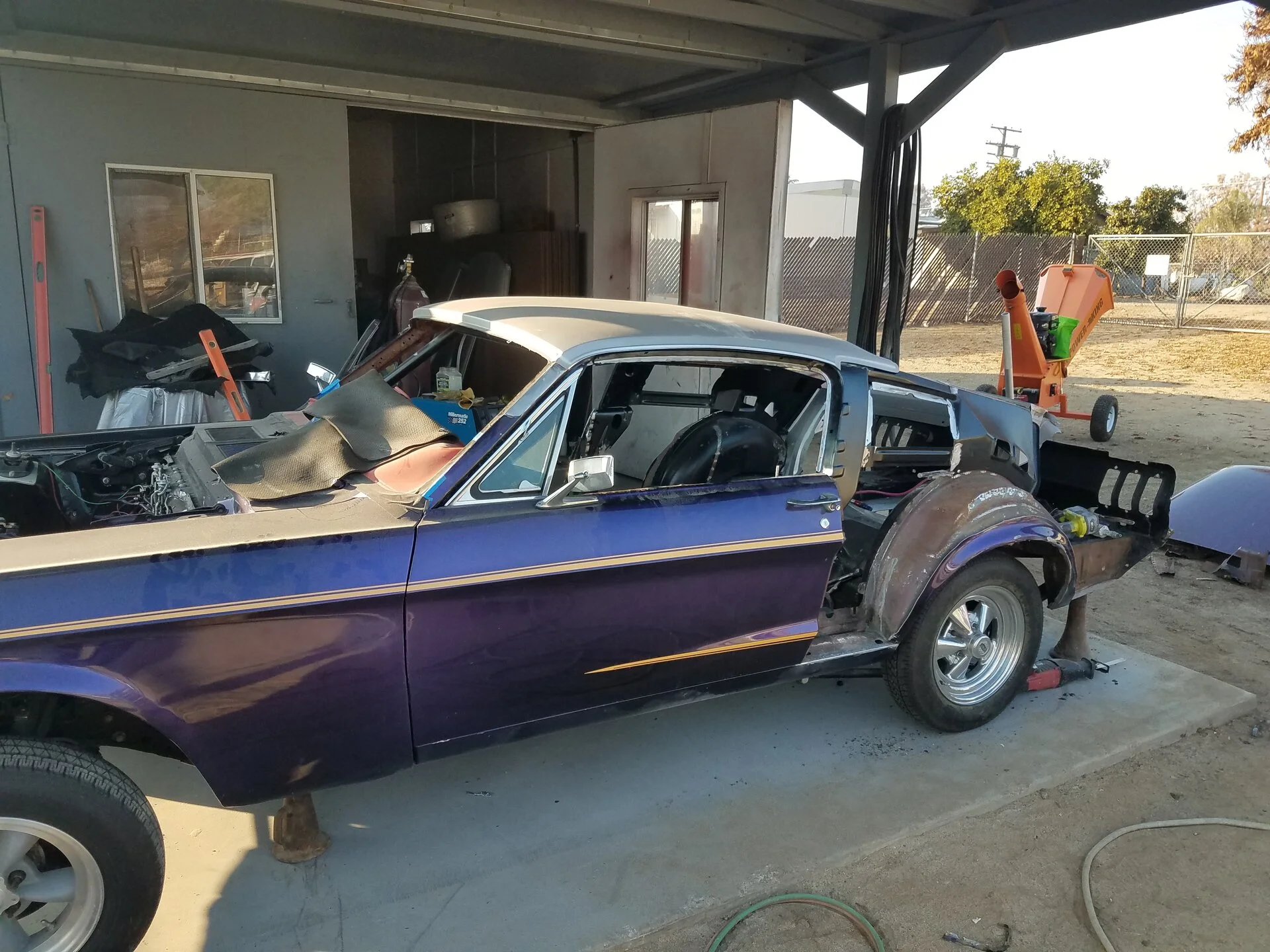

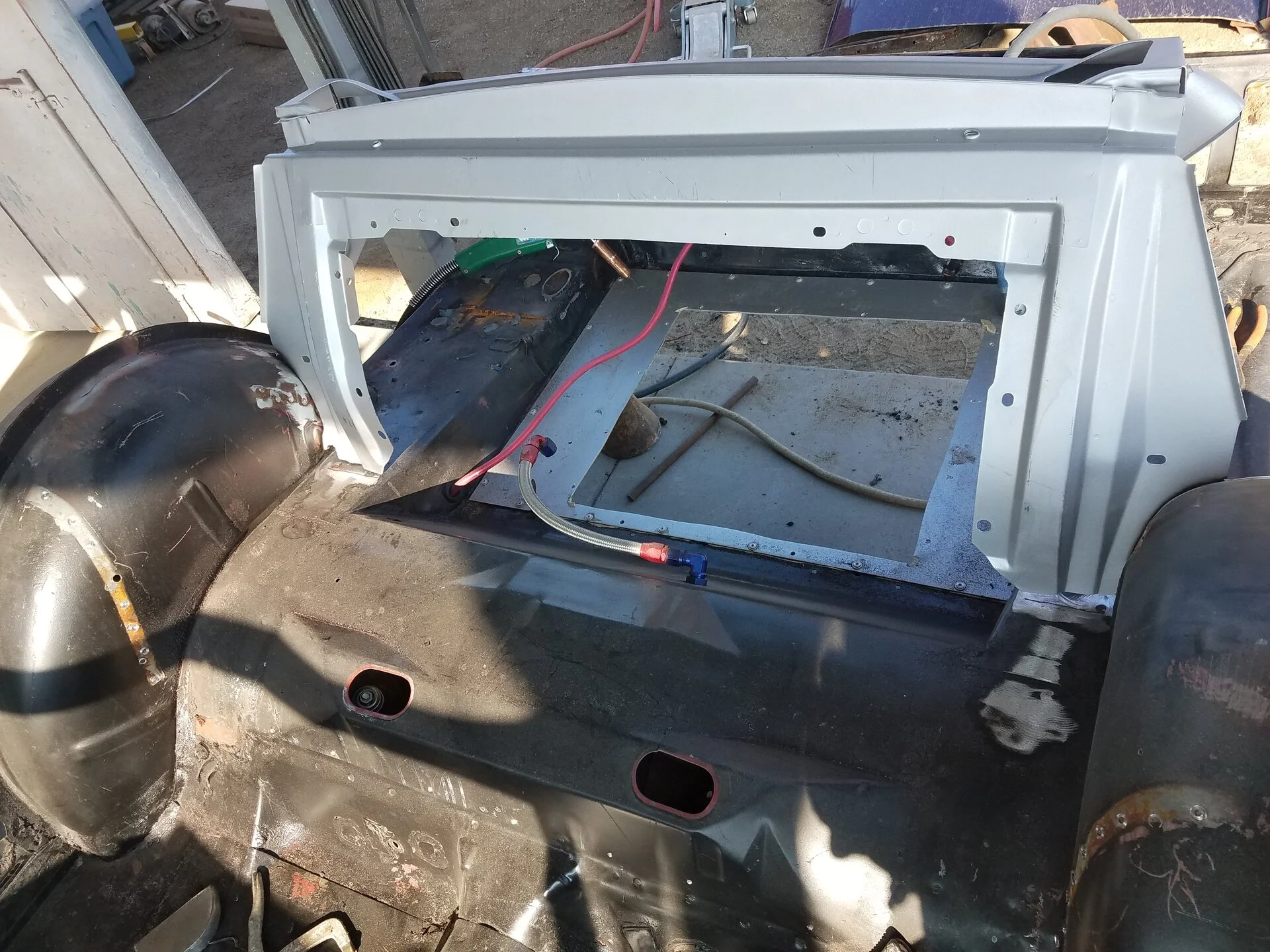

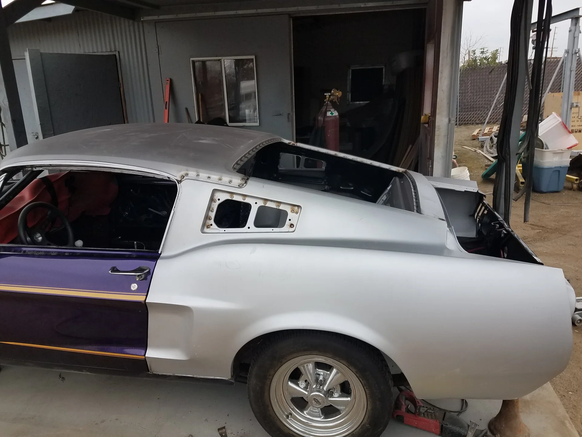

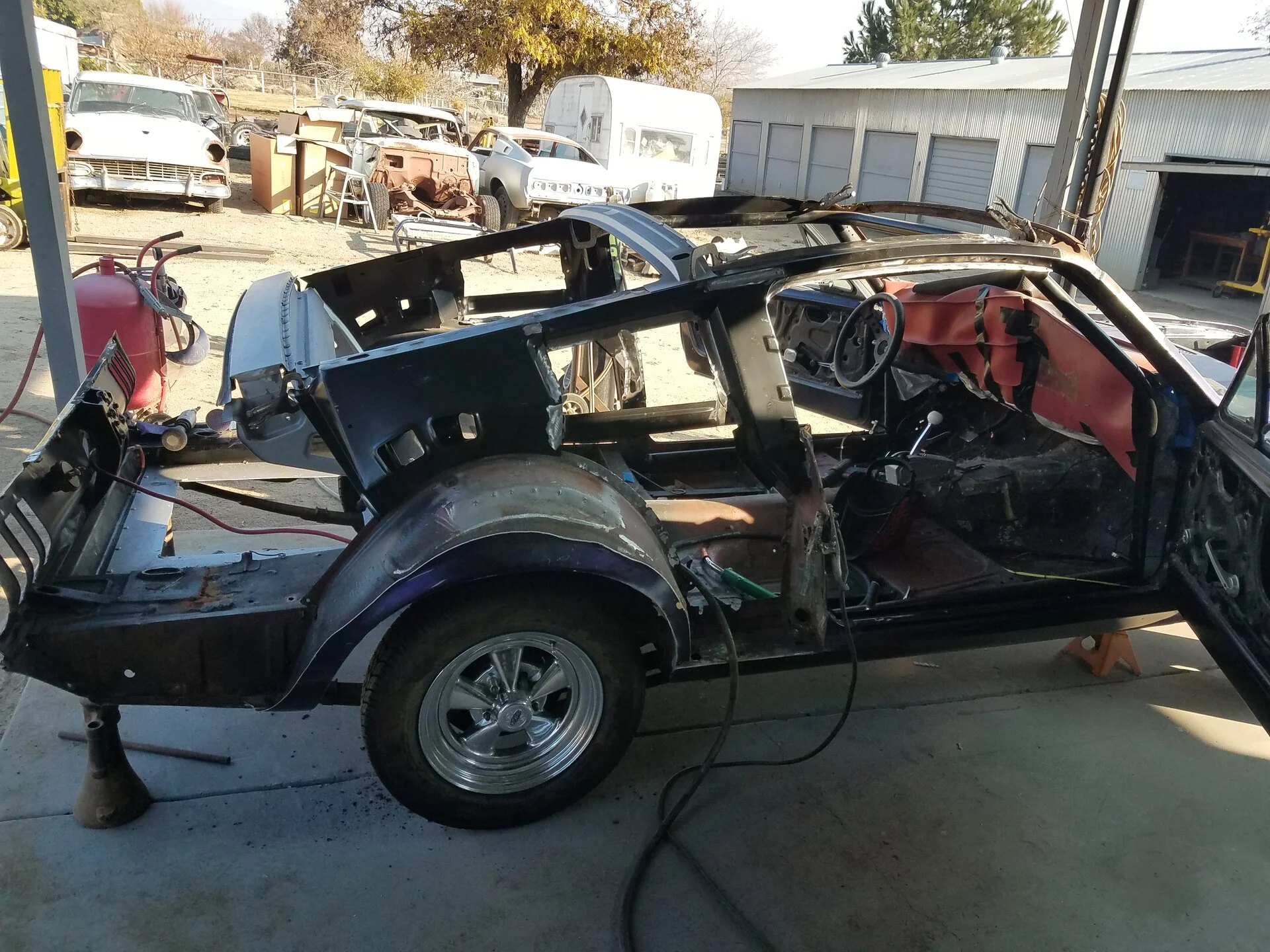

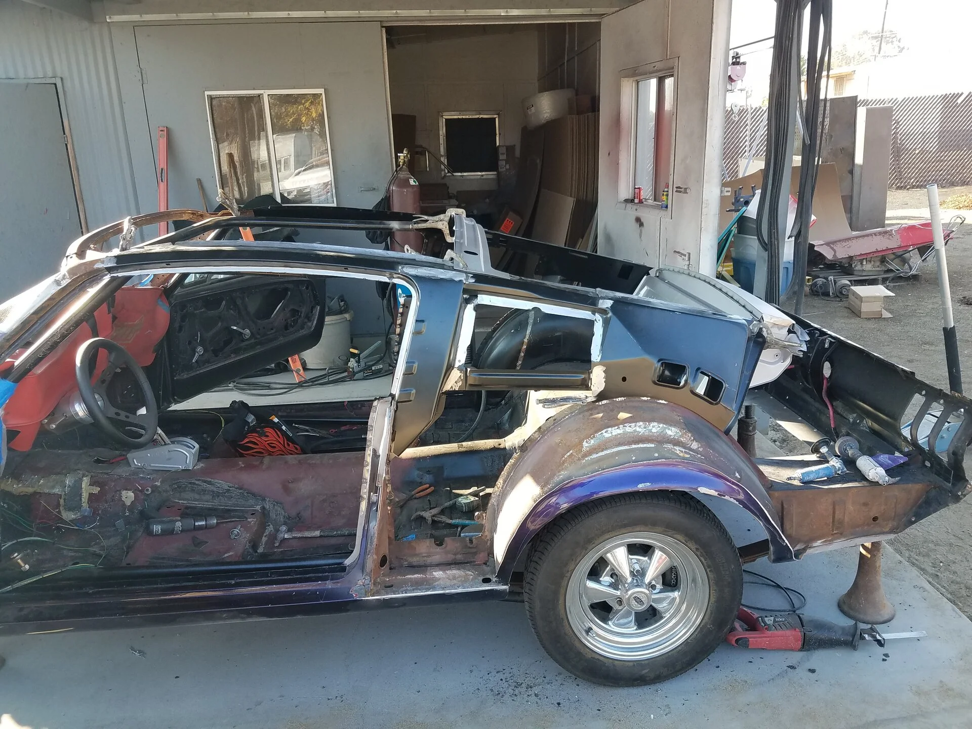

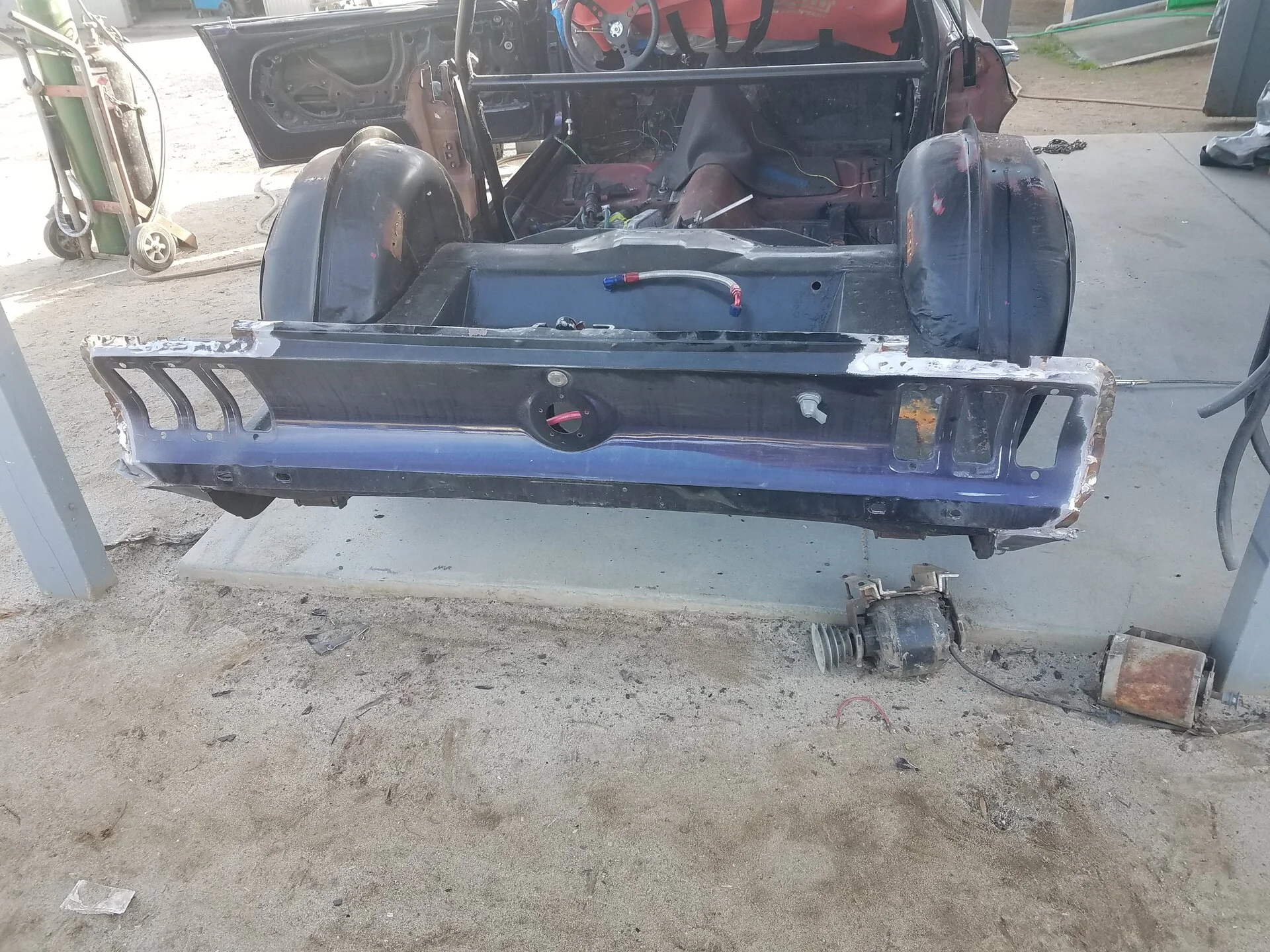

Driver side door jamb is trimmed and so is the tail panel ,only thing left to trim is the trunk drop offs and the wheel lips .

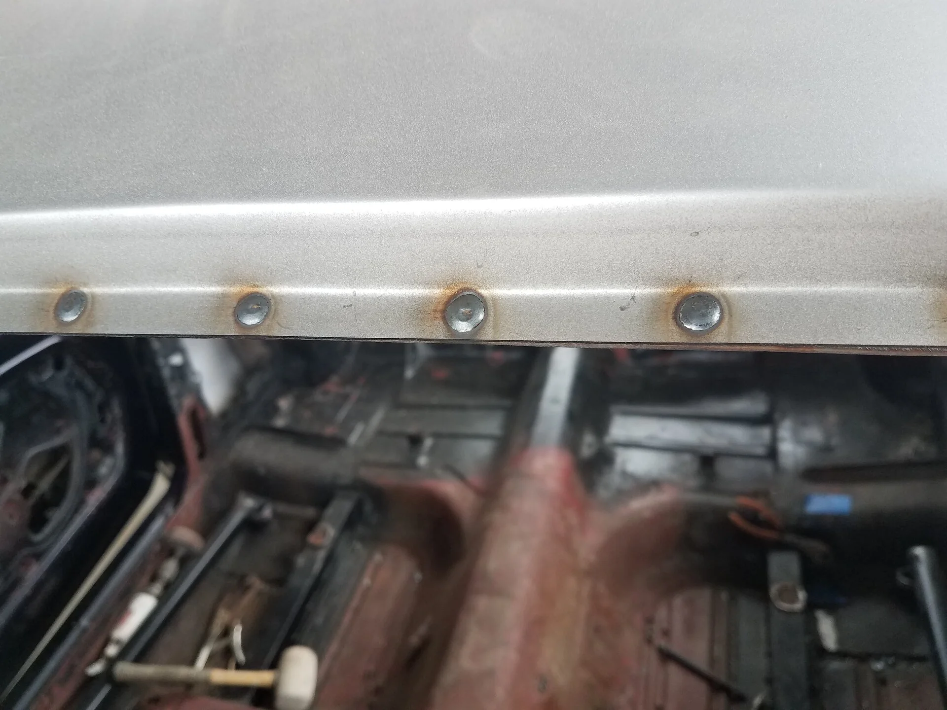

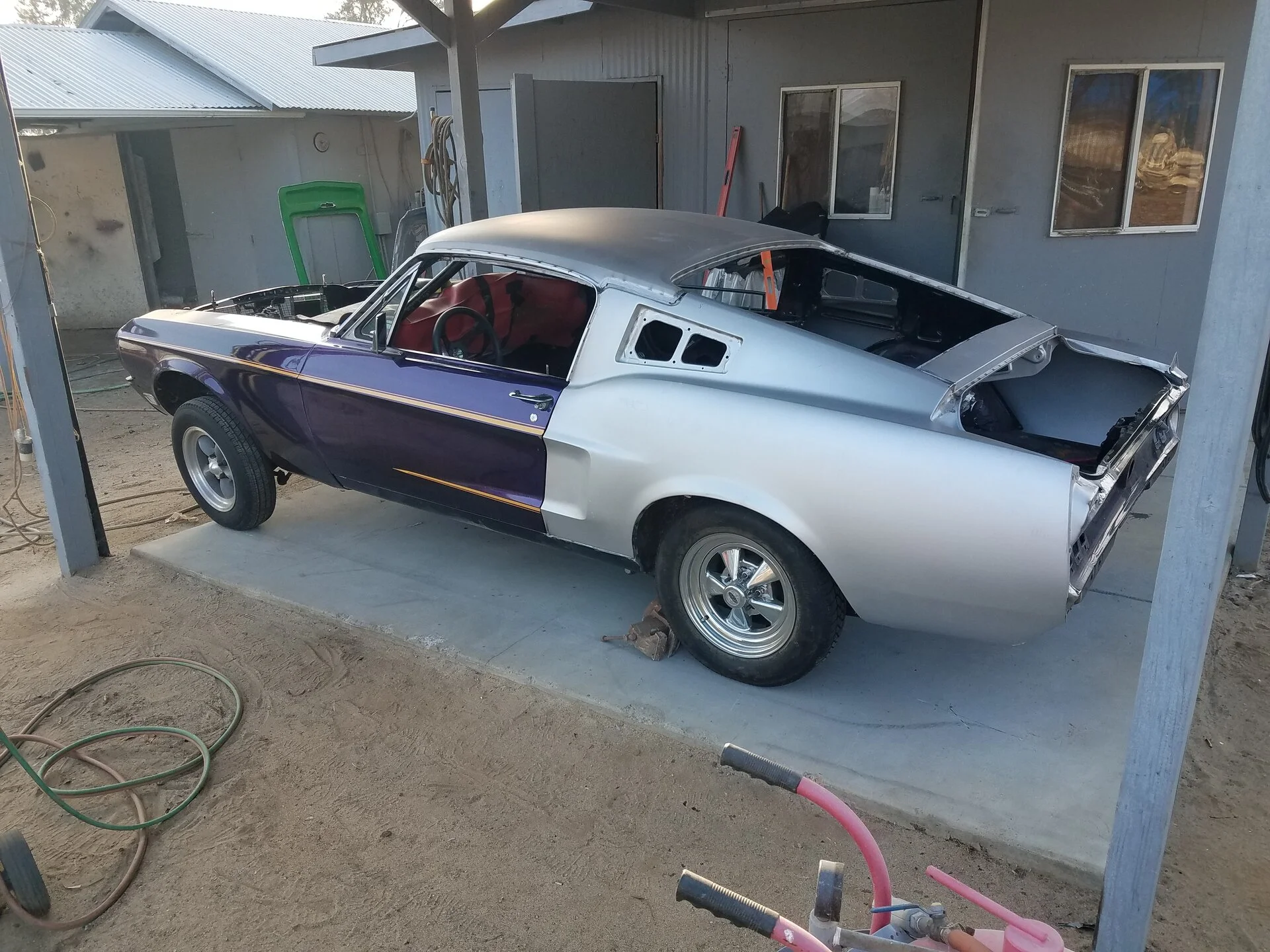

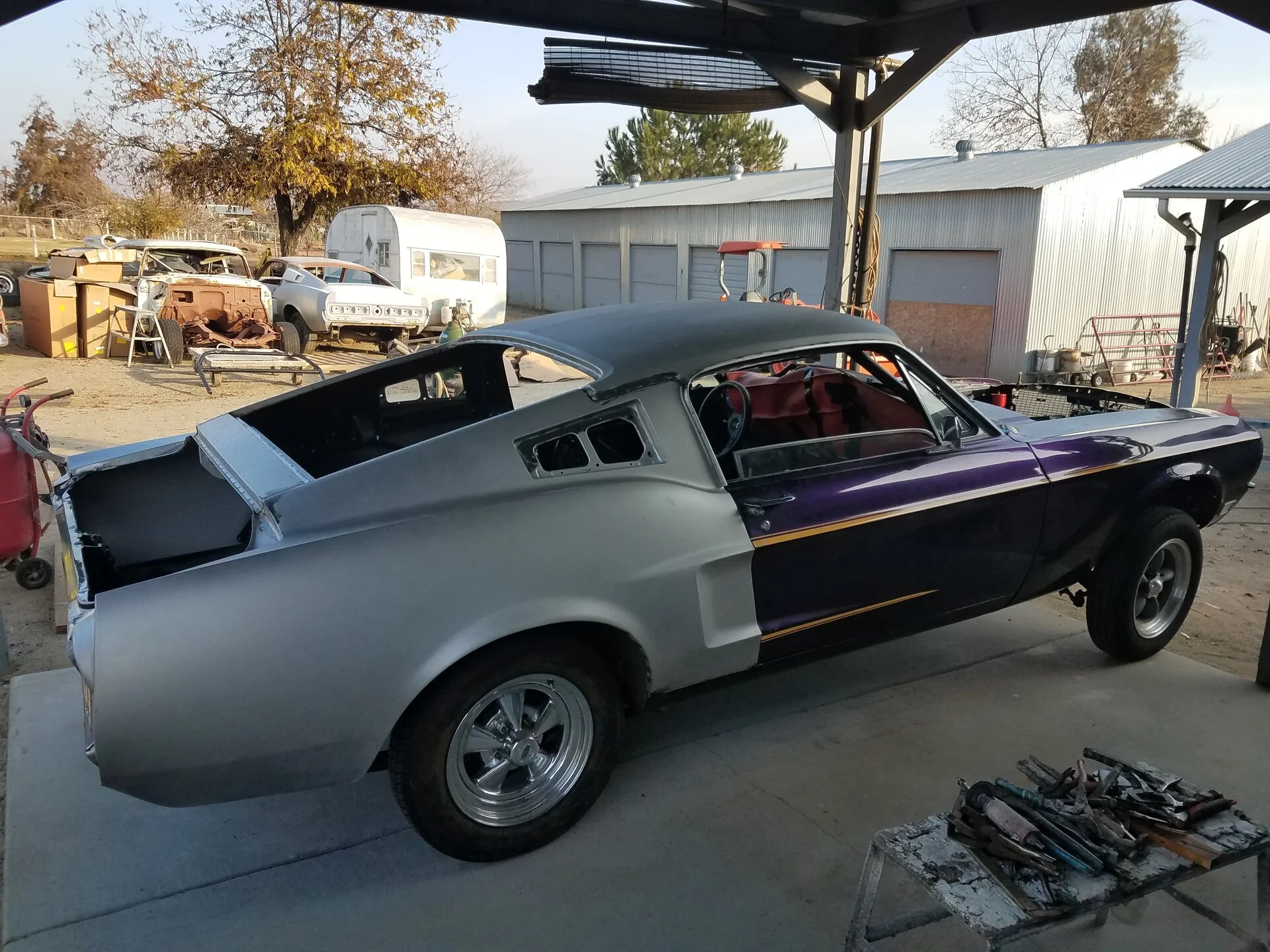

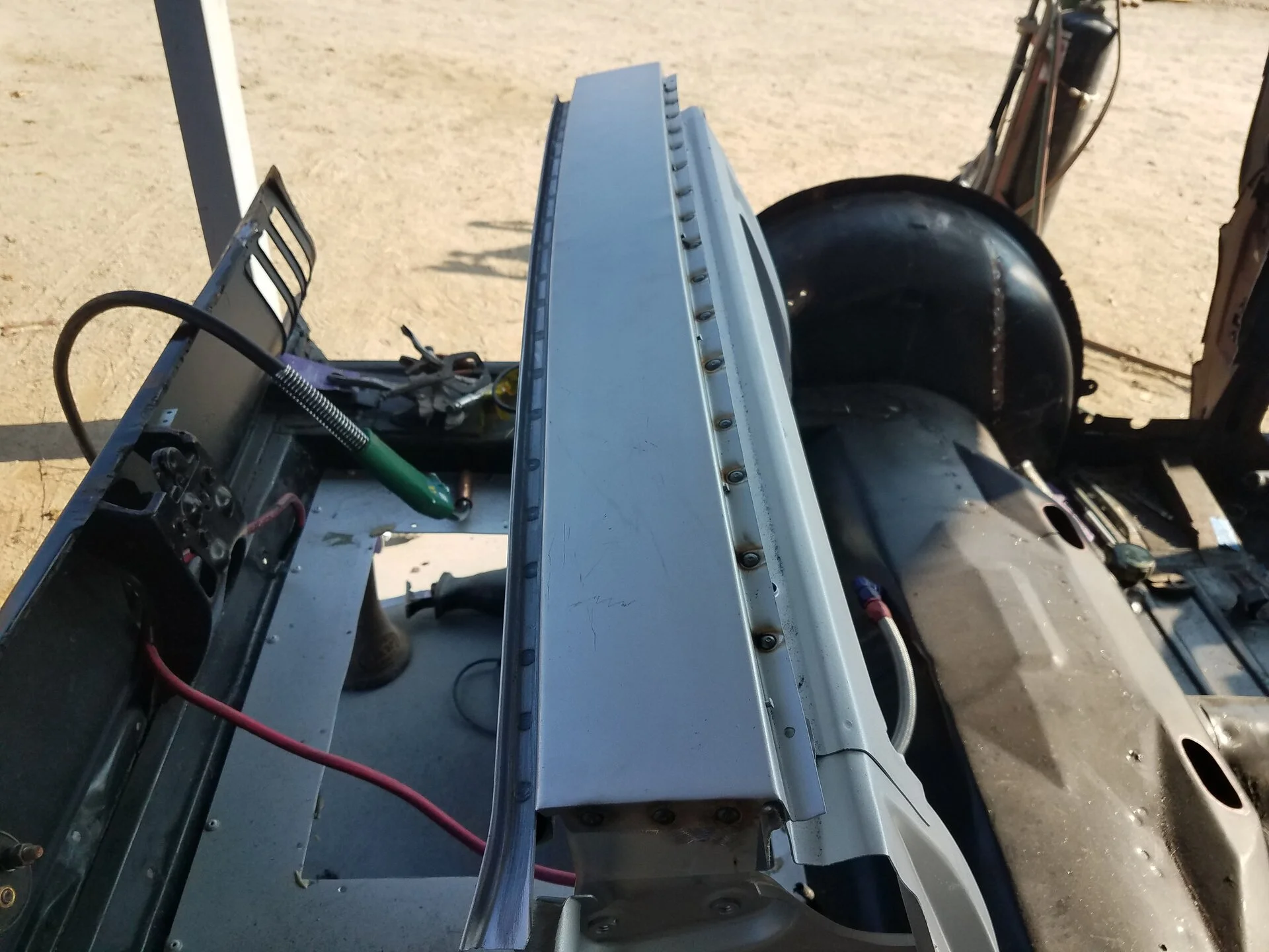

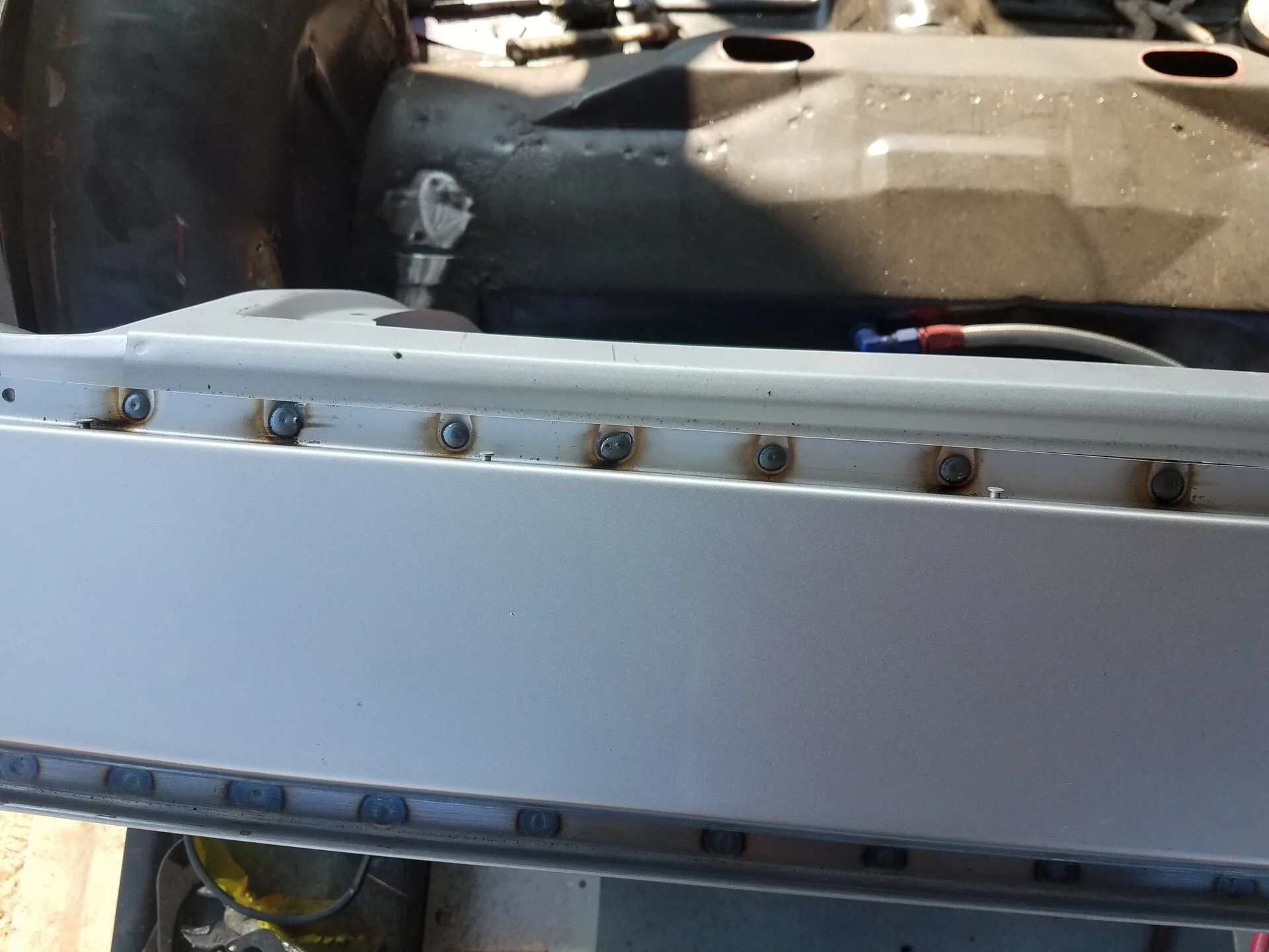

Old pop and spatter was trying to give me trouble at first but after a few choice words it decided to make some pretty nice plug welds . I used my spot welder in the water channel in the lower window panel.

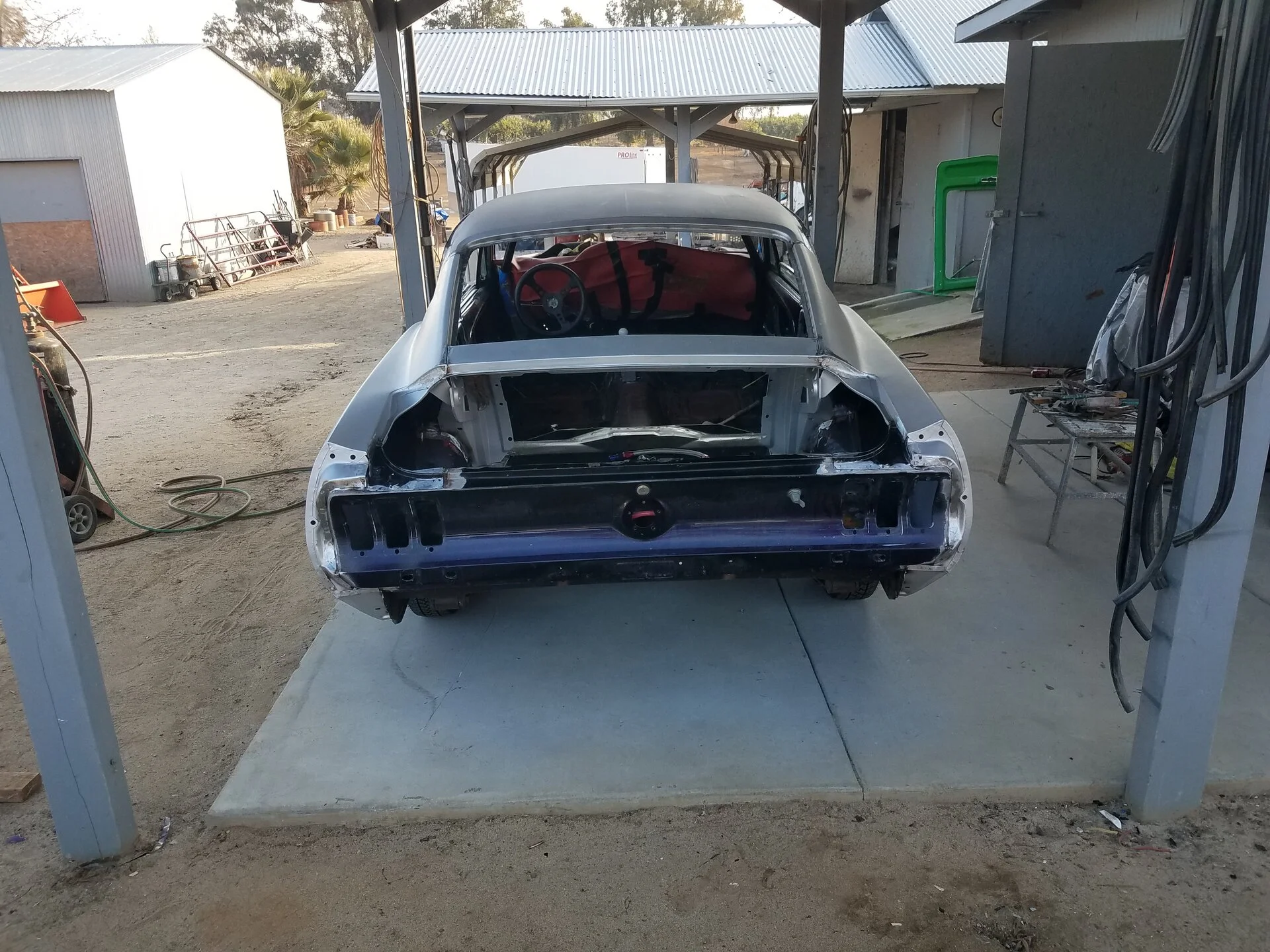

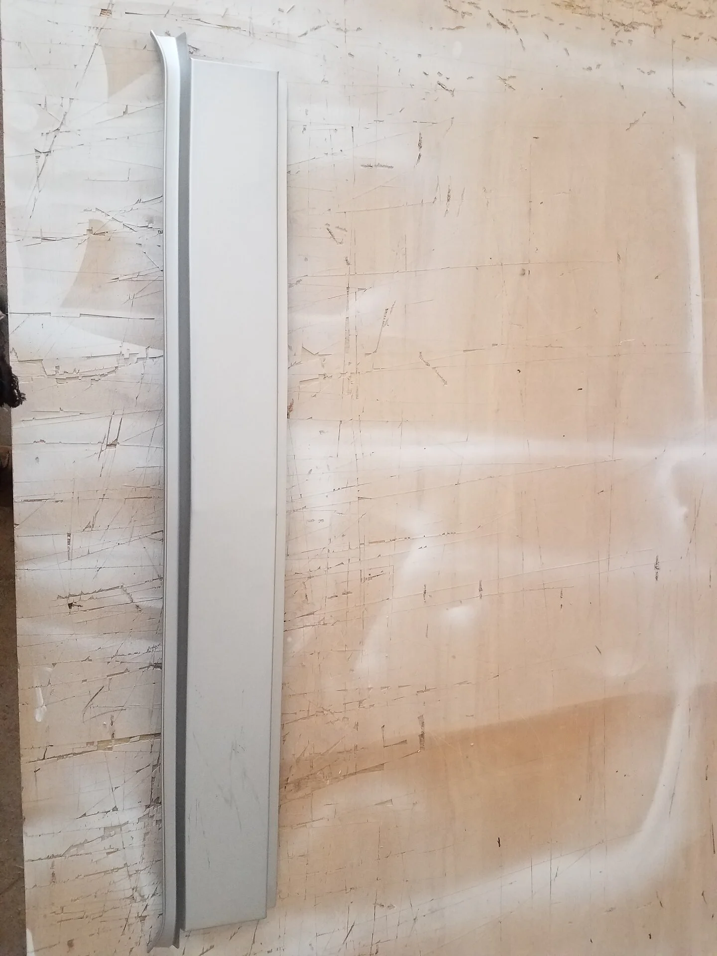

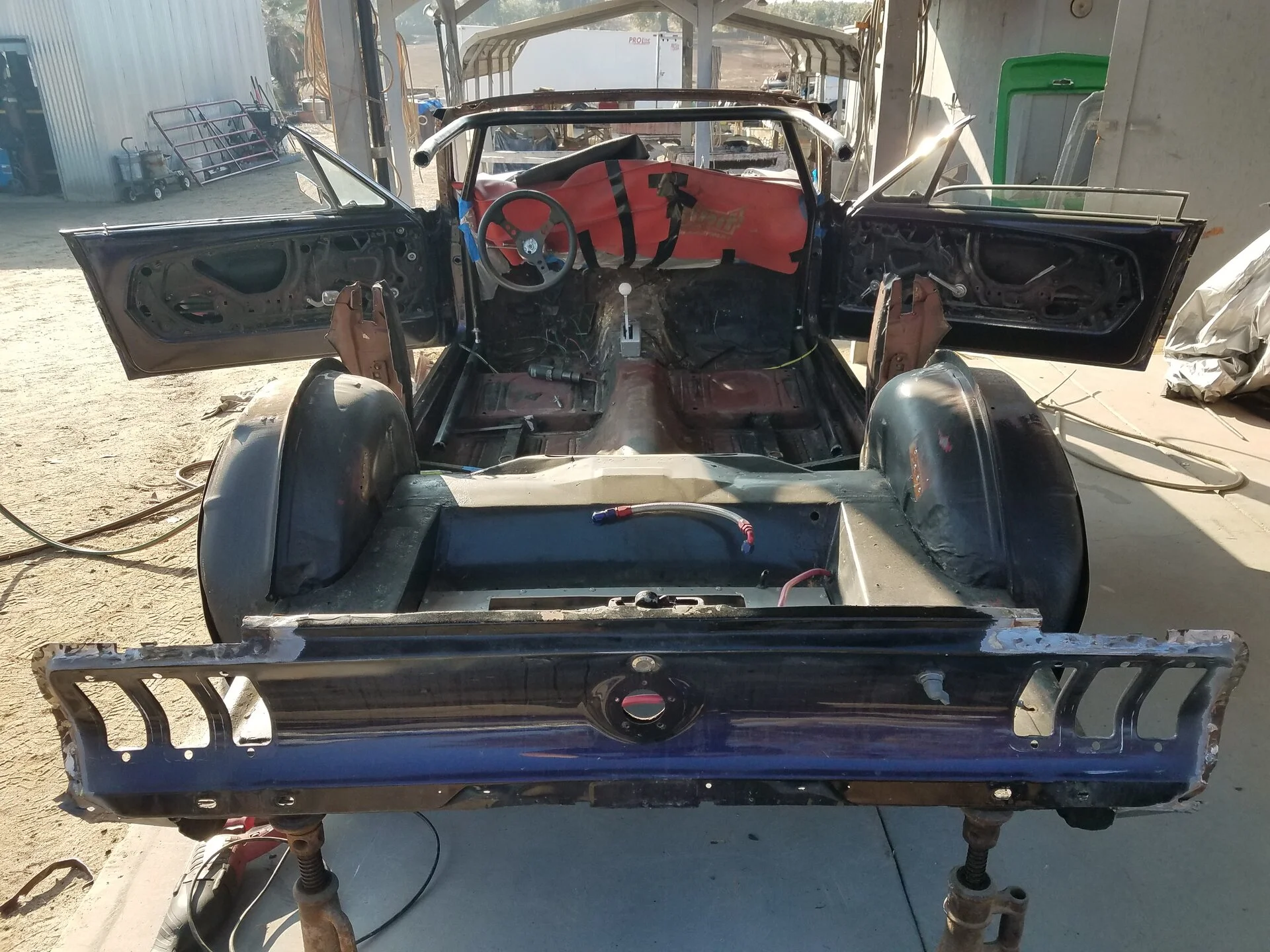

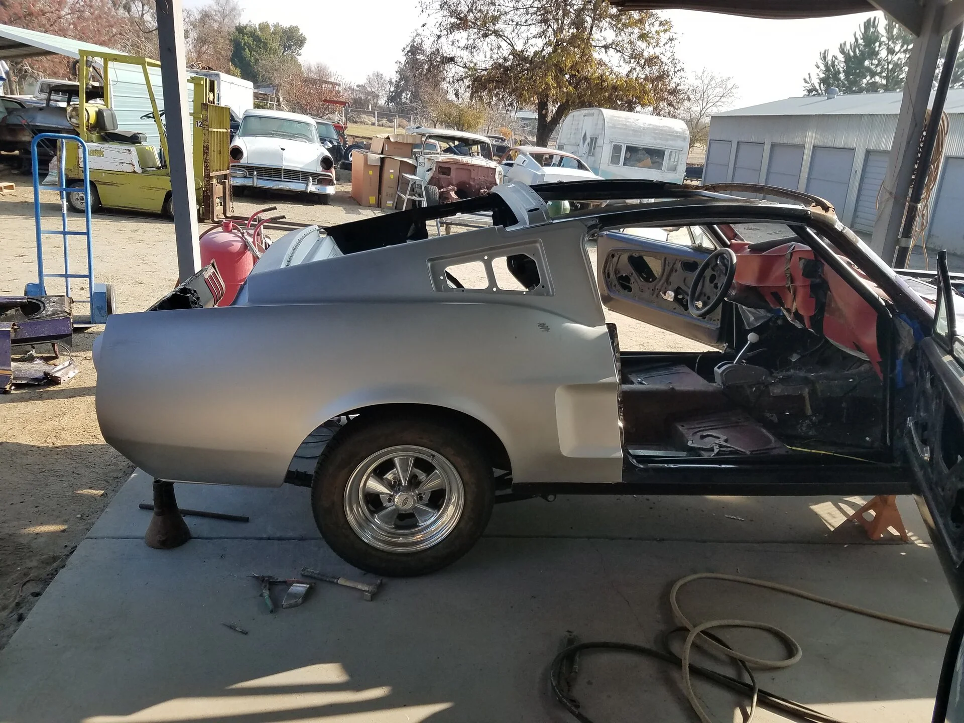

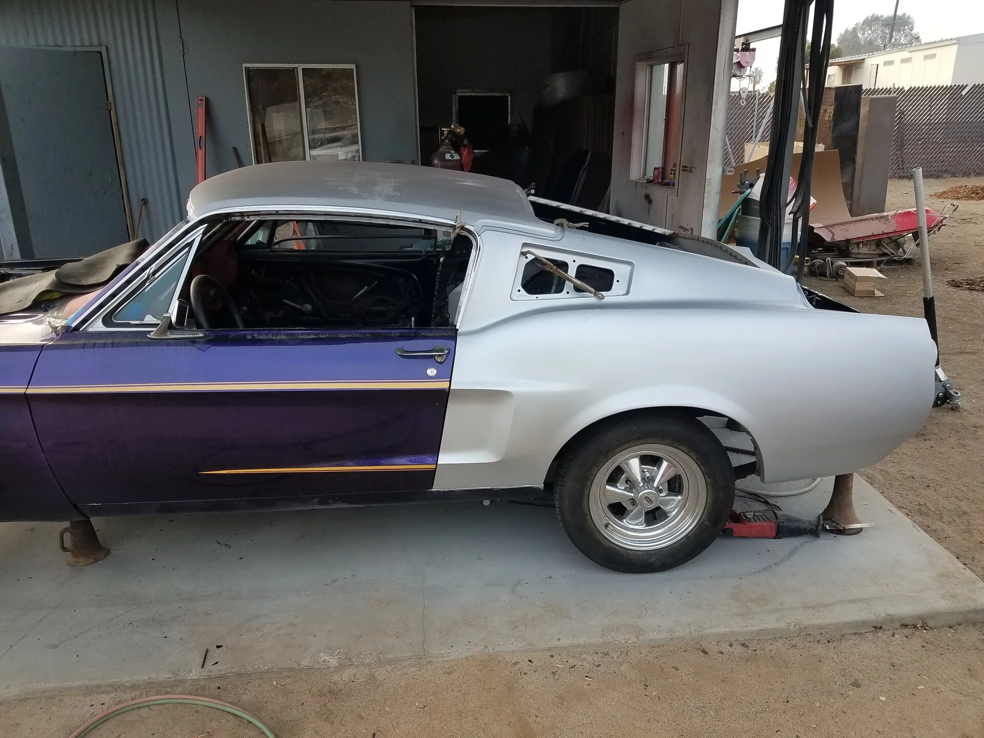

Test fitting ,everything just falls in place . Still have to trim the wheel lips but by tomorrow i should have all the inner structure welded up ,then it just the outer skin

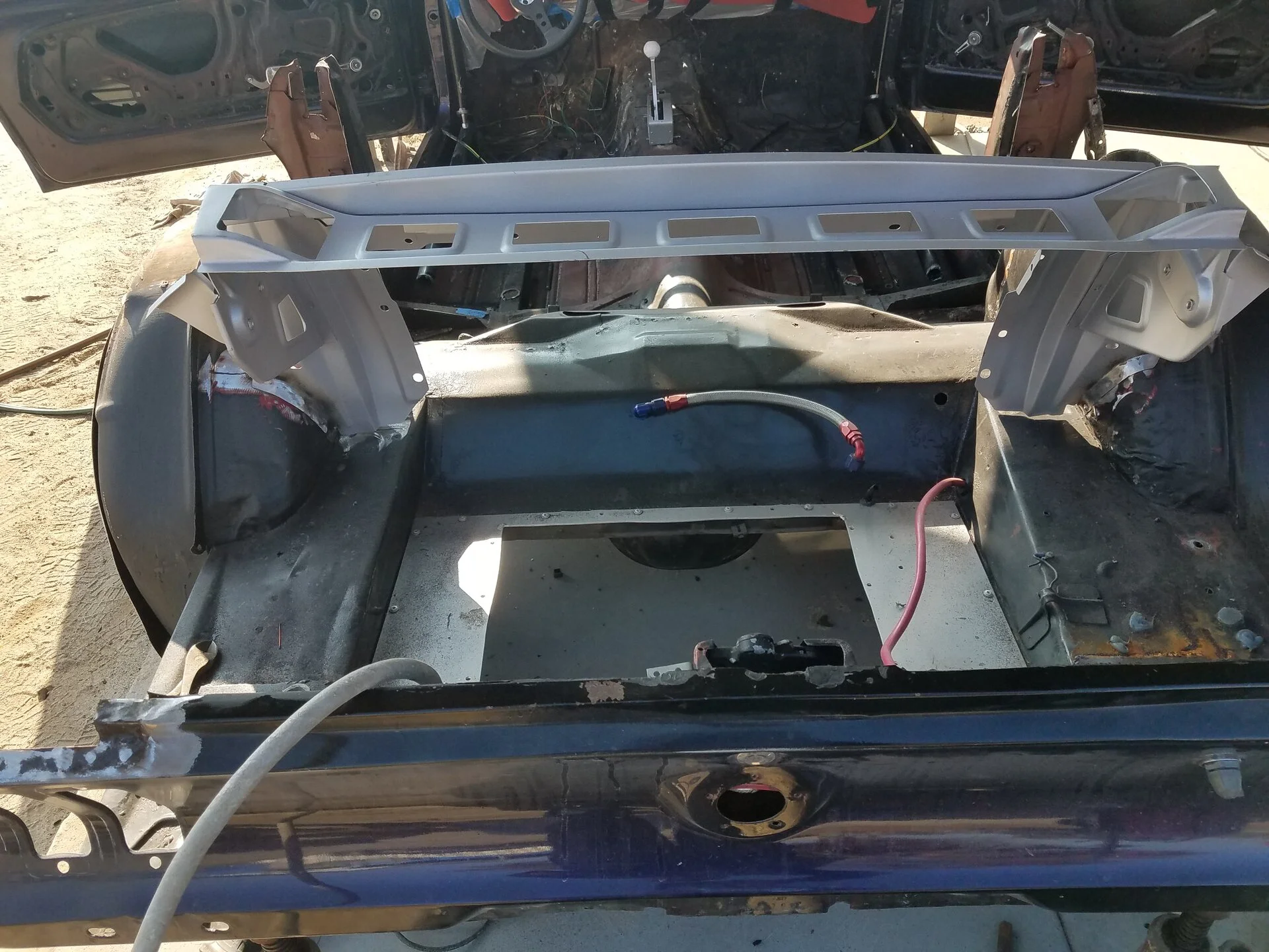

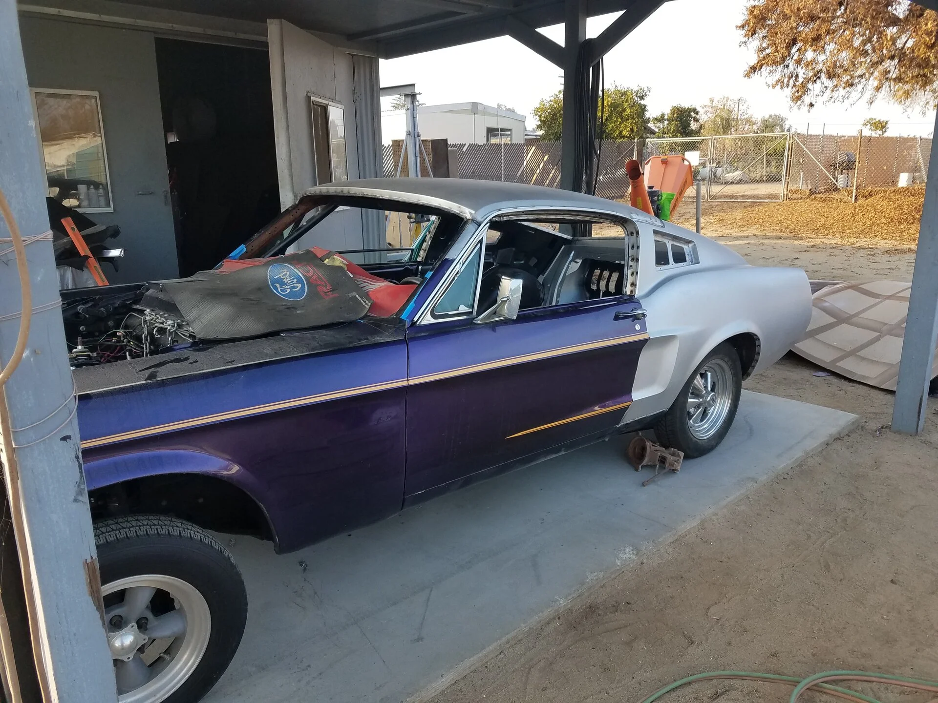

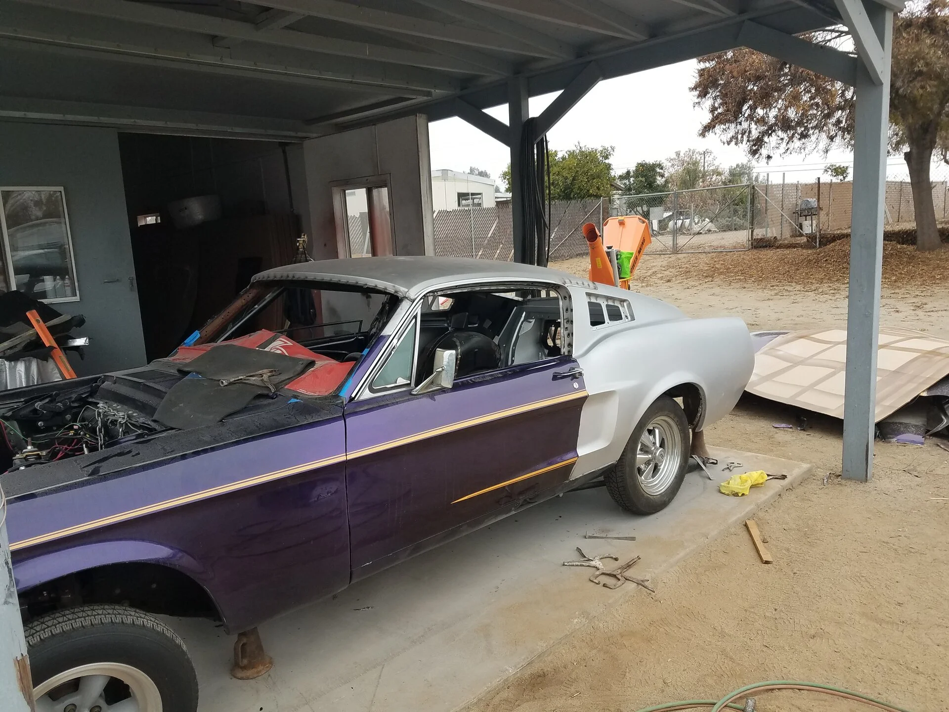

It should turn out really nice if i dont have trouble with the trunk lid ,seems they are about 1/8 inch longer from front to back and it causes a problem with the end caps ,i have to trim the front lip of the trunk lid and reweld ,and it takes a while trying not to warp it but we will see tomorrow

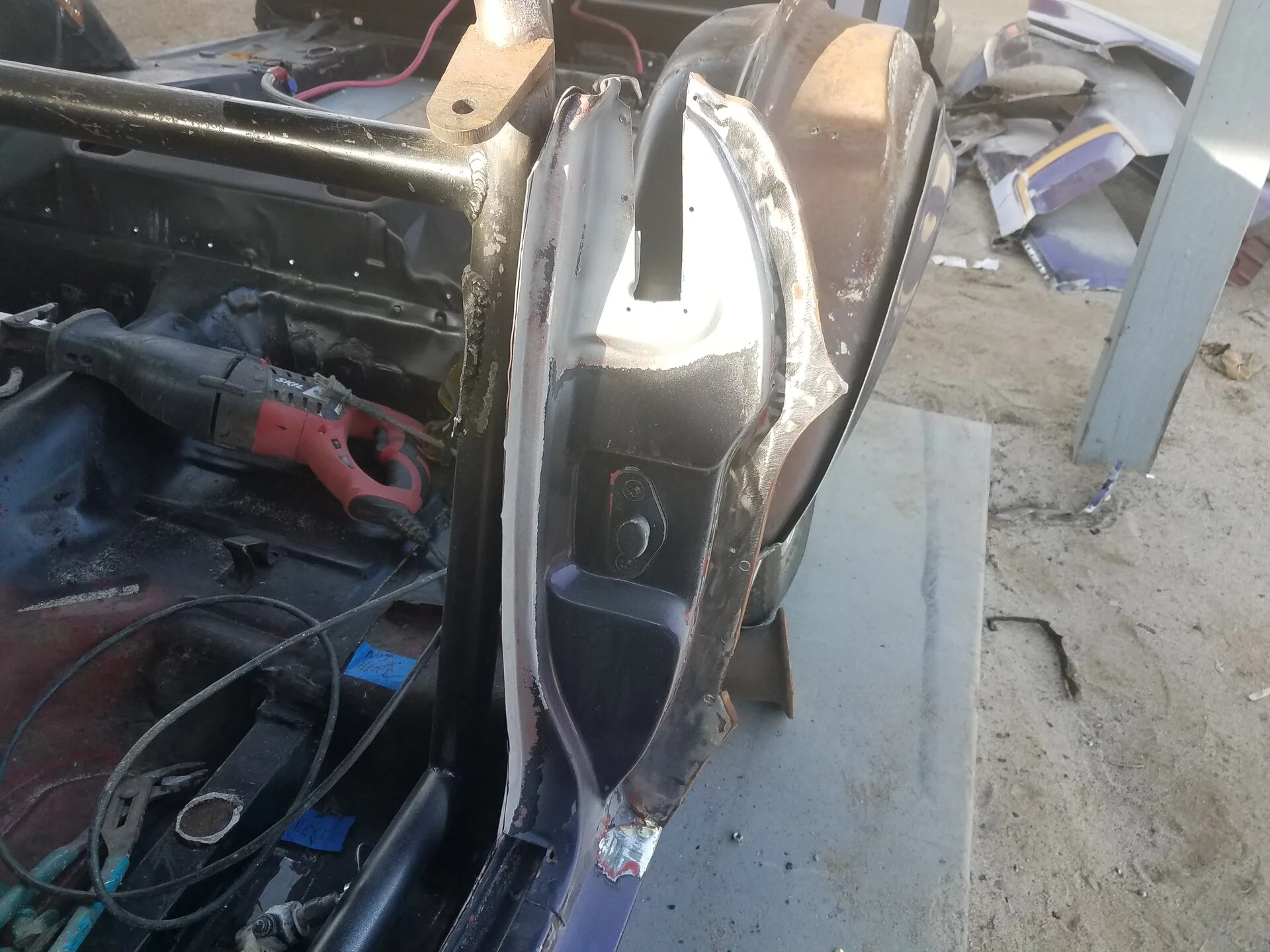

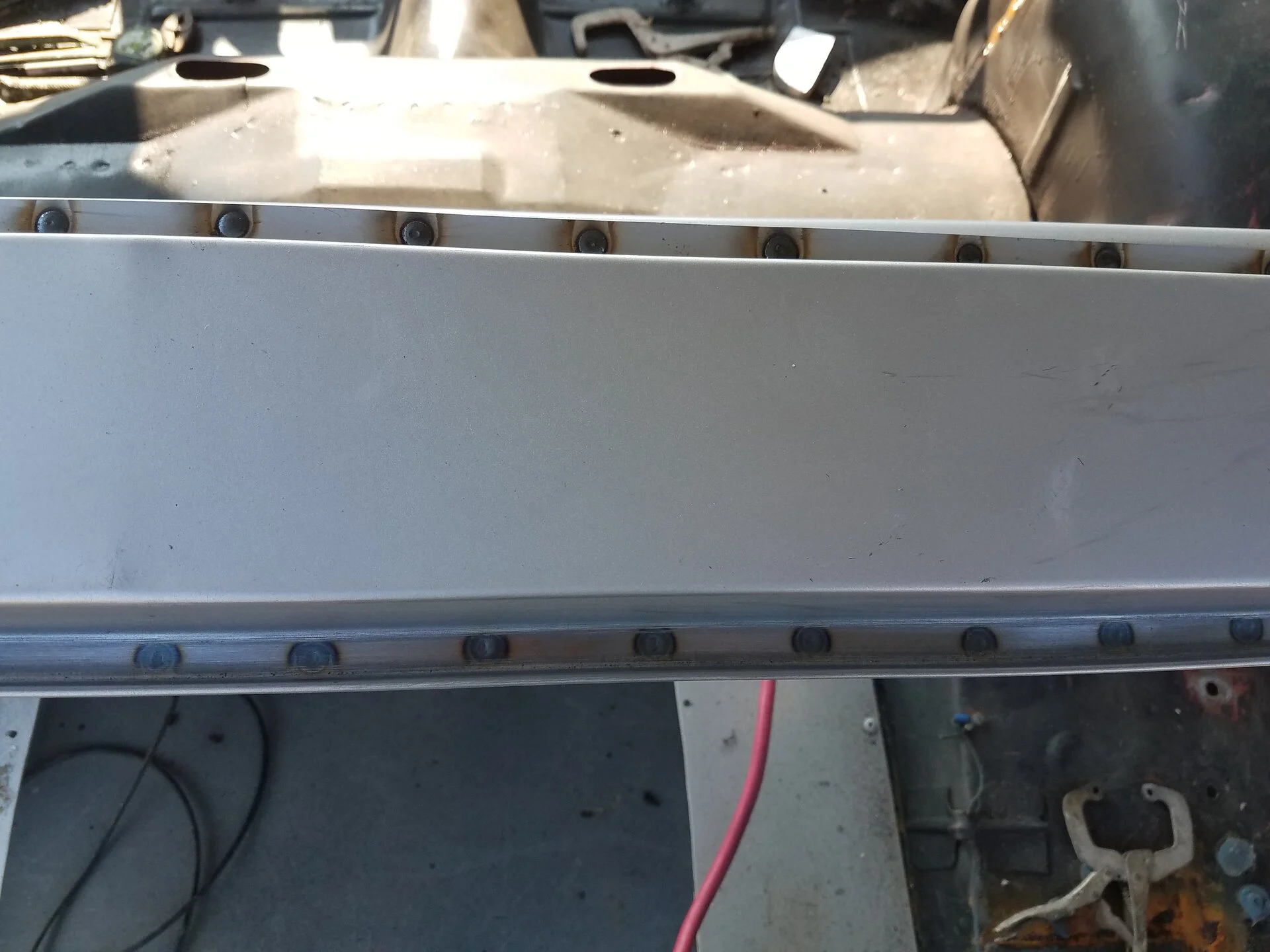

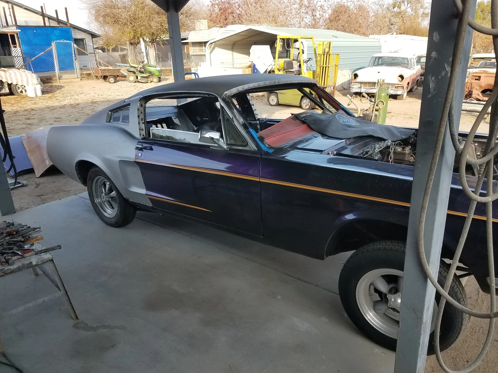

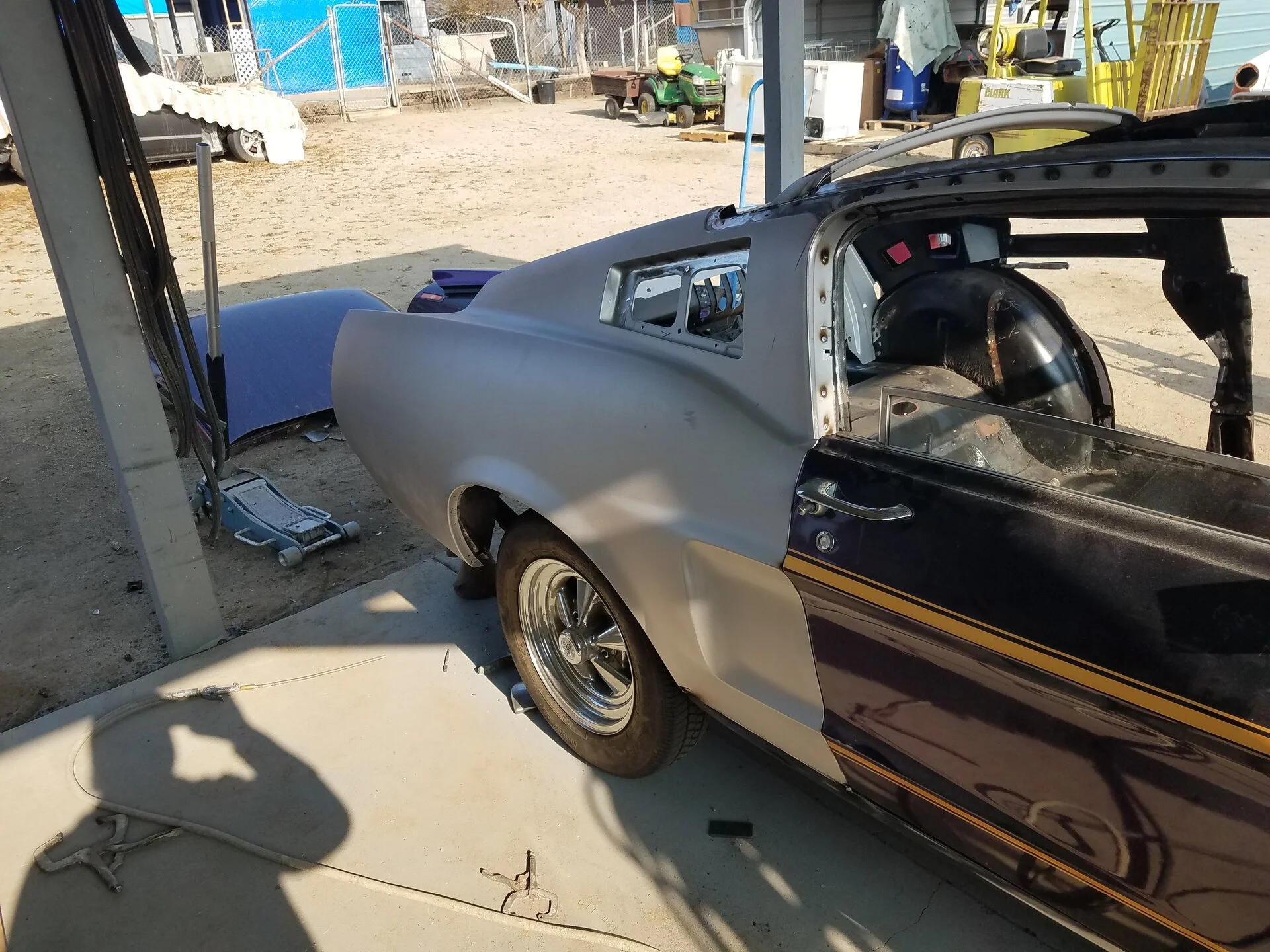

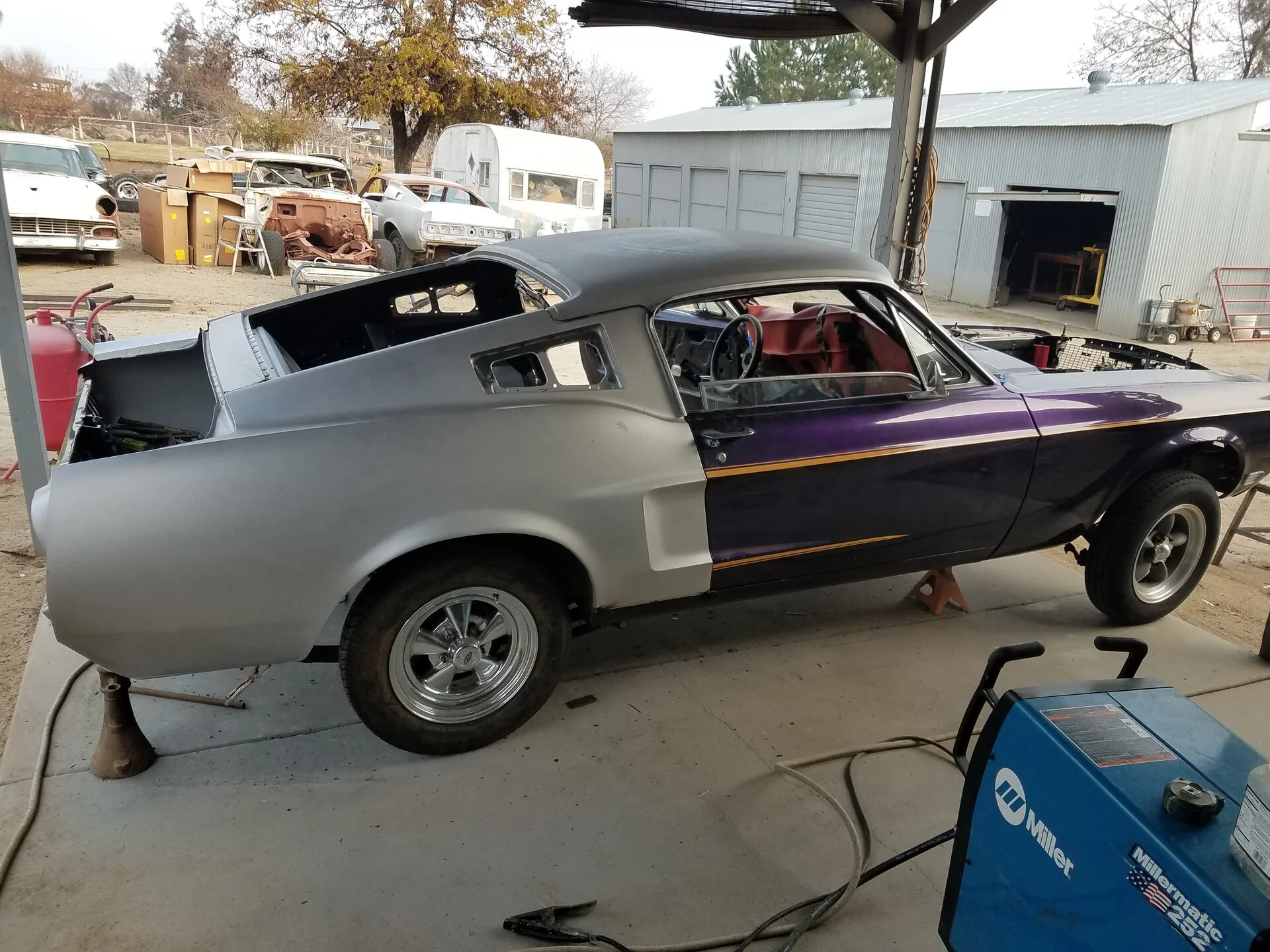

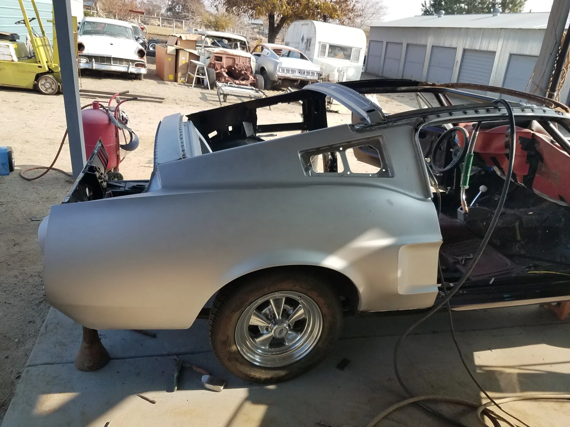

Body is done except for a bunch of interior brackets and a bit of grinding around the door openings and wheel lips ,i may be finished tomorrow ,maybe!
