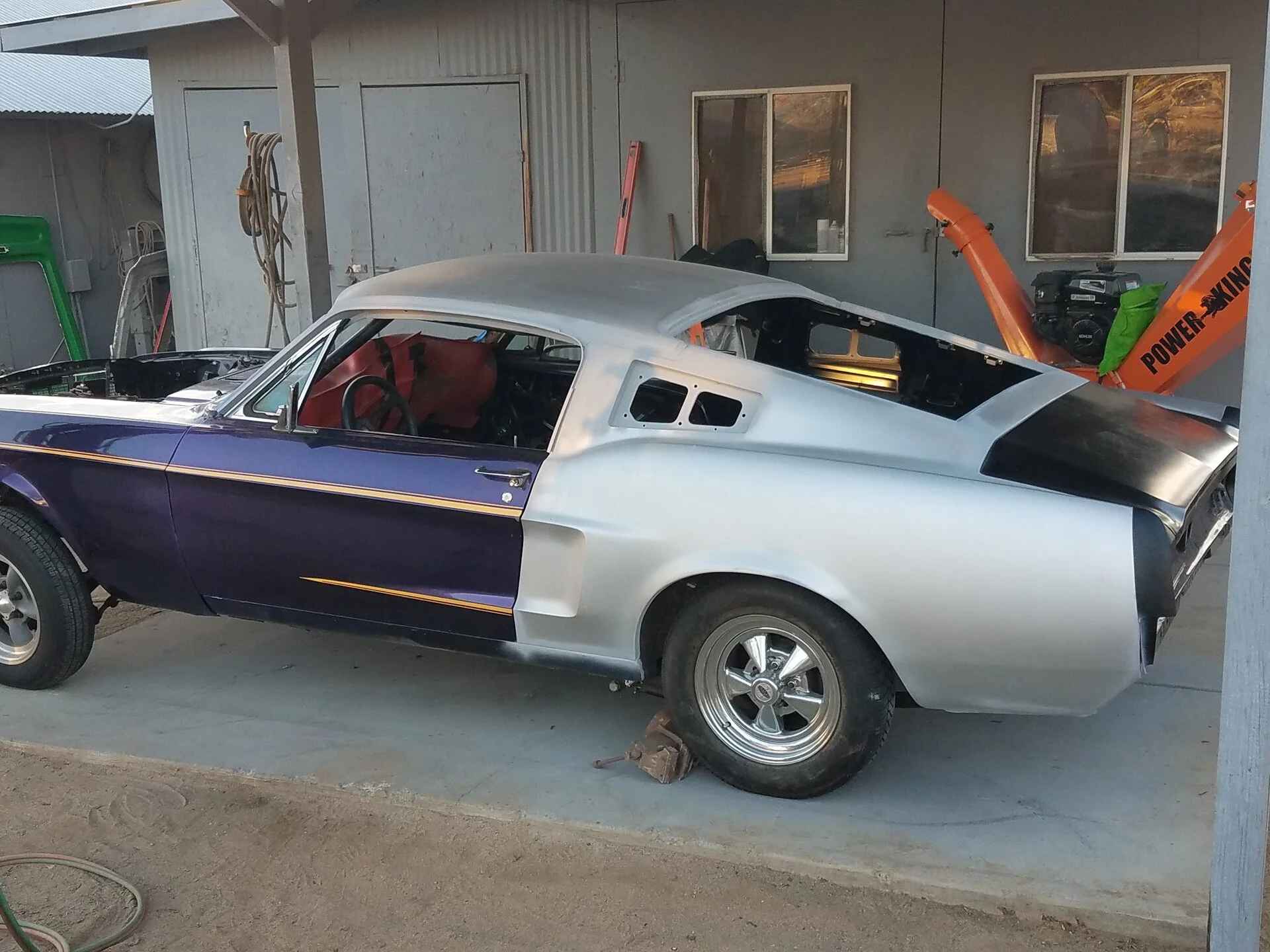

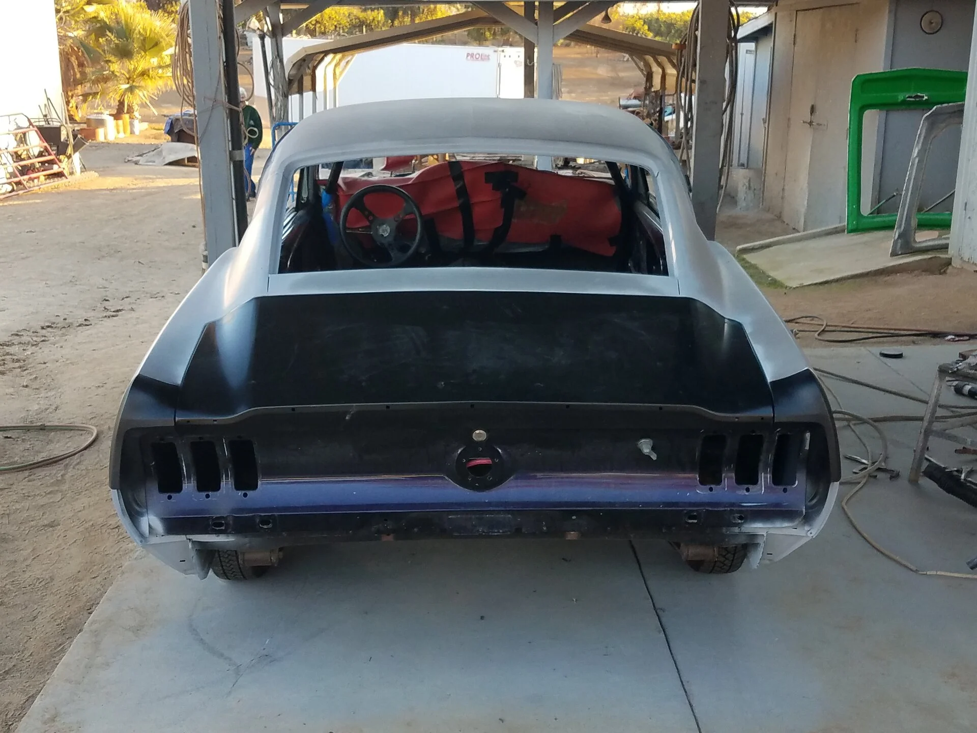

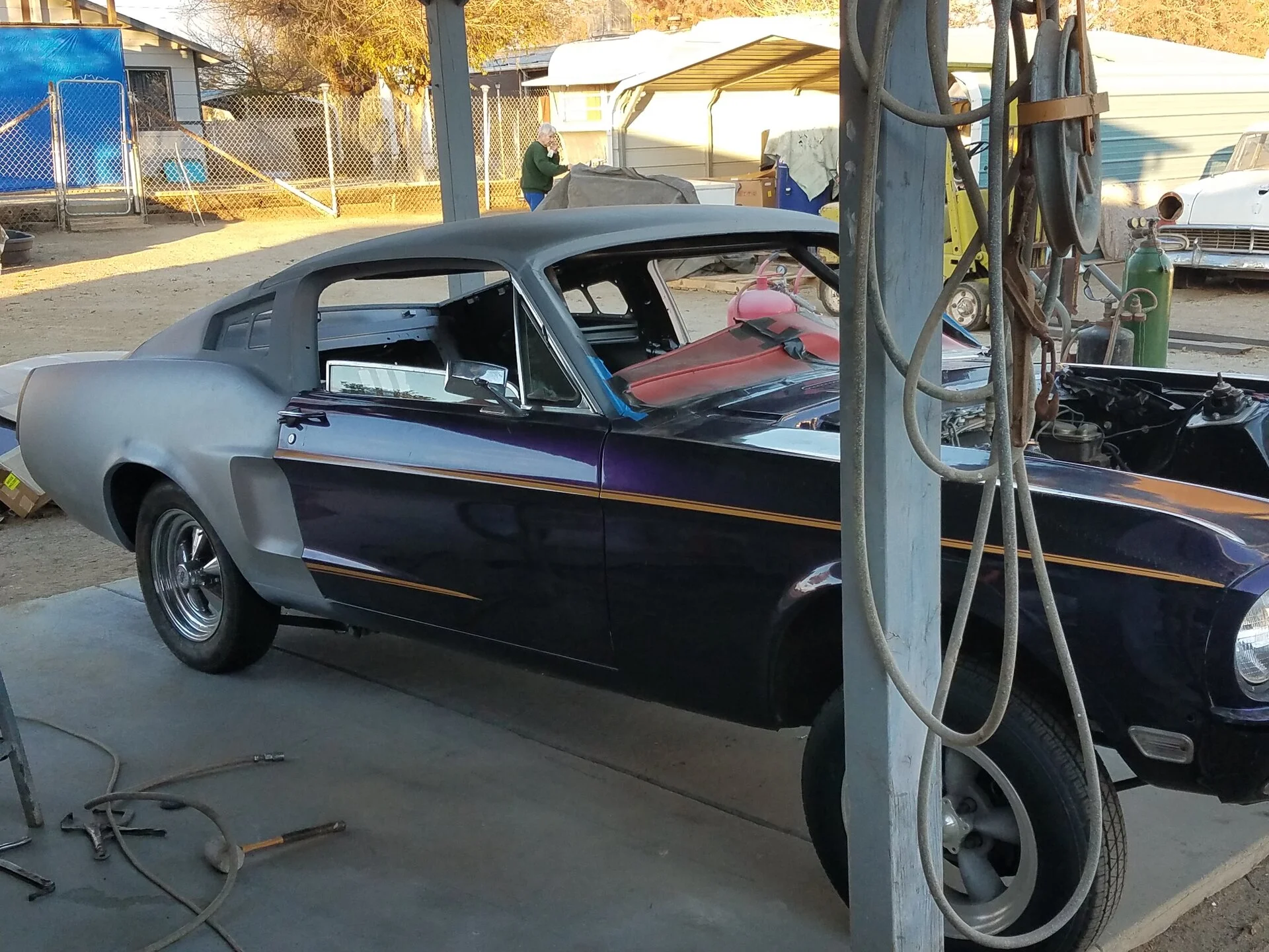

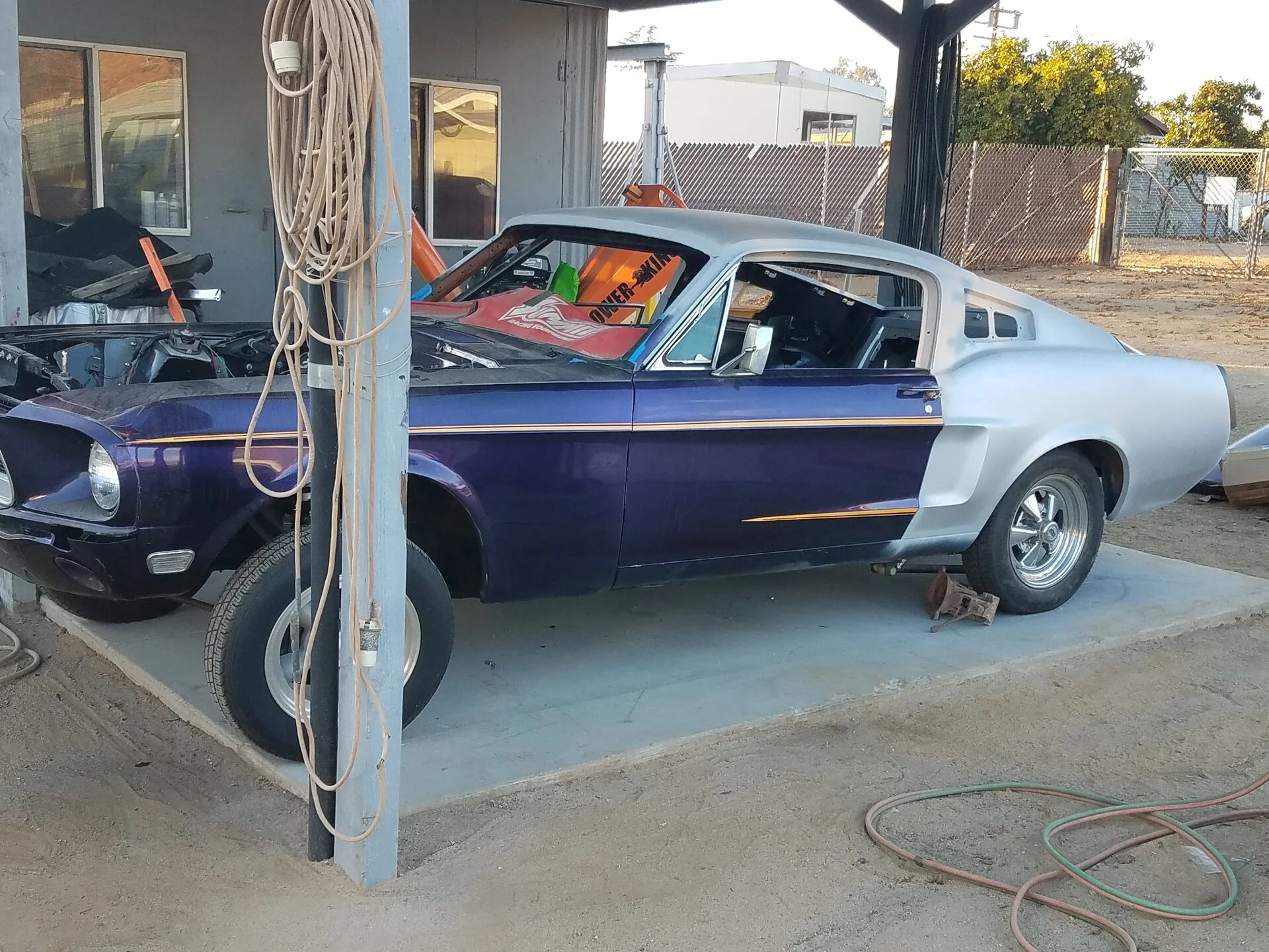

Except for cleaning up all the tools it is finished

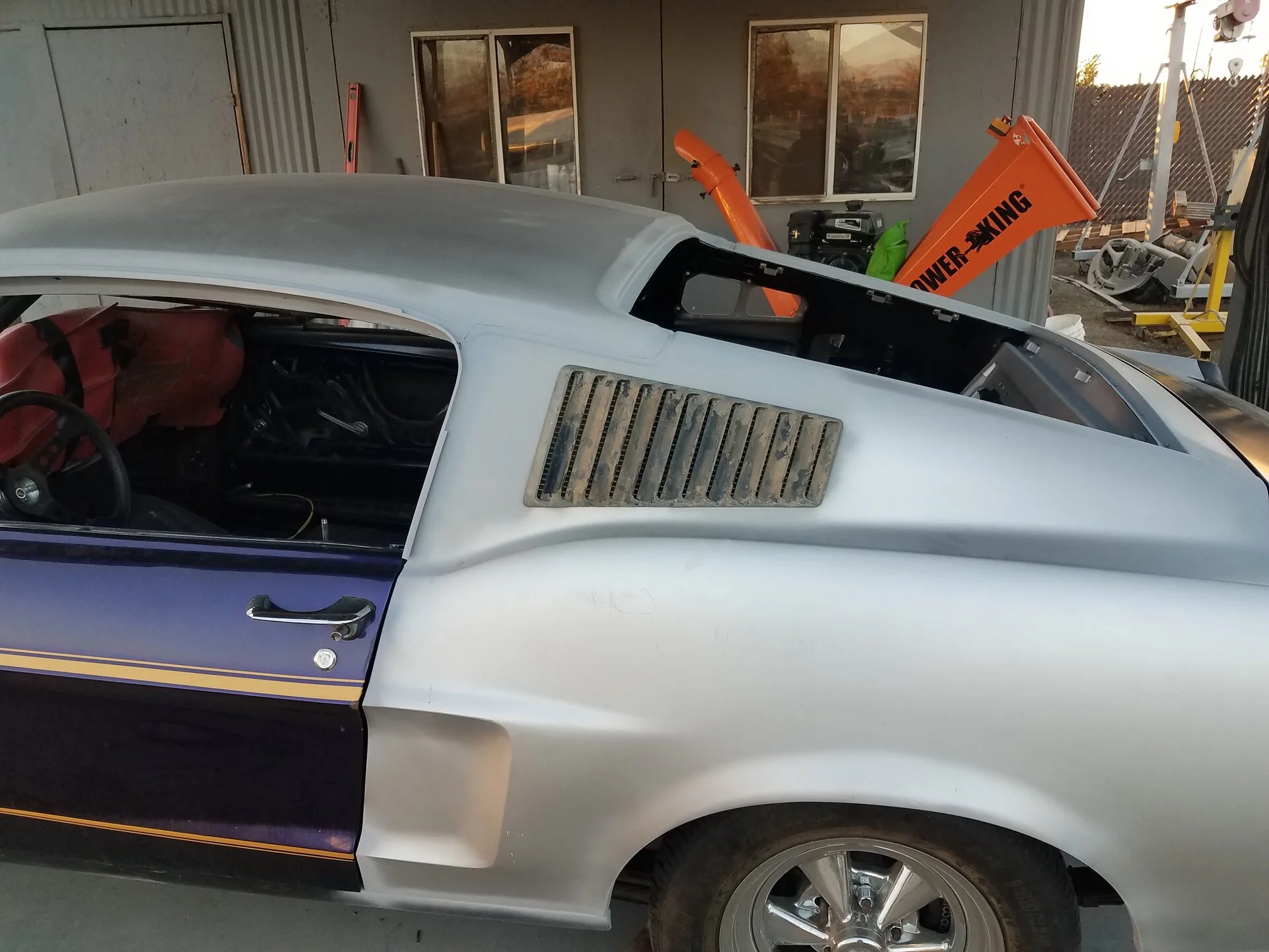

It looks like the vents are a perfect fit
