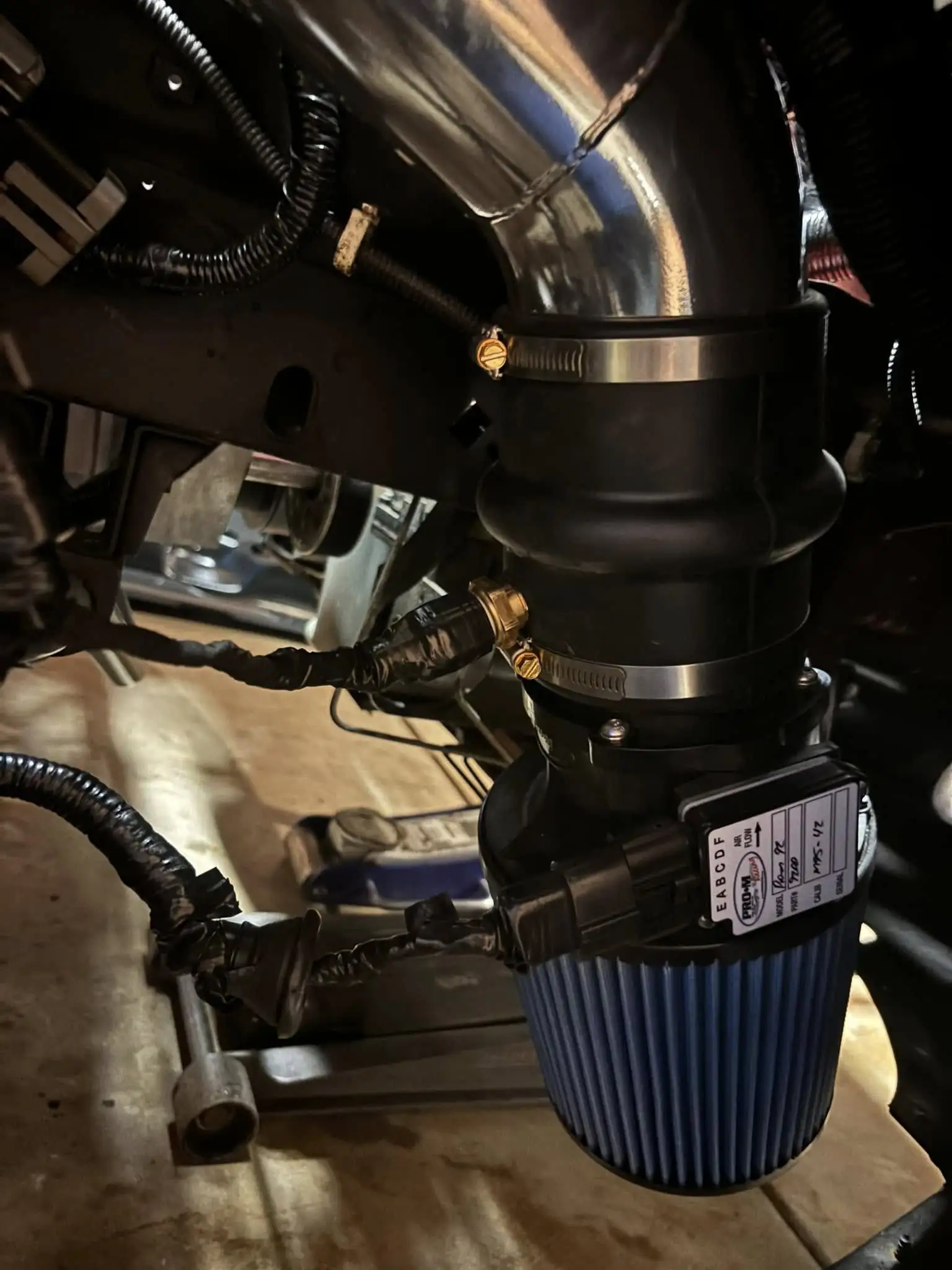

As for the Maf in the fenderwell as in the pic, is there something that will cover it to protect it even though my cars don't see rain unless I get caught out in it lol. I am usually pretty good with checking the forecasts and not getting caught out in or having to drive when it does start; I usually wait till stops or slacks up lmao. Also don't usually hit puddles or anything.

I know @nicholase fabbed up his own aluminum cover to protect the filter. Not sure if they make one premade or not. The fender liner should provide some protection I would think though.
Yeah the guy on Facebook whose pic that is actually someone asked him a question about the filter and he said yeah the liner is going to be on. He hasn't really been responding to questions I guess he's working on his car so but I did ask him about what liner. So yeah I guess it should be okay
