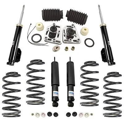

Sounds like you're interested in my combo, eh? :D
Summit offers a package with some of those components at a reasonable price, which is partly why I went that direction. They may not be ultra-hardcore race stuff, but I'm pretty happy with the way the car looks and handles. If anything, I might be inclined to change the springs some day, but they are OK for now. The shocks/struts and CC plates have been great so far.
Summit Racing 15-0076 - Summit Racing® Suspension Lowering Kit Pro Packs - Overview - SummitRacing.com
Ha yeah I'm interested. I'm not looking for hardcore race stuff anyway, just a nice weekend driver that looks/handles nice. I was looking to see if there were any good packages available anywhere and didn't see that one so thank you for the link
