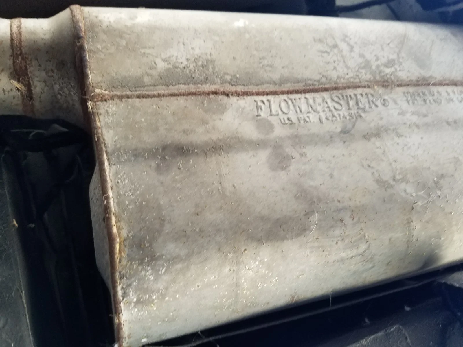

Drove out to a muffler shop to a price quote for catalytic converters near the transmission coverplate. Told we needed for cats for the car to be smog/street legal in California. A bit surprised because we see where two are missing (straightpipe connects/joins the exhaust pipes). We don't see anywhere else that is cut/replaced. We do see a Flowmaster exhaust, which my son says is not original.

2 cats & 2 mufflers.
Cats are in front of the mufflers.

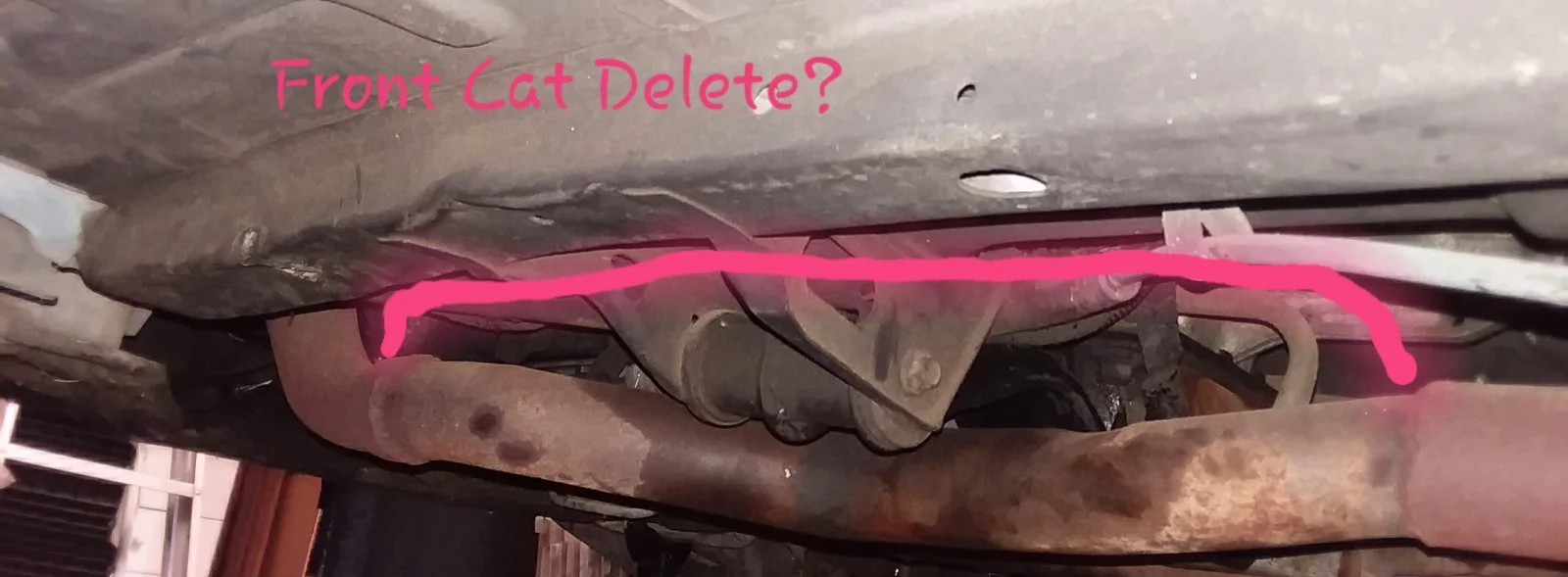

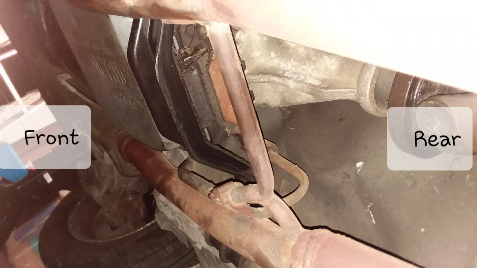

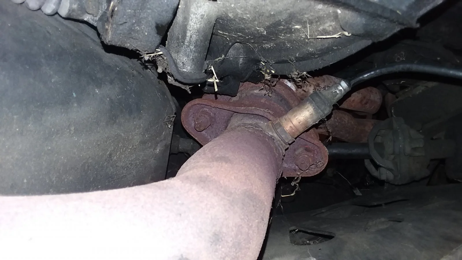

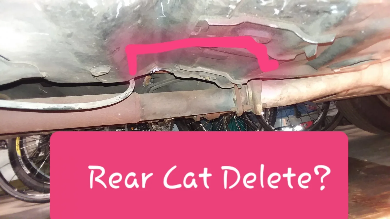

Think we see it now. Looks like what we thought was a connector pipe is the original. Is this where the cats were deleted? And, is the connection between the two pipes correct? We see the O2 sensor up on top. Is there supposed to be one after the cats?
Might be a bit pricey right now to get them but doubt we can get pass smog without them. If not Mustangs, any other car we can cannibalize for the cats?
There are 4 cats stock. Don't know about California and what is/is not legal as far as the number of cats required for smog inspections.
i have a stock catted h pipe, if you need a stock one pm me, I would call an inspection station and talk to a referee and also call a manufacturer like dynomax or flow master, maybe summit, I am pretty sure you can run what ever you like after the cats.
That's not a stock mid-pipe. It's been changed. It's possible it was an aftermarket 2-cat pipe, and then the cats were removed.

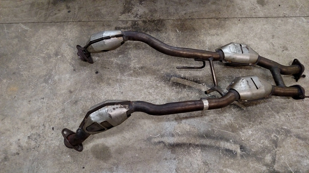

This is what the stock mid-pipe will look like. You also want to verify your air pump setup is present and hooked up. I see parts of it on the pic that look like they are present.
Interesting. Quick question: what is the small tube setup to the left of the cats on the right side of the picture? What does it serve to measure?
That tube runs up front to the pass side of the engine to a small series of rubber hoses and the air pump. During warmpup, the air pump sends air to the heads. When the engine is fully warmed up, the air is diverted down the metal tube to the 2nd pair of cats. The o2 in the air helps the converter do it's job as older cats, combined with these older, inefficient engines, need all the help they can get.

Unfortunately it's a crap shoot. Just shake the pipe and make sure nothing is loose as the cats usually crumble apart when they are bad. If they are solid, and don't appear clogged, you are likely ok.
Put off the trip to St Jude for later in the summer. Son graduated high school last week. Played the double bass with his school orchestra at the graduation. He wants to drive the mustang to st jude together later this summer. So we continue with the project.
Picked up an h-pipe with the four cats for $300 locally (about fifty miles out) and put it in last weekend. Also picked up a stock air box and intake tube to replace the "cold air intake" that came with the car. Told it wouldn't pass the visual on the smog test because it wasn't C. A.R.B. certified for California. Besides it was installed right inside the engine bay so not sure how it was supposed to bring in cold air.

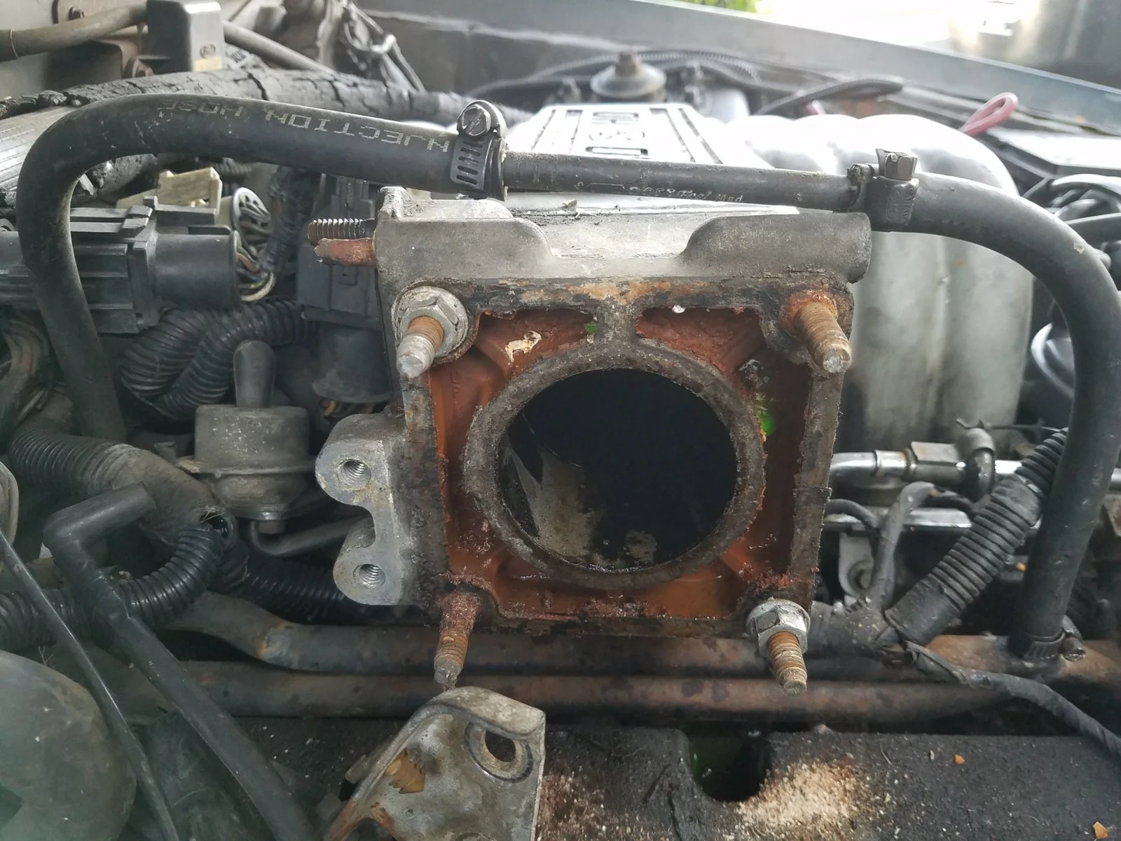

Anyway, when we pulled off the throttle body we noticed the egr spacer was pretty bunked up. We have a replacement one ready to put in because one nipple was rusted and rotted out (have been using a tube bypass as suggested previously). Still struggling to get it out though. Have been spraying penetrating fluid on the four bolts. Thought of using two nuts together and trying to remove the bolts instead.
While we were doing this, we noticed huge carbon deposits at the EGR connection and inside the upper intake manifold. Why would this occur? Doesn't the combustion take place in the cylinder? Does this mean that the car is running to rich and that the exhaust gas coming back in through the EGR has a lot of unburnt fuel in it? We don't see any smoke out the back of the exhaust pipes.
Yes, but having difficulty removing the plate. Two of the torx bolts are frozen. We broken (twisted) three torx screwdrivers and bits trying to remove them. Thought about heating them and about cutting straight lines in them to see it makes it easier to remove them.
Btw, one it comes off, do we use brake cleaner or carburetor cleaner to remove the build up? Or something else?
Thx, jhp & son
You talking about the 4 studs holding the tb on? That spacer can be a pain, spray it down at the gasket with pb blaster, the tap it with a hammer, a small screw driver between the spacer and the intake opening will help, work the three sides you can get at, tap, tap ,tap, gently tap the flat blade screw driver between them then tap on the spacer, change positions of the screw driver and tap the spacer some more. Slow process, you don't want to damage the intake opening, all this is caused by electrolysis, iron, aluminum and water flowing, same thing happens with the timing cover.
