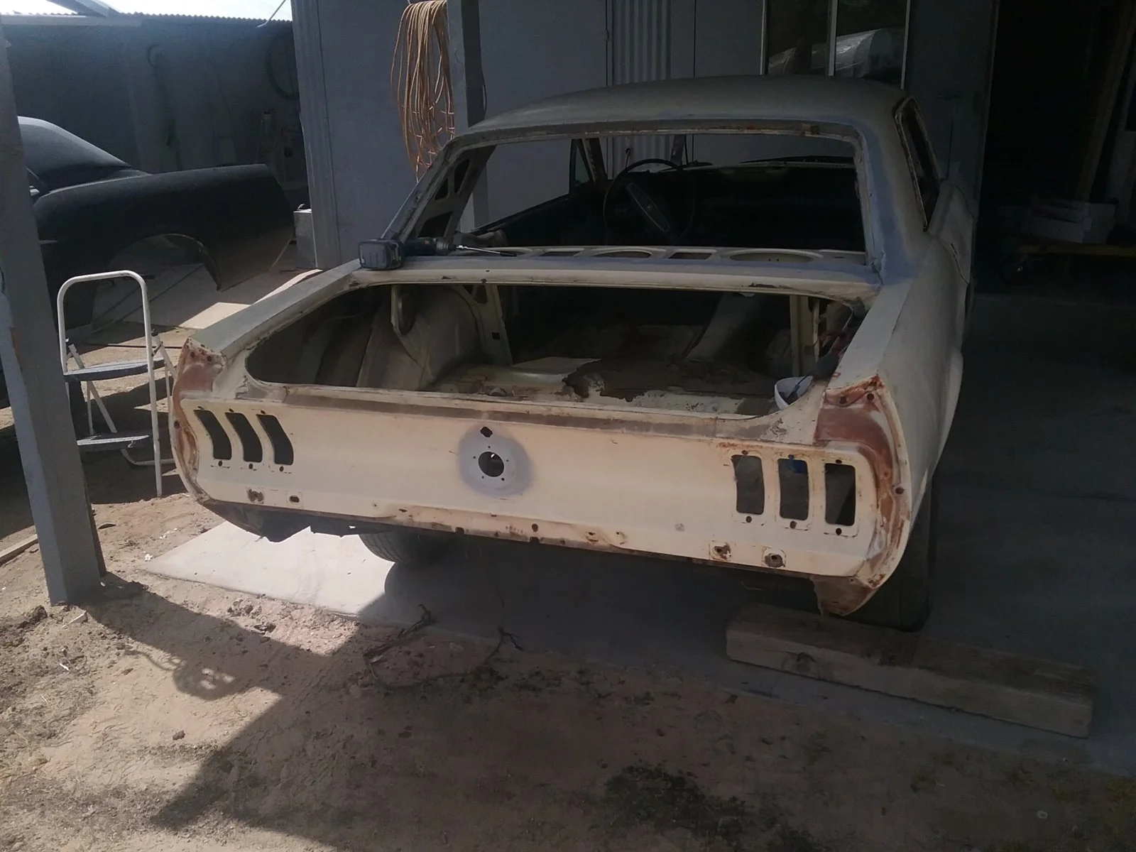

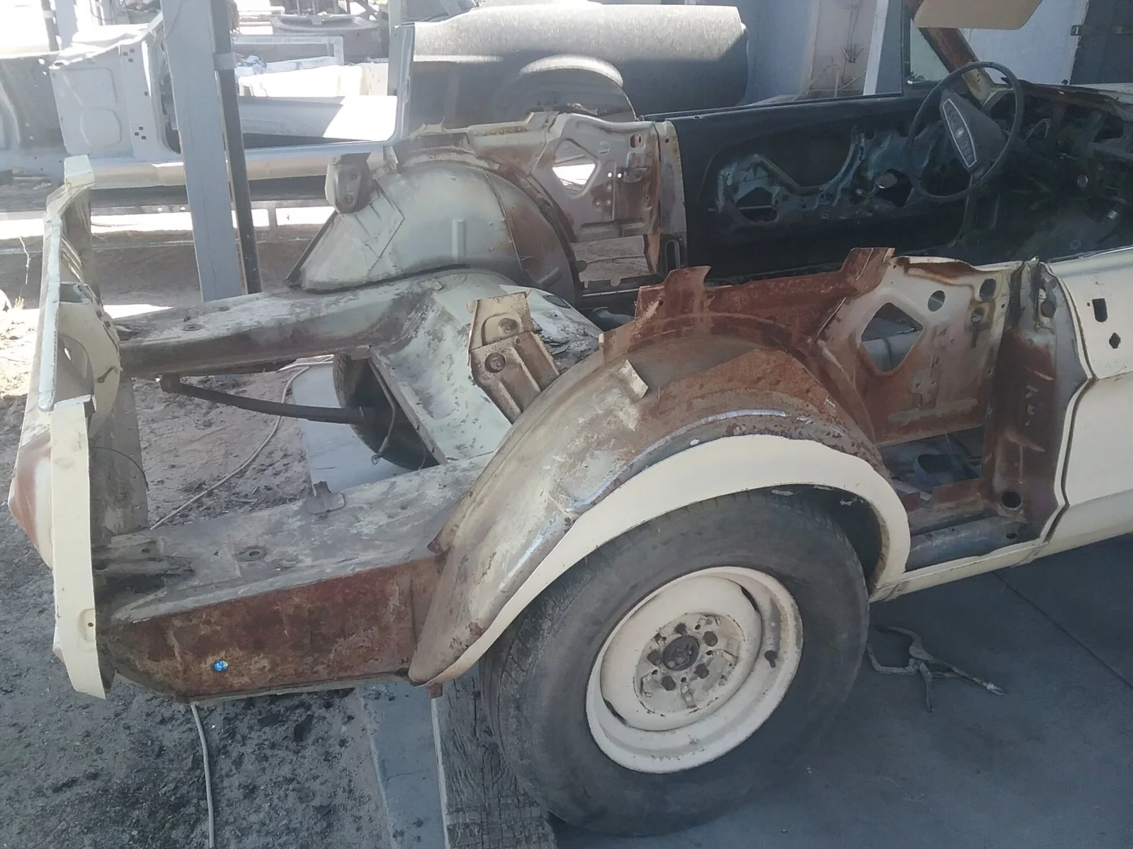

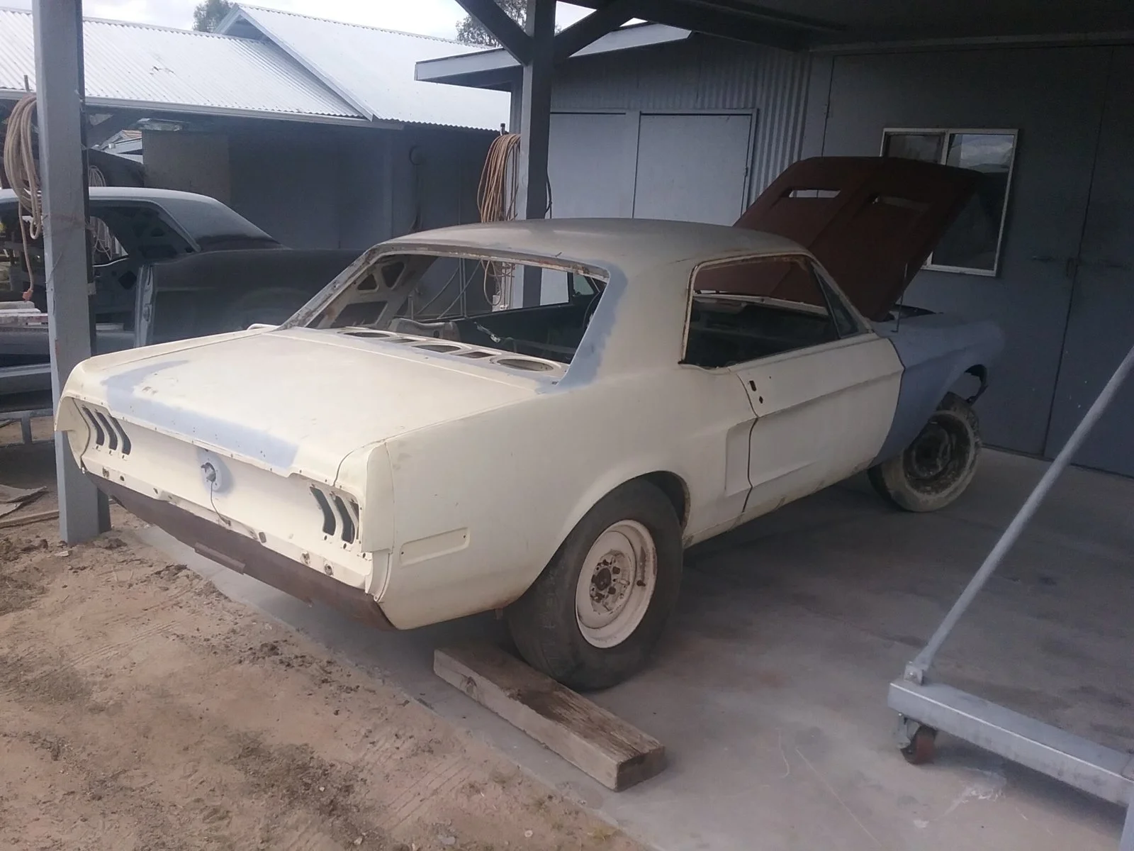

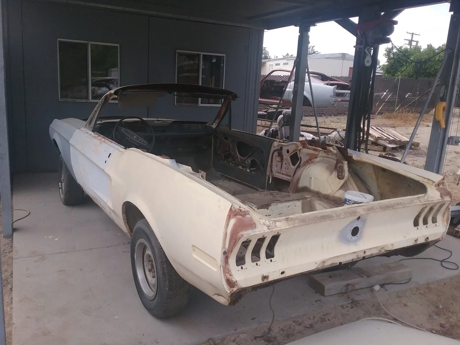

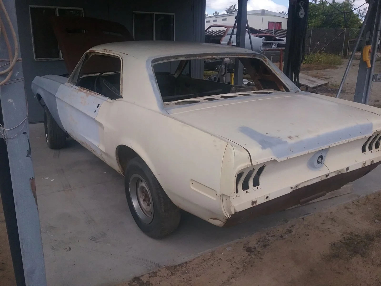

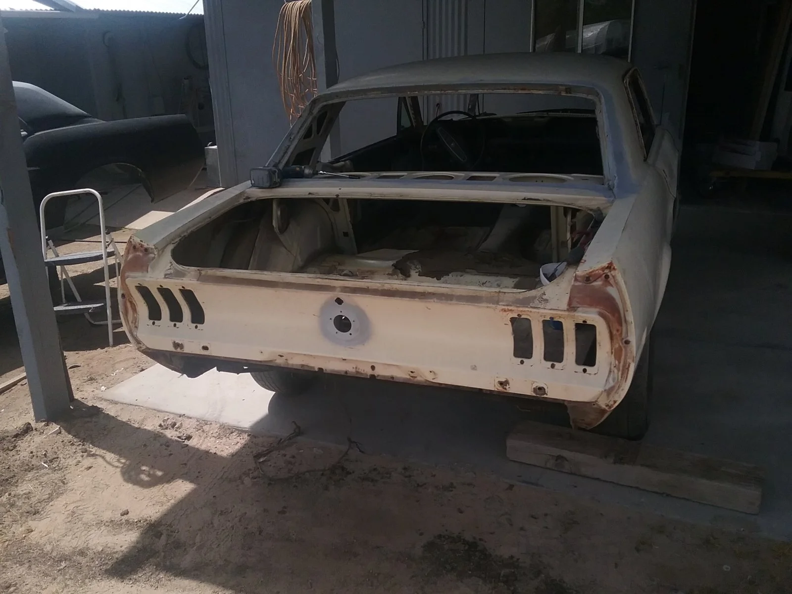

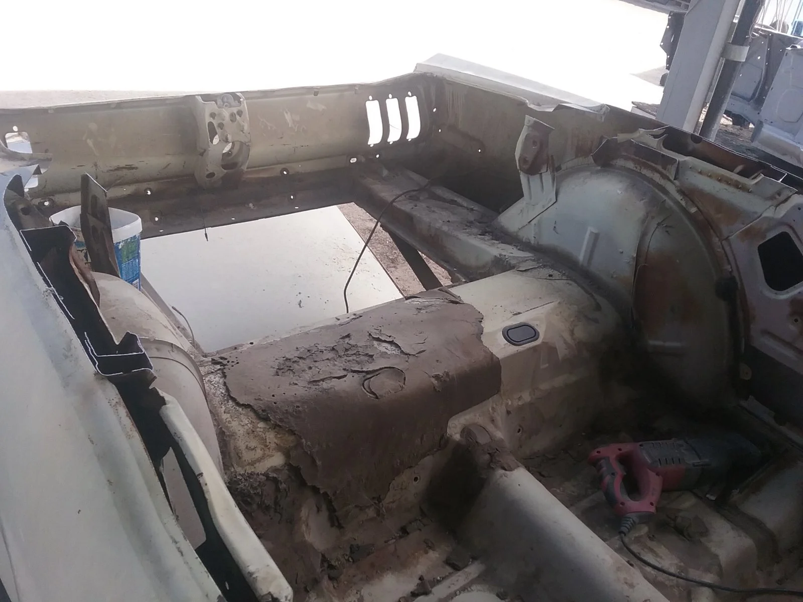

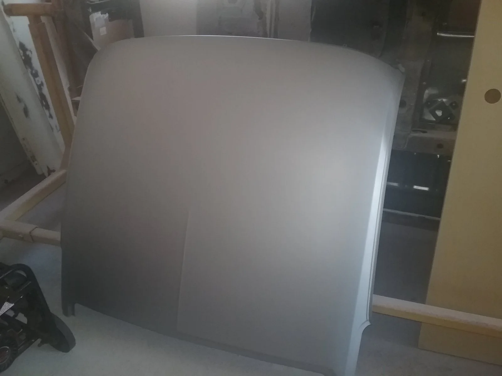

Just picked up another conversion .Its a pretty clean 68 coupe that will be converted to a fast back with the help of all new Dynacorn sheet metal .this will be finished out as a 68 Shelby fast back

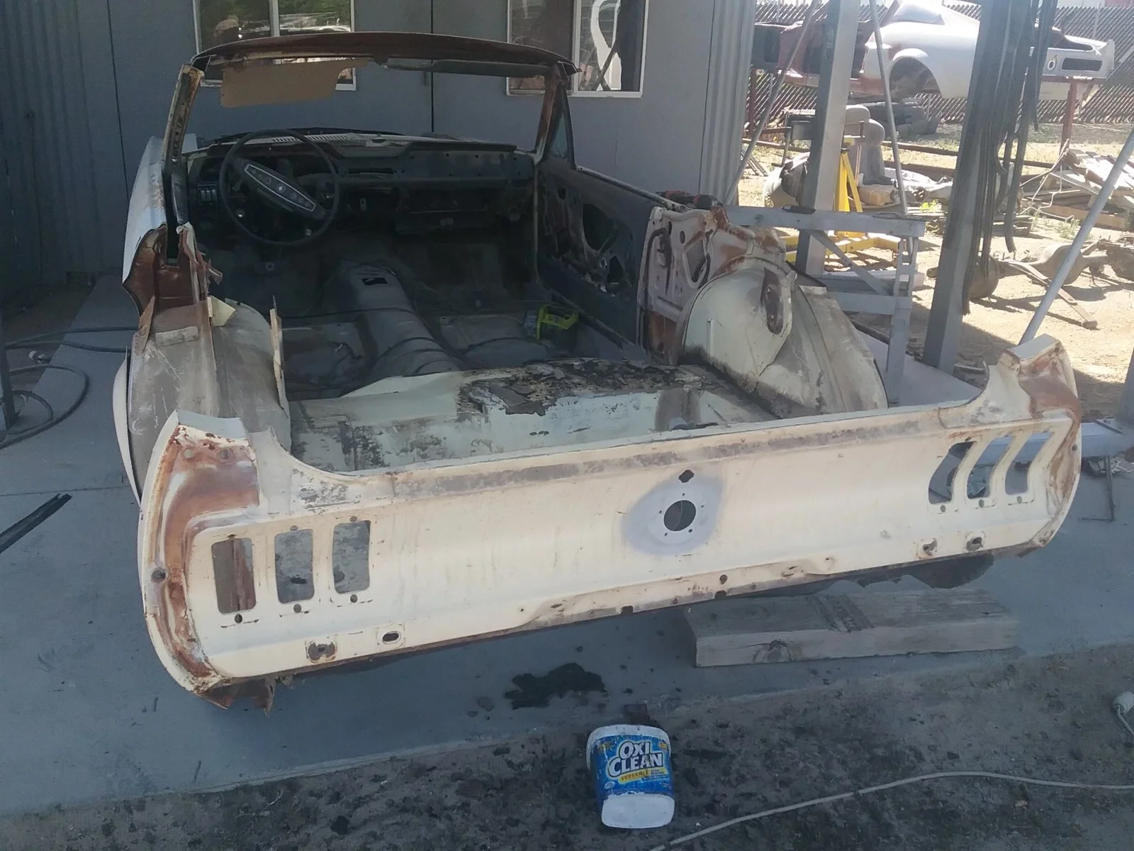

Hood ,trunklid ,end caps and rear valance removed. It will be placed on stands and leveled front to back and side to side before any panel removal. The doors will be left in place and adjusted to the very best fit before any panel removal ,the new quarters will then be fit to the doors
