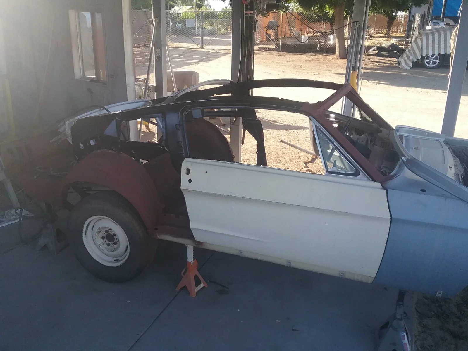

Build Thread Another 68 coupe to fast back conversion

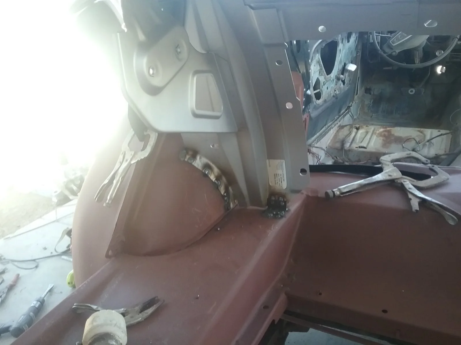

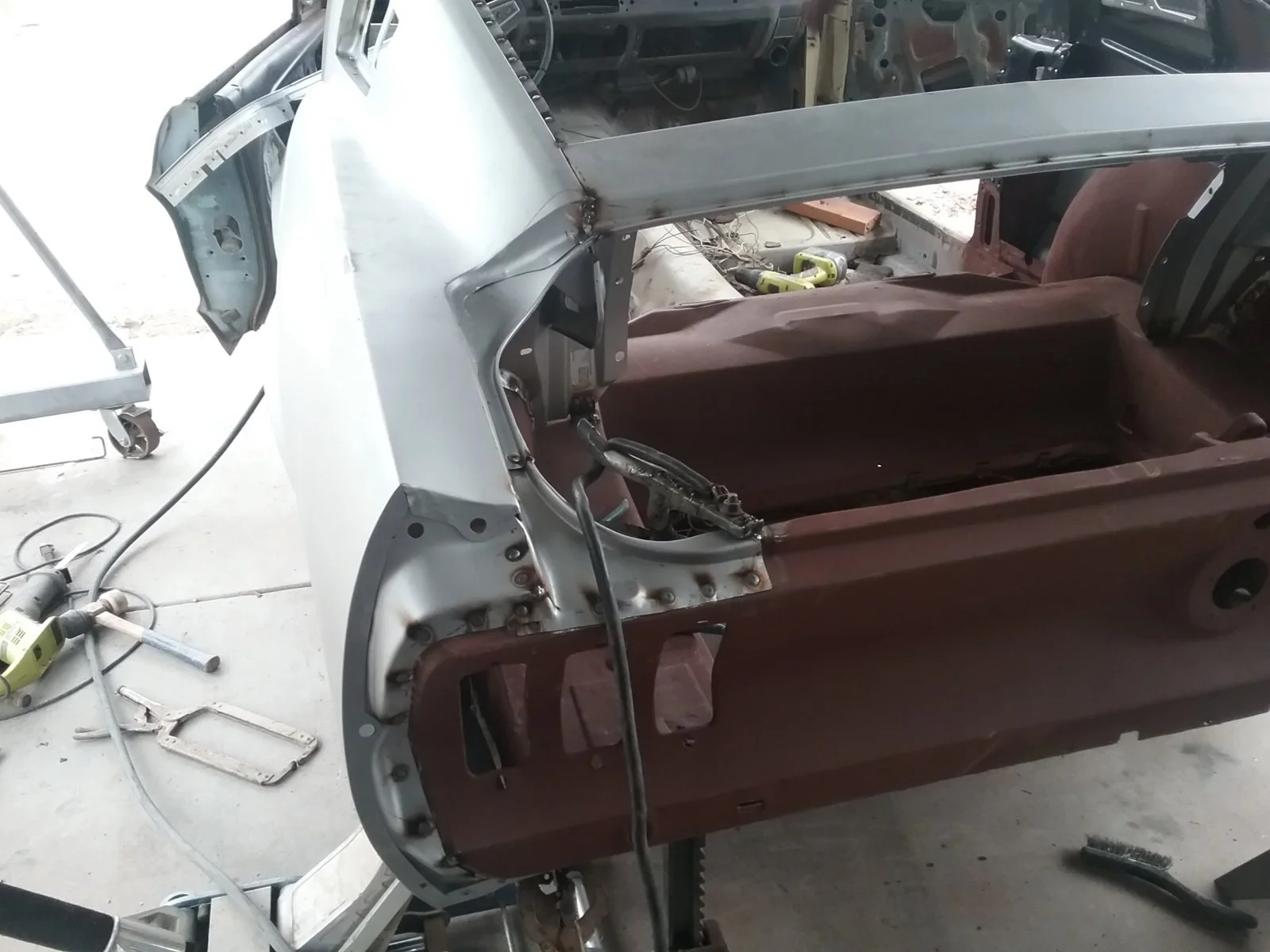

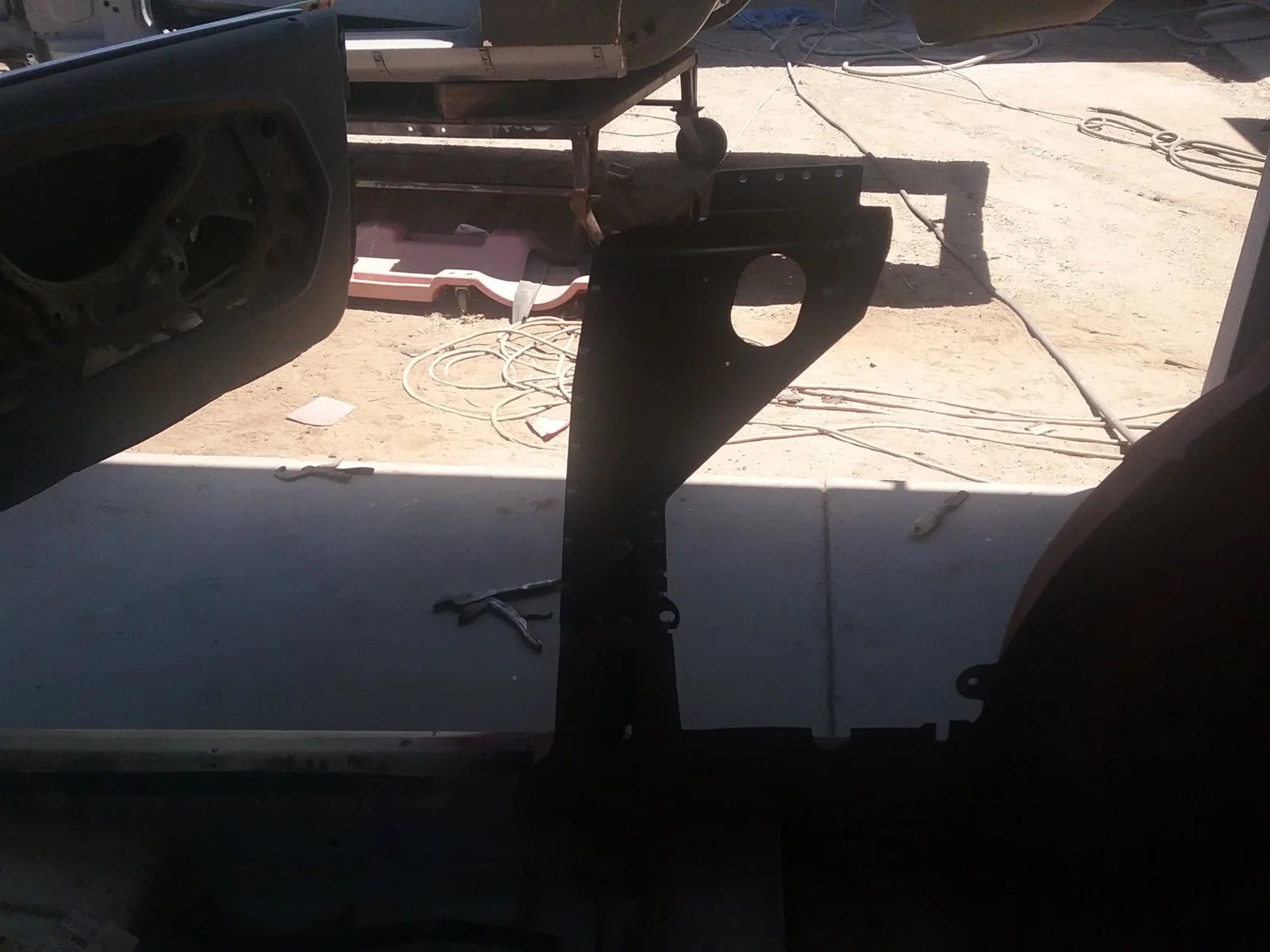

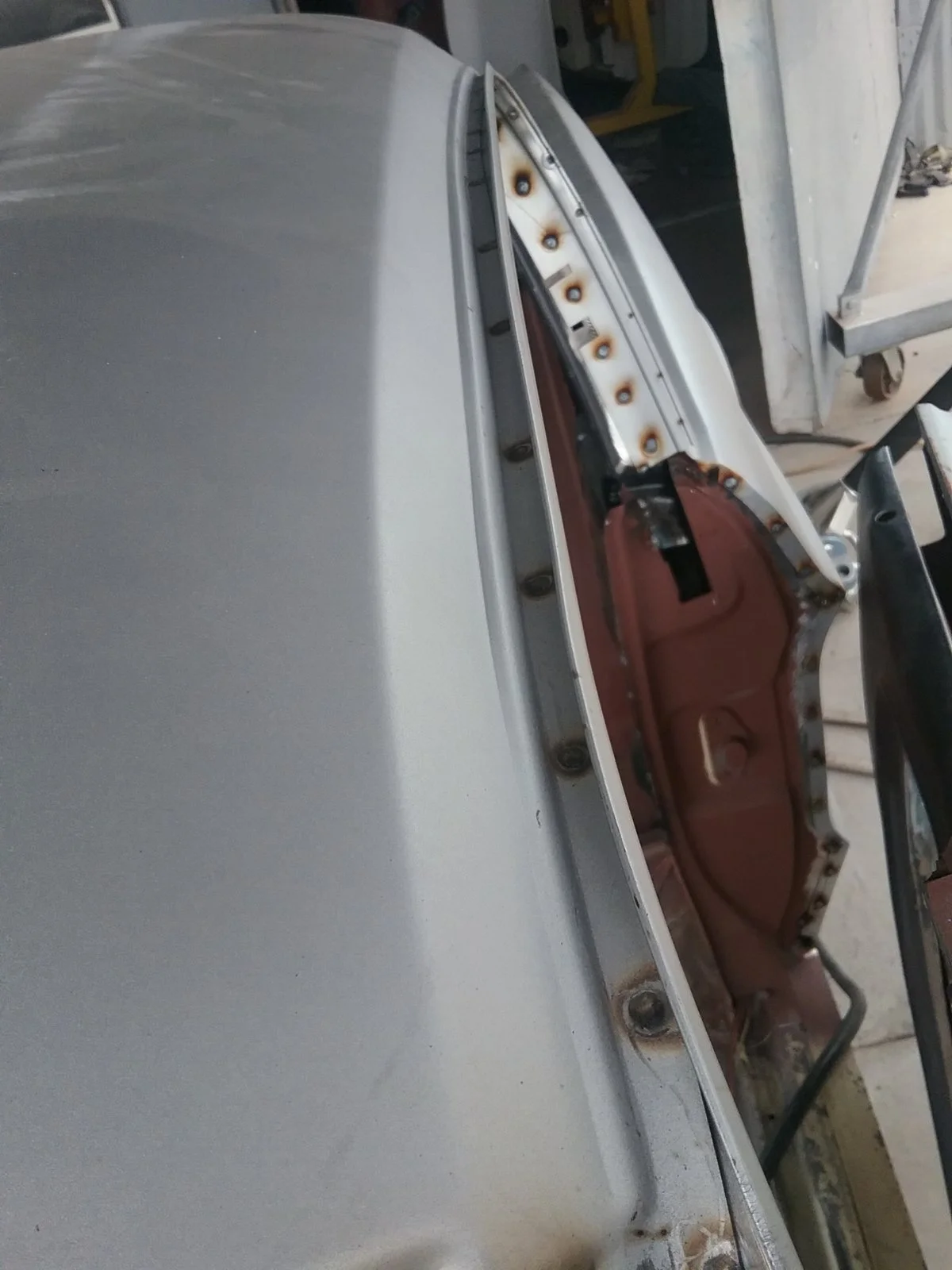

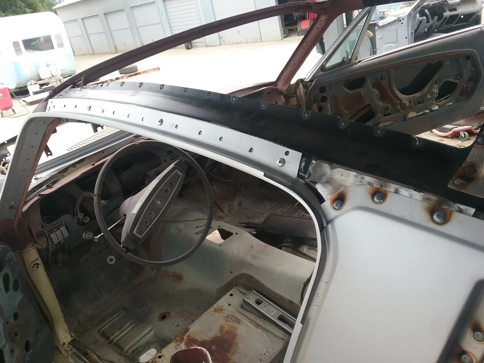

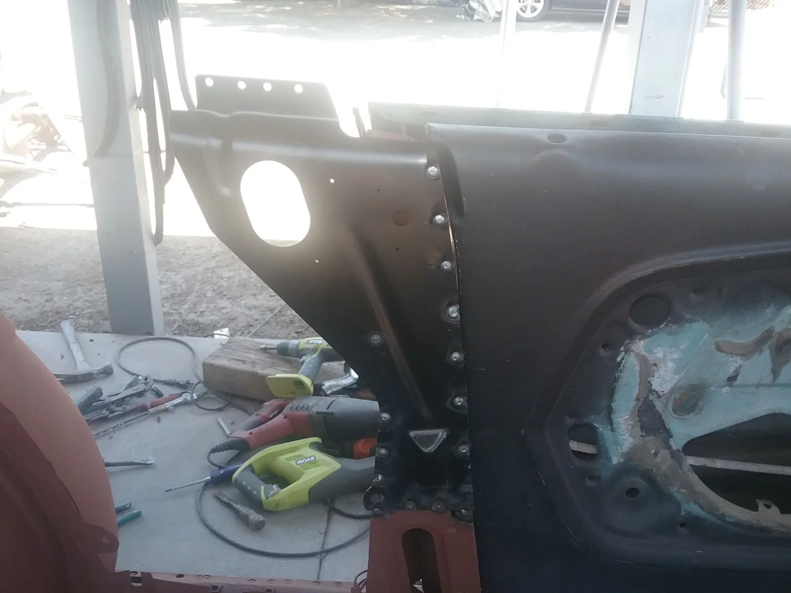

Now that i see everything fits the way it should i took it back apart . It is time to finish the inside of the rear door post,i pre punched plug weld holes ,clamped the inner post and welded it

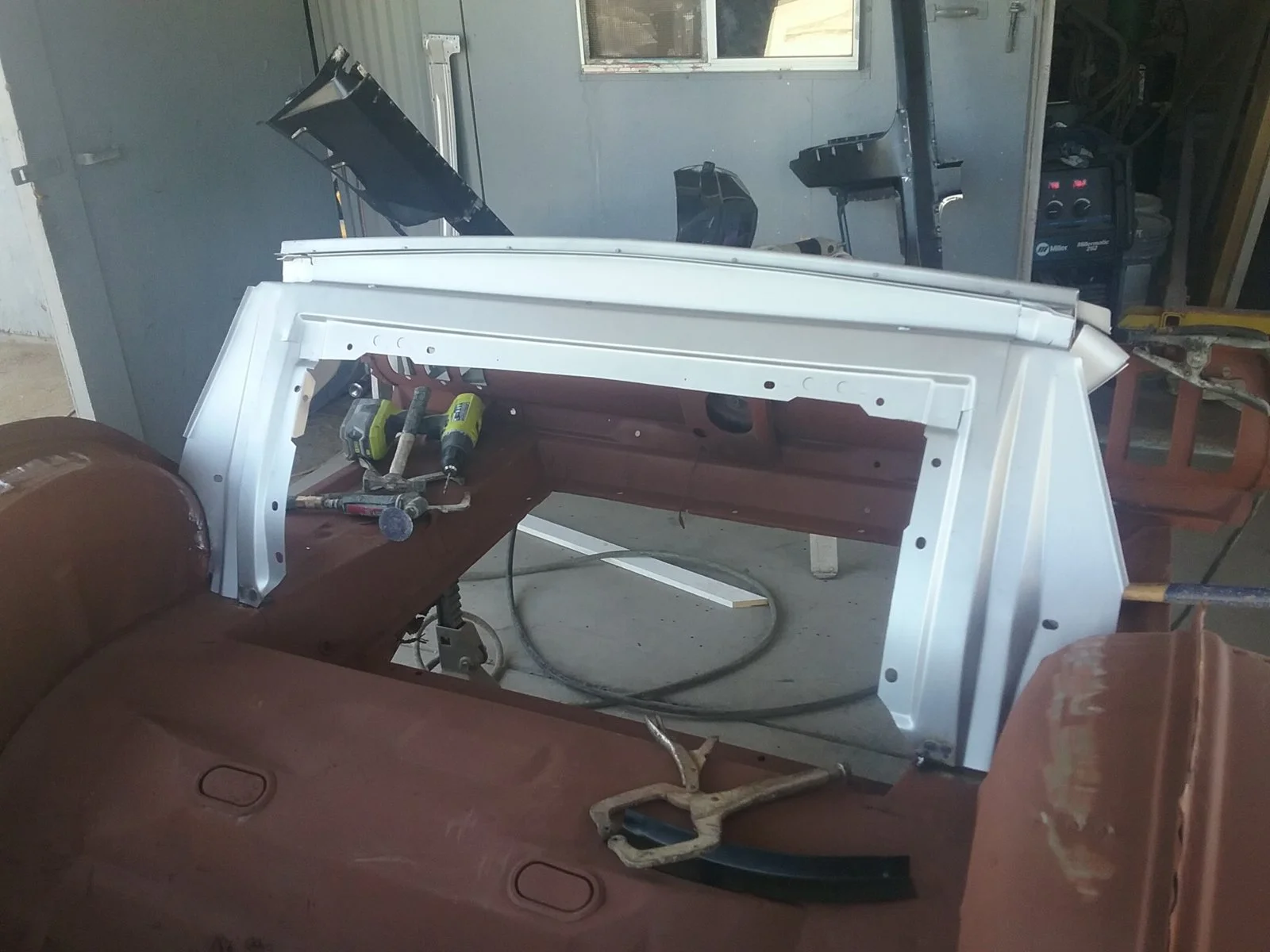

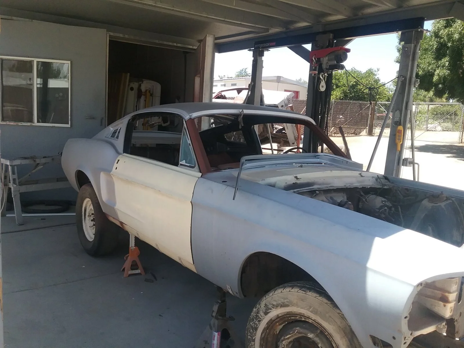

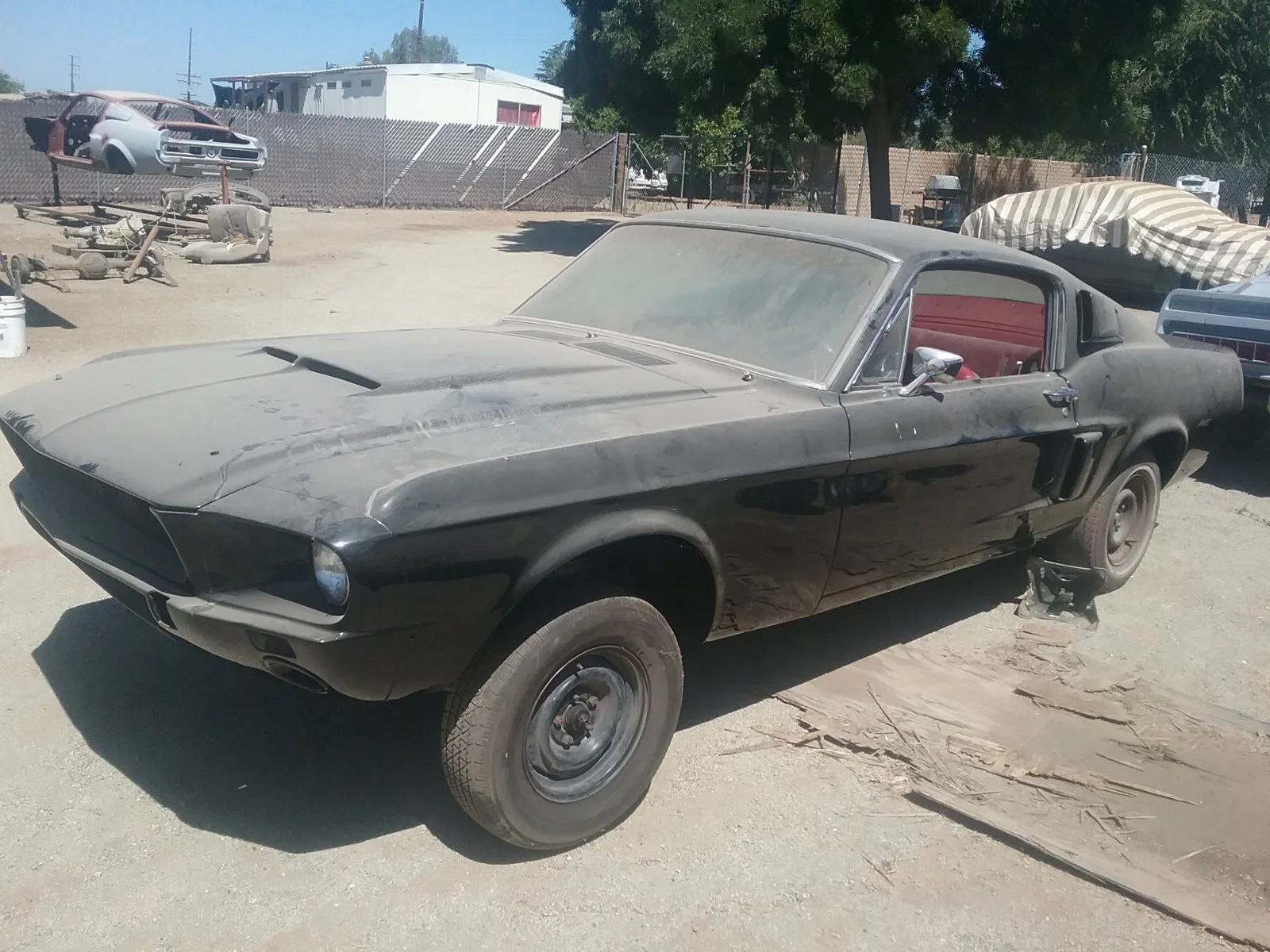

Now i am ready for the back seat panel ,i still have to get my black fastback off the lift for measurements

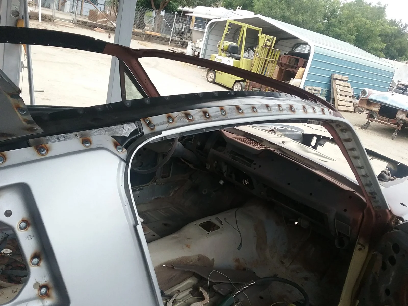

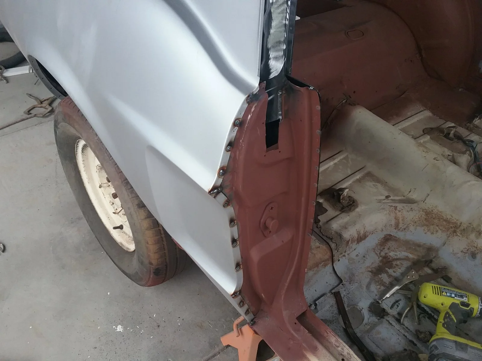

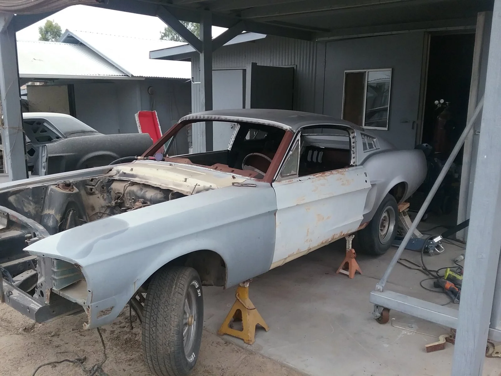

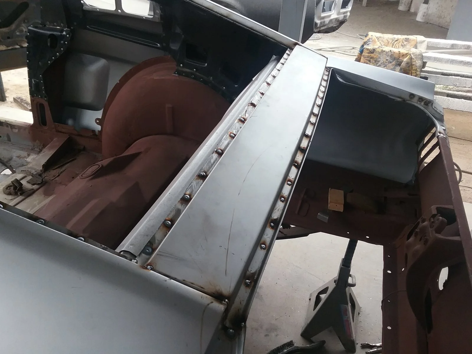

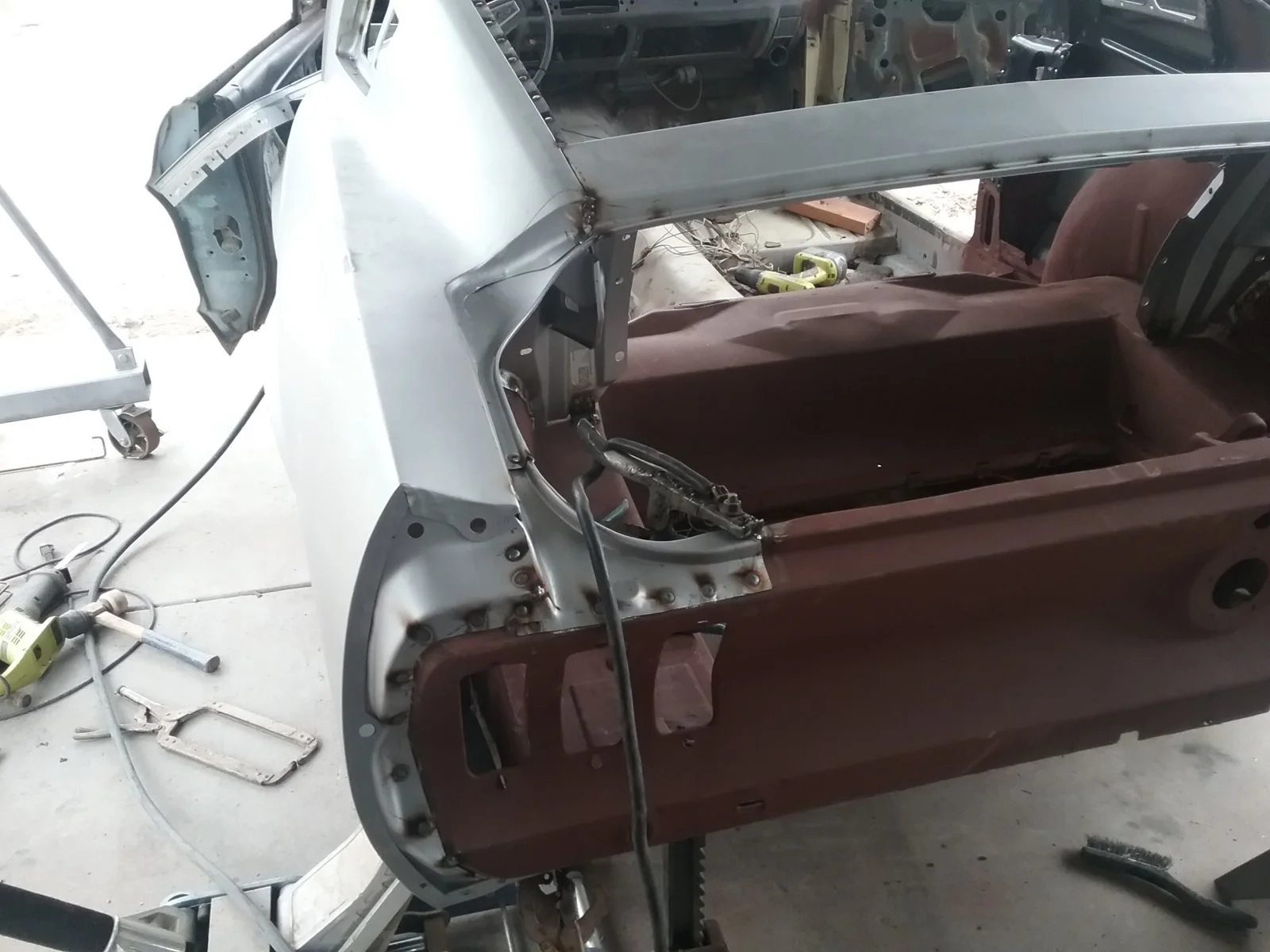

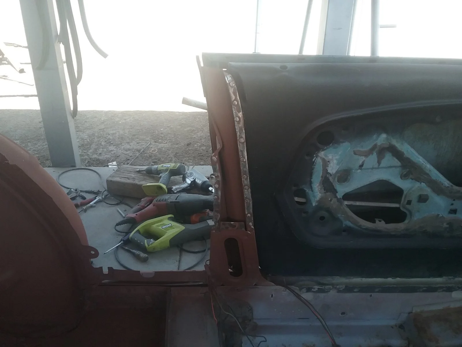

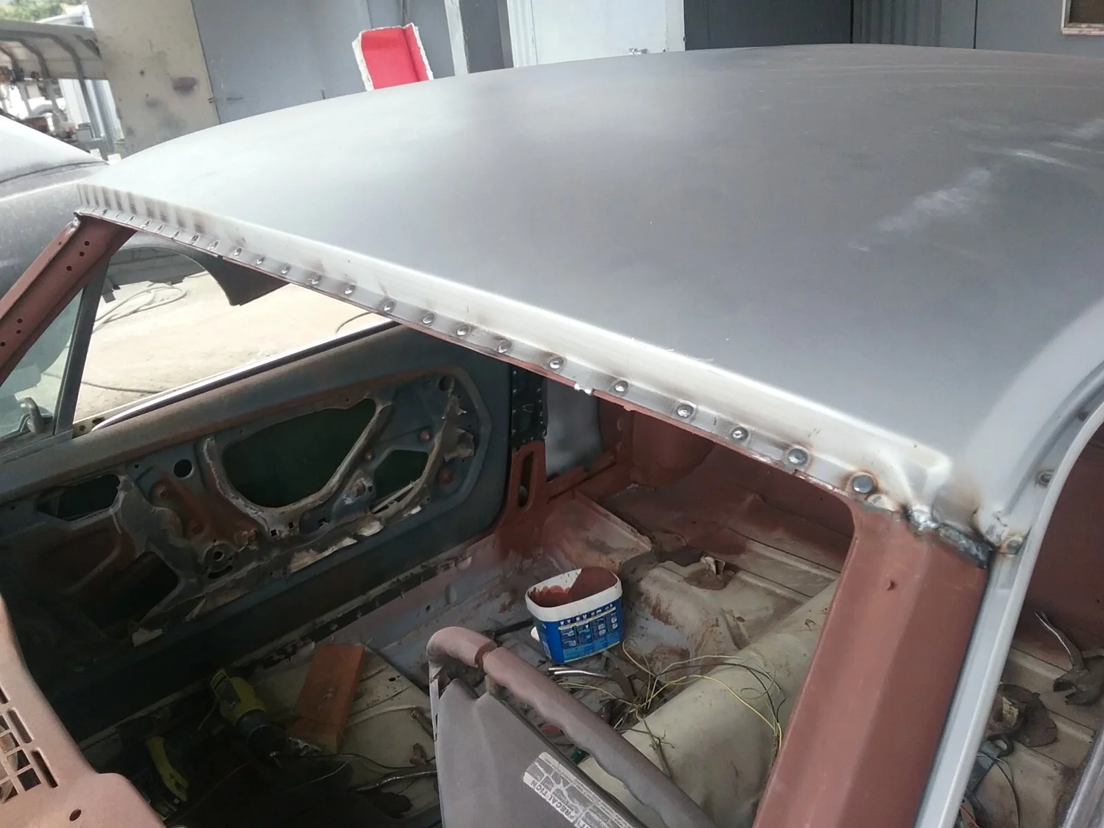

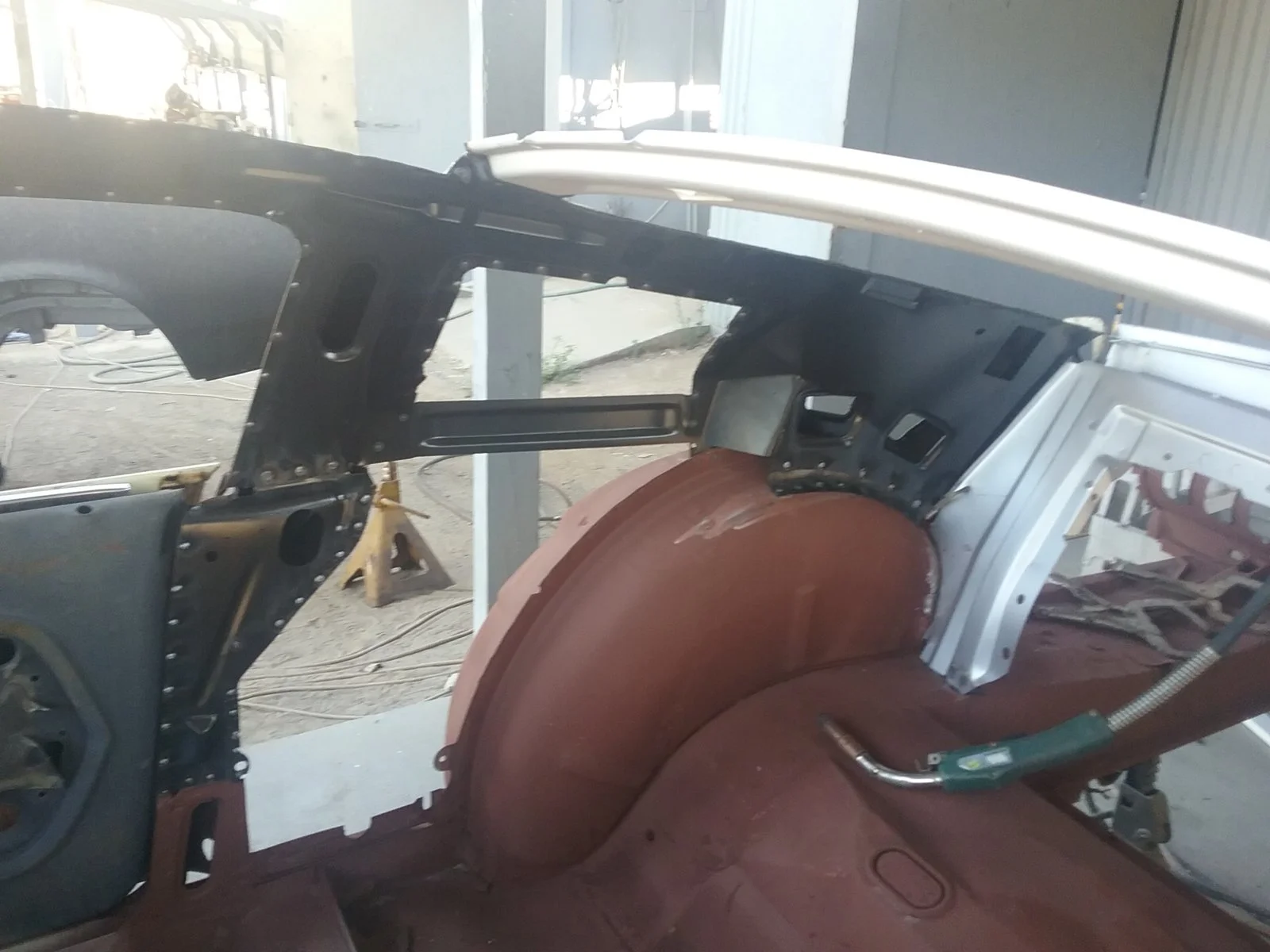

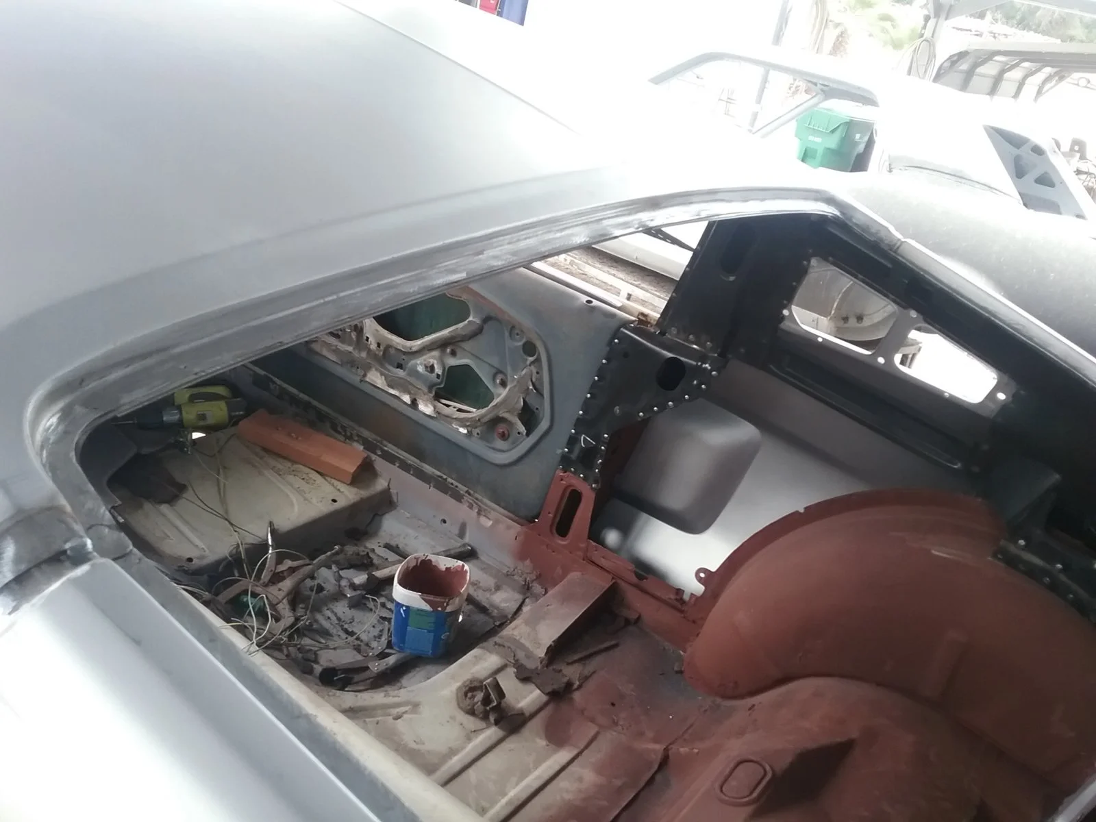

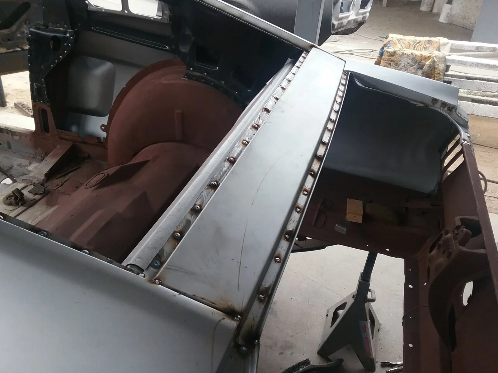

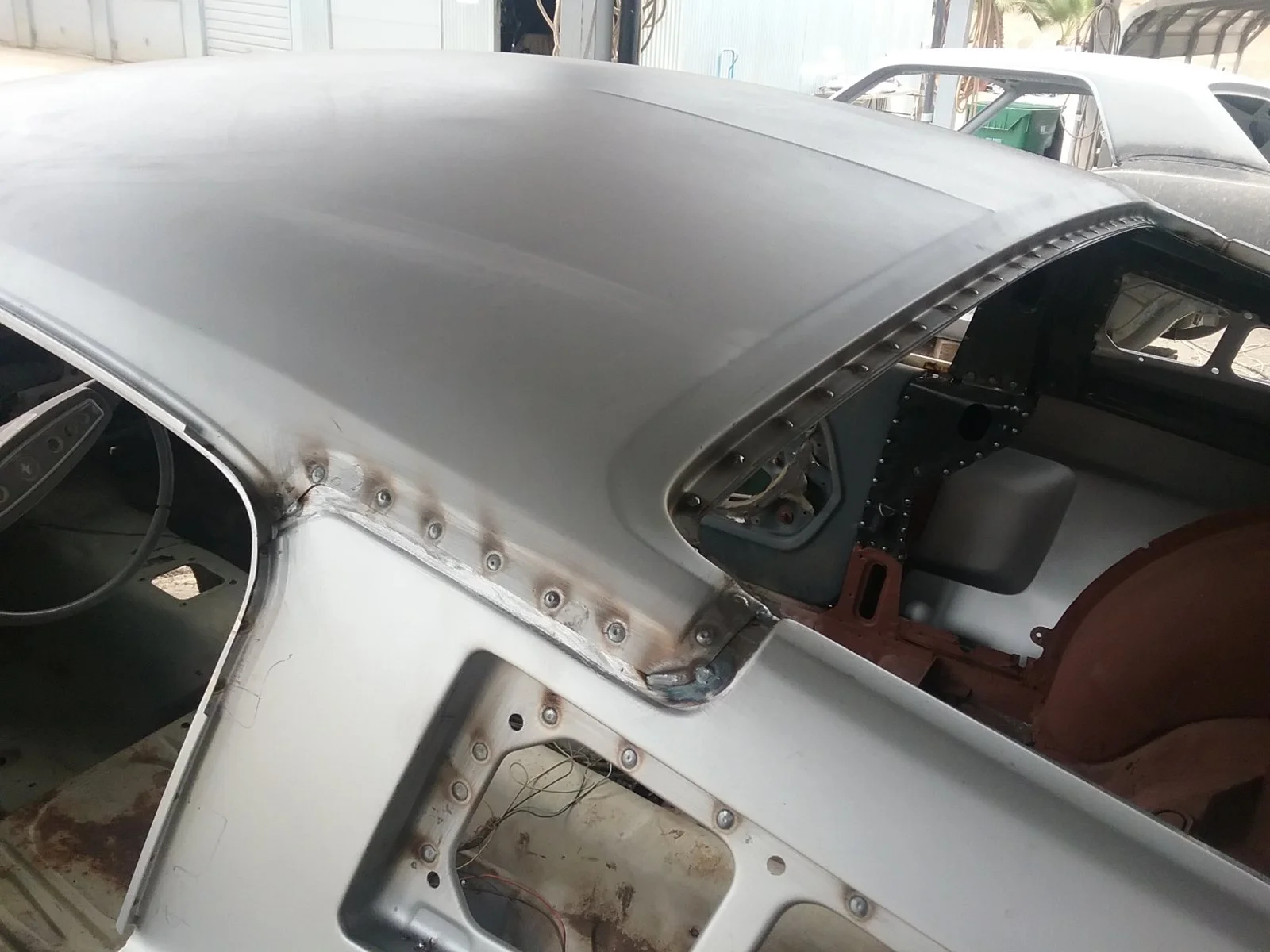

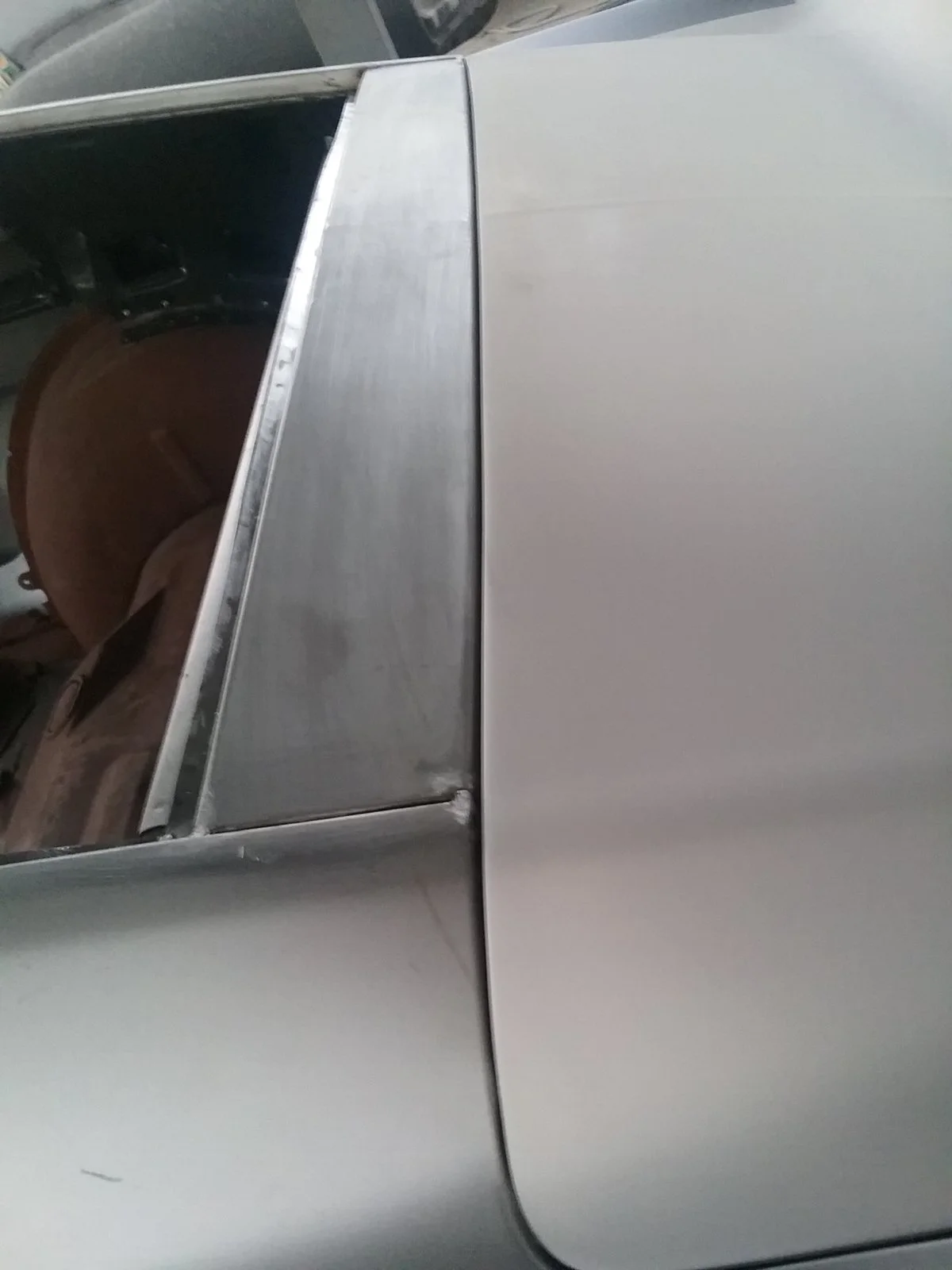

The door frame is next ,lots of clamps and measuring ,once i was happy ,i welded it up . The welder was working the best i think it ever has ,will not be much grinding to smooth off the plug welds.

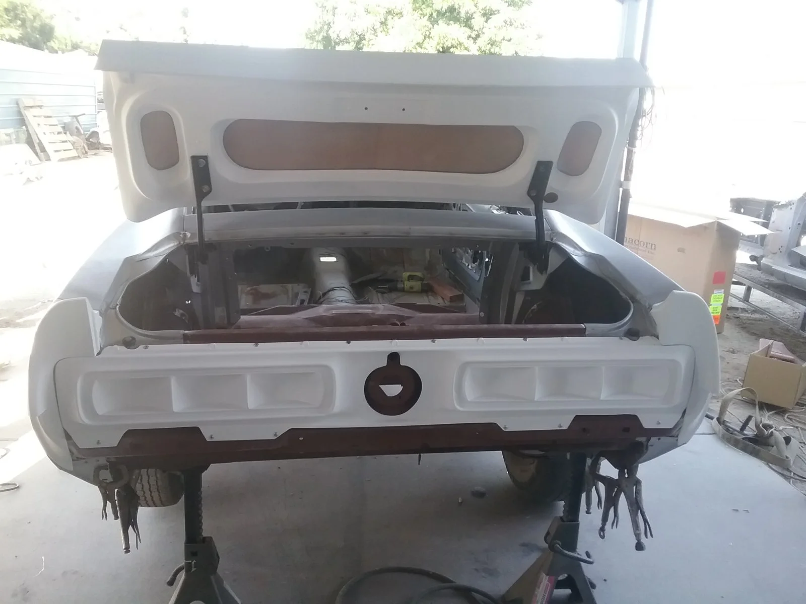

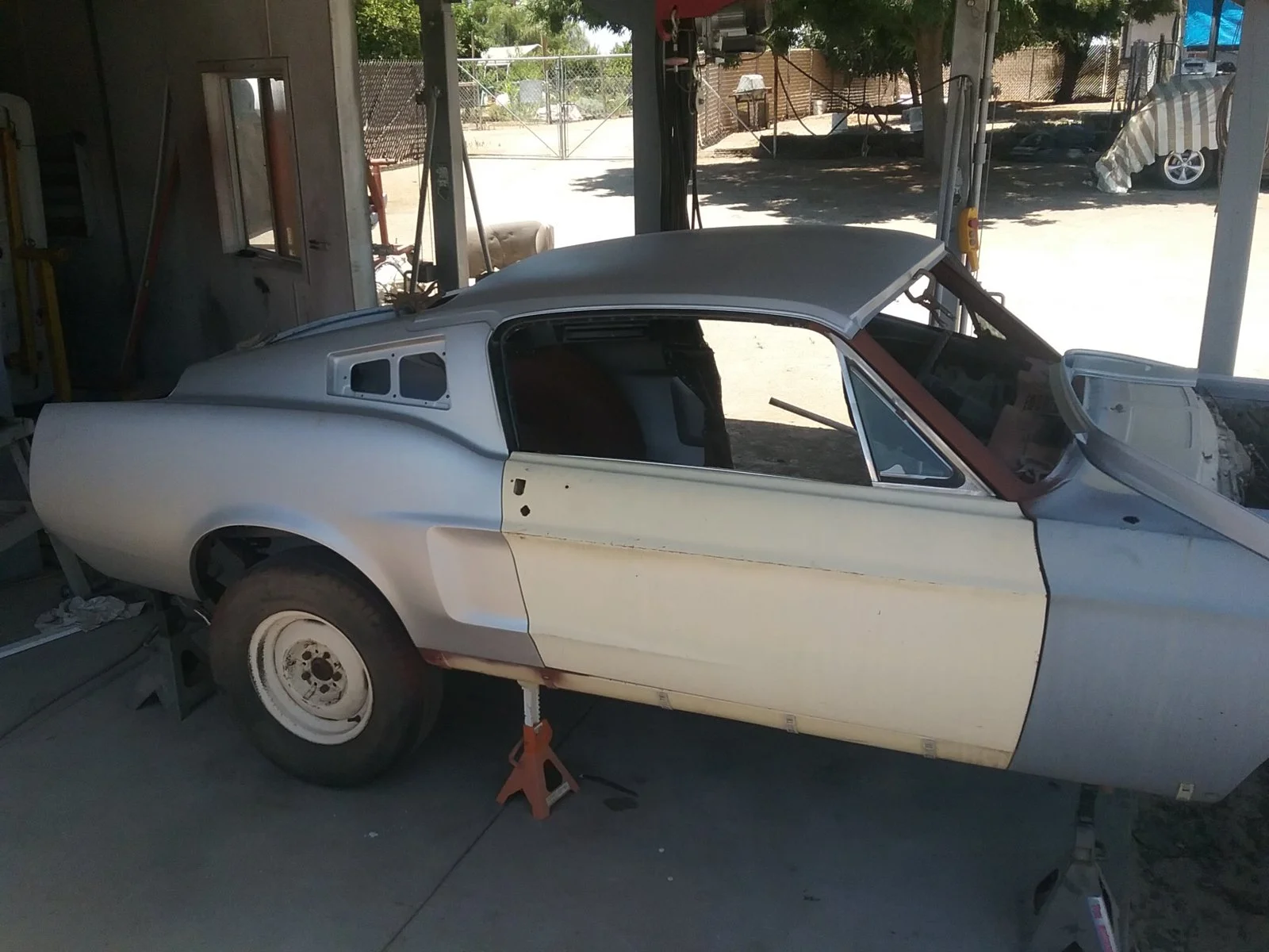

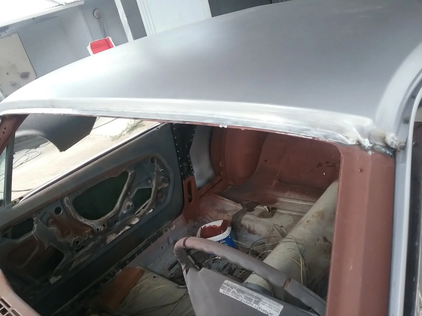

the skeleton is done ,the rain gutter is next ,then the quarters and last ,the roof

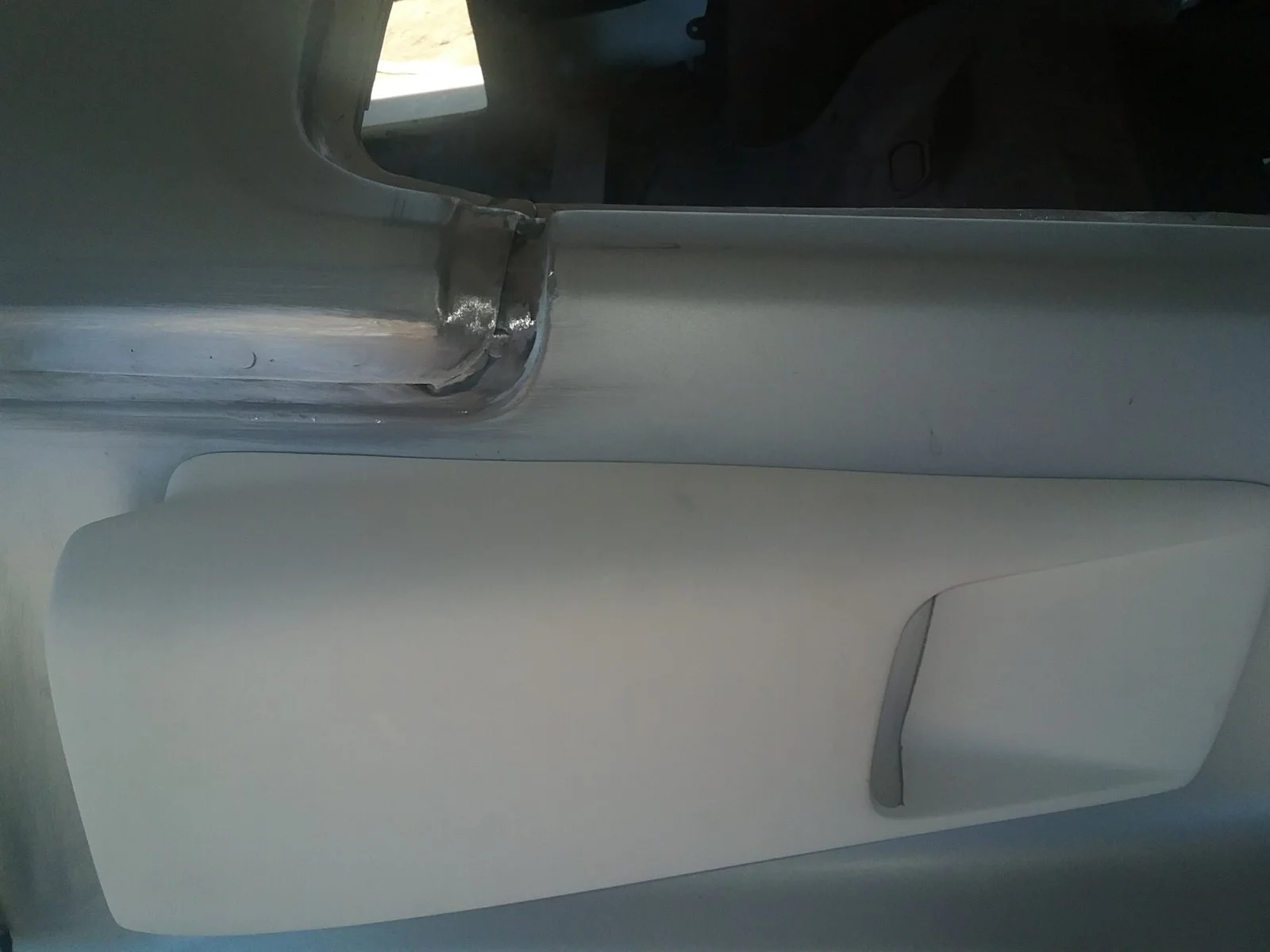

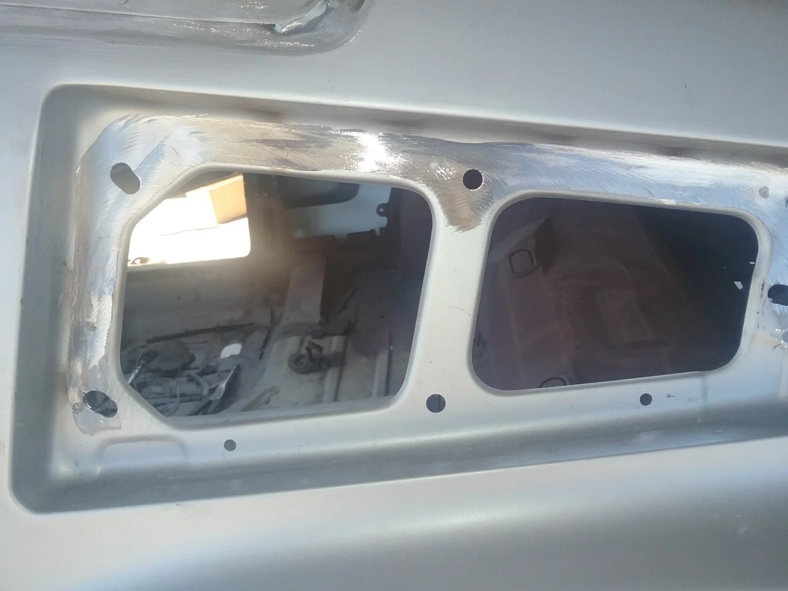

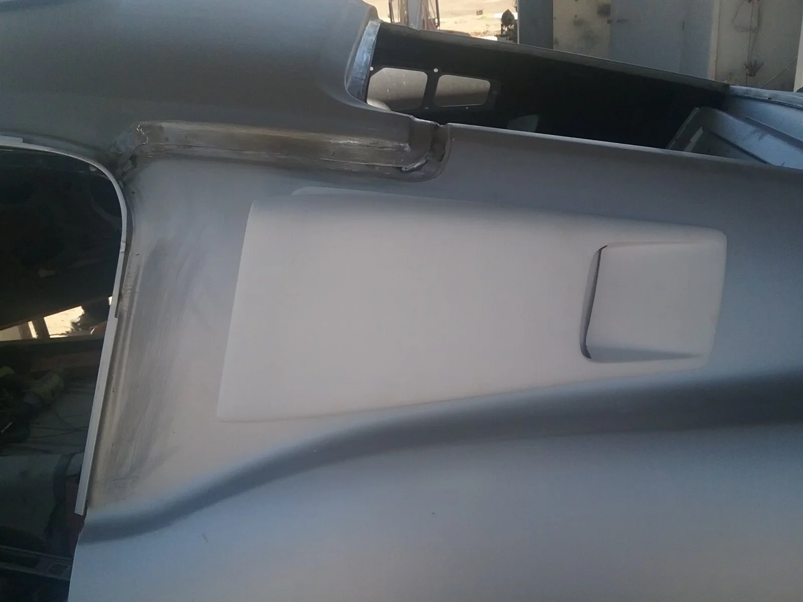

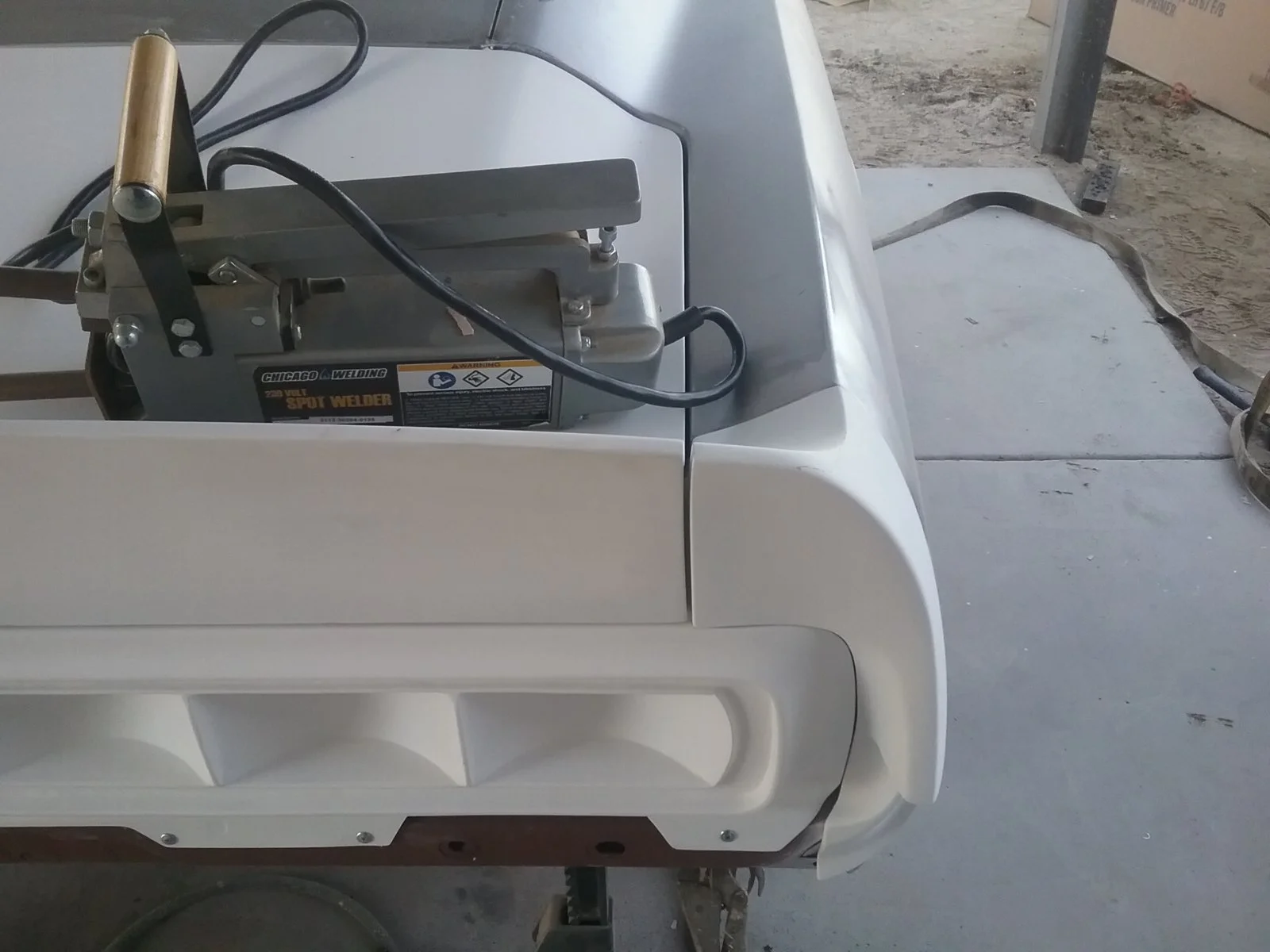

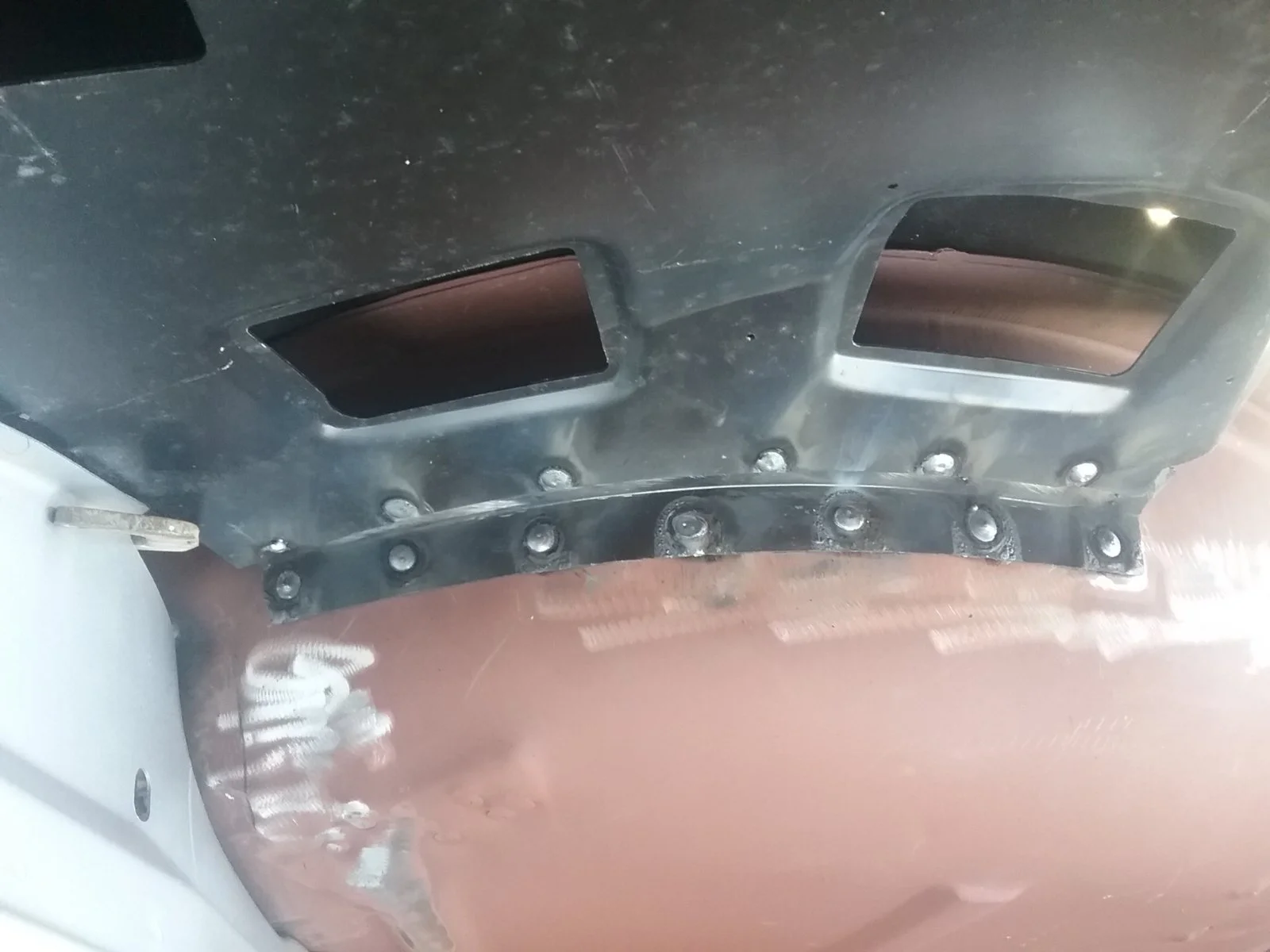

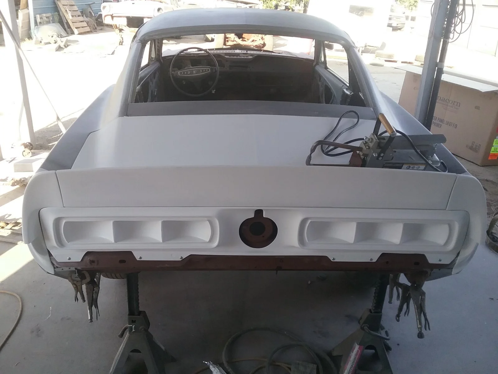

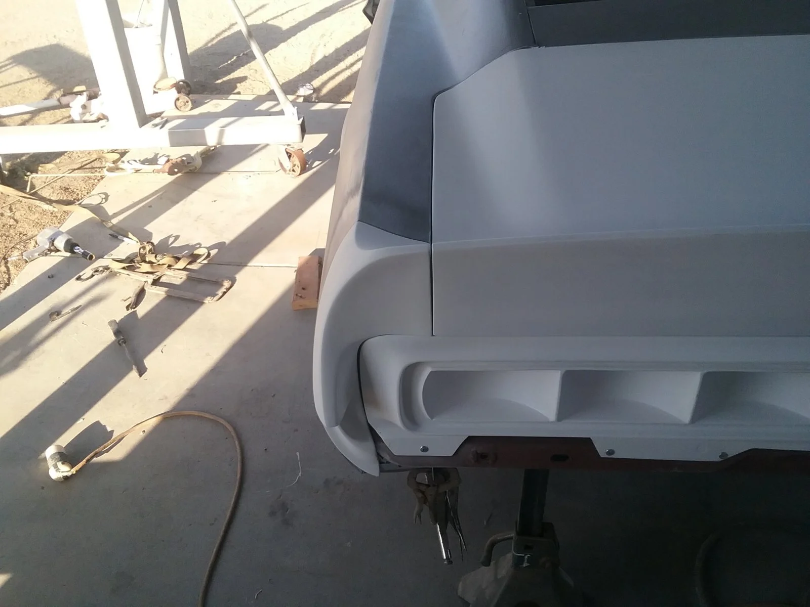

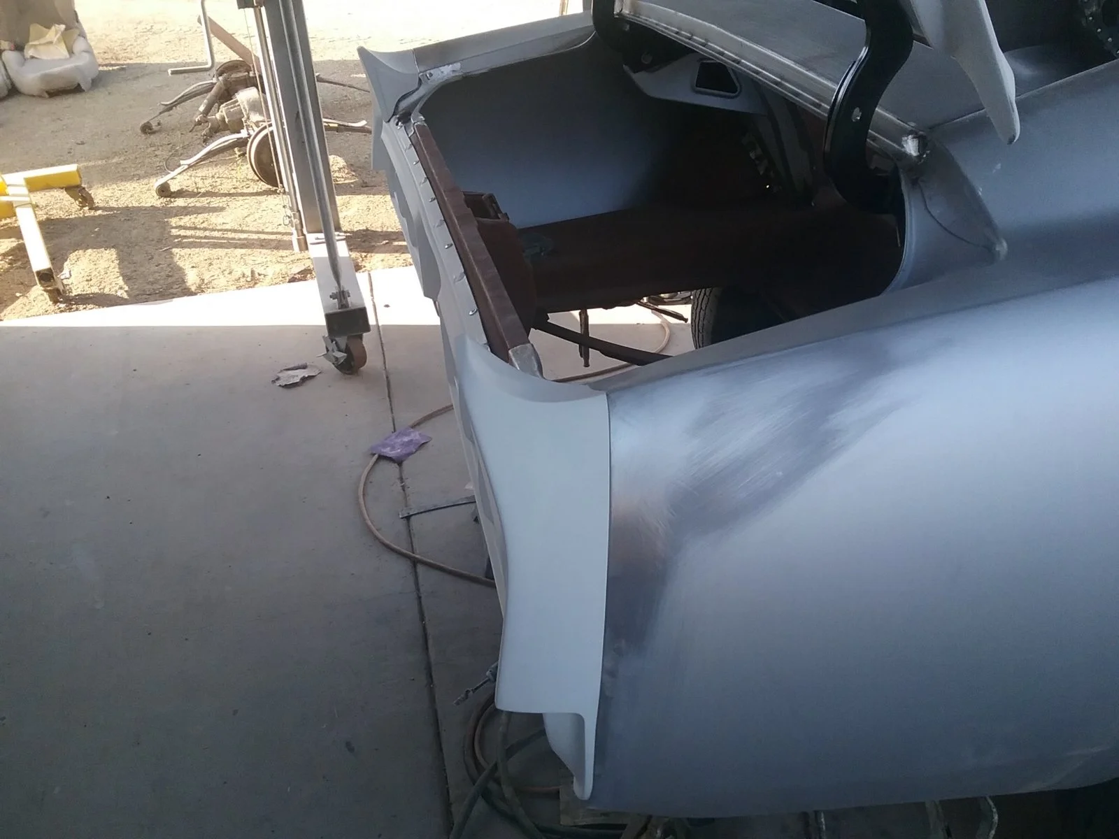

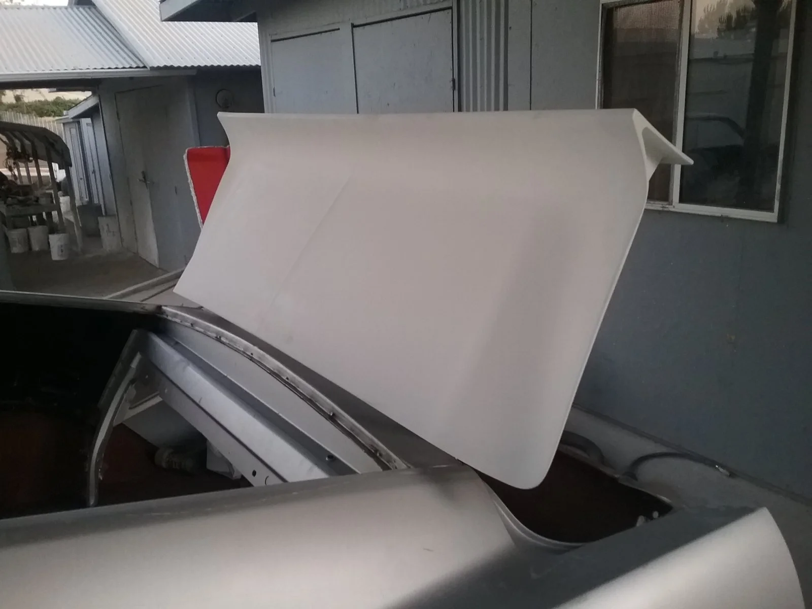

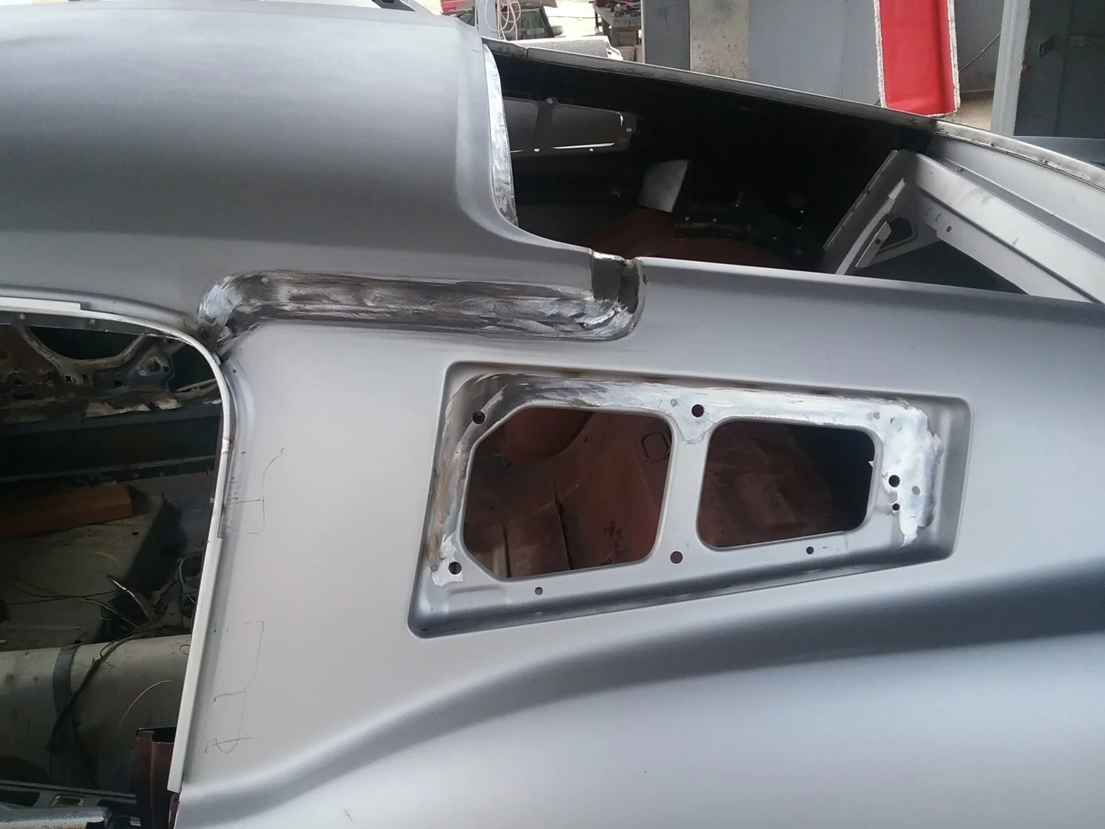

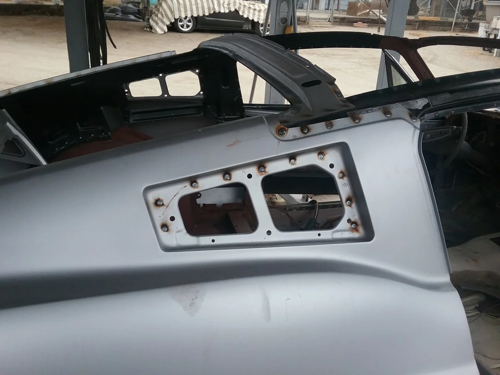

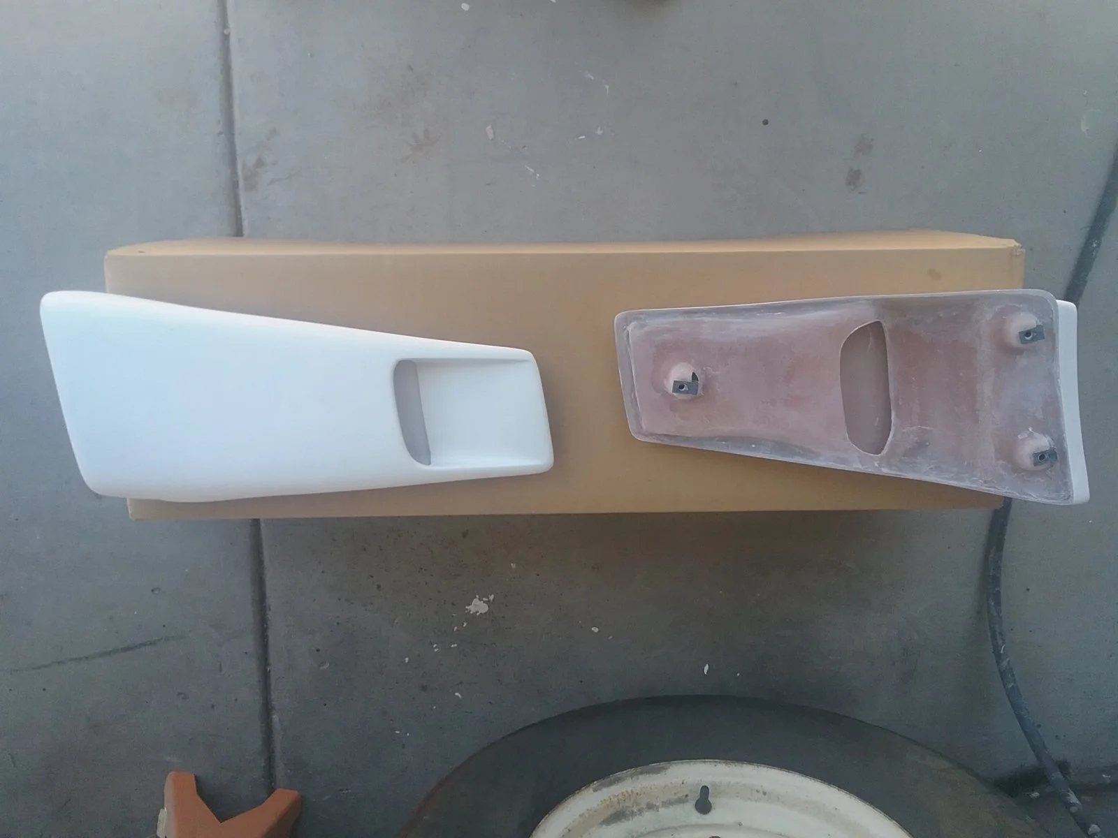

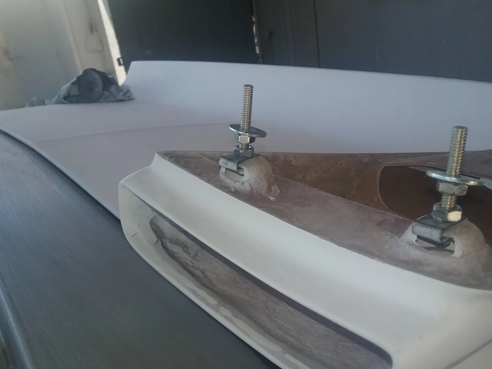

Time for the upper scoops . The mounting studs are in place ,i ad a nut and a washer ,these will be inbetween the body and the scoop ,once i snug down the mounting nuts i tighten the inside nut and washer ,these things are solid
i did need to slot the holes slightly in the body with a round file ,Shelby just drilled these holes out bigger
with the scoops in place i tighten the mounting nuts good and snug ,then i reach inside and tighten the inner nut ,you could pull the car from the scoops they are so solid
