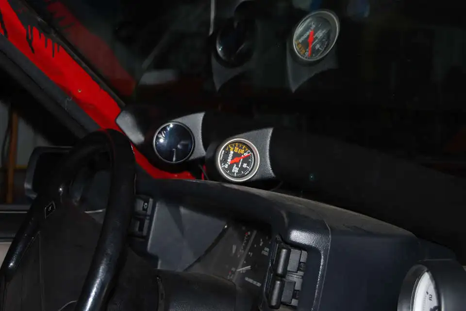

Finished wiring up my wideband, so the pillar mount is ready to be installed.

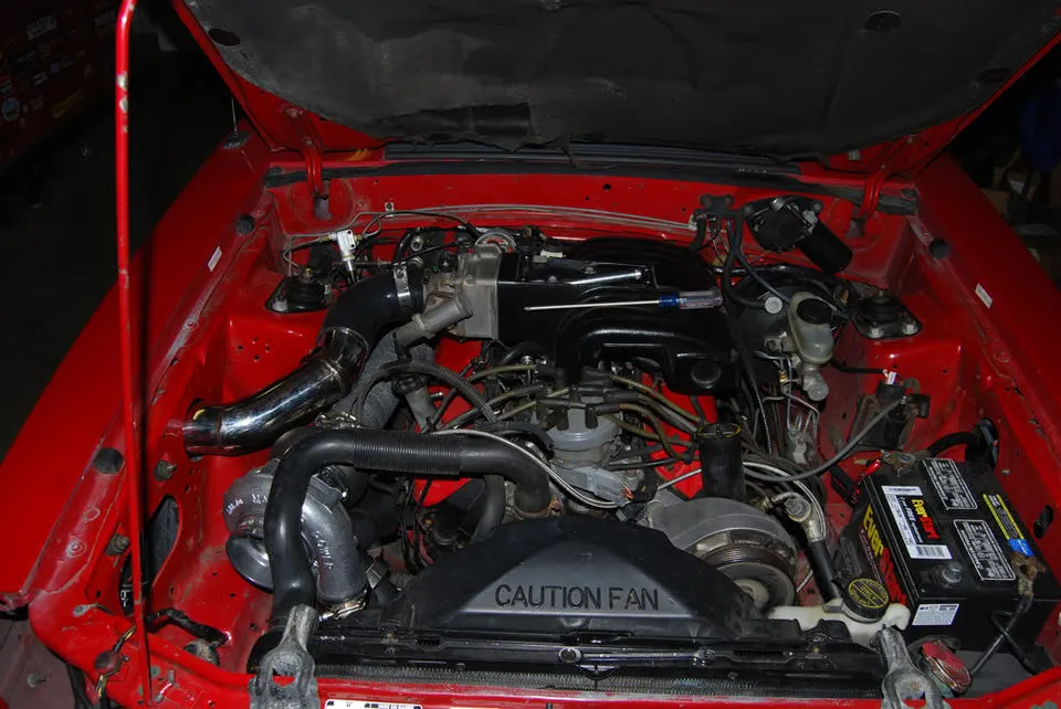

Then I put my y-pipe together, I was surprised how well everything lined up.
But, there hasn't been much success getting the cold side situated. My dad and I have been fighting it all day. And it still either hits the crossover pipe, or gets in the way of the fan shroud.

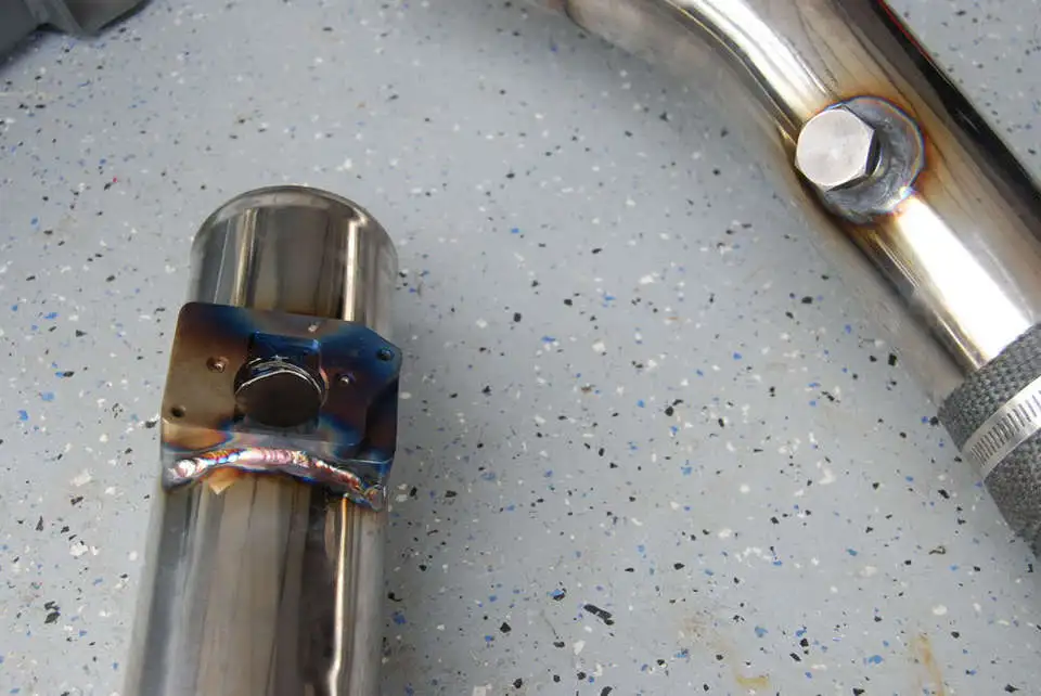

This week I'll take my MAF flange, and wideband bung, and have them tig'd at work.
Random question, but you have the air bag steering wheel, but the pre 1990 gauges that only go to 85 :scratch:
Am I off on this one? Is it because it was a "swapped" meaning it was a 4 popper?

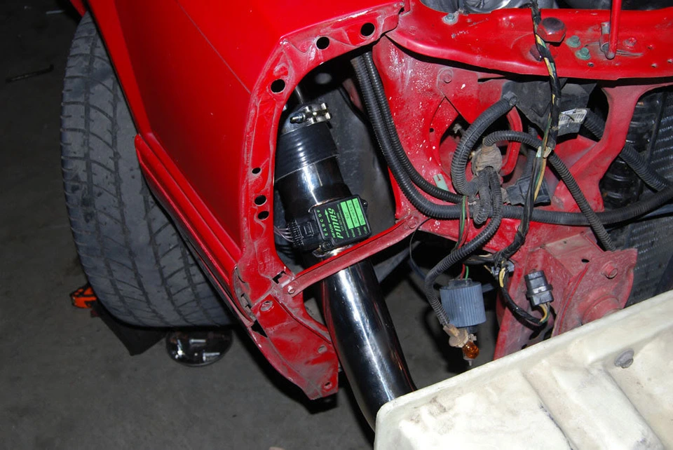

Does anyone know if the blow through style PMAS meters need to be mounted straight up and down? And will a coupler 2in ahead towards the intake interfere with readings?
I try to keep the sensor in the path of the air, towards the top side of the tube/path, the connector shouldnt bother it one bit....
Your meter is in the passenger inner fender right?
Yeah, I'm too cheap to spend $80 on a 140mph V8 cluster. So the tach doesn't read right, and I have a crappy speedo.
Alright. And yes, it's gonna be in the passenger fender.

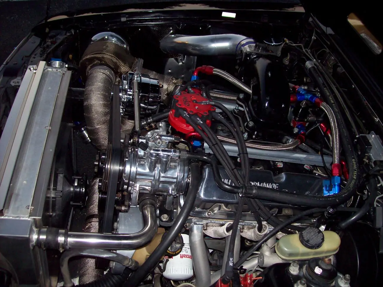

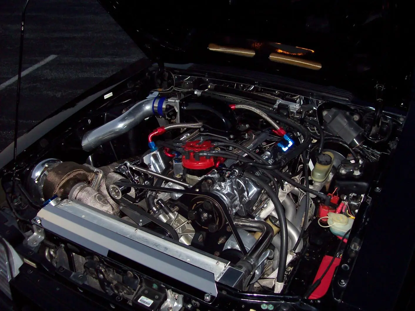

basics
Dart block 3.25" stroke, 4.125" bore
Ported AFR225's
Canfield Spyder-large port design
RNH custom soilid roller
76mm GT-42 ball bearing turbo
TKO-900
60lb inj
Pro-M protube meter
fully built rear and suspension
fully funtional a/c and heat, true daily driven street car
670HP/600TQ @ 9psi :D stopped pulls at 7000rpm and it was still making more power
I'd like to put 18psi to it and make 800-900RWHP which I think I can do easily, if I don't run out of fuel.

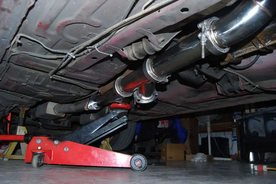

Not trying to hijack but Rick how did you route your downpipe? And what size is it? Where did you squeeze that thing?

Finally got my stuff welded up today at work. And no, I didn't do it. I left that to someone who's actually done it before. :p
Hopefully this was the last purchase to make the car start up.
Air meter installed.

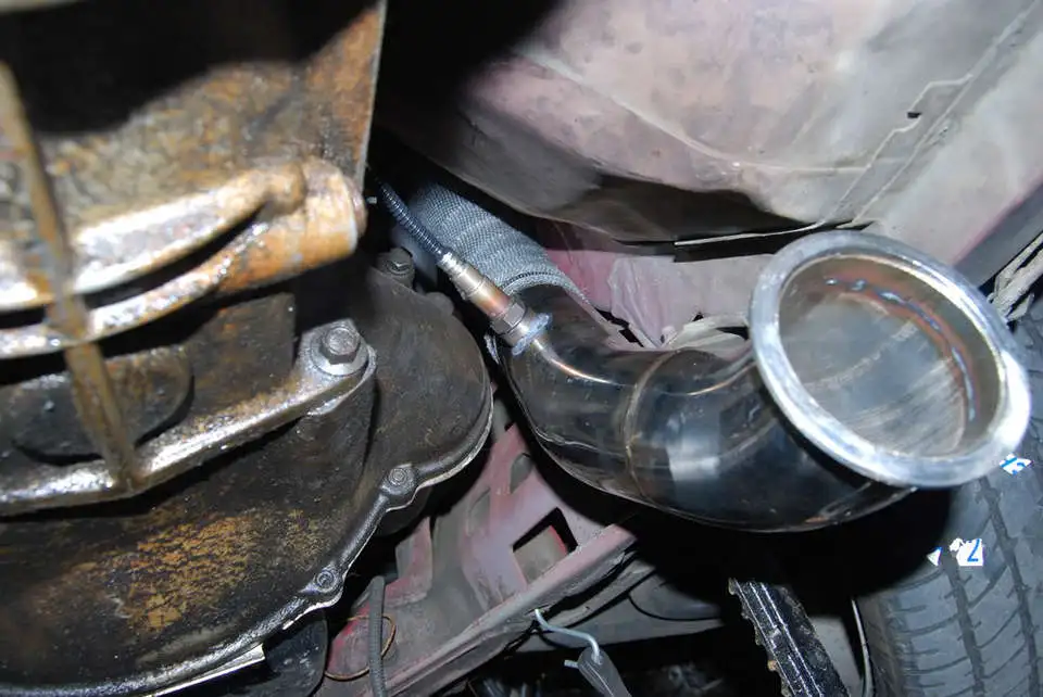

Wideband installed. Innovate needs to get their directions straightened out, because what the paper I got with the unit. And what their website said were not the same.
And the shorter fl-910 filter does fit, but not by much. About an 1/8" of clearance. And I dunno if I like the idea of running a smaller oil filter. Plan to do a relocation in the near future.
