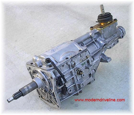

The pair of wires coming off of the late model T5s that PoopDawg mentioned above, is what you're looking for. IIRC, the connector on the front is the one that you need. It's been a while since I looked into it but at one time, I had an article on how to wire this thing up. I'd post a diagram for you but I just don't remeber if the internal switch was normall open or normally closed. I "think" it was normally open. The plug is basically useless on our cars and serves no purpose other than to allow the KOER test. On my car, I have this plug jumpered so that the KOER test will ALWAYS run when I go to test it. It has no other effect on the car. Because of this, it's perfect for what you're trying to do.
Here's a pic of the tranny and pigtail harness. Again... I haven't looked at it a while and cannot say with absoulte certaintly whether the harness you see here is the one you need or if it a pigtail from the other plug that you see on the tranny.
Hopefully someone will come along and clear that up for you. If not, let me know. I'll just look underneath my car and come back and let you know.

Yep, it's the harness on the top front of the tranny there.

cool, how do I know if it works??

Put the car in gear. Test for resistance between the two leads on harness. Then put it in neutral. Test resistance. Then connect the ground wire through this harness for the remote start so there is no power when in gear.
