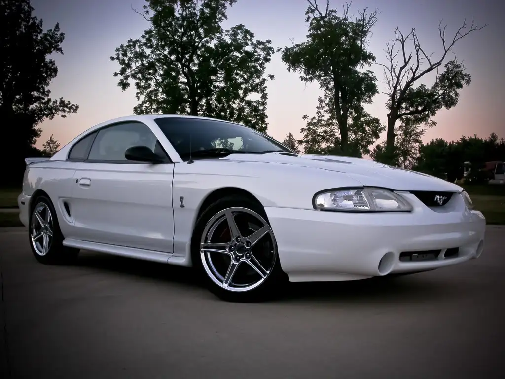

I had a '95 GT, and actually like the body style / engine combo. I would throw a vortech on it with supporting mods, 13" Cobra front brake kit, Cobra front bumper, some lowering springs and shocks, 18X9 wheels up front / 18X10.5 wheels out back, sub frame connectors, and done. Some go, some stop, some stiffening, and some style. Your trans and clutch should last you a bit depending on how you drive, and if you like dumping the clutch or not. If you can handle more cruising type driving, with rolling into the power in higher gears, then your T-5 will be fine if there are no unforeseen problems with it. When you get more cash back in the bank, then get a trans and new clutch.
From a quick Google search, here is an example with pretty inexpensive 18" Saleen replica wheels, a Cobra front bumper, and lowered. Doesnt take a bunch of money to make them look clean, and with a Vortech and some decent brakes and an Eibach lowering kit (dont skimp on struts/shocks), you will have a nice little car. This one is not a vert, but whatever.
Of course, this is just my opinion. Wheels are always subjective, but I was trying to give you as close to the total package within $10K of modding.
