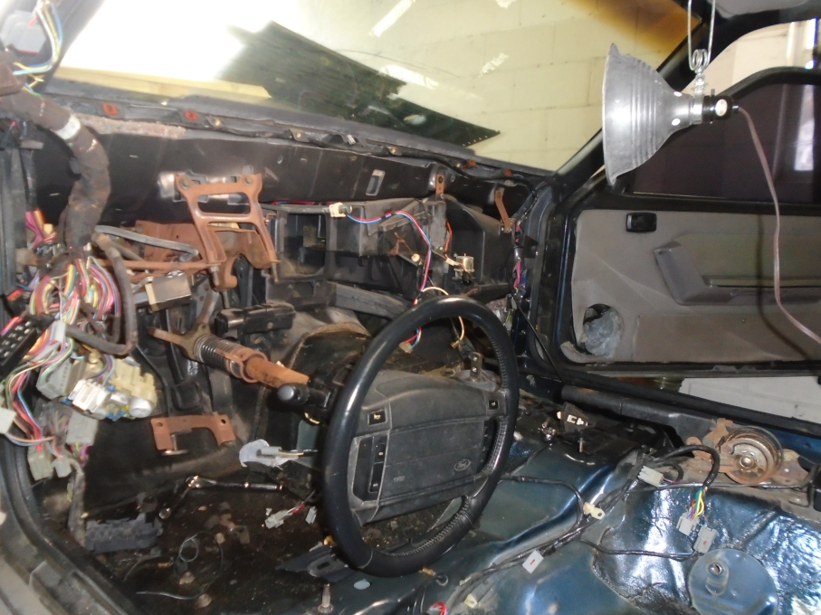

I started the process of removing everything so that I can get a good look at my interior firewalls. Not too bad for a couple of hours in the garage. I've never had to pull a dashboard before and I have a special disdain for whoever designed those plastic clips for the wiring harness connectors .
Still have to remove the pedals, steering column, and A/C system but that can wait till next weekend.

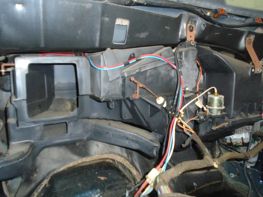

When I was taking the A/C controls off, I was wondering why the temperature control knob wouldn't turn, I think I found the culprit. That sucker is rusted up pretty tight.

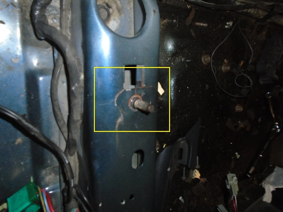

And I get to add one more thing to my future welding projects. I found that area around the driver side stud is cracked. What's the best way to repair this?
Chase the cracks to the ends, drill them with a 3/32” drill bit (keeps the crack from going any further), prep the cracks for welding (buff the paint off), weld them up, hit the welds with a wire brush, paint them up.
Cool, thanks for the tip. I'm hoping to be able to pick up a welder sometime around the end of this month. It will be nice to be able to start taking care of things like this.Chase the cracks to the ends, drill them with a 3/32” drill bit (keeps the crack from going any further), prep the cracks for welding (buff the paint off), weld them up, hit the welds with a wire brush, paint them up.
Pick up some scrap metal of various thickness and practice, the thin stuff, hoods, door skins are the thinnest, the door jambs like where that striker, is a tad thicker, grab a door from a 80-90 car cut some holes and practice welding them back in.

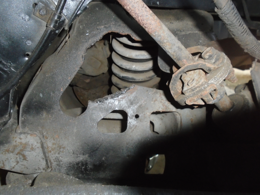

I'm still plugging away at the disassembly of this project. I'm getting ready to drop the exhaust and transmission after I go pick up a transmission jack and clear out a space to store it in the garage. The transmission will probably go through a rebuild on the bench and the exhaust is going to be completely replaced at some point. The old h-pipe and mufflers are looking really rough so I'm going to do a new system from the headers back once I get the engine back in (still a long way off from that). As I was crawling around underneath I noticed something odd with my k-member:
I'm not sure why someone would have cut it there but this gives me a reason to start looking at tubular k-members. Its not something I had originally planned on doing but at this rate, I'm looking and trying to knock out as much as I can before I start bodywork and paint.
My bet with the fat mans cracked floor pan. and tourched K member would be those cheapo summit /jegs headers that fit like azz in that area, if it was the frame rail on the other side I would say on old icon or tti turbo kit.. I would check the rest of the floor pan for cracks, if the studs started to pull, the rear of the seat brackets tend to crack the pan also where they bolted up if it didn't have frame ties with a seat brace. Couple .of cars I owned came to me like that
... If its needs or is getting a floor pan patch, best bet is to remove the front seat cross member and brace it from the under side where the stud is pulling threw, its pretty damn flimsy design stock once you get a good look at it.. Plate the undeside and drill it for the stud anchors to sandwich the plating. so they can't pull threw like it does on the factory sheetmetal design, esp if your a bigger guy.. I actually sheared the power track cam arms that raise and lower the seat in one car at the track that I repaired that on, they where fully pulled threw when I got it. It held up fine to my big ass shifting around on a lose seat after I braced them like that. Idk why ford made the power tracks arms out of extruded aluminum but they did, nice for a driver, not a car that 60fts though.
They crack badly with out those T braces if it was beat on, between the studs pulling out, the manual tracks cracking at the rear, just as the bend starts, all that flexing murders the pans, even with them you see a lot of stress cracks if they raced it a lot without a cage or decent sub frames.
Part of the reason they did that bandaid known as the ssp reinforcement, that every car since 83 has on the drivers side rear bolt holes, complaints about them ripping up the pans... They didnt do the passenger side though and you need to transfer that brace if you ever do patch pans, its not on those.. Tin can cars. Seen too many like this over the years and worse on rust free spotless pans , the rear cracks do show up more on the passenger side pan, guess from twisting/ torque and lack of that extra brace spot welded that's the drivers side has.

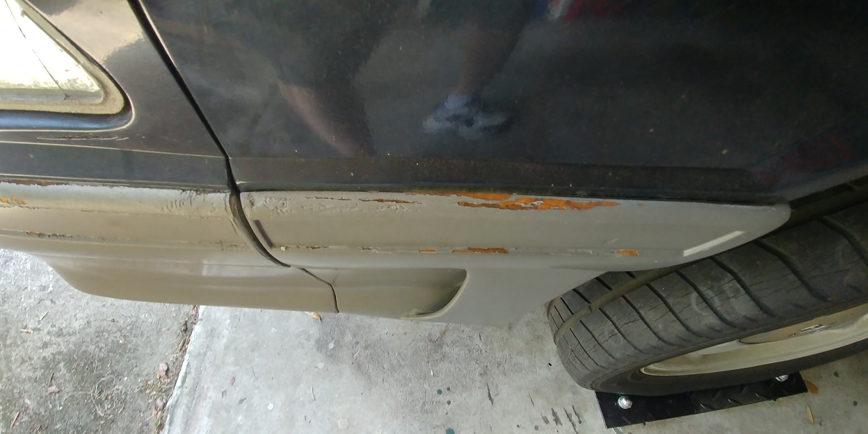

The skirts are wavy and/or have chucks missing out of them. Front and rear bumper covers have some heavy gouging in them and I'm not sure if that is easily repairable. I'm planning on spending some quality time in the garage next weekend and will be going back over the car and updating my to-do list. The project was put on hold while life was in the way but I think I'm ready to start getting some stuff done with this one.What skirts are you missing? Or are they just wavy?
Thanks for the tip. I'll have to try that out; I figure I can't mess them up any worse.That damage should be very fixable with a little flexible filler/putty.
oh yeah you can!!I can't mess them up any worse.
but you won't.
I called that car the Stunt Double' for a reason, my covers are the same way. Easy fix.
