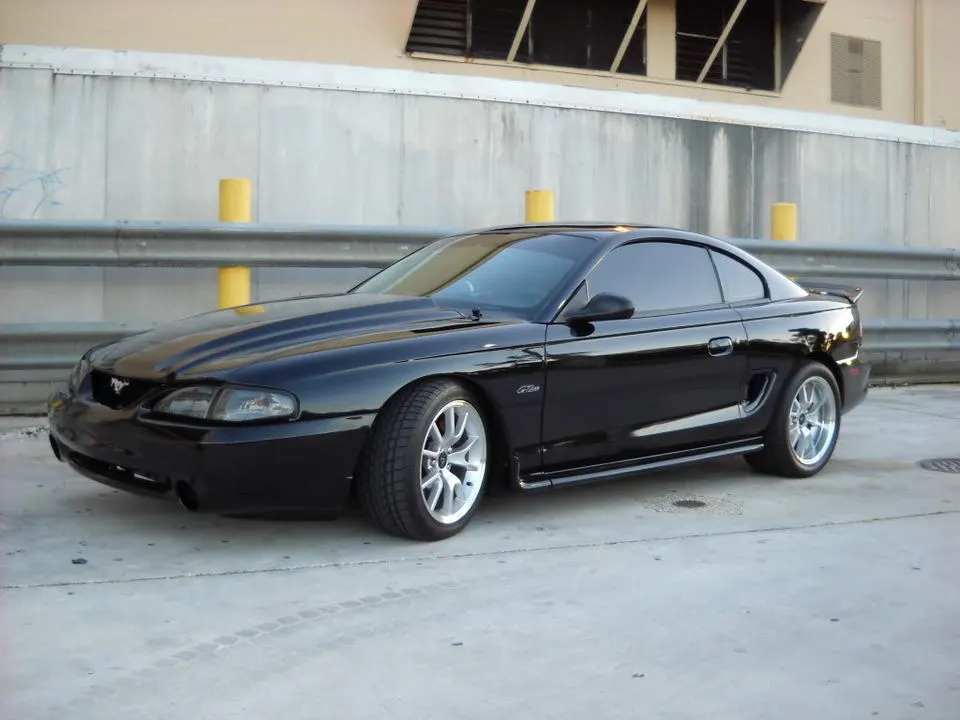

Remember this thing is a mustang. The weight balance is not good. Its nose heavy. I would hate having 245s up front. My 2c.:shrug:
I agree with that. I have 9" up front and BFGoodrich 275/40/17s, and love it. They fit great, and I'm basically slammed. With the proper equipment in the front end (AKA offset rack bushings, relocated swaybar, etc) it will feel BETTER than stock.
Man your stang looks good! I hope I can have my suspension worked out like that some day. Do you have wheel spacers in the rear?
