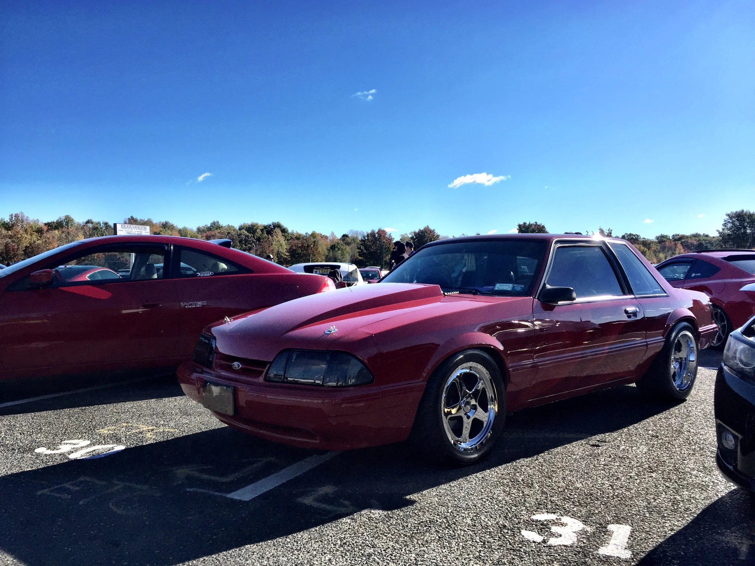

I'm pretty low . I can count on 1 hand how many times the header has actually scraped.
1 3/4 bbk Long tubes

If you look under your car, how many inches will you say you have from the ground to the bottom of the header at it's lowest point from where it starts to turn up?

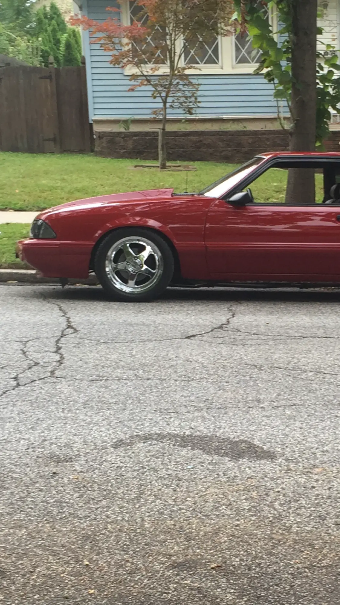

I have no idea. This pic is the best I can do at the moment to answer that.
Looks like you have at least about 4-8 inches from ground to the bottom of header. 4 is better than my boy's 2 but still would be pushing scraping everything probably.
8 on the other hand would probably be real real decent
