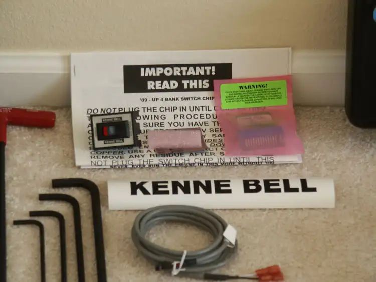

I bought the kit from KB with the 90mm MAF. So they tuned it for that and my 75mm TB and their air box.
I'll be doing the install. Do I need to take it for a tune? Or just the Dyno?
I'm assuming this is the chip I got from KB (with a switch for street or track).
Again, I don't mean to highjack this thread but I think it's relative.
