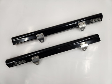

Anderson Ford Motorsports Fuel Rail Kit - Has 8AN inlet and outlet. I have a #8 feed going to a Y-block that feeds the front of each fuel rail. At the back of the rails they tie into another Y-block and then connect to the fuel regulator.
Anderson Fuel Rails 86-95 Mustang 5.0/5.8L Black
Anderson Ford Motorsport is the ultimate source of high-quality Ford Mustang performance and racing parts. We provide parts for classic and modern engines.
www.andersonfordmotorsport.com

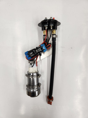

I run a stock tank with an aftermarket hanger (similar to the Pro-M) with a Walbro 465lph fuel pump with 8AN PTFE feed lines thru a separate stainless steel filter (for E85). I run the stock OEM fuel feed line as my return and connected it up properly from my regulator and into the fuel tank.
I also have a separate Aeromotive 13101 fuel pressure regulator. Ensure you upgrade your relay to feed your fuel pump. I put a new kit on mine.

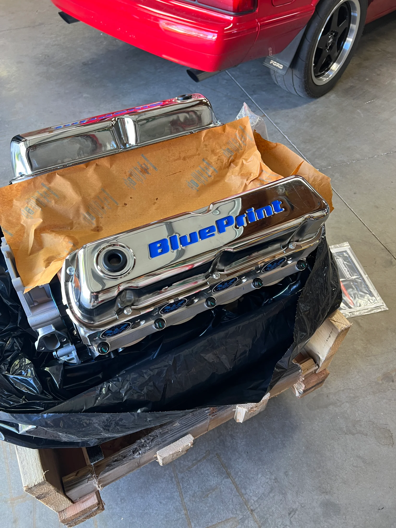

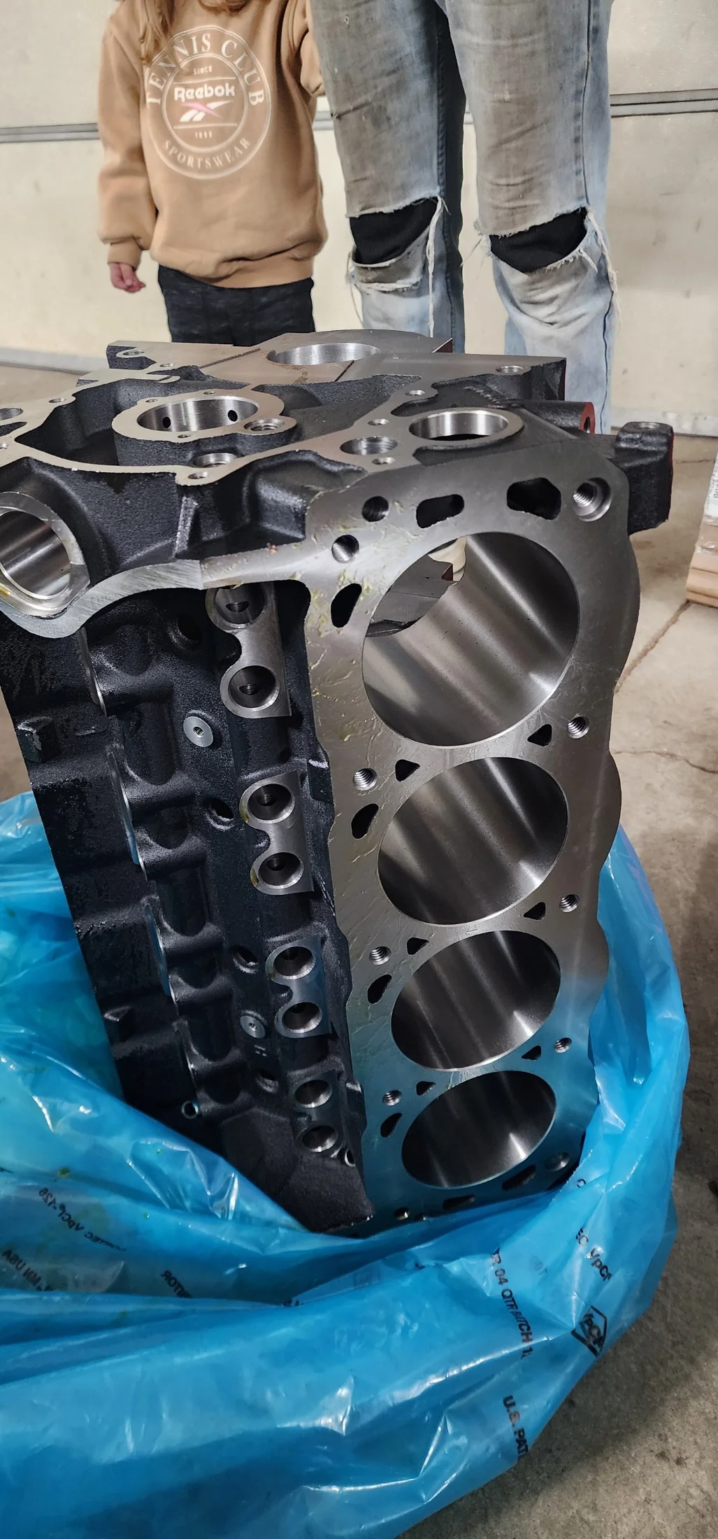

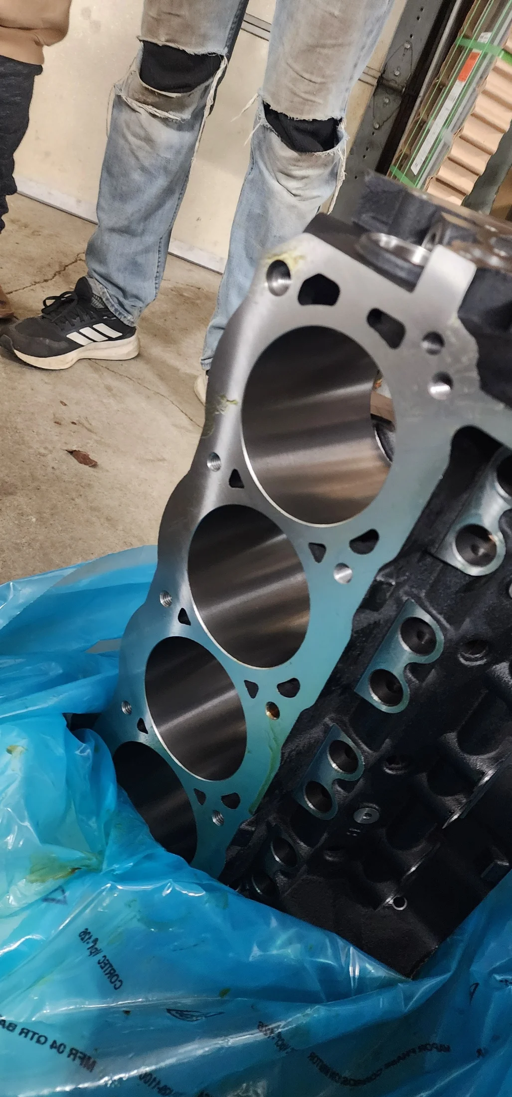

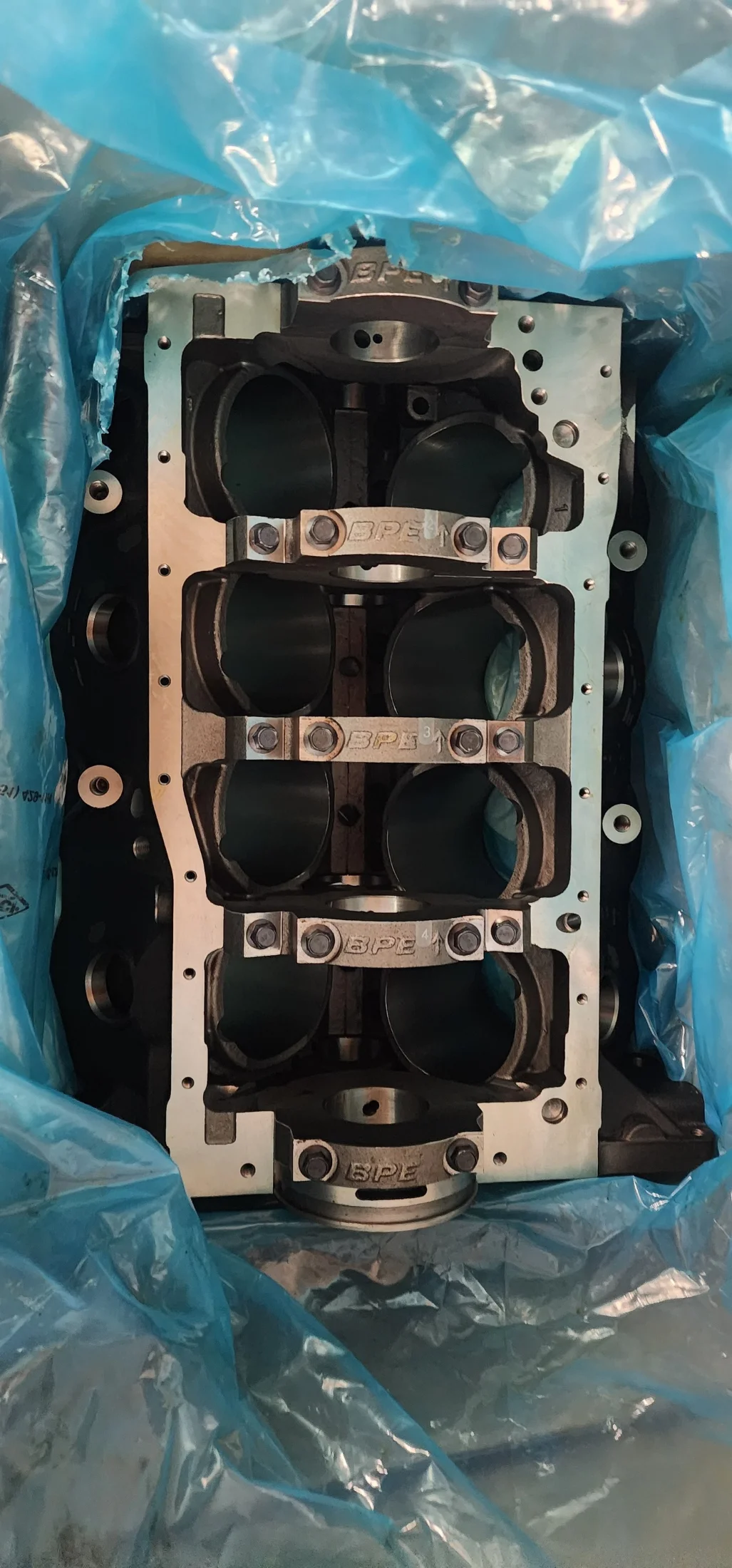

Got a delivery today. Still gathering parts for it so it will be a few months before it actually goes in the car. Dyno sheet says 432hp and 432ftlbs torque, 17 more than they advertise. I'll take it. Should be a fun project.

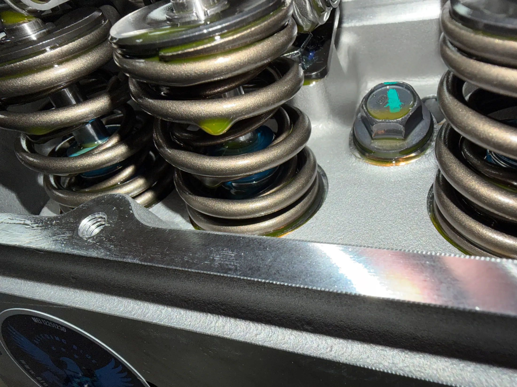

Hey buddy. Did you ever install and boost the blueprint engine ? I am thinking of doing the same but seems that no one has been brave enough to add a little boost lol. What are your thoughts on the quality of the long block ?

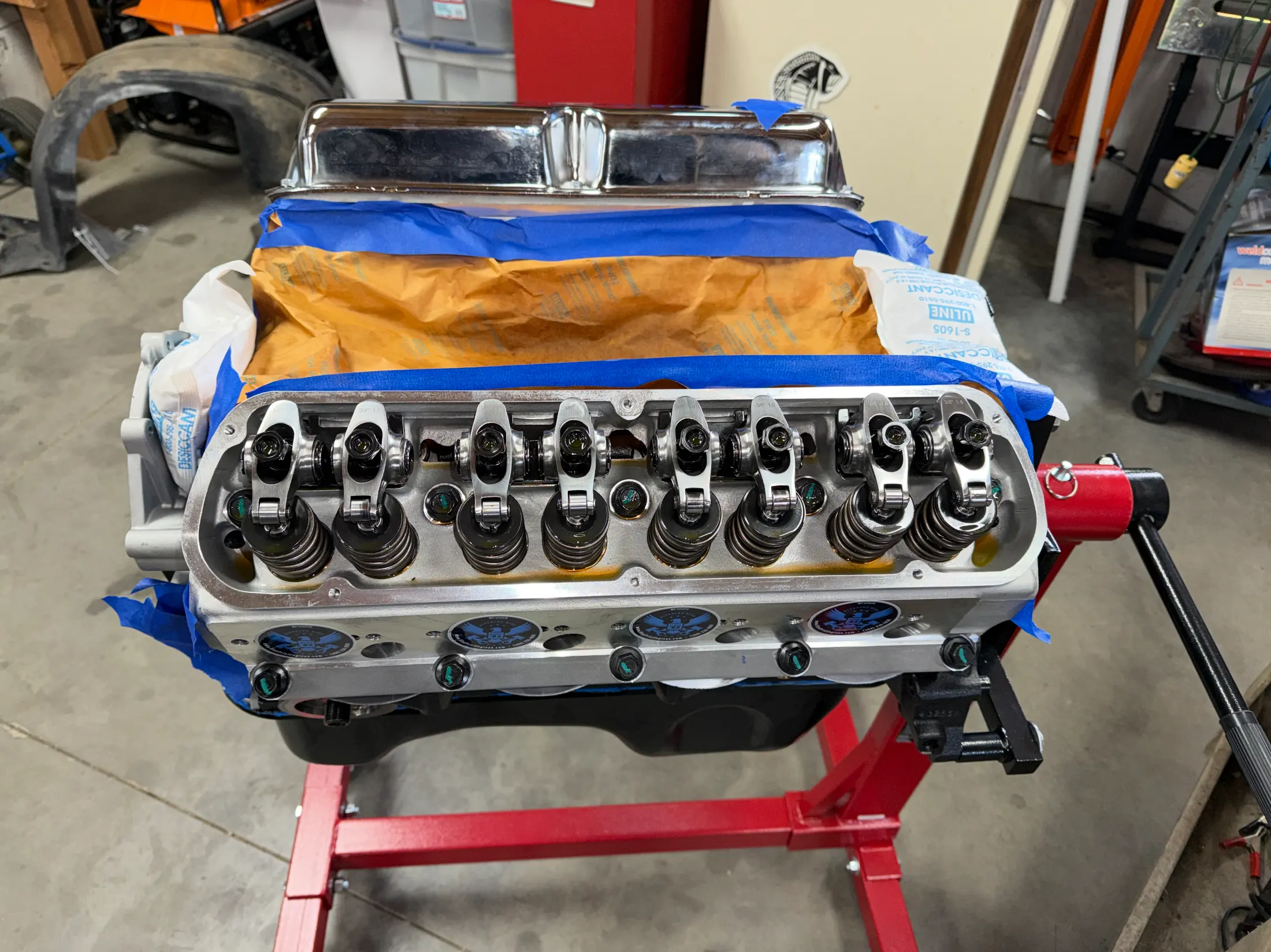

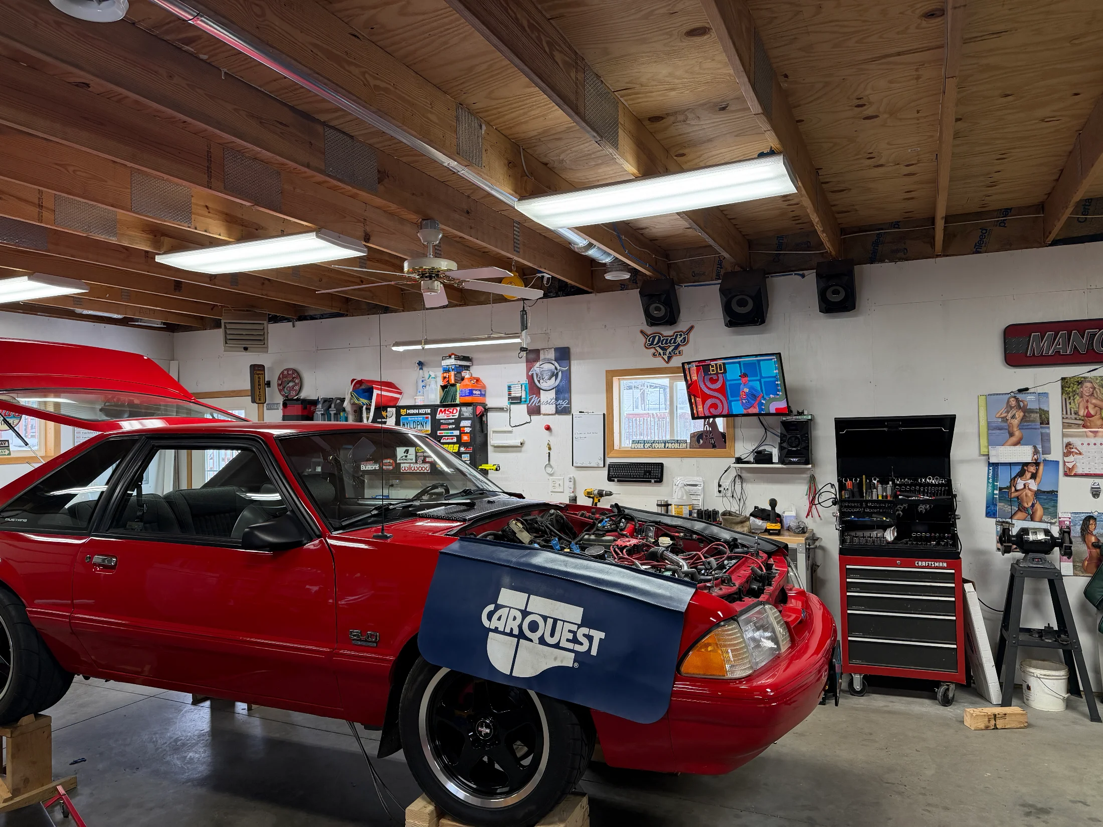

It's not installed yet. But it's in progress. Working on the fuel system and started to pull things apart, but it will probably be March or April before it's ready to fire. Going to be replacing the cheap valve covers, but other than that it looks good. Just ordered a bunch of parts with Black Friday sales going on, and it's snowing here, so time to get serious.
Post some pics of the valve train when you swap the valve covers if you can. I contacted blue print asking what parts they are using, but they were very vague, they only said that they were comp cam roller rockers but no part #’s or anything. Wondering if they are steel or billet rollers. They said also stated that they use mahle brand forged pistons and ring set.

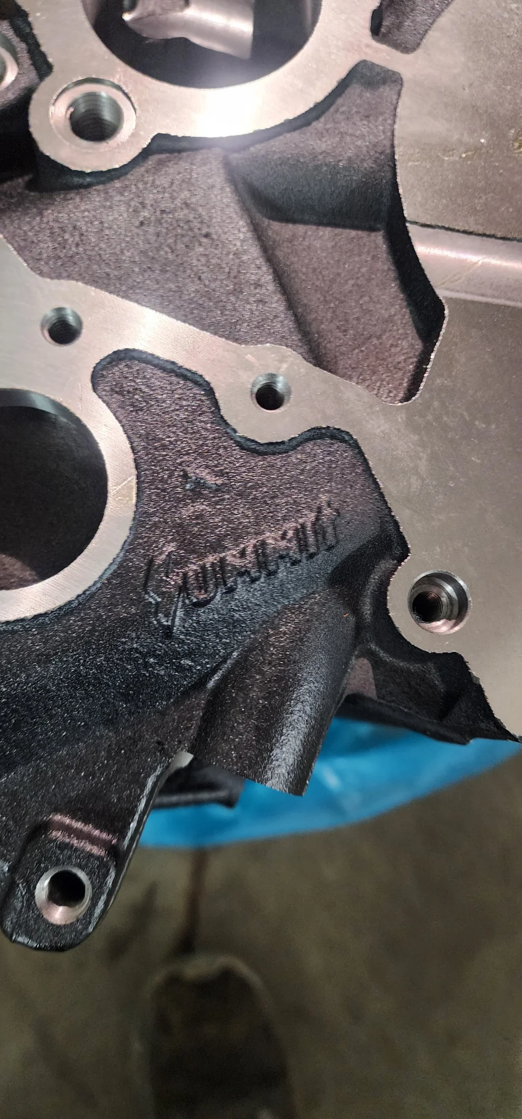

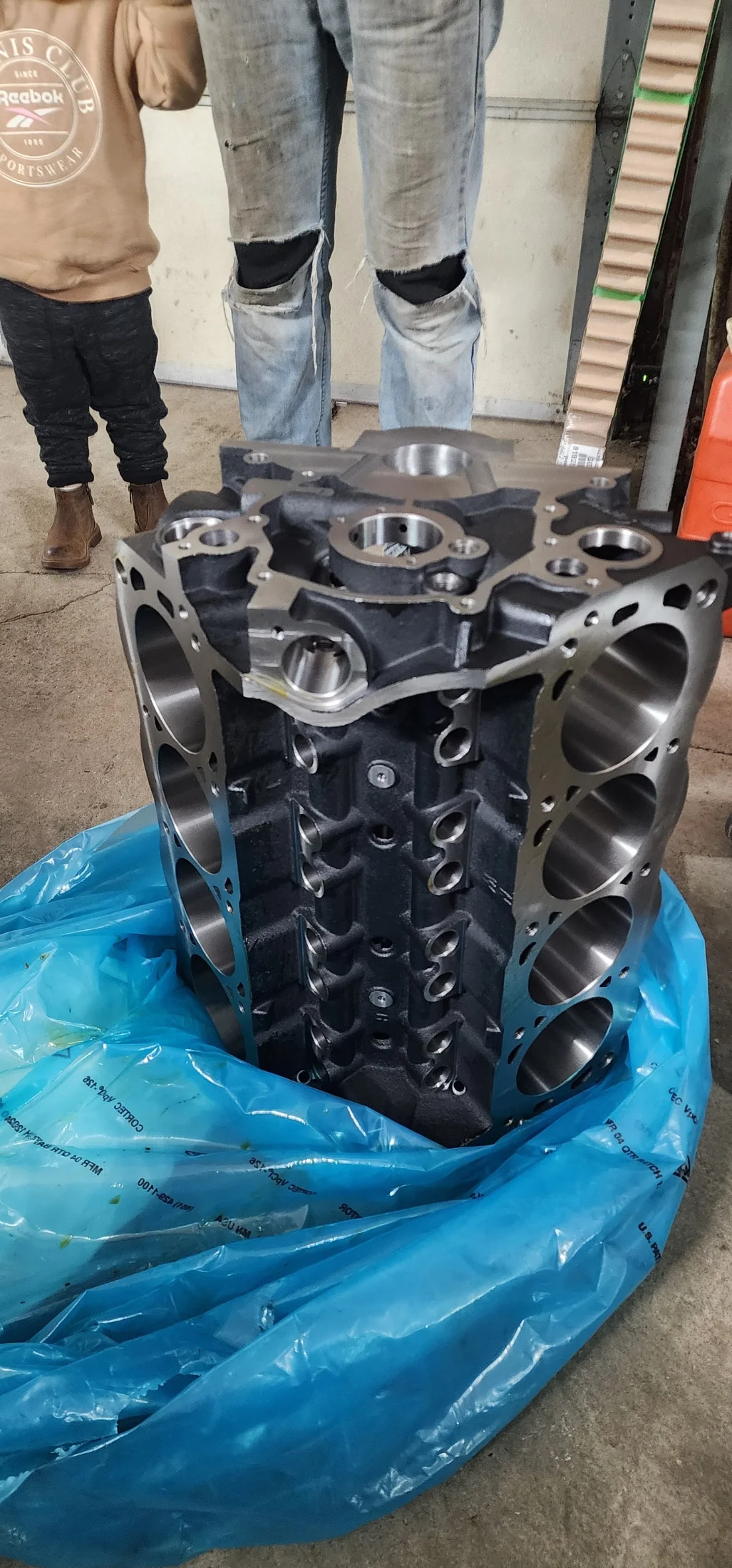

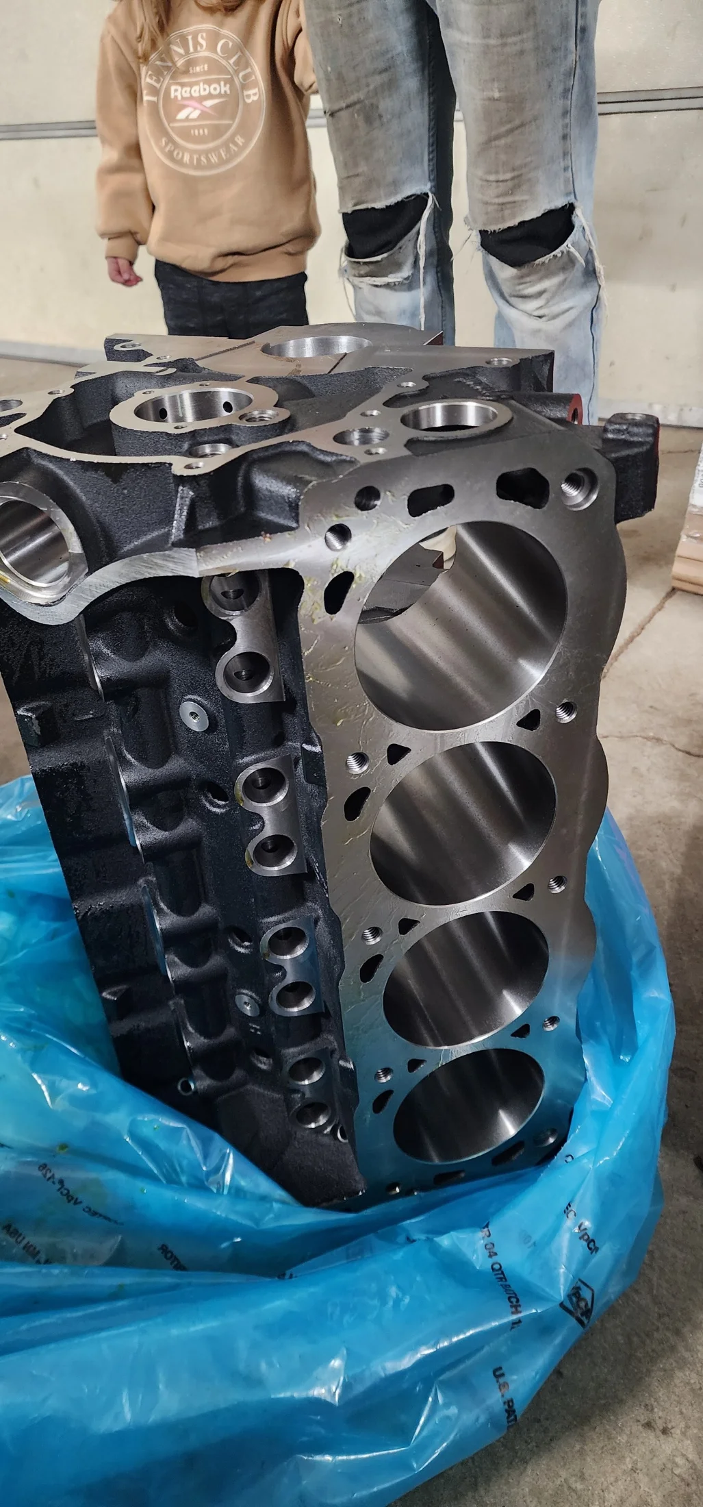

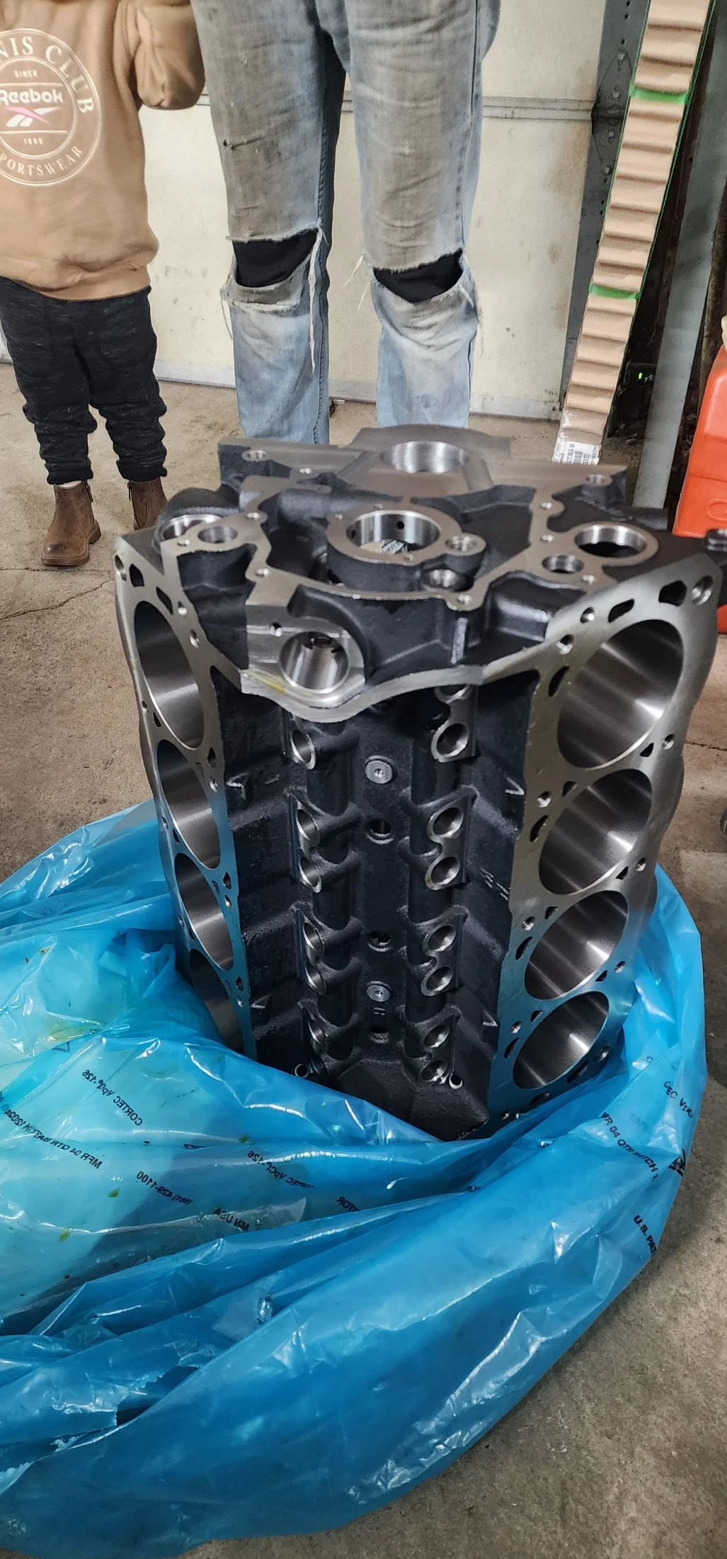

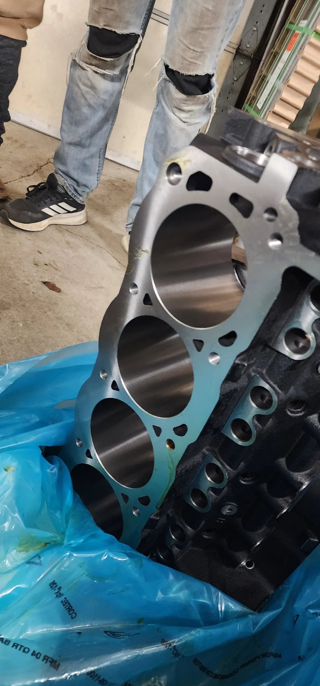

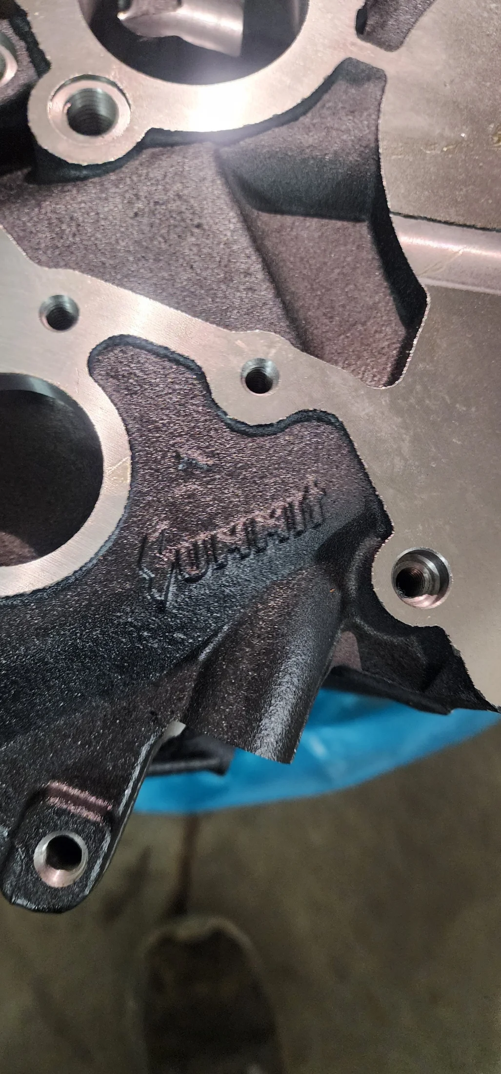

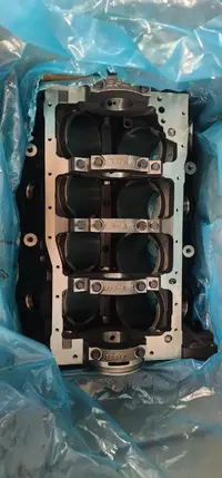

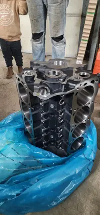

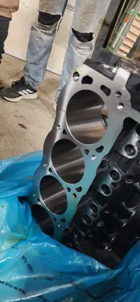

Just saw this post by a guy that bought one of the new Summit blocks on 8.2 Deck Mafia on facebook. Everyone's been wondering if the Summit 8.2 blocks are the same as the new BluePrint blocks. With the BPE logo on the main caps, I would say yes they are the same.

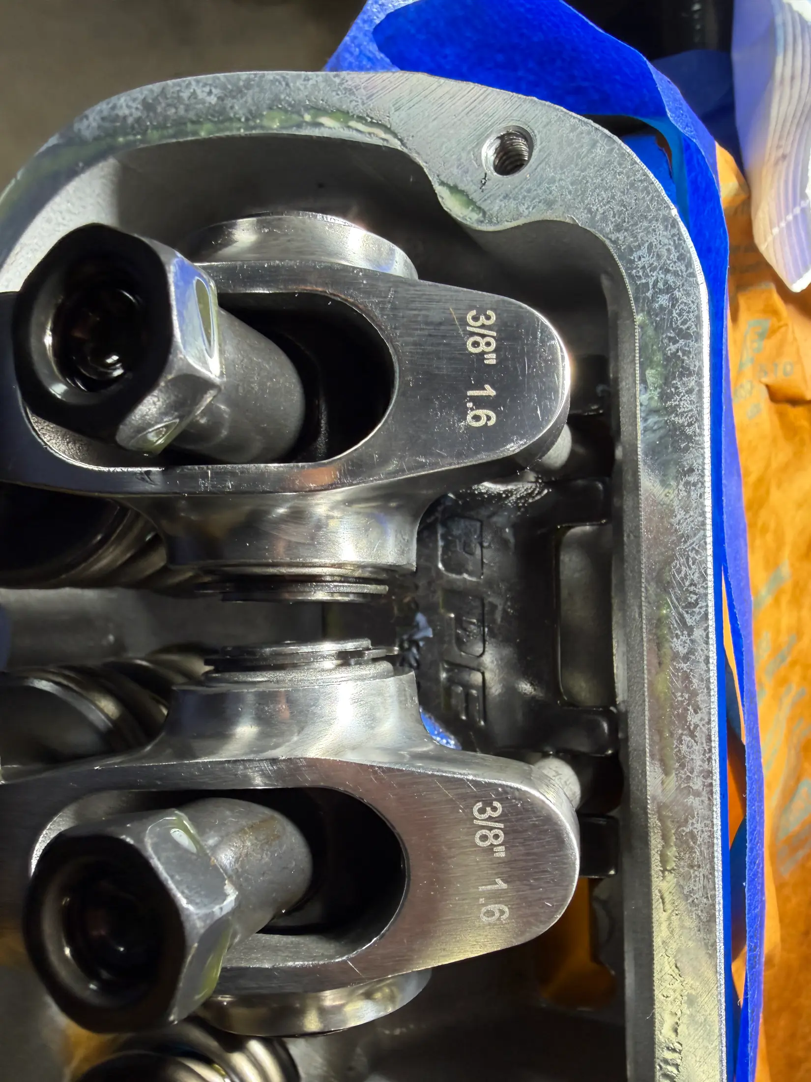

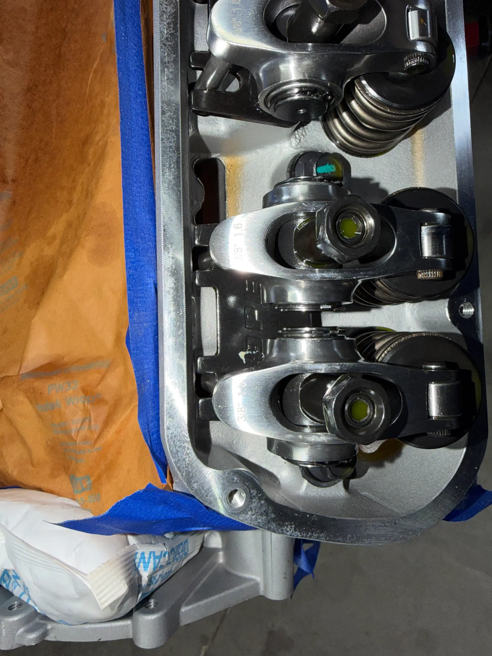

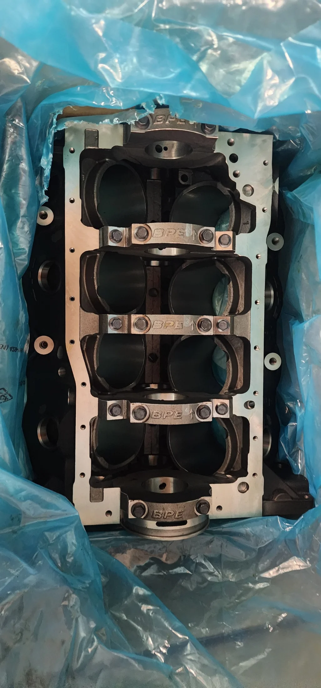

I was curious about the rockers too, so I pulled the valve covers. They look like billet to me. Couldn’t find any markings other than the 3/8” and 1.6 stamped on them. Everything looks good to me, but I’m far from being an expert engine builder.

Your gonna want to pull the timing cover also, its a non EFI one.
China rockers, stainless, many brand them just like the China sourced dart clone heads bpe brands, there the only one with those castings in the pedestal option but many sell the stud version yongyu industrial cast the heads, think Y&j make the rockers but never dug into those much. https://ynj-racing-rockerarm.com/collections/stainless-steel-rocker-arm

Nope. This ones made specifically for BluePrint and has mounting holes for either style pump. Just need to block off the mechanical fuel pump hole and change the timing pointer and my reverse rotation water pump will bolt right up. https://blueprintengines.com/collections/timing-covers
