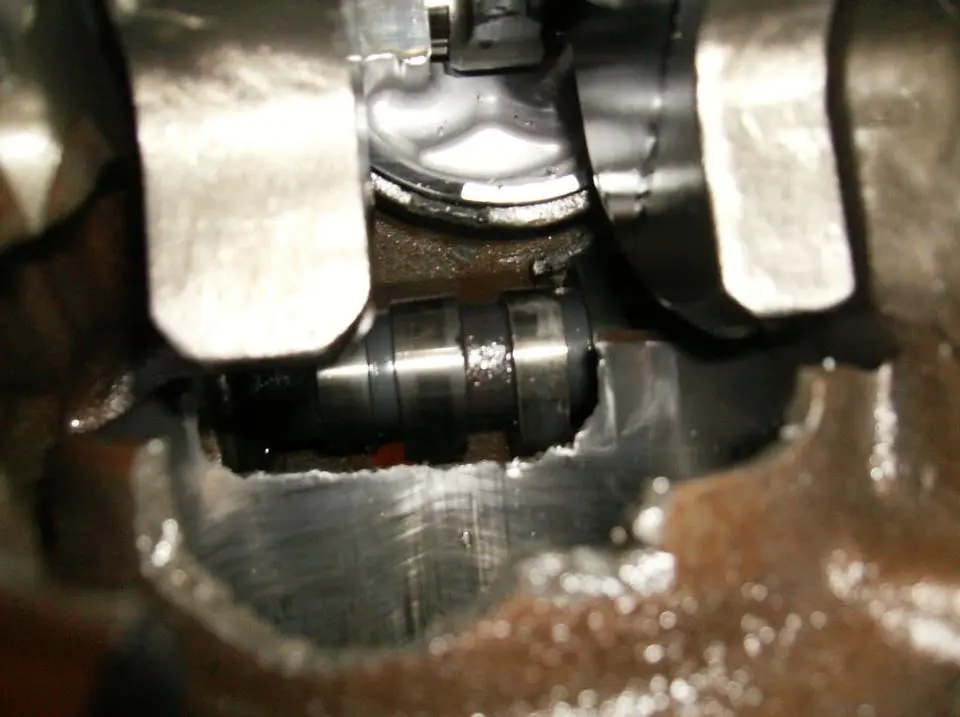

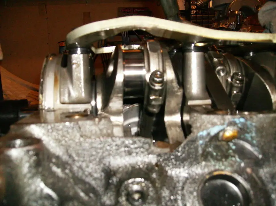

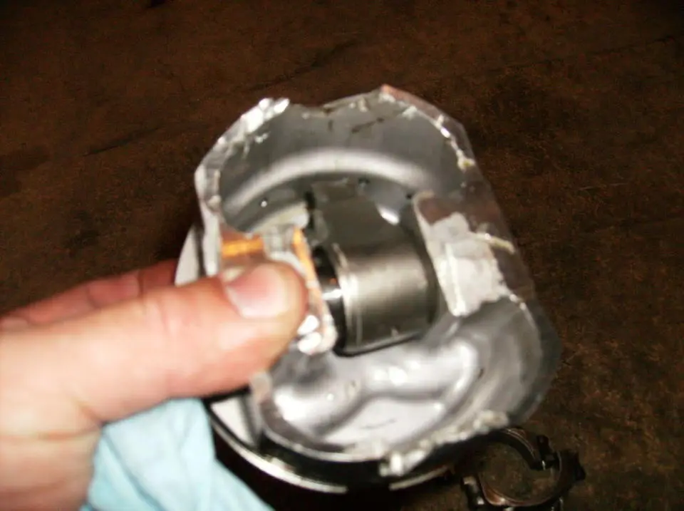

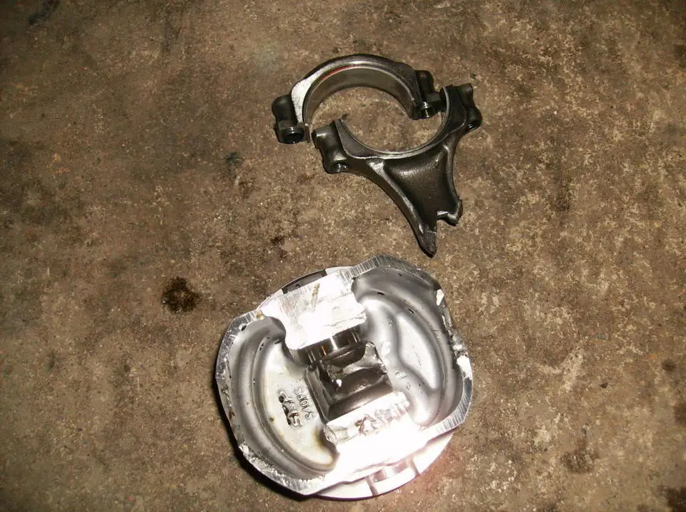

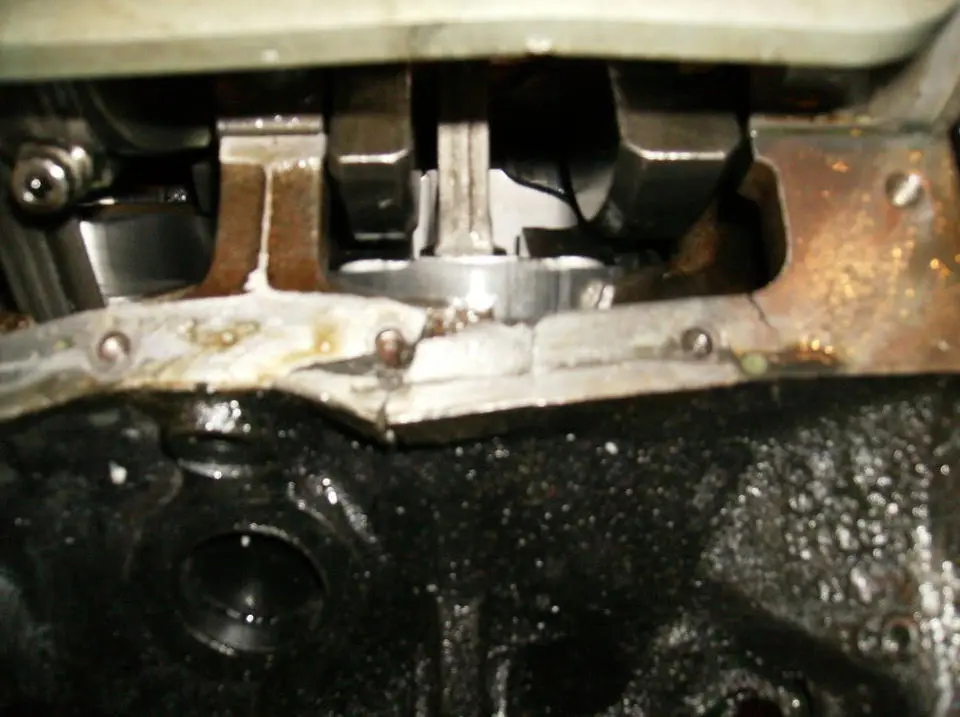

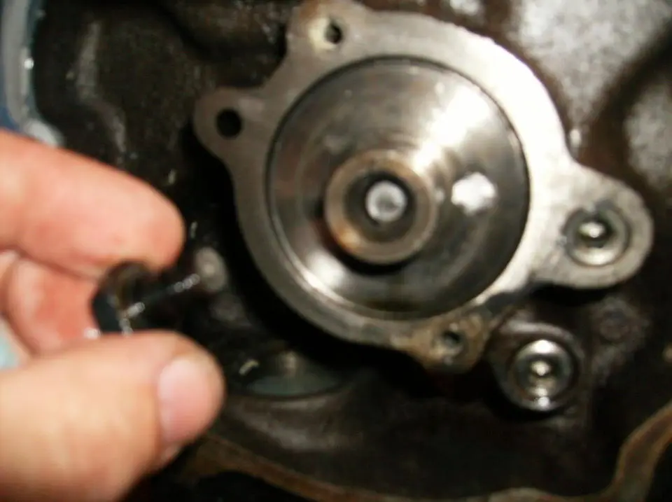

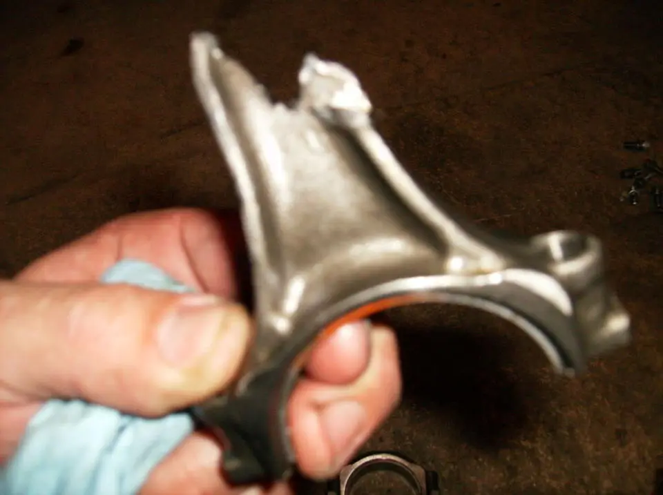

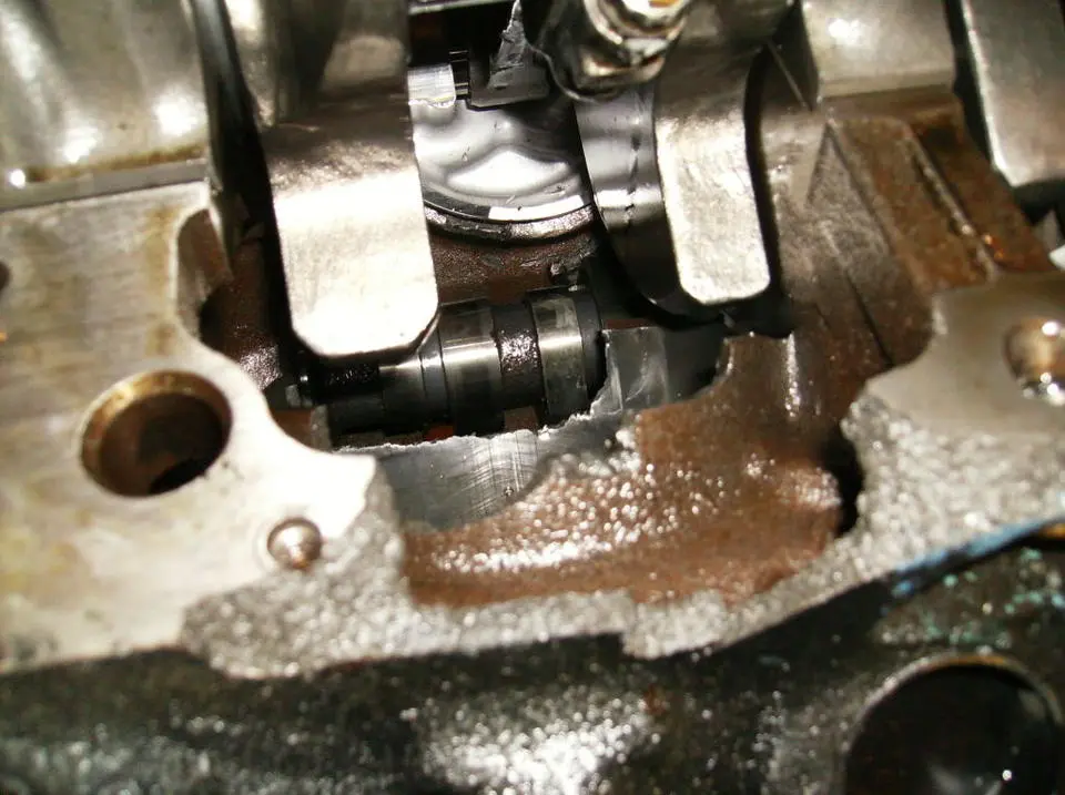

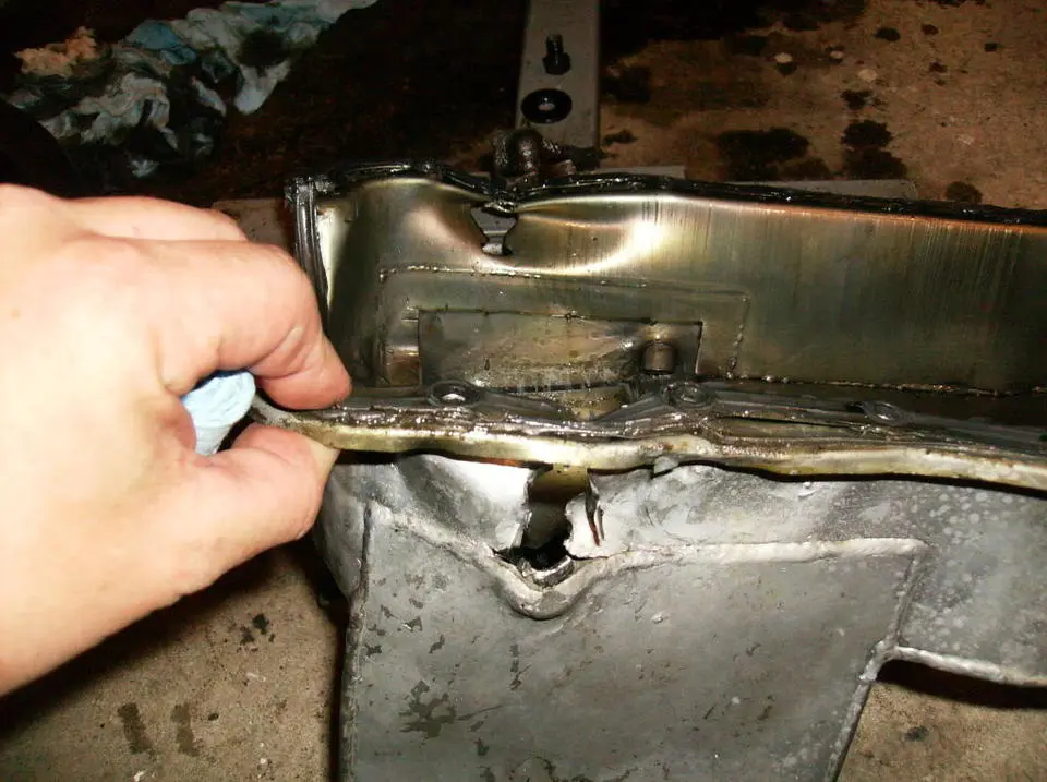

Well took it apart. #8 SRP rod broke, spun around in block punching holes in both sides of block and my canton pan, and bending the main stud girdle and slapping the piston repeatedly. Broke the cylinder skirt, lodged a piece of it , wedging the cam, locked it up, causing my ARP cam bolt and dowel to shear off in cam, and intake valves slapping the pistons.
Completely totalled
