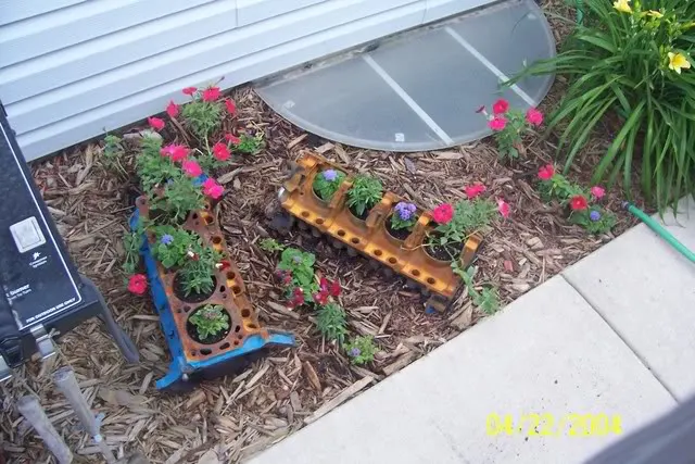

split mine in half at 480 to the wheels on a dyno, tq was bit more. who knows its a gamble .
flower pot
