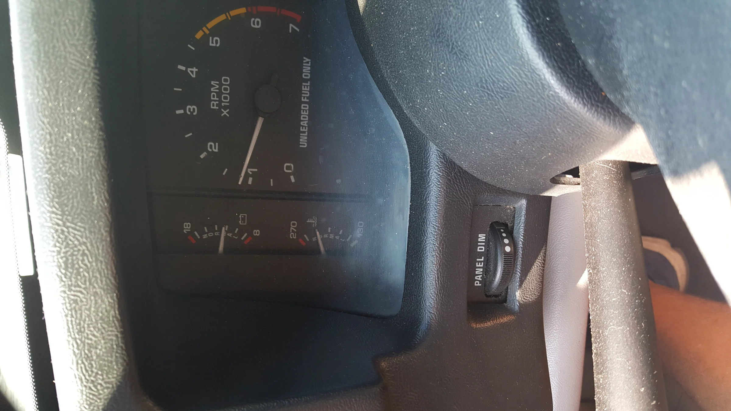

Found the issue too my over heat and bucking misfire issue come to find out was a bunch of paper and old filter in the maf screen cleared it out lost misfire and temp was faulty gauge replace with mechanical gauge all is good now found exhaust leag at headers clamp smh fml!!!!
