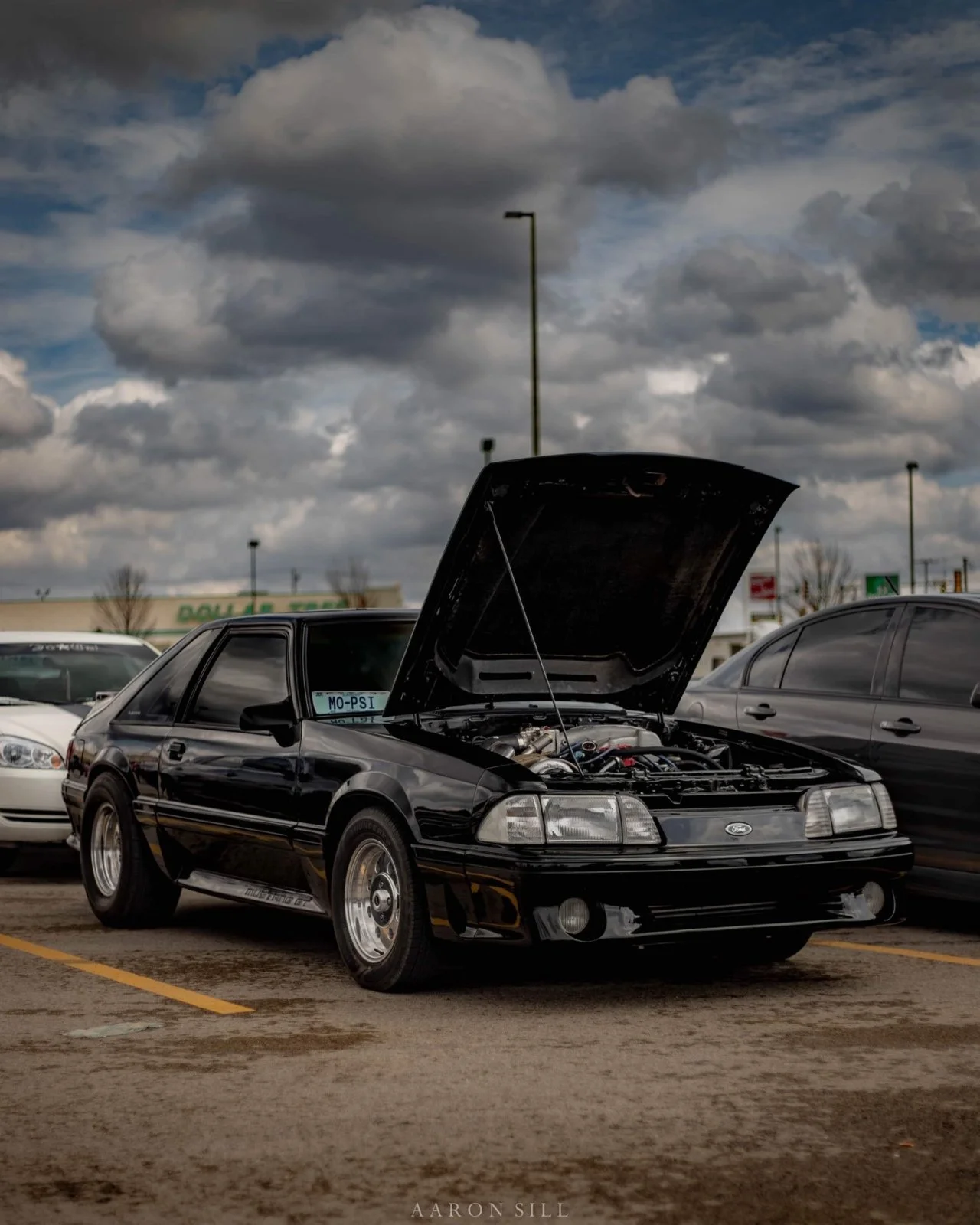

Went to the first car meet if the year today. Car didn’t blow up or break so I guess that’s good

First, I absolutely love the look of that car. Stunning! Very clean! Very aggressive! The quintessential foxbody!
