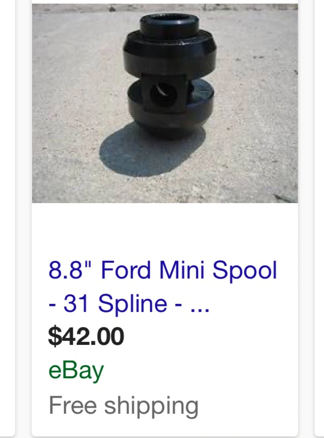

would I run into axle issues with the stock 28 spline (i think)? I think I read something last night about the explorers coming with 31 spline axles from the factory..maybe that would be a better choice? correct me if I'm wrong here..just trying to get as much info as possible so I know what I'm up against here.
Budget speaking, you want a 31 spline spool in your stock axle. Weld the axle tubes to the pumpkin, and run a rear end main cap girdle. Moser or Strange Engineering 31 spline forged axles.

Did ford ever put a 31 spline spool in anything from the factory that we could get in a u-pull yard?

If it helps-Spools are cheap on eBay .
There not that high for New either
