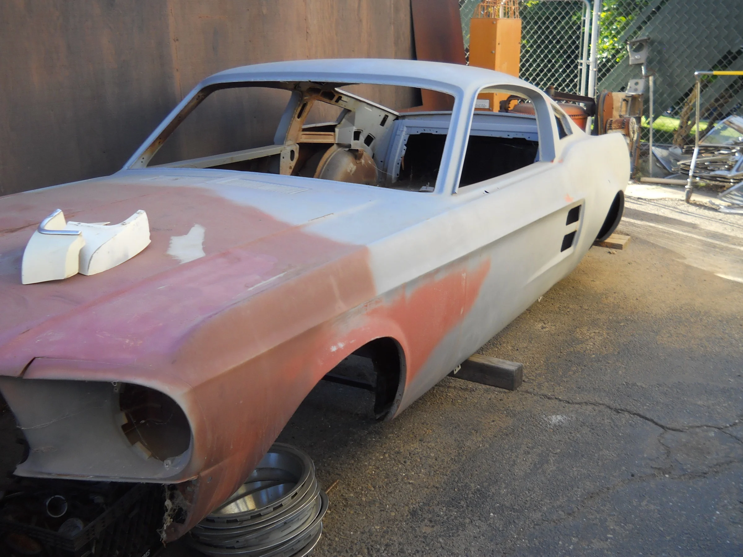

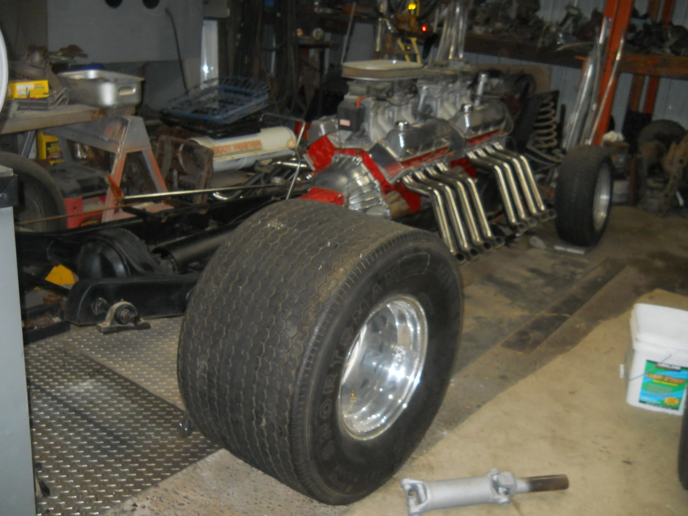

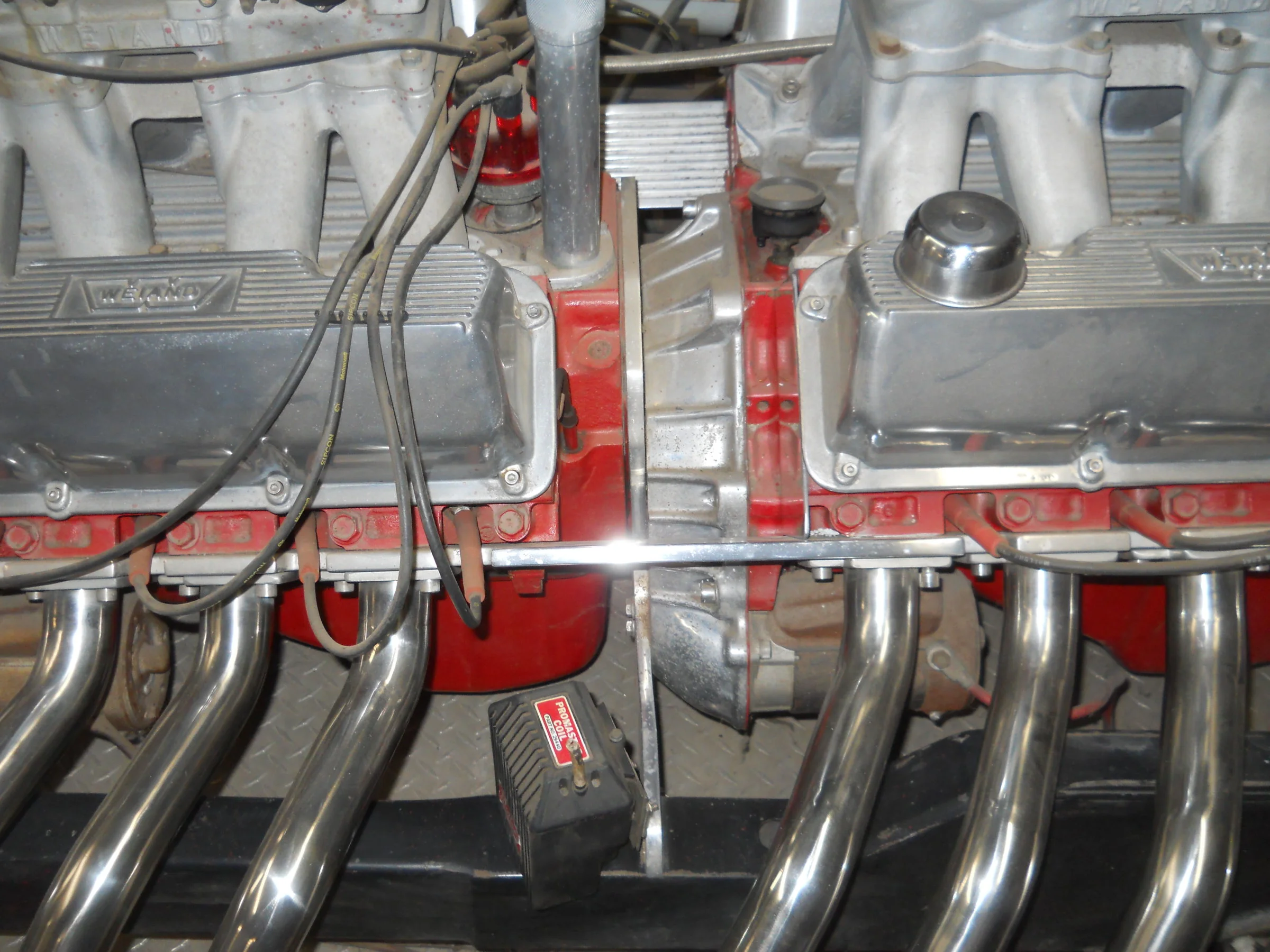

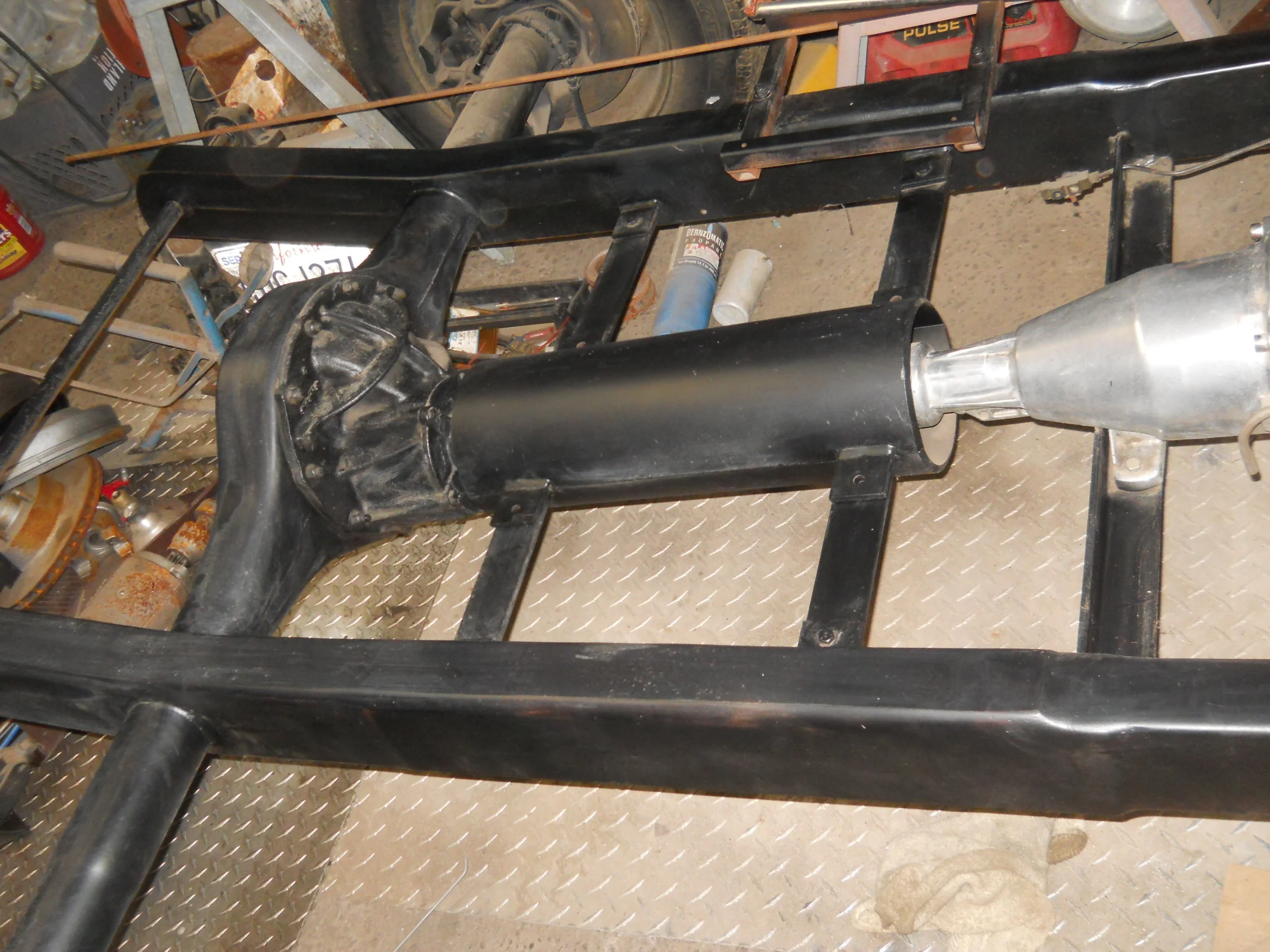

Hi Guys, I'm an old old school car guy, I have 15 mustangs, most are unfinished projects, And are now for sale. I have a (home shop) built, low cost drag mustang, Just mostly now for noise and fire, I like showing at mustang shows and this thing gets lots of comments in my backyard shop. Has two 351 C engines, four 4 bbls and 23" S/S pipes, all hand built and purge welded here at home 7 pieces each pipe, I used a 67 fastback front sub frame, hand built the rest of solid frame, with a body tilt bar out back. The fb body is solid welded, all stock steel but with glass flares, will have lex windows, all brushed .032 alum. interior and air lift cylinders for the body lift. Spent lots of time on this thing, then got sidetracked, probably will never actually finish it, as am building a 69 fb with 408 ci. W now, also, my son is building a 69 R code 428 CJ outside on the lift. Keep the stories and project pics coming. At 81, I can still see and read. I have a 89 Saleen conv. I never drive also two 1978's, one is a KC. one is a 4 cyl. with 4 speed cp. Thanks, Harry
