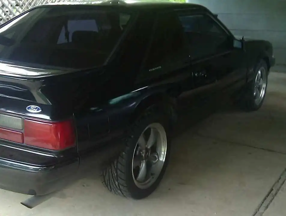

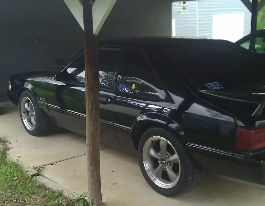

Look at the pics of my car i have sn 95 fronts and fox length rear it isnt that noticeable with the right back spacing

Not the greatest (cell pics) but you get the idea. Need to get out to my favorite spot and get some good pics of it.
