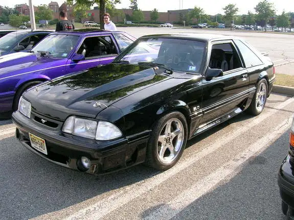

Bullitt wheels on my 1988 LX

Any thoughts about non-Ford wheels? I don't see any with 30mm but most are in the 27mm range. Is this enough to make a difference? I had a Contour for a daily driver back in the day and I bought TSW wheels and had nothing but trouble with them. First they came without the correct mounting rings, then when I got that sorted it took an act of God to balance the things. I had to bring it to 4 different places before I found someone who was able to get them close but never perfect. Needless to say I'm a little gun shy of wheels without a Ford stamp.
You will need spacers to use them and look decent. They have more like a FWD offset and backspacing. I've seen them on some 94-04 cars, and they look like they are all sucked in. The only Fox they look decent on is the SVO and Saleens which came with a 2-1/2" wider track than the rest of the Fox cars since it used the wider Mark VII axles and brake setup.
The 05+ 17x8 have +45 offset. The sn95 are +30
That means out back, the rears would pull in 15mm or about 1/2 an inch. This would work fine out back as it would be 1/4 wider than stock fox offset.
Up front, you might find the wheel hitting the control arms. Guys typically run 10-15mm spacers up front and maybe a 5-10 out back to push them out slightly.
I have seen them on fox mustangs...they work. The tire size is incorrect though as they come with 235/55/17 which is too tall for a fox.

I am gonna run these anyway....picked up a low mileage no curb set for 400.
Yes, 94/95'do push out more than stock, the 96+ push out 8mm more than the 94/95.
I def notice my front wheels out wider with the 94/95 spindles vs when I had svo rotors up there.
