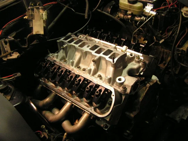

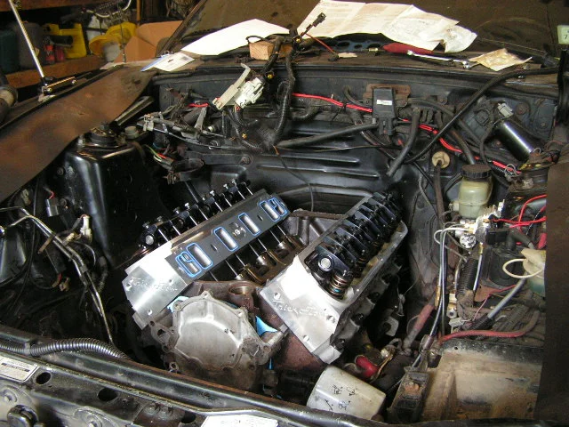

Id never put a b-cam in any car, but besides that, AFR 165's are not anywhere near 2,000$.
If your going boost, get some TF TW's, if not get AFR 165's or AFR 185's. Even 185's arent even close to 2,000.
Then spend the money and get a custom cam, and dont get that BBK intake. I went with a trickflow setup, I dont like the intake so much but it gets the job done. And Id rather have a custom cam over the TFS 1 for the extra $150.
