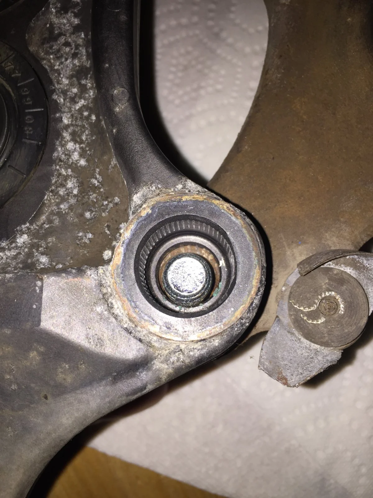

Played with it a bit more last night.
The Caliper is clearanced enough to bolt up fine once the inserts are remade for the offset. You can see the m12 bolt here. I have both bolts in the Caliper. It's tight, but it fits
With the other Caliper, you can actually thread the m12 bolt in and with the offset it's able to be snugged. Caliper actually fits damn well. I'm surprised.

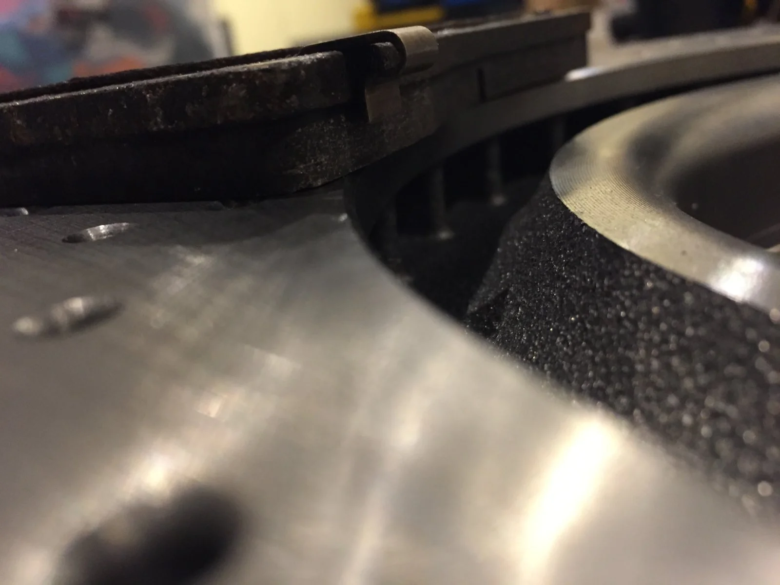

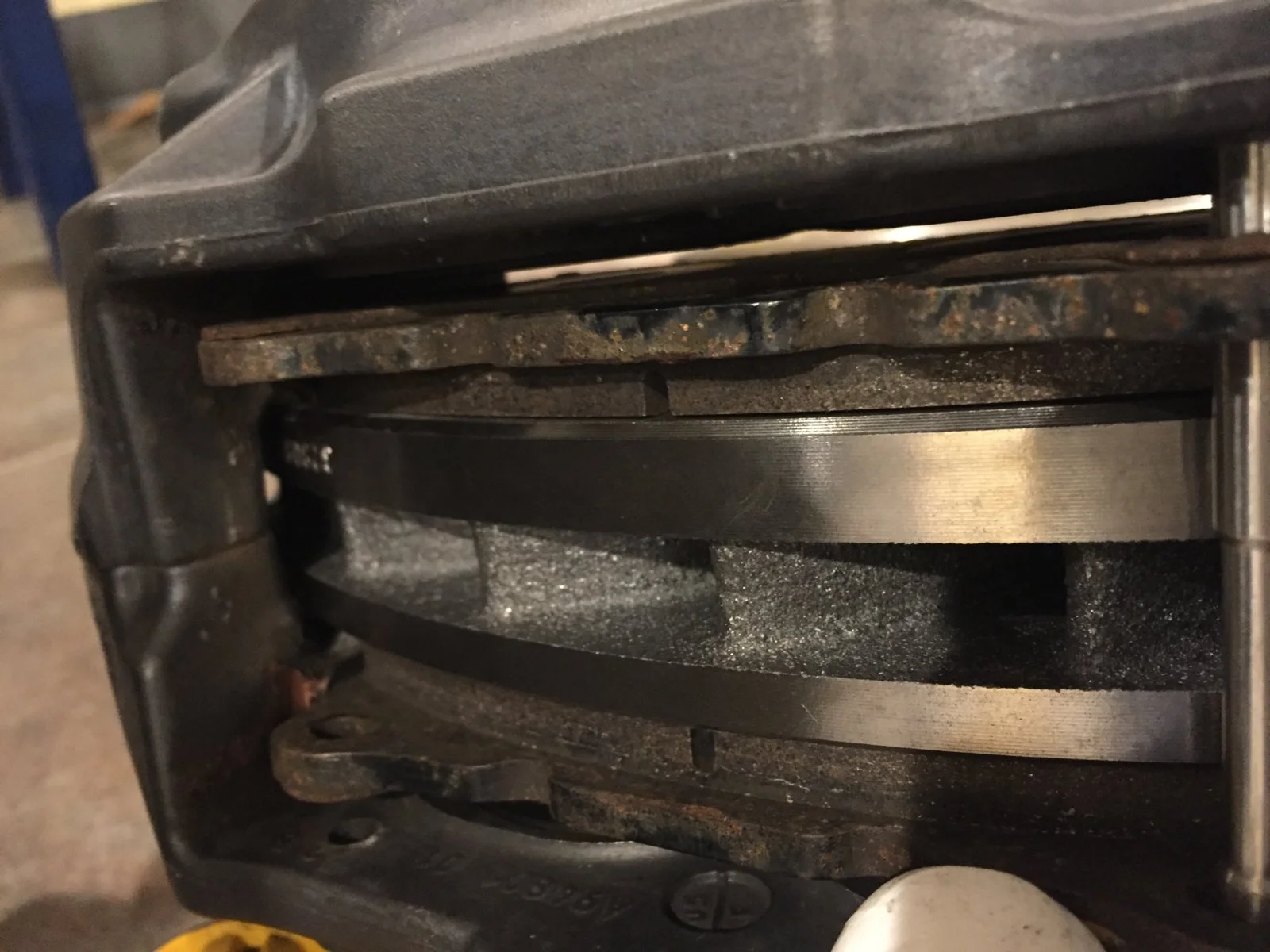

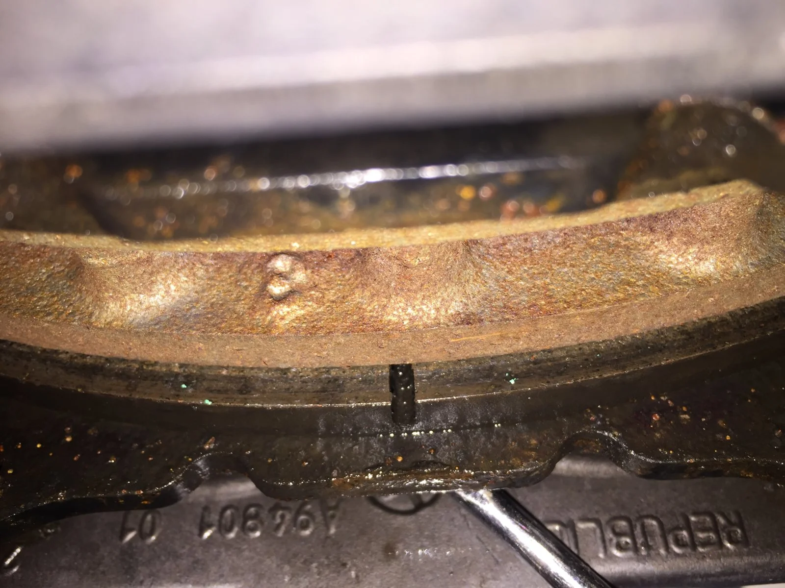

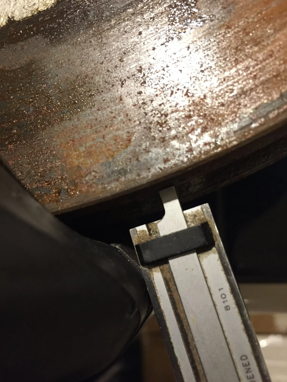

Pad comes fairly close to edge of rotor on bottom edge. You can see how the curve is slightly different. These calipers work with 12.5" rotors.
On the top side, different story. Looks like there's a 5mm overhang.
Not much room to go larger on rotor without striking the body. I need about a 5mm larger rotor. Even then might be some pad overhang

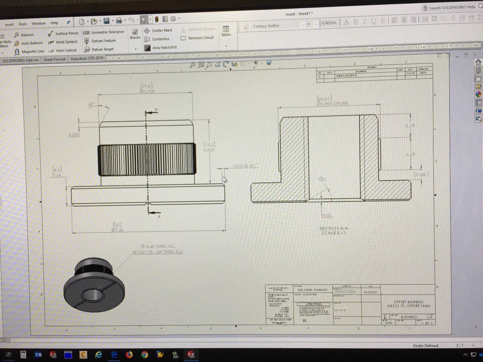

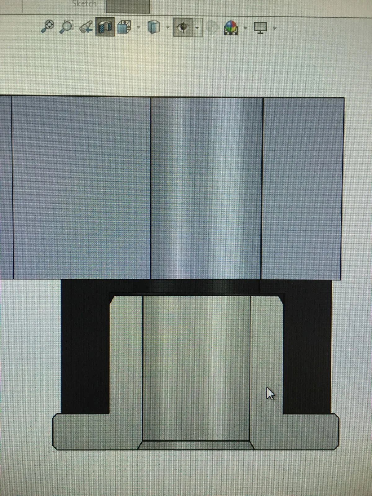

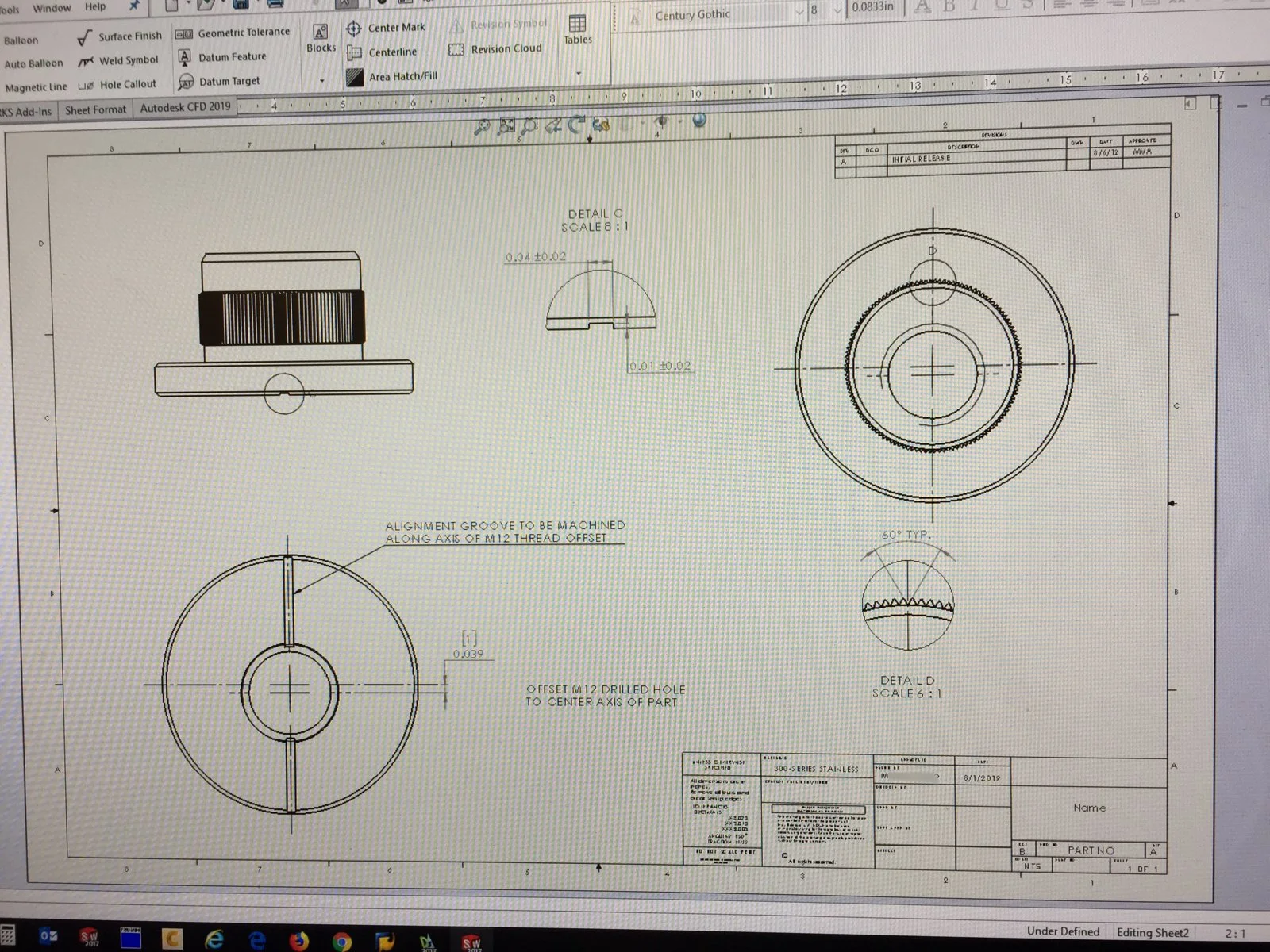

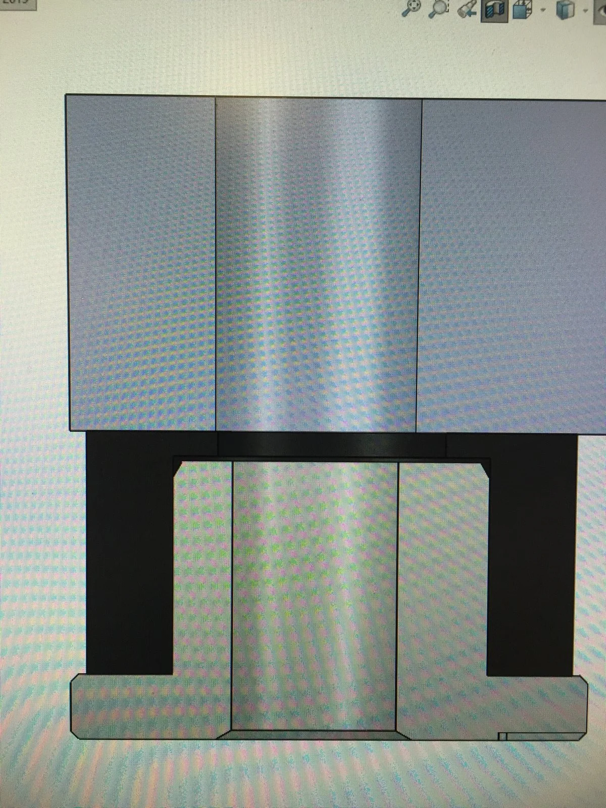

Whipped this up during lunch in 10 mins.
I did model it up in CAD and it should work fine. Cross section of the spindle on top. Black is the aluminum Caliper body and the insert bushing on the bottom with the offset and m12 threading. As you can see...it aligns nicely.
Now to get 4 made. Might take me a few weeks

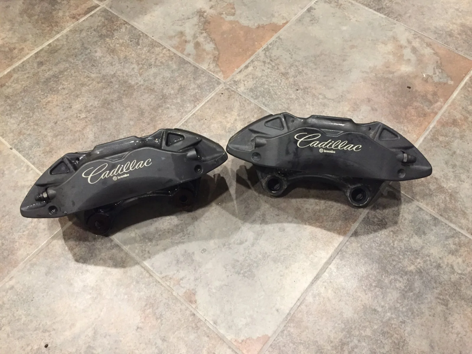

By comparison, stock bushings with m14 hole. You can see how it's off a bit and how you'd have to clearance the sn95 spindle to fit it.
Btw...pics of my $100 Caliper pair. I'll refinish them in traditional Brembo red and white decal when done

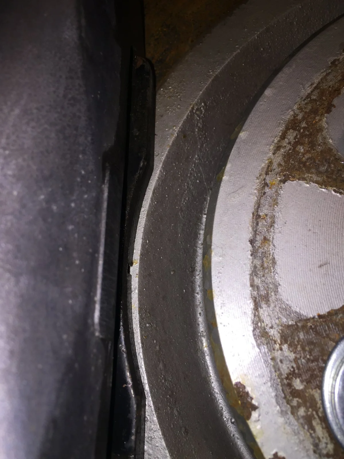

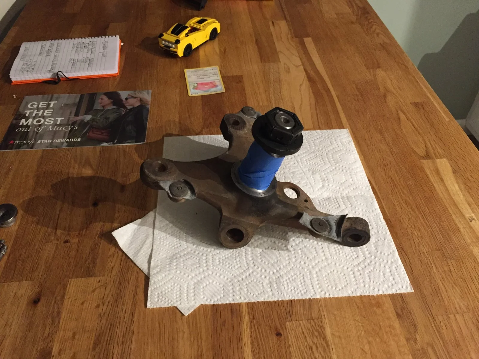

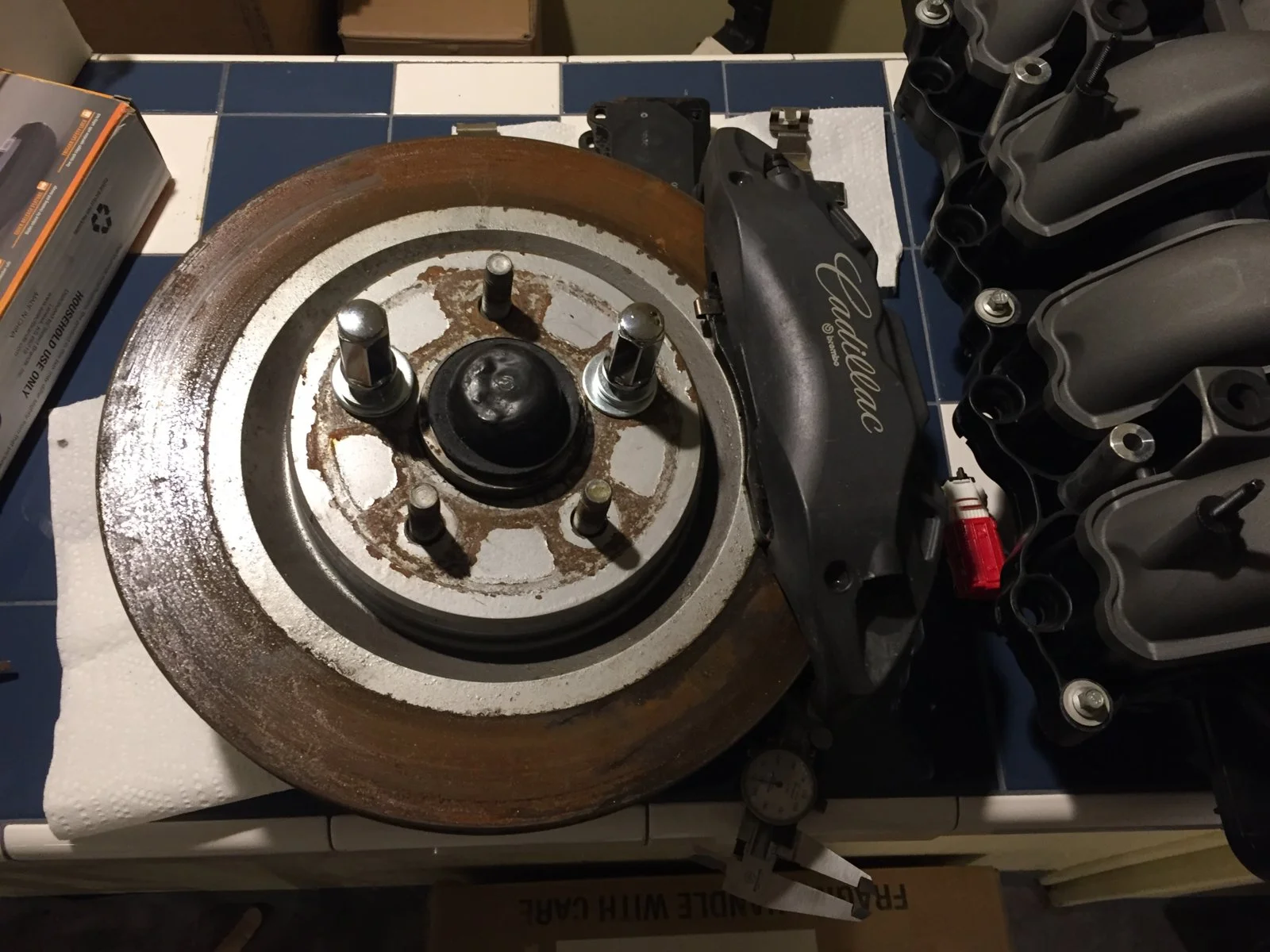

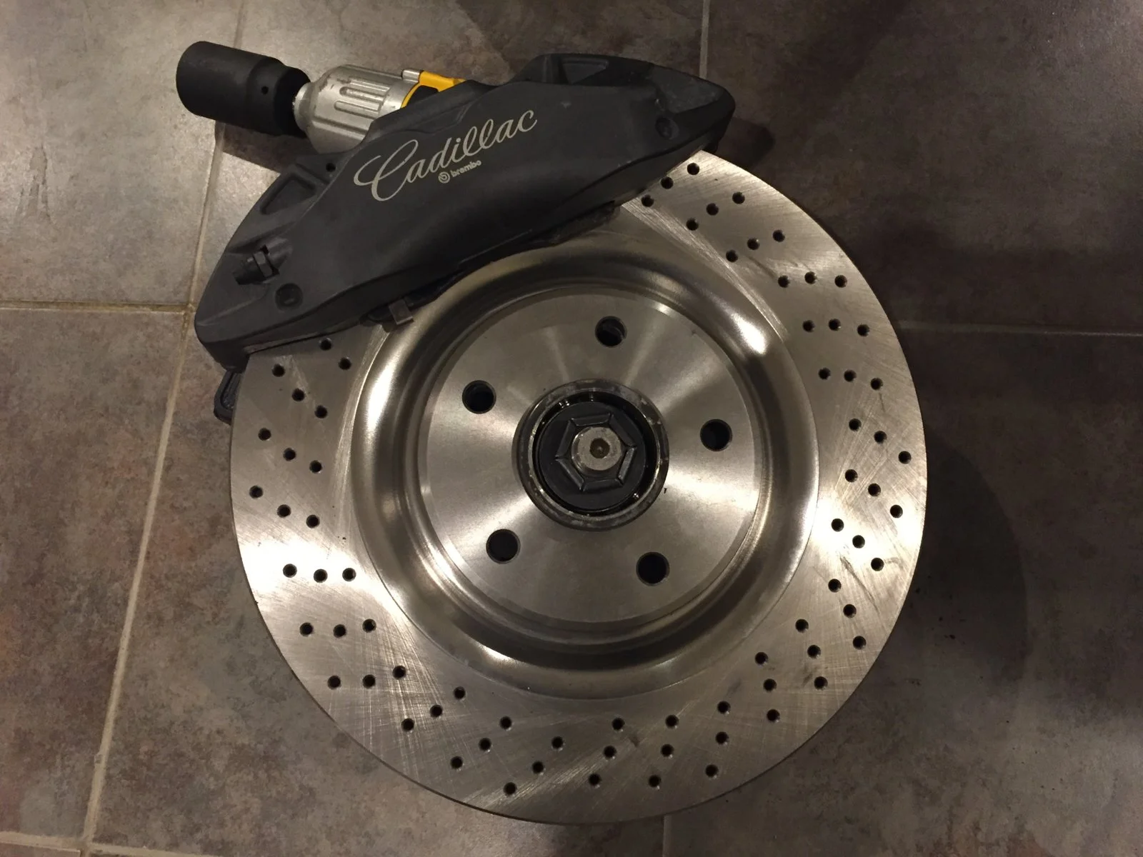

Some more experimentation.
Press the lugs out of a junk hub I had. Test for up the corvette 13.4" rotor. It's actually pretty damn close to fitting. Tough to say for sure until I get the Caliper fully bolted on.
Need to verify the rotor is fully seated on the hub. It's the right size to slip on, but might be some rust preventing it from going all the way down. But...it's close.
Appears to barely clear the rotor channel and the pad appears to to cover the entire rotor on the top
However, now the bottom of the pad hangs over.
Anyway, I can't do much until I machine the bushings and have the Caliper fully secure. Perhaps there's another corvette casting that has more rotor face.
