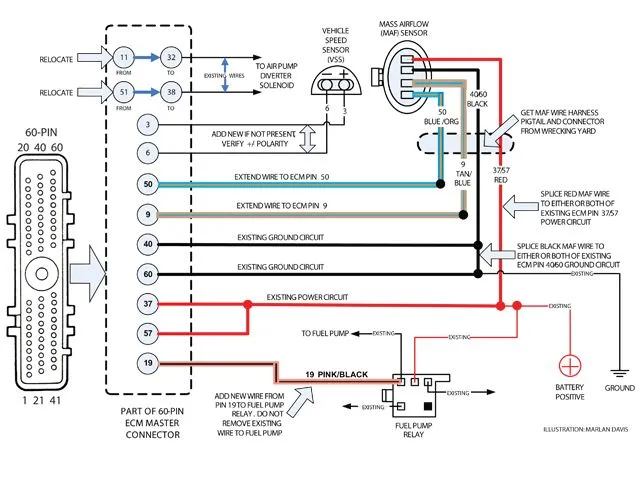

Honestly at this point i'd just do the MAF conversion.
Couple hundred bucks for a meter (SN95 plus adapter), a $45 IST wiring harness and a used A9L/A9P and then you can run whatever cam you so desire (TFS stage 1)
MASS air conversion instructions from MAF - Mustang Mass Air Conversion - StangNet - The Mustang Network FREE
Revised 2 Aug 2014 to add new links to conversion harness suppliers, diagram for repining computer wiring connector and YouTube video
A9L (5 Speed) computer from junkyard $100-$150
A3M (5 Speed) computer from junkyard $100-$150
A9P (Auto or in a pinch, it will work in a 5 Speed car) computer from junkyard $100-$150
70MM MAF from 94-95 Mustang GT - $40-$70
MASS Air wiring harness kit $30-$85
The whole thing is probably less than $300 using junkyard parts.
A9L computers are 5 speed only
A9P computers are automatic, but will work with a 5 speed.
The conversion harness seems to work well for most folks. It avoids the compatibility problems in using a harness from the junkyard. Simple and cheap, actually less work that swapping the wiring harness.

Wire side 60 pin computer wiring harness connector
Computer side 60 pin computer wiring harness connector
If the idea of moving & soldering wires scares you, here's a list of compatible Mass Air wiring harnesses.
