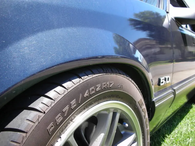

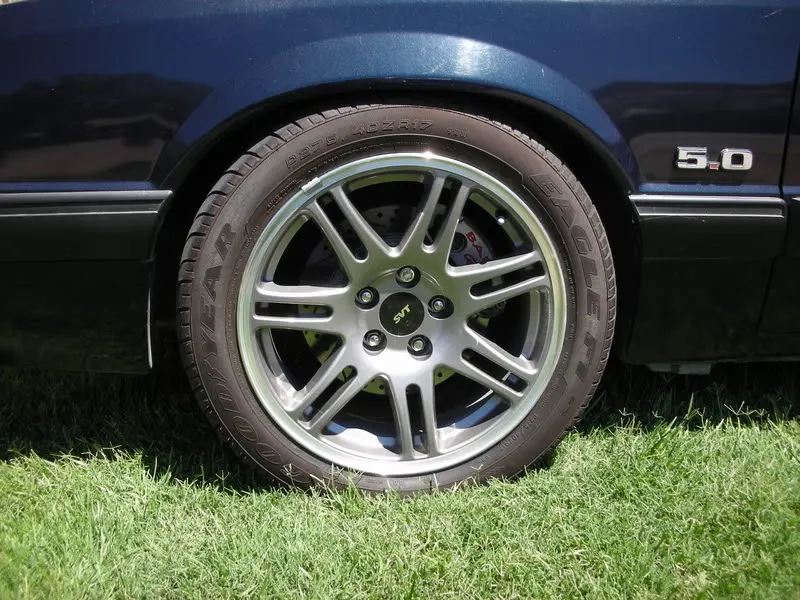

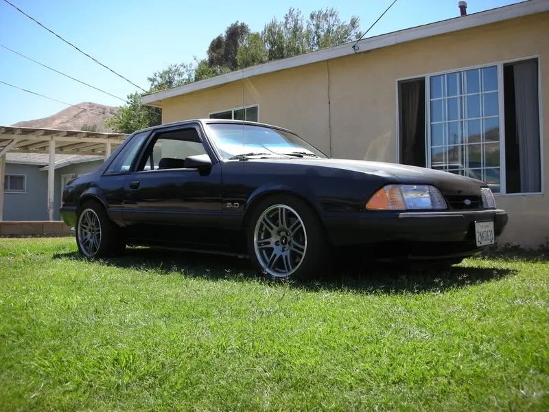

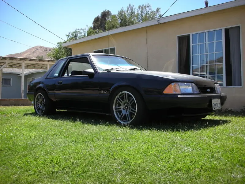

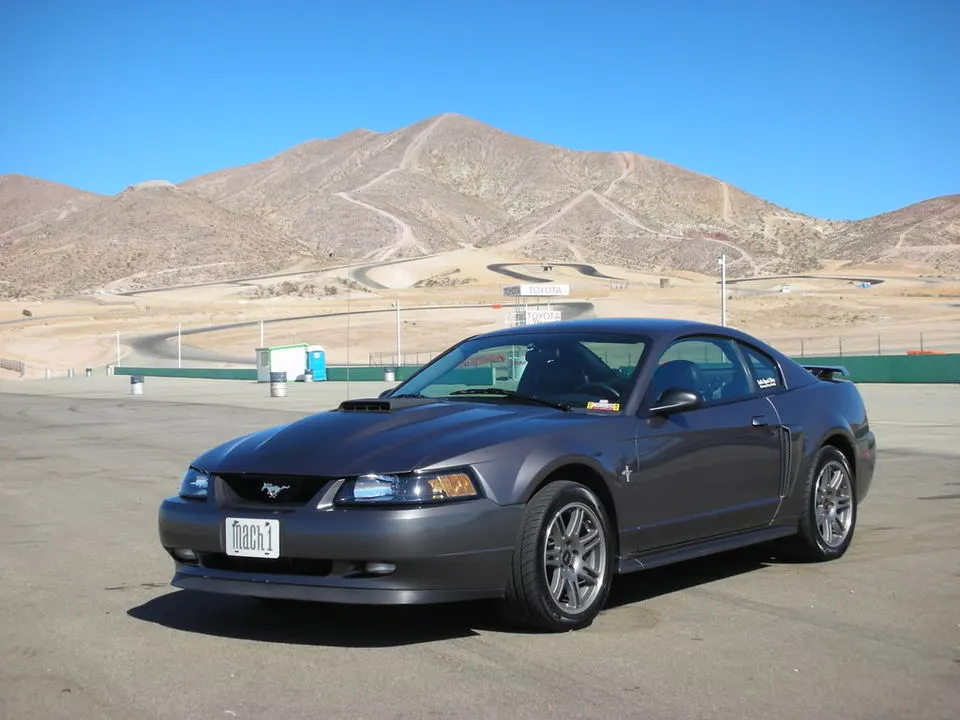

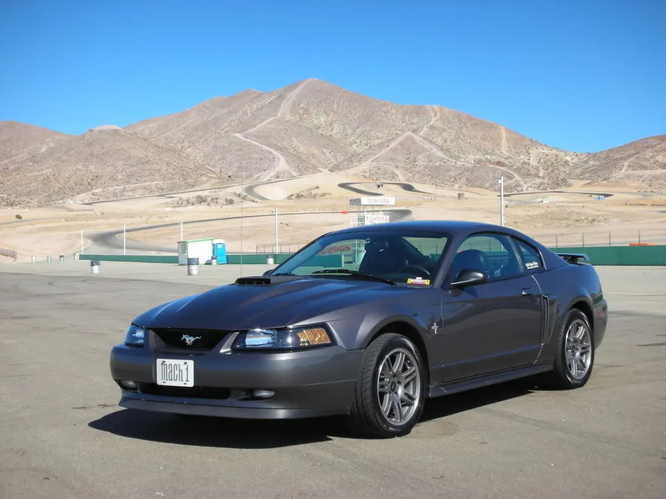

Unfortunetly, the front tires do rub. If I decide that I want to use these wheels on the coupe, I'll have to change the front tires to a smaller size. In addition, I may have to install the front spring isolators and/or replace the front fenders with those from a '91 and up Mustang to gain more fender clearance. Until then I have the set of wheels/tires installed on my Mach...
