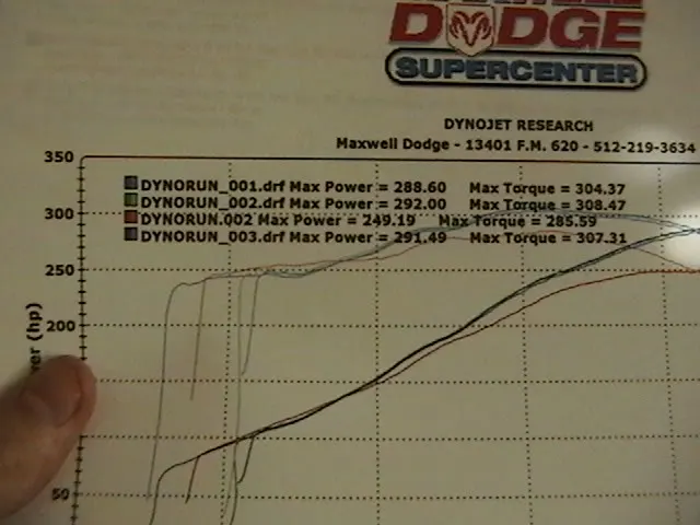

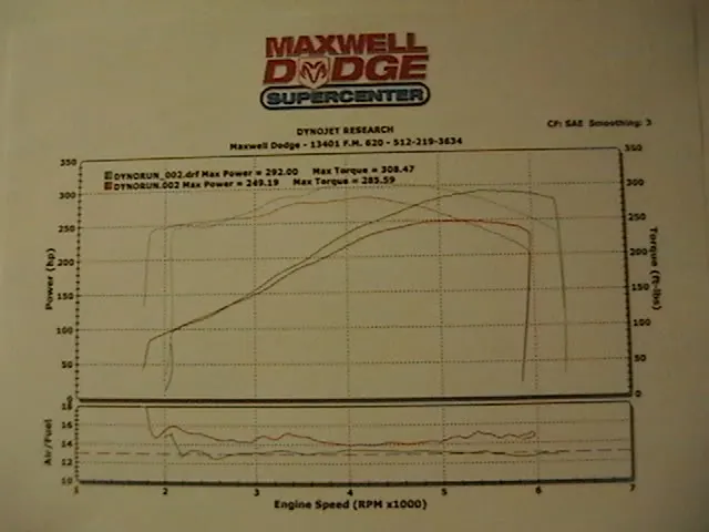

***UPDATE!*** Well it didnt quite do 300, but im still VERY happy with the #s! Made 292RWHP/308RWTQ! :banana: The graph and videa are in my latest post.
Car has like every bolton (e water pump, U/Ds, windage trey, LTs, O/R X, cat back, CAI, TB, plenum, Tims tune, and VT cams).

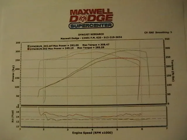

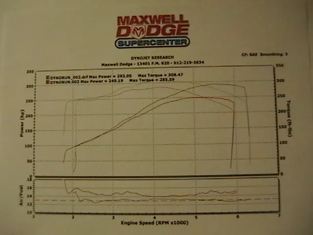

Im thinking if I had the stock rear tires/rims and the stock 3.27s, it would have been VERY close to 300, but like I said I AM HAPPY! And very glad to see that my A/F is dead on still. SOOO I added windage trey, BBK LTs, U/D pullys, and a electric WP after Tims tune, and it went from 274/292 to 292/308 and A/F was uneffected. Apparently LTs DONT screw up the A/F:shrug: .

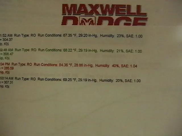

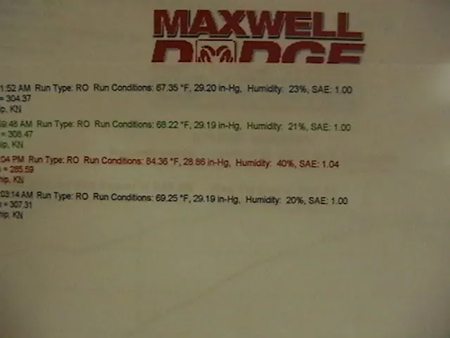

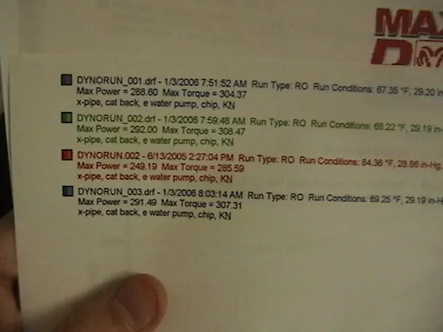

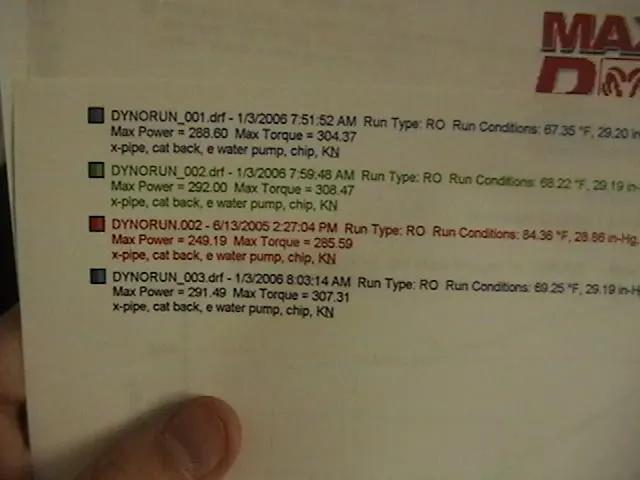

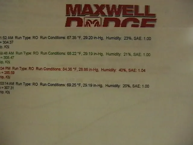

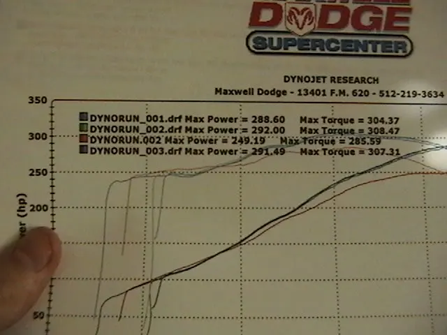

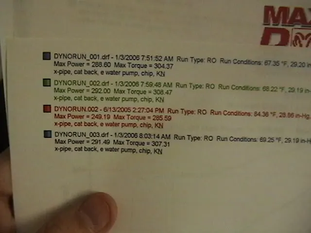

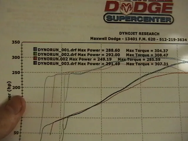

Ok, here is the graph...pic was taken with camcorder so im not toooo sure about quality so thats why I did some closeups. I asked them to do and overlay, and the green line is my best run, the red is my best back before the cams,dyno tune,LTs,windage trey, and pullys. Notice the red A/F lol, darn mail order tunes:nonono: . The green one is from Tims tune...thats how its supposed to look! And notice the power curve....cams and LTs really dont loose much down low huh? And this time around it has the weather info:nice: ...this is due to them just updating the software last week :D
Guy made three runs for me :D Its supposed to be 2. The second run (green) was after a 5-10 minute cool down, the 291 run was made just after that to see if it liked being hot, and the 288 was the first. I think the first was lower mainly due to the EEC needing to get in the swing of it going WOT :shrug: since both the 1st and last were hot runs, yet the last was clearly higher.
And conditions.

I made a good guess at 295, I was only 3 off. :nice:
