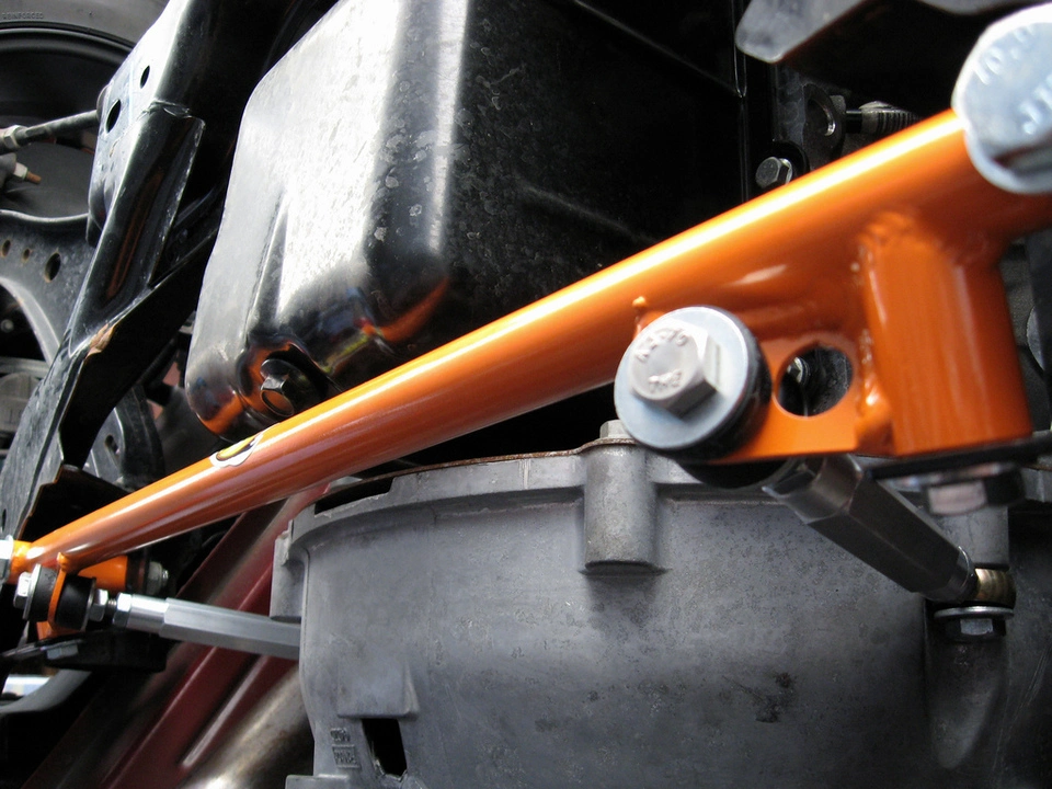

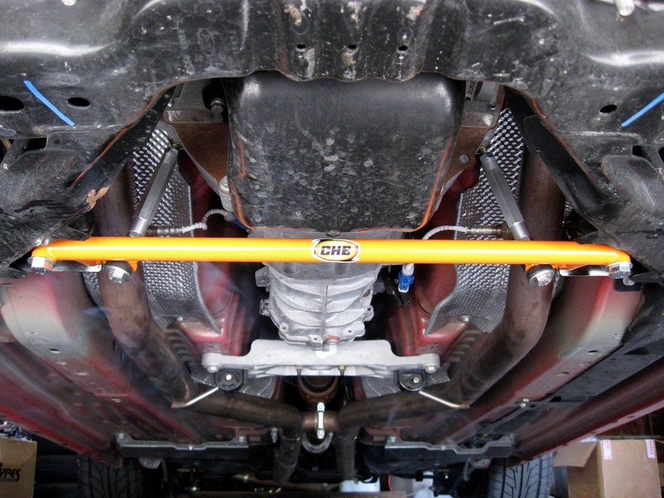

1 car down, 1 to go. Installation was pretty straight forward. The CHE directions on their site are pretty good. I ended up using the inside holes. I first tried the outside, but that pulled the limiter too far away from the bell housing. Installation took about an hour and a half, but I took my time. I'm confident I can get the next one in in under an hour. I got the orange one for my '07 because I figured I'd be doing a write-up and I wanted it to be easy to see. But the CHE directions were more than sufficient.
Haven't driven it yet, but I plan on getting to the track this weekend. I did rev it up a few times, though. You can really feel and see the car tilt when you rev it. Feels like a big block :)

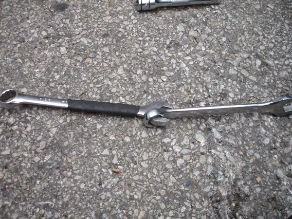

Yep. Pretty easy. Just jacked the front end up in the garage and went to work. Honestly, nothing really took all that long. The hardest part was breaking the nuts loose on the a arm bolts. After a few minutes struggling and thinking, I grabbed another combo wrench and put the closed end over the open end of the other wrench, to act as a breaker bar, and shot some PB Blaster on them.
very nice, I got the steeda g-trac brace that's been collecting dust that I really would like to get on there but can't because apparently my 2007 has... A: something like that from the factory that's in the way and B: the bolts mounted up not down so I can't break them loose without some 5ft long extension.
The bolts are installed correctly. The bolt should face up. The nut is on top. Use a combo wrench with the closed end, so that the wrench angles down. Then use another wrench as a breaker, as shown in this picture. To help matters, squirt the nut with PB Blaster 5 minutes before working on the nuts. Should come off with little effort. Took me a good 10 minutes to decide to try that.

Doesn't help your car handle all that much better if at all. It helps keep you from punching a hole in your radio when you go for third.
Edit: I haven't been under my car since it was installed, but how much room is there to get a socket or ratchet wrench for the oil drain plug? Or would you have to remove the entire brace?
That was my question when installing it. Socket won't fit, I can tell you that. You'll have to use a wrench. But it looks like it should come out without issue. You'll just have to clean the bit of oil off the brace after you put the plug back in. Little price to pay for having a stiffer chassis and better shifts.
Got the other car done in well under an hour. Much quicker when you know what you're doing. No struggle with the a arm bolt using the wrench as a breaker bar. Put the torque limiters in the same hole as the other car and it went very quickly.
