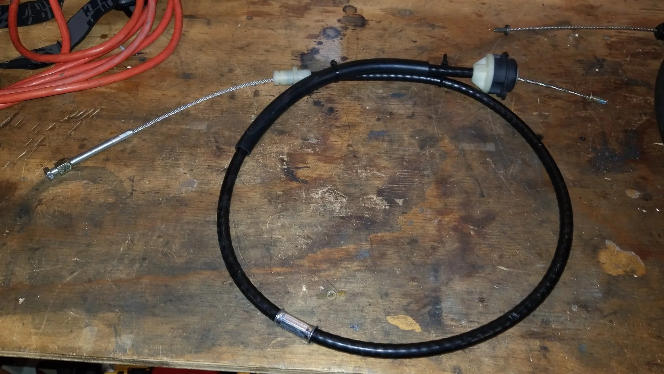

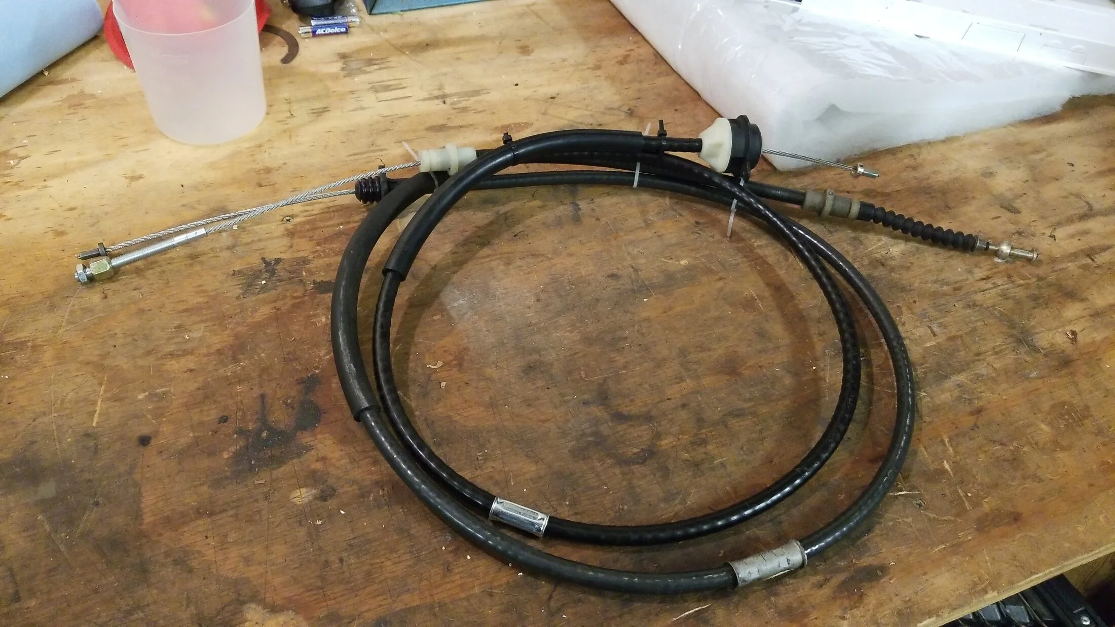

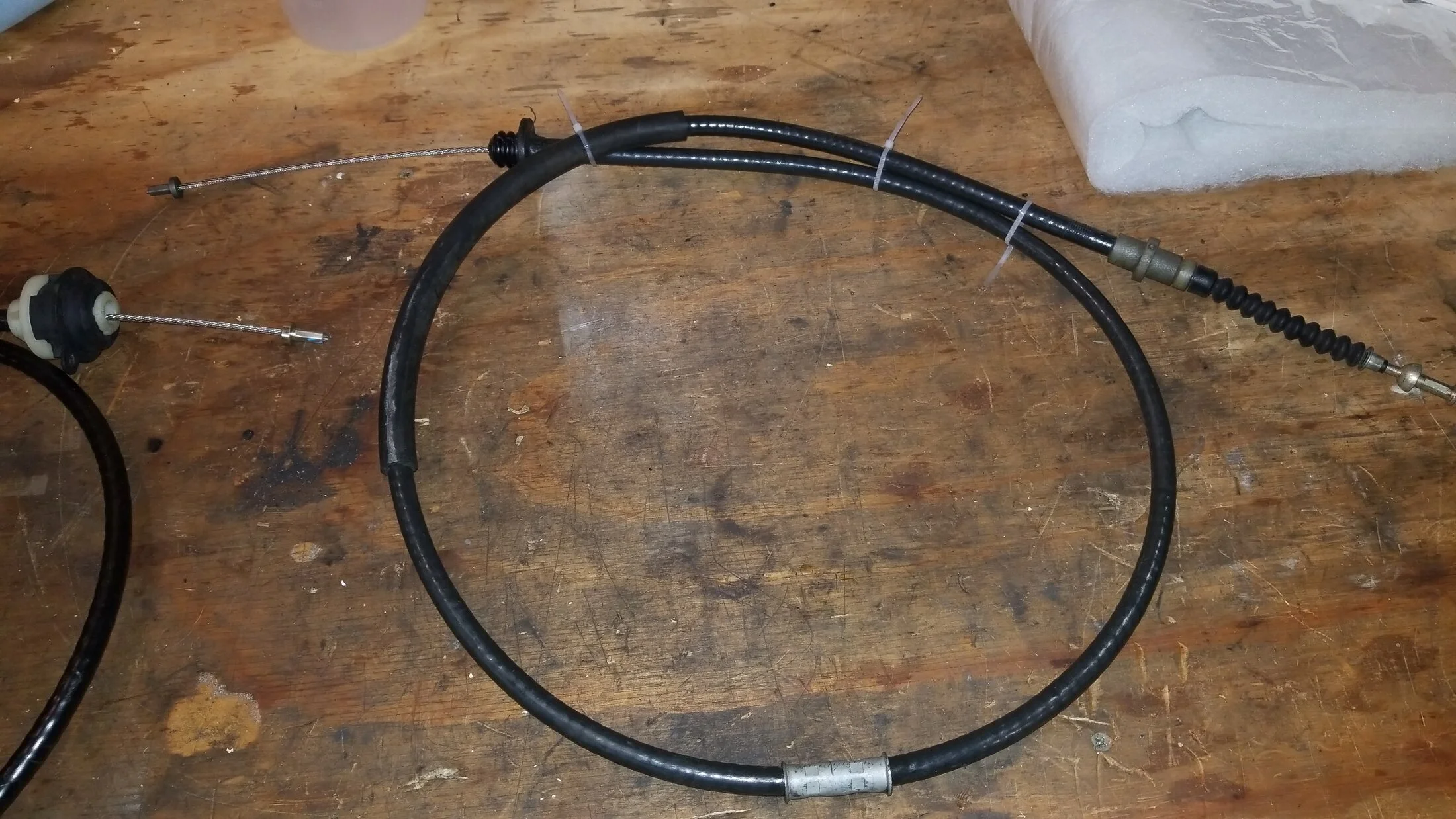

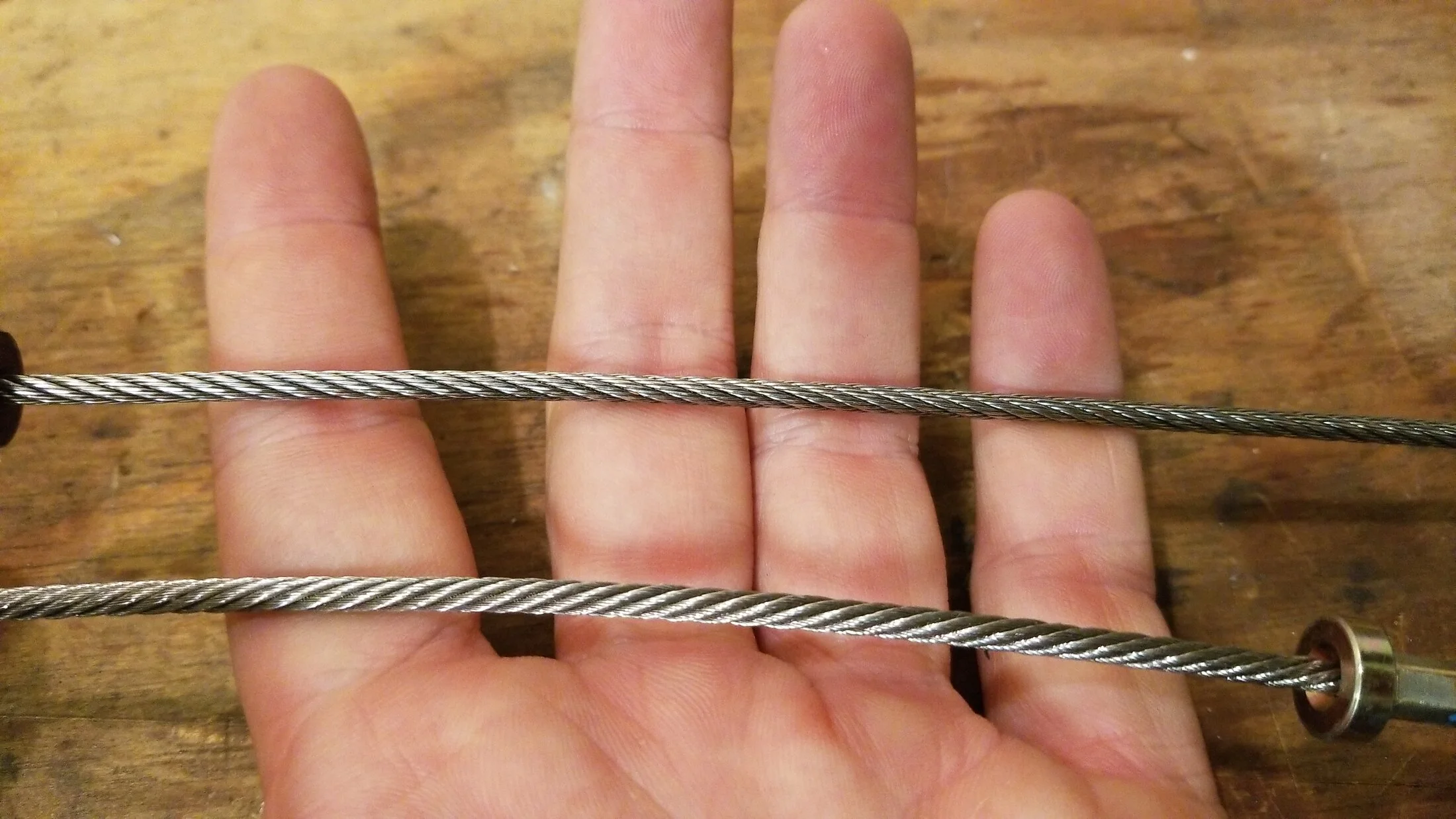

Steeda Top & MM bottom
MM is longer
MM:
Steeda:
MM top, Steeda bottom

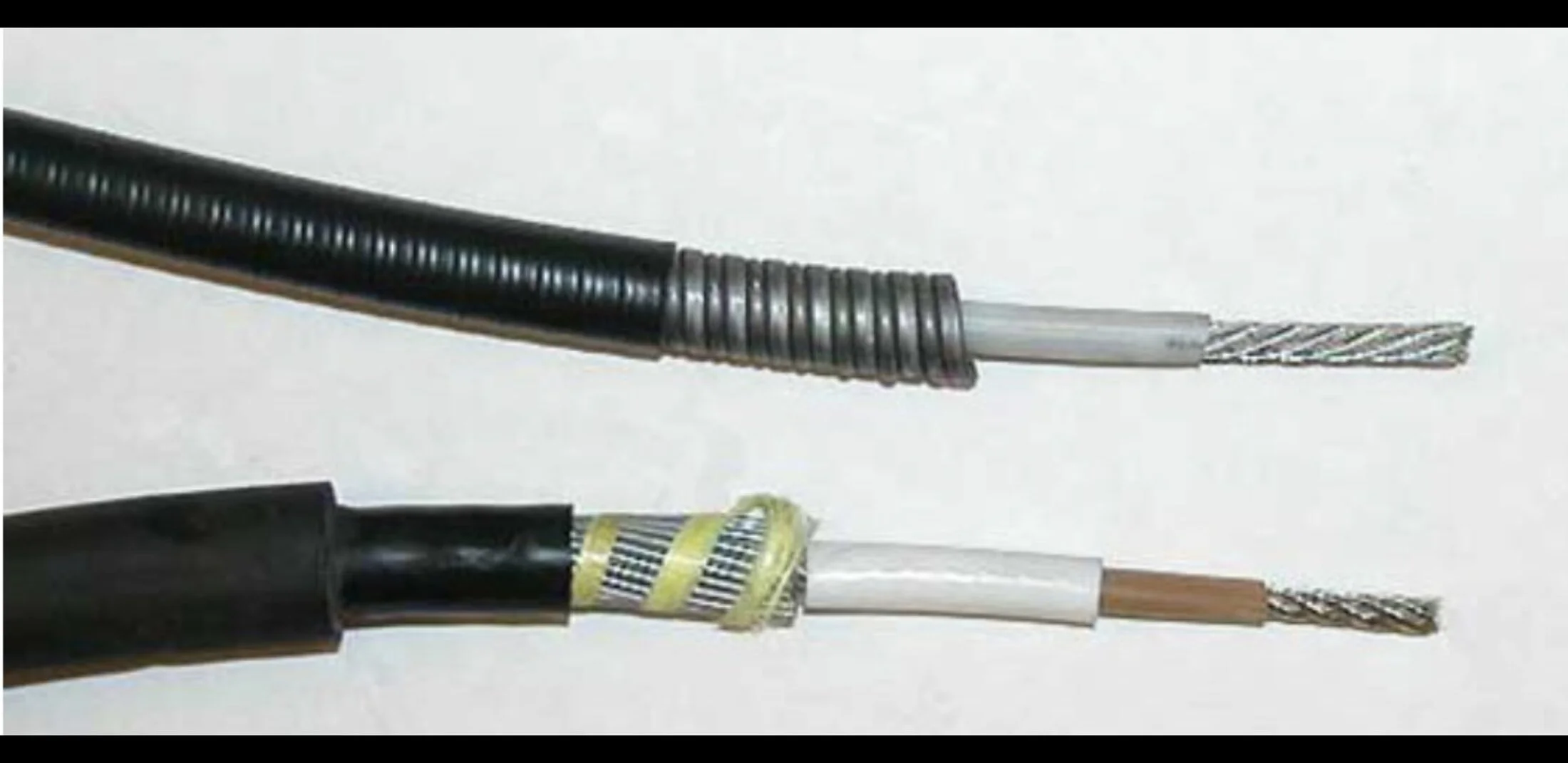

MM thinner, more tightly woven strands.
From MMs website, MM on bottom. Aftermarket top.
Reactions: Shakerhood, rednotch and Noobz347

The top cable style in mm's picture are the ones that collapse.. The coiled sheathing ends up deformed and cutting into the cable or at least that's the issue I all ways had with them...
The newer 94-up oem ford cables all had that black firewall end, just with a bushing on it. the aftermarket has it to but they all ways have a metal band around the sheathing where it meets the cable housing end. I guess MM scrubs the part number when they take the bushing and the bracket off the cable, its usually printed on that small outer cover in the middle of the cable..
The steeda cable is a 79-95 I'm guessing, not a 96-04, they have one for each. Hard to tell without the frame rail bracket, but the 96 up one they sell should be longer then the fox style and I assume longer then the MM if its adjustable.
Hays used to make a very stout adjustable cable with metal ends that was blue but they where like double the cost of everything back then, pretty sure that's also no longer made.

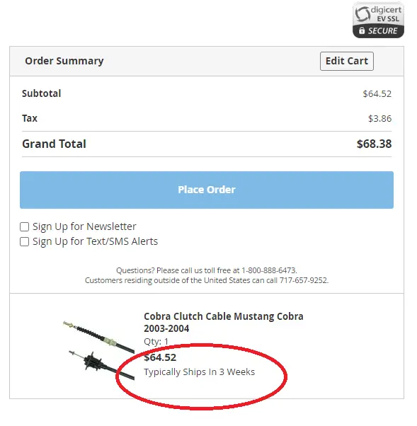

Update to the update:
At first, I couldn't get the [Place Order] button to activate. I'd missed a clicky block.
Here's what it ended up being with standard shipping:

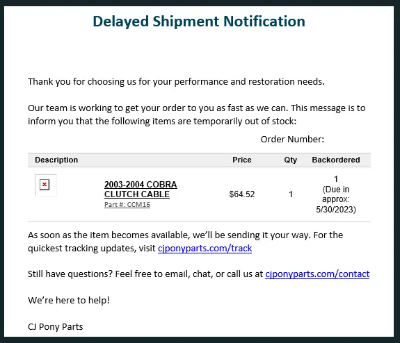

Kinda figured... I remember this happening with CJPony a few times in the past. I'll probably stop with them unless, kinda like I thought about this, they really have something no one else does. Sent a message:
"So, basically, you guys lie on your website when it says "In stock" to get the money, which you charge immediately to the credit card, and then you report a delay or back order... got it. Issue a refund, now."
They sent back an email explaining how to cancel the order on their website, but I'd rather a human read that.
I'm not really pissed. I just think it's a shoddy business practice of theirs. Should have taken a screenshot of "In Stock" when I placed the order. That's why it went on my Amex Plat... Amex doesn't F around when you tell them to dispute a charge. If it goes through for Noobz, I figure the back order was filled and other places can get 'em, too.
