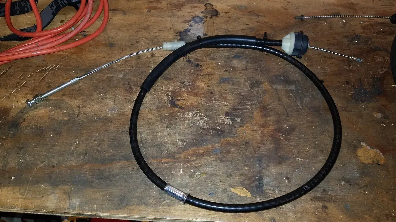

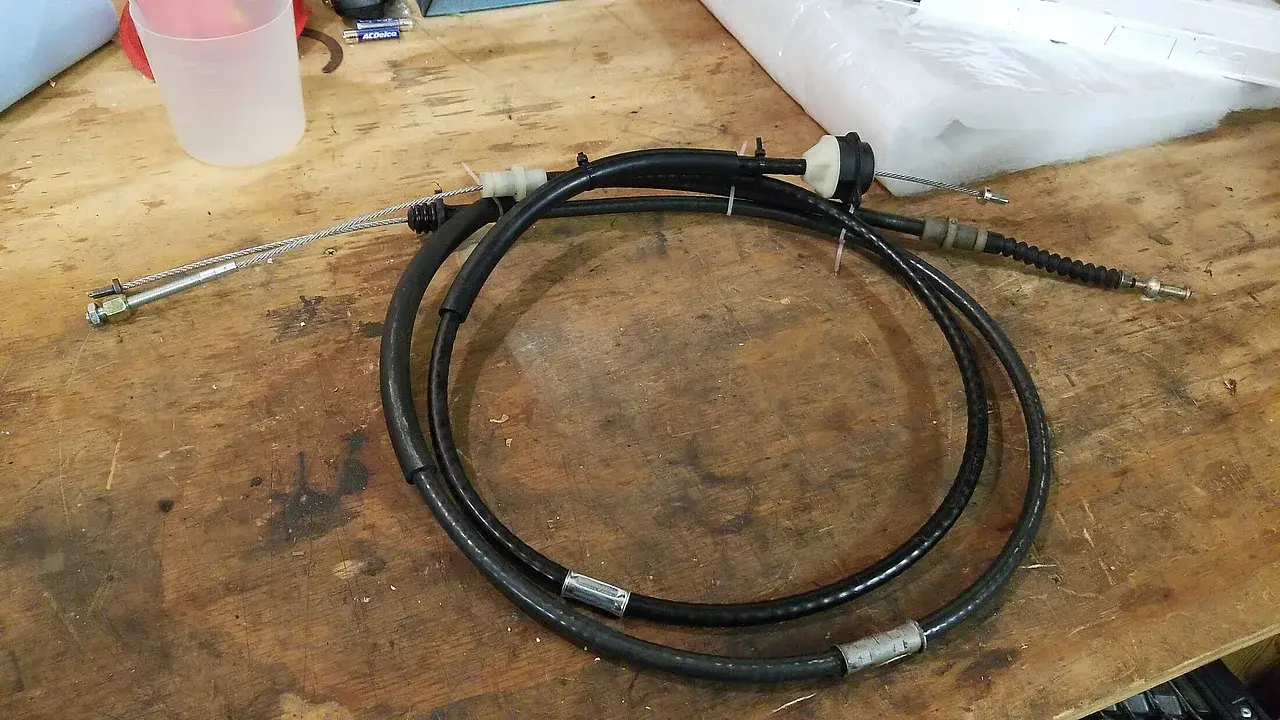

I will never use a cable again that has the white plastic ends. I've replaced probably 50 of them. On customers cars they would jam up in the sheath or pull the sheath through that white plastic. The last cable I bought for myself was a Ford one from a local dealer. One of the autozone cables was OK too. It had the black plastic and felt like OEM. I have no idea what brand they were. The cheap white plastic ones were sold by Advance, AZ, and a few other places. I'd ride around from store to store until I found a good one. Napa used to carry a decent one also.
(Pic stolen from FastDriver's post #23 in this thread)
Question about the "white plastic ends" that you refer to.... Are you referring to the white plastic end at the clutch fork end of the cable or the white piece at the firewall adjuster?
Both. I've had nothing but bad luck from that design. If your clutch is heavier than stock carry an extra cable in the car. If you notice the clutch release point getting closer to the floor. Check the end that goes through the firewall. If clutch starts getting tighter and tighter make sure the cable moves freely. I hate them but the better ones are getting harder and harder to find.
