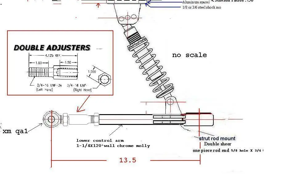

I am building a coil over set for a 65-66 mustang (road race AIX) I have the over all design competed but there is a couple load Issues I need deal with as in the lower control. I would like to make it fully adjustable using a ladder bar Adjuster ¾ x 16 R by ¾ x 16 L . Is type of setup had bin used on pan hard bar but the grade 5 bent and the grade 8 snapped. The question is how much loud, and share is on the LCA at the frame mount. Need cacs.

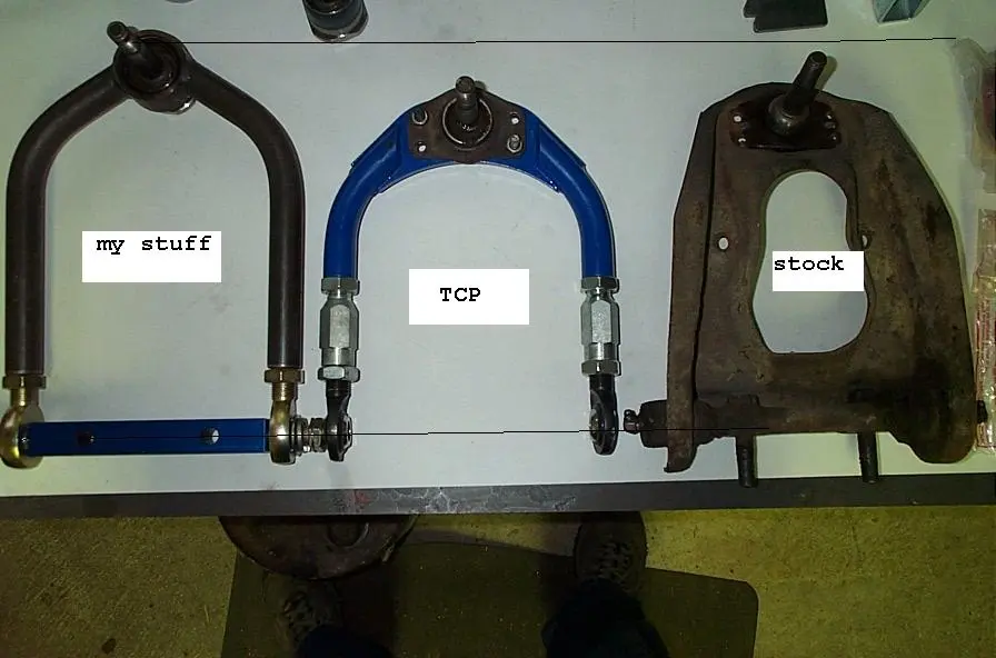

Just curious (this is not my field), but why the extra length on the upper arm?
I an still in the mockup stage, have not establish a length on then.
Does any body out there have the demotions on a Global West set up for a 65-66? Ball ball joint angel on the LCA and the UCA ect

I caning the lower adjuster for now and moving then to the Upper control arms. Yes the uppers will need to be shorter.

Bossbill and I are hard at it we a makeing two different types UCA’s
