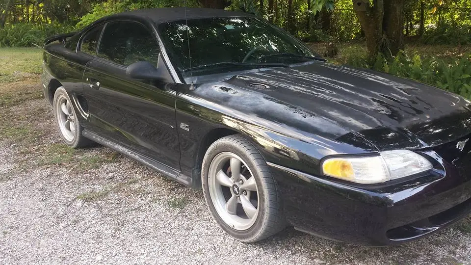

When I got my car this past Summer the paint was already fading on the hood and roof. However 8 months later up to now the since the Fl sun beats down on it and now the hood has grey streaks and it looks alot worse. So I would like a new paint job, I don't want a crappy AAMCO one nor a showroom style. Would $1,500 be resonable to expect to pay just to repaint it the same color, black?

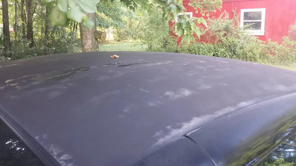

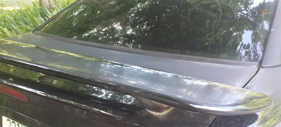

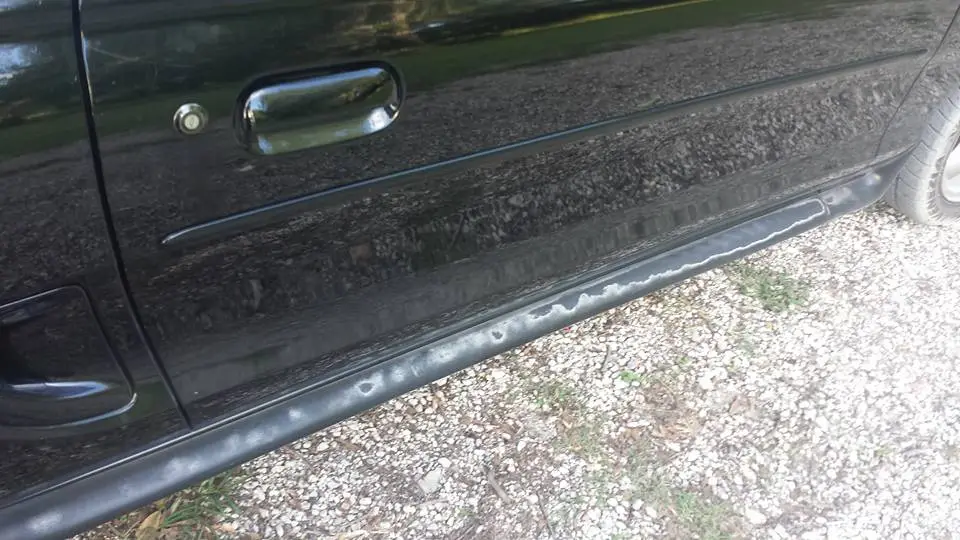

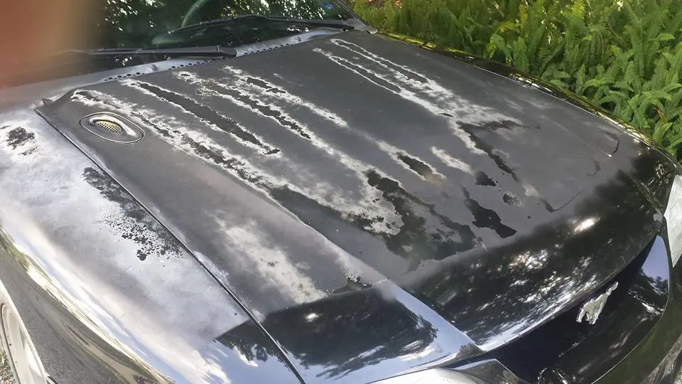

Most of the paint still looks nice on the sides, and front and back bumpers and right side front fender. The hood and left side fender is where it is the worst. the roof and trunk are faded

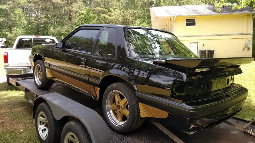

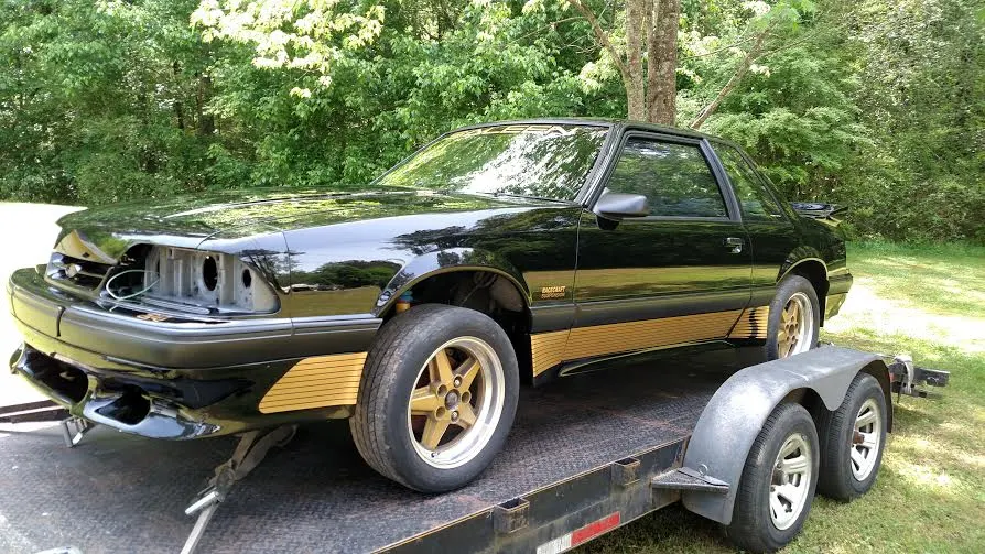

Here's one that I'm proud of that we just completed. It was a high end project and was completely disassembled and brought to us for paint. Our final price for paint, glass, restoration of the mouldings , trim, quarter windows, reassembly of the exterior and installation of the strips was around $6K.
Now its at my buddy's shop getting wired and the restored drivetrain and interior reinstalled.
Oh boy! Your clear has delaminated.
What this means is.....it needs to be stripped completely. You can't just remove the peeling clear, if you do, you'll leave a real ugly die back pattern on your panels.
Bright side? It's not that tough to do, but does take time. If you would like to do it yourself, pm me and I'll walk you through the steps.
There is no recovery from this though, the old paint has to go.
