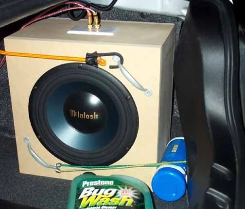

My wimpie little sub box, custom made by a carpenter customer of mine: inside dimensions 13 x 13 x 9.5", 3/4" MDF and holds just one 10" sub which, believe me, is more than enough (for music inside); total cost $20. Bass response is best when the cabinet sits in a corner, so it's mounted by bungees to the passenger side in the trunk. Also removable that way to get at spare tire if necessary (note handles and banana plugs attached to wall speaker jack). If you want sheer decibels and scr*w the quality, go with ported boxes, which will need to be more than twice the size, the weight, a commitment to give up any usability of the trunk (lol). IMO

Very Nice! I thought you were gonna install the polished nickel satin handles?
